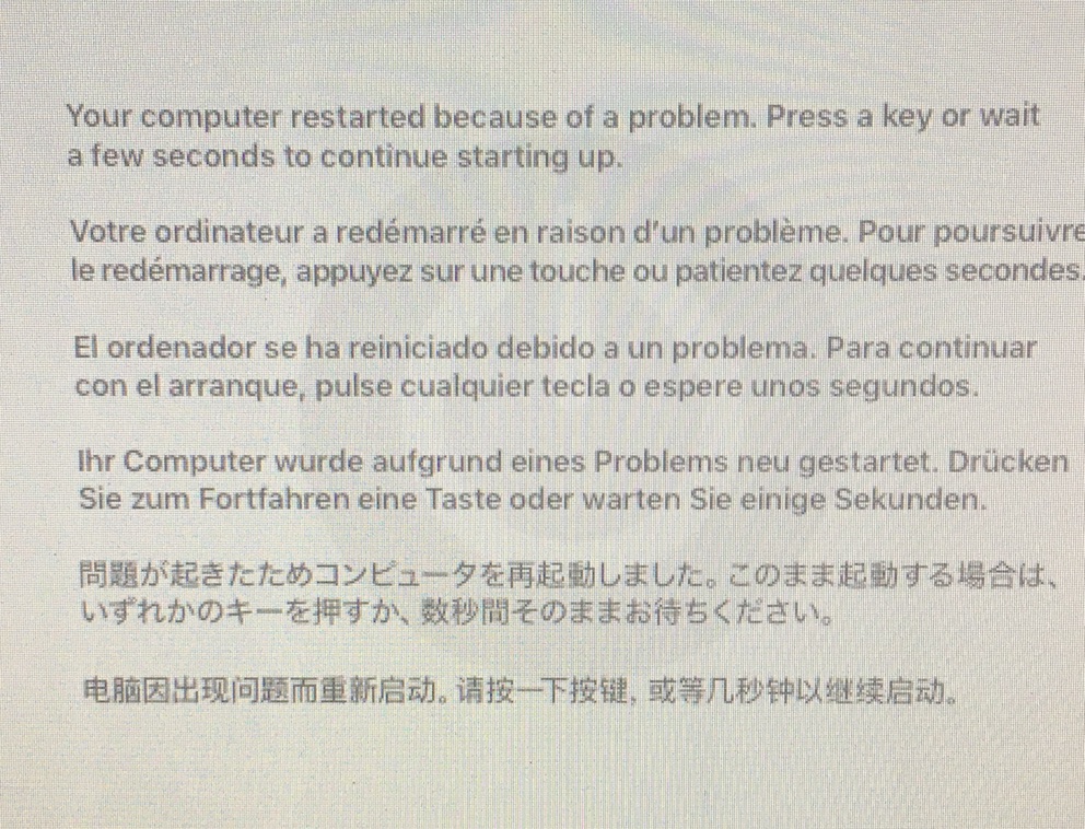

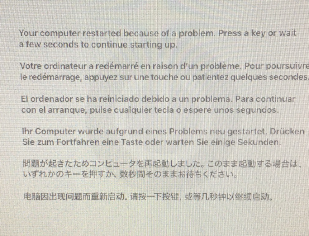

Hope this is useful for Core2Duo and Mac Pro 3,1 users. I'm focusing on what is causing this kernel panic in the full OS.

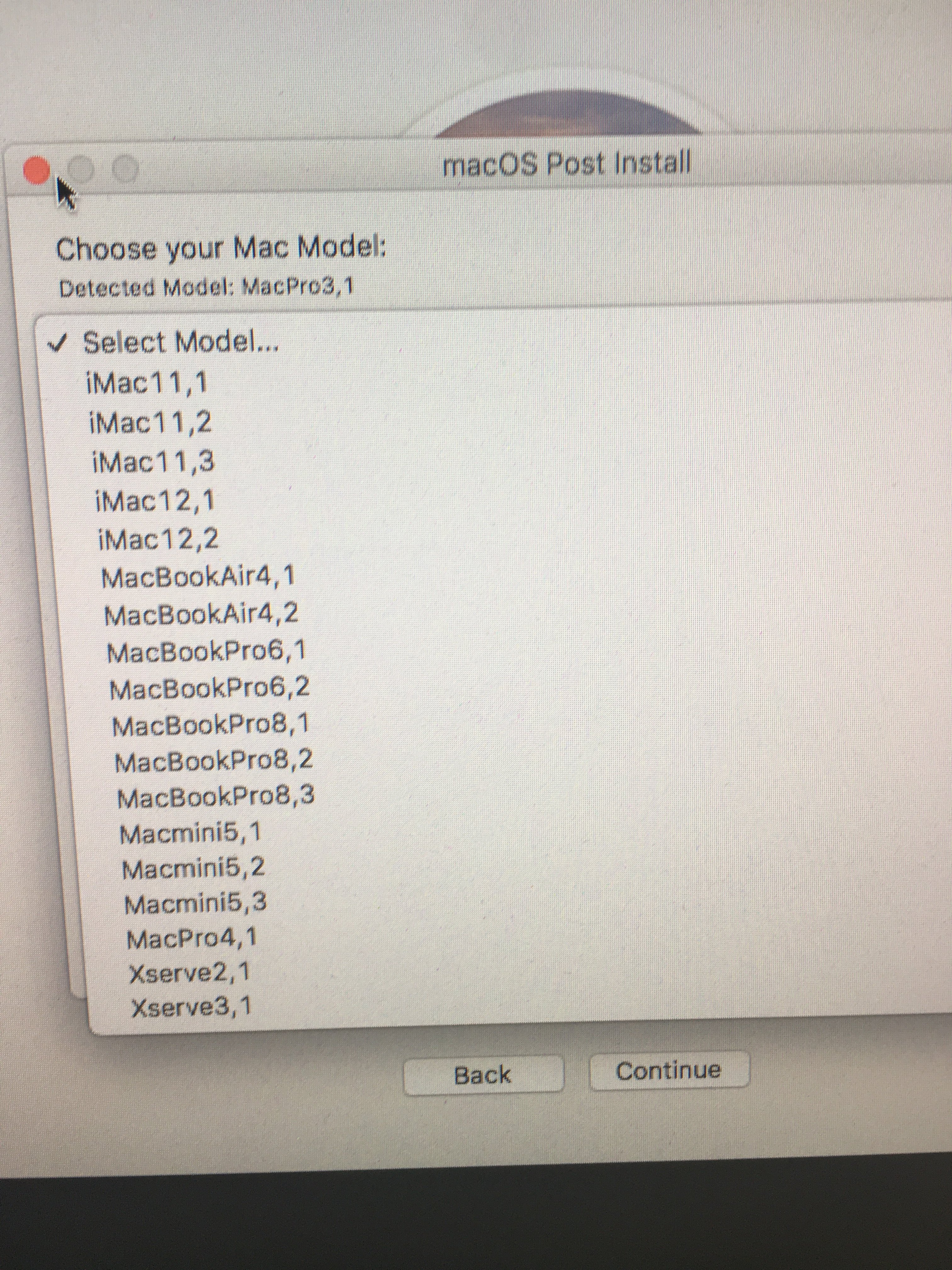

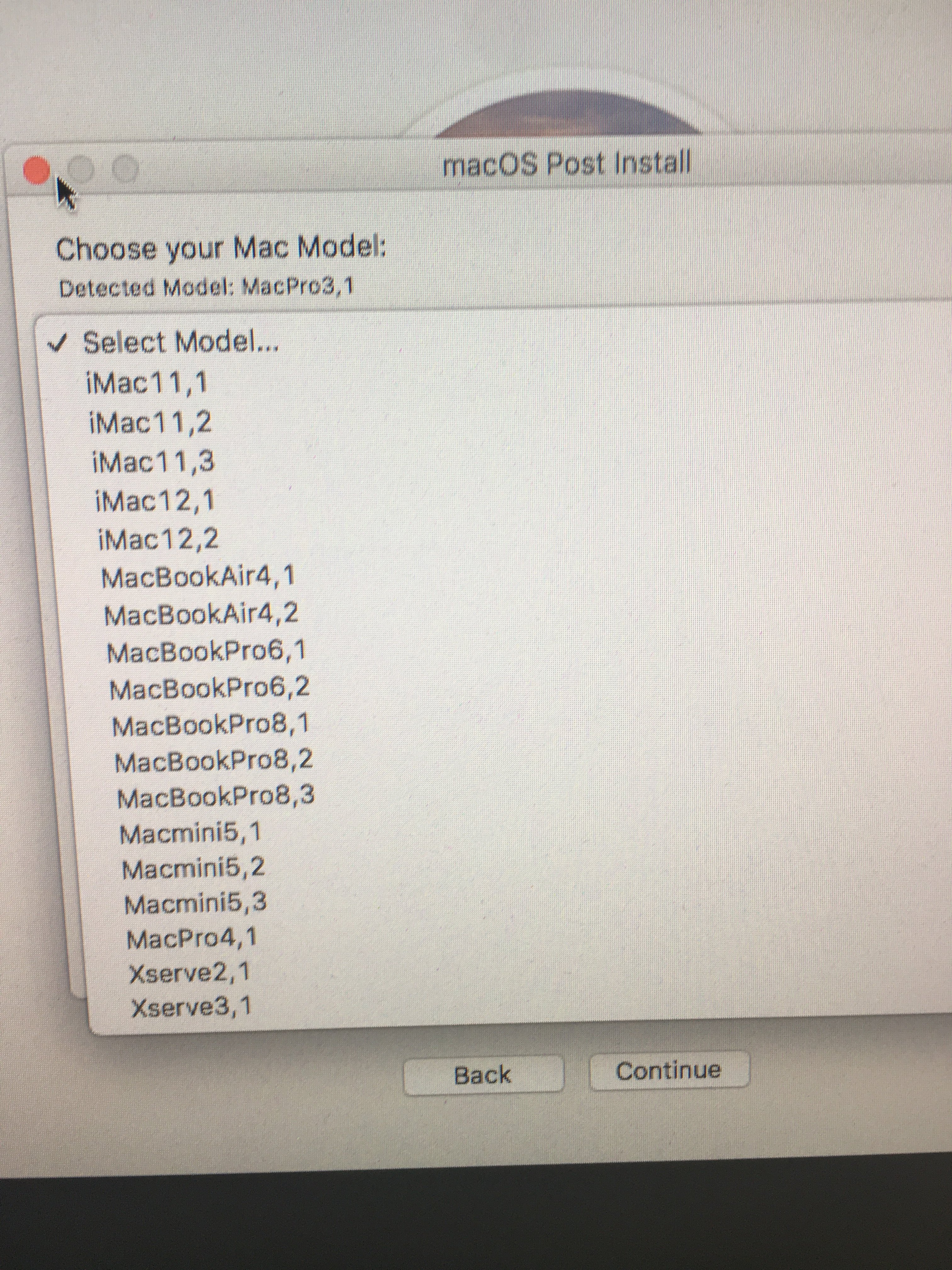

Using the prelinked Kernel (15,381,852 bytes) on beta2 on Mac Pro 3,1, I was able to get a Kernel Panic log to output. It does not always save a log when there is a Kernel Panic. In this panic log it appears to be the com.apple.driver.AudioAUUC. It is the last loaded Kext:
This is using Dosdude1's installer, just the -no_compat_check flag is set.
Standard EFI, no clover or no other patchers or anything like that. I've removed clover from my system.
I am watching it verbosely using Cmd-V at startup. It appears to load the EFI correctly in the display then boots up, then panics right before 2nd stage. (Arrow with gray screen)
Another thing that could be a problem is Apple has VirtualBox.kexts which should not be needed in a standard install unless Apple is using it for iOS Support? I am not sure, they are loaded right before the AudioAUUC.

*** Panic Report ***
panic(cpu 0 caller 0xffffff7f856595fb): NVRM[0/2:0:0]: Read Error 0x00000144: CFG 0xffffffff 0xffffffff 0xffffffff, BAR0 0x92000000 0xffffff9625a2d000 0x120020a1, D0, P0/4
Code:
Anonymous UUID:       2AC57058-4428-12D6-F1BA-EACD4953AB91
Wed Jun 27 17:37:07 2018
Backtrace (CPU 0), Frame : Return Address
0xffffff83ec9318e0 : 0xffffff8004c6d166
0xffffff83ec931930 : 0xffffff8004d95824
0xffffff83ec931970 : 0xffffff8004d87b10
0xffffff83ec9319f0 : 0xffffff8004c1f180
0xffffff83ec931a10 : 0xffffff8004c6cbdc
0xffffff83ec931b40 : 0xffffff8004c6c99c
0xffffff83ec931ba0 : 0xffffff7f856595fb
0xffffff83ec931c20 : 0xffffff7f8574b234
0xffffff83ec931c80 : 0xffffff7f85dc580f
0xffffff83ec931cb0 : 0xffffff7f8565ffd5
0xffffff83ec931e80 : 0xffffff7f85601213
0xffffff83ec931ea0 : 0xffffff800529d860
0xffffff83ec931ee0 : 0xffffff7f85552a8e
0xffffff83ec931f30 : 0xffffff7f87e2da9a
0xffffff83ec931f50 : 0xffffff7f87e3696d
0xffffff83ec931f70 : 0xffffff8004d87331
0xffffff83ec931fd0 : 0xffffff8004c1f336
0xffffff8420cdbf30 : 0xffffff8004c8b442
0xffffff8420cdbf80 : 0xffffff8004c8ba10
0xffffff8420cdbfa0 : 0xffffff8004c1e4f7
      Kernel Extensions in backtrace:
         com.apple.iokit.IOPCIFamily(2.9)[1057F053-73DE-33E4-B5BE-09DA28715DB4]@0xffffff7f85534000->0xffffff7f85568fff
         com.apple.driver.AppleACPIPlatform(6.1)[577DDA65-E8D0-3357-8FBB-20E69AB66086]@0xffffff7f87e26000->0xffffff7f87ec1fff
            dependency: com.apple.iokit.IOACPIFamily(1.4)[95DA39BB-7C39-3742-A2E5-86C555E21D67]@0xffffff7f863cc000
            dependency: com.apple.iokit.IOPCIFamily(2.9)[1057F053-73DE-33E4-B5BE-09DA28715DB4]@0xffffff7f85534000
            dependency: com.apple.driver.AppleSMC(3.1.9)[DA4DC28A-5818-3F23-AFDC-ADC8F4A93CFA]@0xffffff7f863d5000
         com.nvidia.web.NVDAResmanWeb(10.3.1)[9E5331D7-2B37-394B-97C7-3C5B54B7C367]@0xffffff7f855fa000->0xffffff7f85c72fff
            dependency: com.apple.iokit.IONDRVSupport(519.19)[3B9AF334-51BC-3DCC-95B2-DC7386BB16FF]@0xffffff7f855df000
            dependency: com.apple.iokit.IOGraphicsFamily(519.19)[0B3857C5-9040-3A0C-BFB4-C45E56DB01C6]@0xffffff7f85589000
            dependency: com.apple.AppleGraphicsDeviceControl(3.18.52)[FC5E4CD4-7730-3A55-9CC5-338A64F50E42]@0xffffff7f855ef000
         com.nvidia.web.NVDAGM100HalWeb(10.3.1)[16BD04F0-8B47-3565-B416-680CAD199D22]@0xffffff7f85c89000->0xffffff7f85e2cfff
            dependency: com.nvidia.web.NVDAResmanWeb(10.3.1)[9E5331D7-2B37-394B-97C7-3C5B54B7C367]@0xffffff7f855fa000
BSD process name corresponding to current thread: kernel_task
Boot args: -no_compat_check
Mac OS version:
17F77
Kernel version:
Darwin Kernel Version 17.6.0: Tue May  8 15:22:16 PDT 2018; root:xnu-4570.61.1~1/RELEASE_X86_64
Kernel UUID: CC1699EE-71B5-3AF1-AAA3-6DBD16222B92
Kernel slide:     0x0000000004a00000
Kernel text base: 0xffffff8004c00000
__HIB  text base: 0xffffff8004b00000
System model name: MacPro3,1 (Mac-F42C88C8)
System uptime in nanoseconds: 542831124174
last loaded kext at 14746517647: com.apple.driver.AudioAUUC    1.70 (addr 0xffffff7f87605000, size 32768)

Can you try booting with an AMD video card installed? I think I've possibly narrowed the issue down to having an nVidia GPU installed on these older systems, and nobody has tested one that does NOT have an nVidia GPU.
Experimented with my MacBook Pro install and a Mac mini 3,1 2Ghz intel C2Duo Early 2009 Nvidia GeForce 9400. A Firewire 800 install to Mac mini via Target Disk. Completed install and Recovery Disk. I selected Mac mini 5,1 from the Post Install menu even though it's a 3,1 and the patcher recognized the MacBook Pro, not the mini. Booting into Mojave on the Mac mini yields gray "no go" circle. Booting into Recovery Disk 10.14 completes but no USB or Bluetooth mouse or keyboard to move the cursor. Ran Post Install 10.4 without "Legacy USB" support and no difference. Ran High Sierra Post Install with "Legacy USB" support and no difference. Oddly, the Sierra patcher USB partition on the thumb drive would not appear so I couldn't try anything with that. Sure got me excited to see the 10.4 Recovery Disk boot up. This Mac mini runs Sierra and High Sierra without a hitch thanks to the patchers.

My 3,1 with boot-rom patch running HS 10.13.6 beta 4 currently has an nVidia GTX 680 but I could swap it for an HD6870 to test a Mojave install on an SSD. Any special Mojave installer? Or will the latest one suffice?
Would this be useful.

First problem, the MP3,1 is not in the post-install list. Looks like the post-install patch needs modifying.
When the post-install includes the MP3,1, I'll run the patch.

MP3,1 with latest Mojave patcher applied to clean SSD with Mac-efi flashed AMD HD6870 installed to test. Post-install patches applied manually because no MP3,1 in list.
Boot progress bar gets 2/3rds across and KPs.
Boot progress bar gets 2/3rds across and KPs.View attachment 768051
Darn. Back to the drawing board with this KP issue I guess... Can't be MCP chipset causing it, can't be GPU... The ONLY thing that would make even the slightest bit of sense is that SOMETHING in the system relies on SSE4.2 instructions, as the lack of SSE4.2 support is the only thing in common with the Mac Pro 3,1 and the Penryn Core 2 Duo-based machines.
