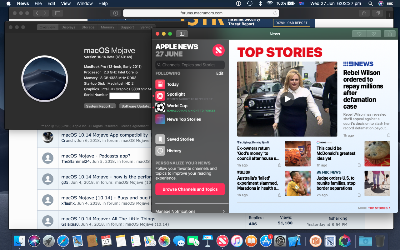

I downloaded Mojave beta 2 and used dosdude1 patch and everything is working perfectly on early 2011 MacBook pro 13" including the new apps such as news, stocks and voice memos. can't see any reason why apple didn't support 2011 macs other than them wanting people to buy newer hardware which they don't actually have any MacBook pros that are worth buying.View attachment 767920
