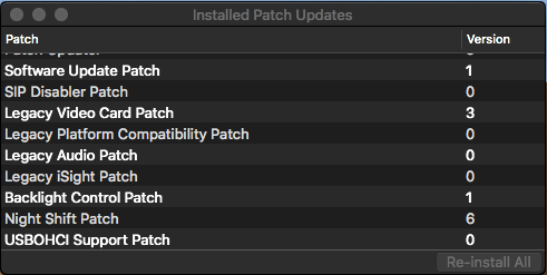

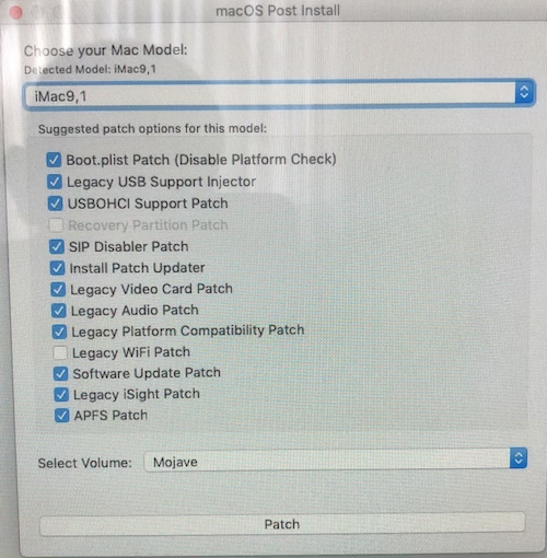

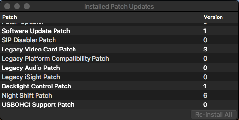

@dosdude1 could you please explain what is wrong this patch "Backlight Control Patch" Last night I tried to re-install one by one all the patches for test and when I tried to re-install this patch machine never boot and starts looping. Why this happening?
Also, I realize something there is no Backlight Control Patch on the Post Installation stage for iMac 9,1;
Also, USBOHCI Support Patch looks like patching on the Post Installation Stage but when we are boot the system it doesnt show on the Patch Updater and your new Verify Pacth Integrity doesnt find it.
That seems to happen on some machine, for some odd reason. I thought it was due to AMD GPUs initially, but now I'm not sure. I may just remove this patch until I figure it out (however, I have been unable to replicate the issue on any of my machines).

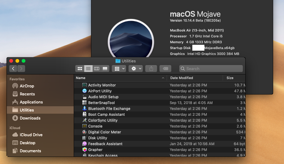

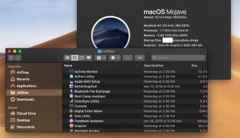

Alright, got everything figured out! To get acceleration working under 10.14.4 with a non-Metal GPU, just download this archive, extract it, cd into the extracted directory using Terminal, and then run ./install.sh. Please ensure you have the Legacy Video Card Patch installed properly (you can re-apply it with the post-install patch, or re-install it using Patch Updater after running the script just to be sure). After rebooting, you should now have full graphics acceleration!
I believe I got full graphics acceleration now thanks to @dosdude1 on my 10.14.4 developer beta 4 version.
I just had to run the graphics acceleration patch script above to my already booting MBA. Did not have to re-install.
As always, awesome work @dosdude1 !
