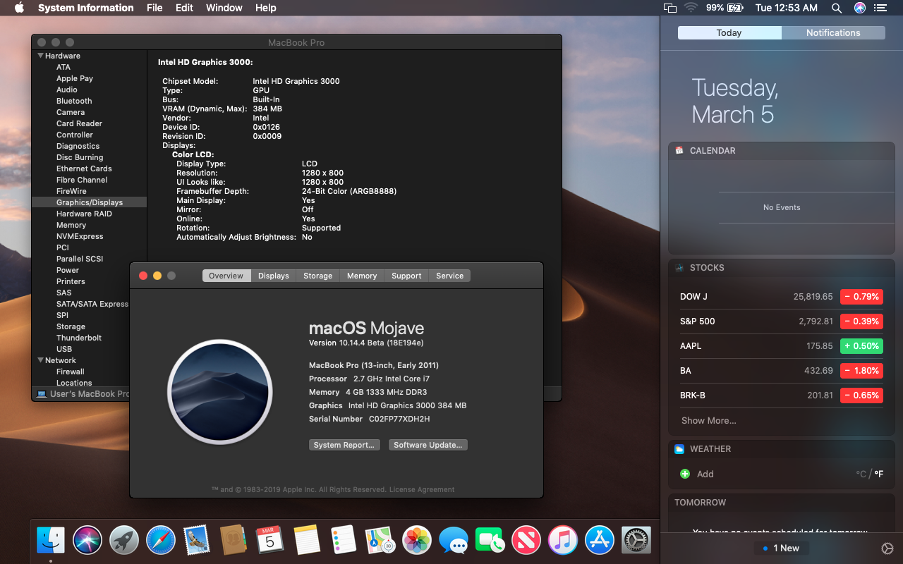

The update on my supported machine (MBP 2012) to 10.14.4 developer beta 4 showed the firmware progress bar again.
I’ll stick to 10.14.3 on my unsupported Mac for a little longer, I think.

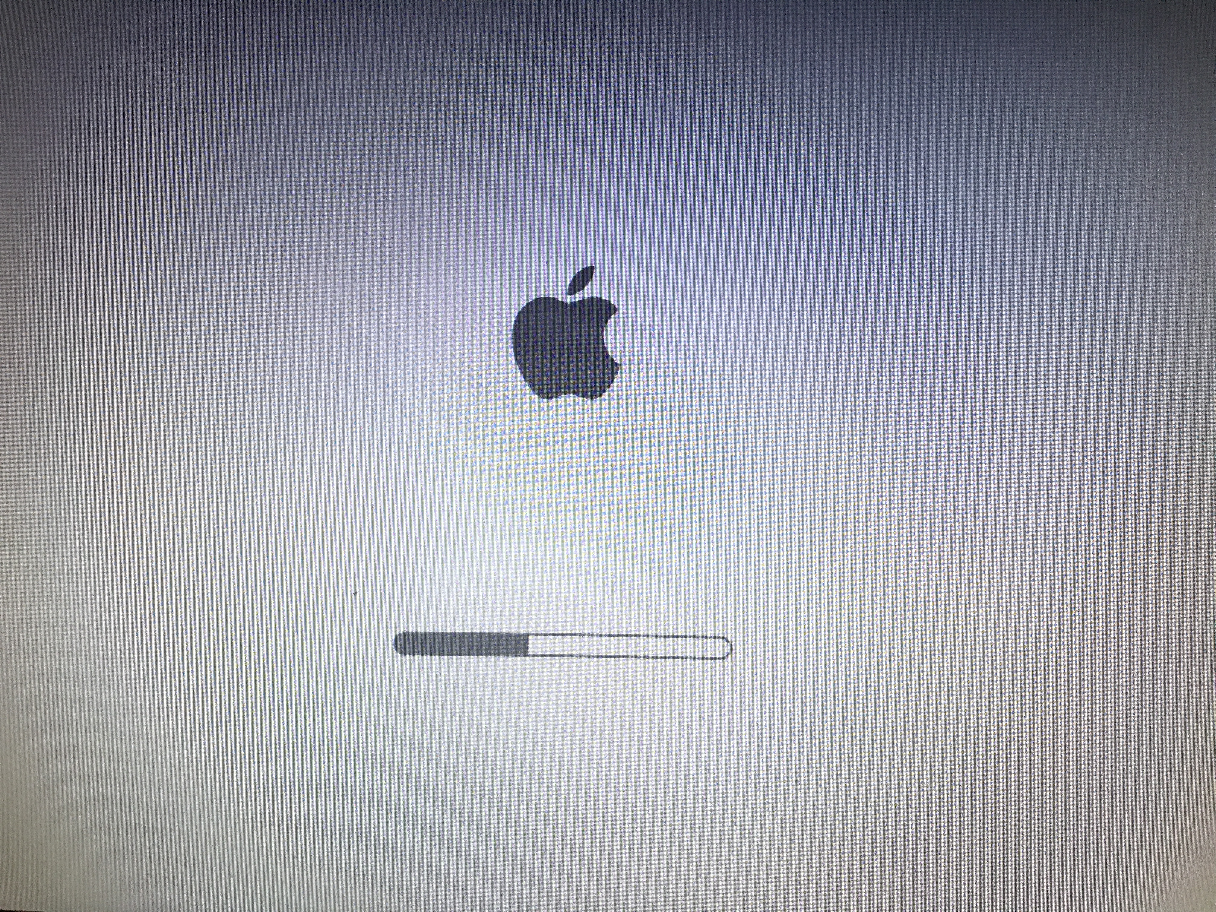

Proper sequence:
- update OTA from 10.14.3 to 10.14.4 b4
- let machine reboot but boot to patcher/install USB stick
- re-patch everything
- reboot and wait for progress bar freeze with white spinning symbol
- reboot but go to cmd-s (single user)
- delete your OpenGL driver (according to dosdude1 findings)
- reboot to the Finder
- let dosdude1´s script do the work (or do it manually and fix file attributes/permissions)
- run patch updater and re-install all patches (if patch updater itself has an update, accept that before patching, too)
- reboot
- success / accelerated GPU

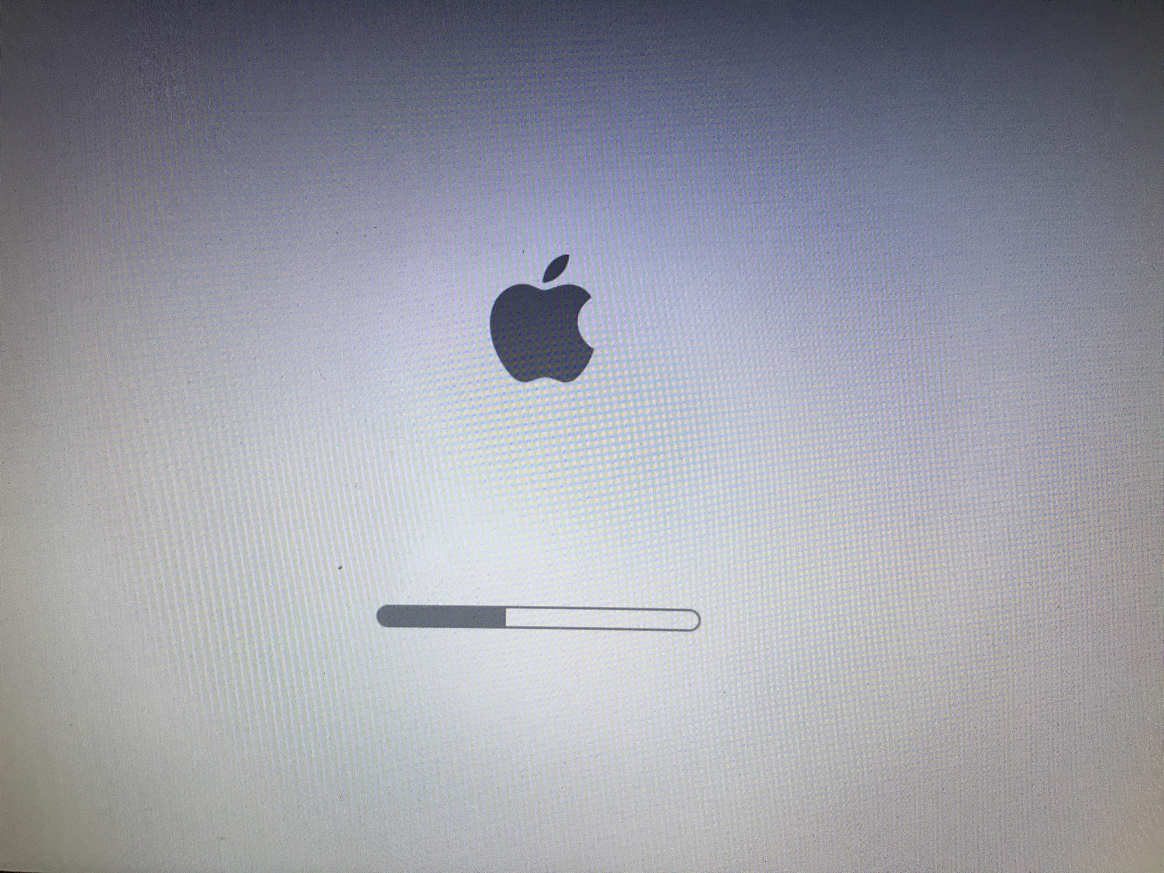

Hi Collin, I'm using a Mac Pro 3,1. It was running El Capitan, but I'm a heavy Adobe user, so needed to update for the latest batch of Creative Cloud updates to install. It has an Nvida Fermi Quadro 4000 for Mac video card installed, and 16 GB of RAM. Booting off a SSD in an OWC PCI card. Followed directions to the letter, but, now I have a system that will only boot a short way, then I get an error message, that the system has encountered an error. If you hit a key, it will start to load, about 1/4-inch on the bar, then shut down with a black screen. It wouldn't allow me to boot into the recovery volume, so I rebooted to my USB drive, selected the Patch the Recovery option, and it now allows me to boot into it. I've also used the option for Legacy Video Card in the Post Install Tool.
But it still won't boot past that 1/4 inch into the progress bar. There doesn't seem to be any FAQ or explanation of what the legacy patch tool options do, or when to use them. So, any help would be great. I'm wondering if the issue is the OWC Accelsior S card (https://eshop.macsales.com/item/OWC/SSDACL6G.S/)? I'm assuming that since the system will boot off the USB drive, that things like the video card, RAM, etc. all are working fine, so whatever is happening, happens almost immediately. I've been unplugging external drives, etc., to rule that out.
I read the note about the archive, but not quite sure how to install, but will give it a whirl. Love a short video tutorial.
You will need to apply the legacy video patch for any non-Metal card like the Nvidia Fermi Quadro 4000. If you have a backup of your previous El Captain volume, your best bet is to reformat the current system SSD as APFS and install patched Mojave 10.14.3 with migration from the backup volume for your other files.

I am far from an expert, and have had no luck getting 10.14.4 to work on my non metal devices. Is there an easy way or a script to do this. I have tried at least 5 times no luck.
Thanks. Ok, a bit of an update. More to come later. After numerous tries, installing Mojave as an update to the existing El Cap system, but ending up with a computer that crashed at startup, and reinstalling, etc. to no avail, I tried a different tack. I installed an empty drive in one of the bays of my MacPro 3,1 formatted and partitioned it, installed Mojave on it. And voila, it booted fine, the Nvidia Quadro Fermi 4000 card worked fine, and all was well. That was until I used Migration Assistant to transfer data, settings, etc.. and upon restart, same error and crash at Startup.
So, I installed again, used Migration Assistant to only transfer settings and users, and all is well. I don't know if there is a way to tell if Graphics Acceleration is working. It seems that the problem is with something in my existing system that is crashing the system. The challenge is how to transfer over data and apps on a selective basis. The moral is, as it always has been, start with a clean install.

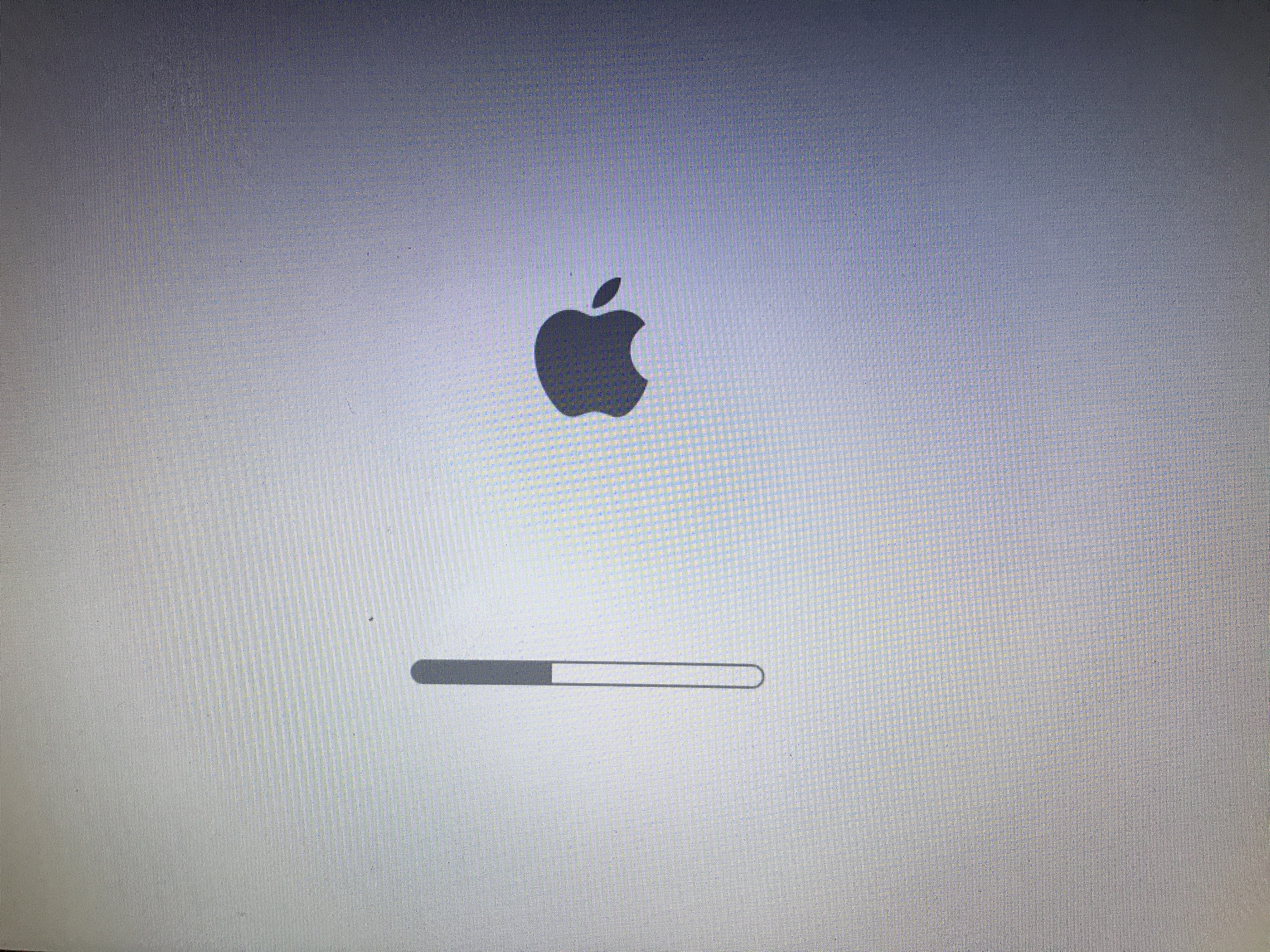

Alright, got everything figured out! To get acceleration working under 10.14.4 with a non-Metal GPU, just download this archive, extract it, cd into the extracted directory using Terminal, and then run ./install.sh. Please ensure you have the Legacy Video Card Patch installed properly (you can re-apply it with the post-install patch, or re-install it using Patch Updater after running the script just to be sure). After rebooting, you should now have full graphics acceleration!

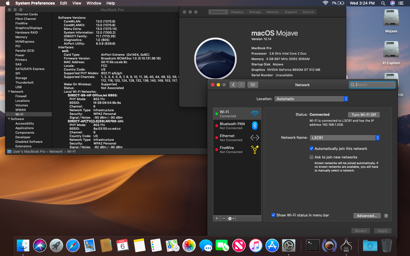

Well, I need to give a HUGE thanks to @parrotgeek1, who figured out this amazing solution... Broadcom BCM94321 WiFi cards are now WORKING under Mojave! If you'd like to test, just download the attached ZIP, extract it, cd into the extracted directory using Terminal, and then run ./install.sh. This should get WiFi working on ALL machines with BCM94321 WiFi chipsets, including the MacMini3,1, MacBookAir2,1, MacBookPro4,1, iMac8,1, and more. Please post results!
