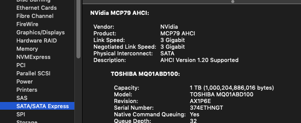

It's not the NVIDIA Graphics that he's talking about, it's the SATA/SATA Express chipset. See Pic. Mine shows the version he's talking about and shouldn't try the patch.

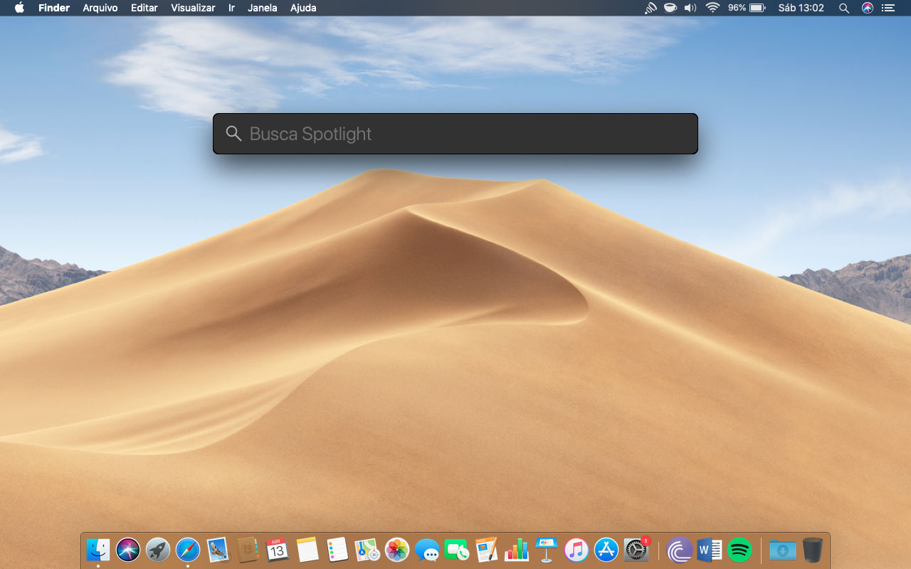

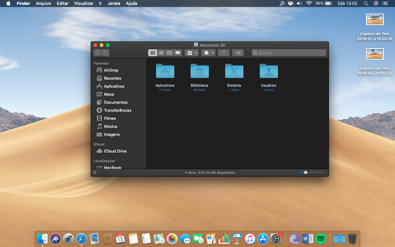

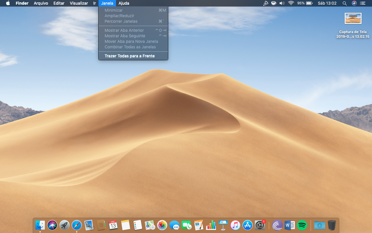

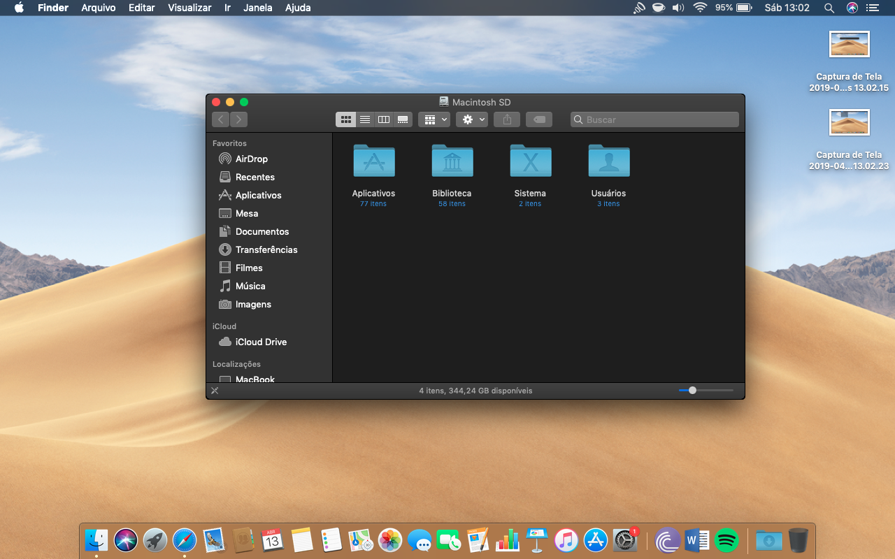

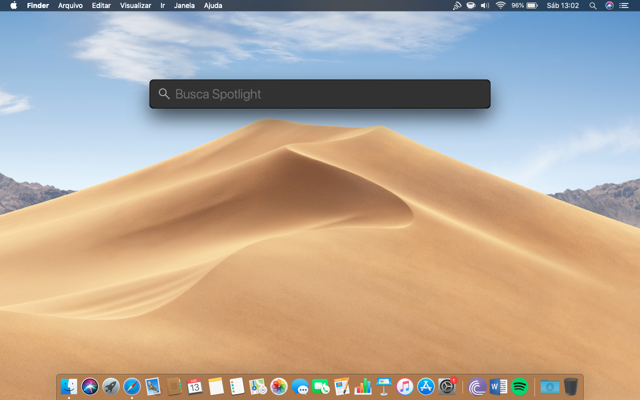

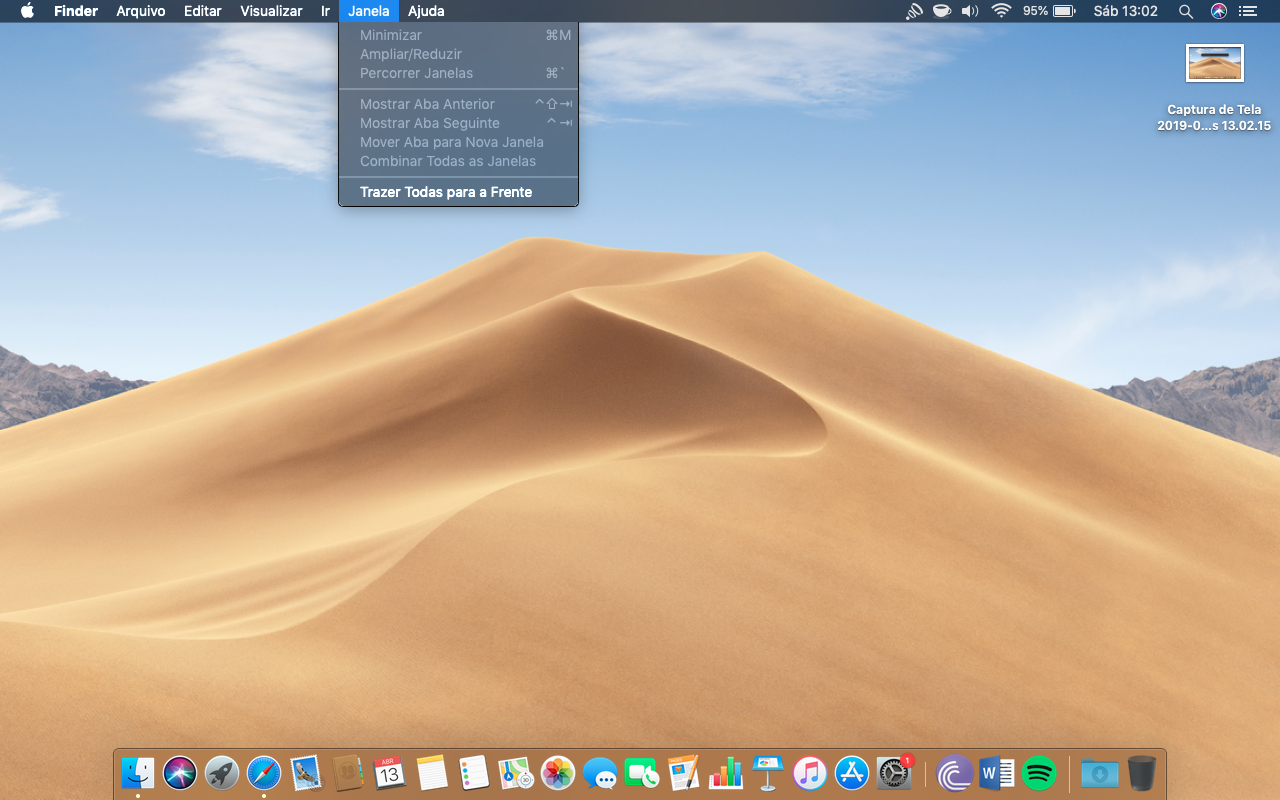

These artifacts in Intel Graphics / GeForce 320m do not bother me so much because I use the dark mode.
The @pkouame solution only uses AppKit removed from the Flat package, so I keep the menus transparent and something solid, with a bit of transparency in some parts of the system, much better than using no solution.

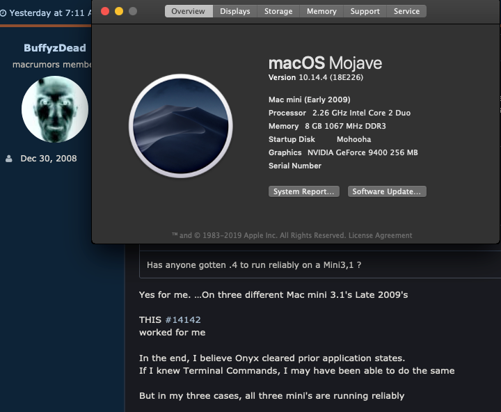

THIS #14142
worked for me
[doublepost=1555078796][/doublepost]

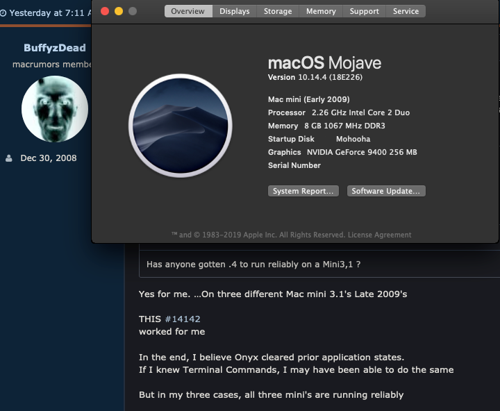

Yes for me. …On three different Mac mini 3.1's Late 2009's
THIS #14142
worked for me
In the end, I believe Onyx cleared prior application states.
If I knew Terminal Commands, I may have been able to do the same
But in my three cases, all three mini's are running reliably

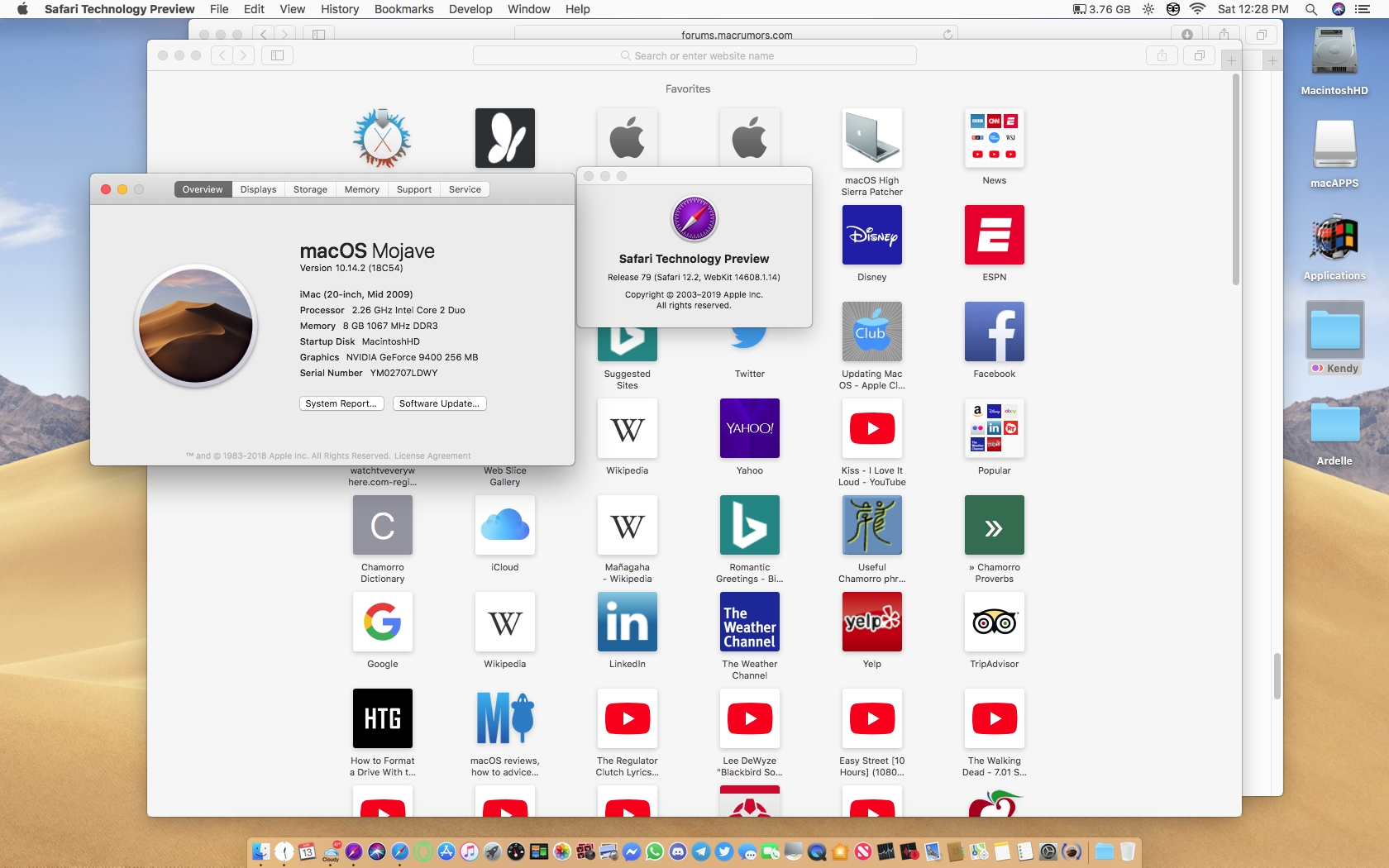

I actually downloaded Tech Preview 12.2 from the links posted by webg3 above, but it refuses to open it on 10.14.3. Plist file might need adjustment, I am not sure where though.

[doublepost=1555184396][/doublepost]I am really enjoy 10.14.4 on my MacBook I thought it was the 5,1 model but used this neat little app and found out it is the 5,2 model have full acceleration and the newest hybrid patches work great
