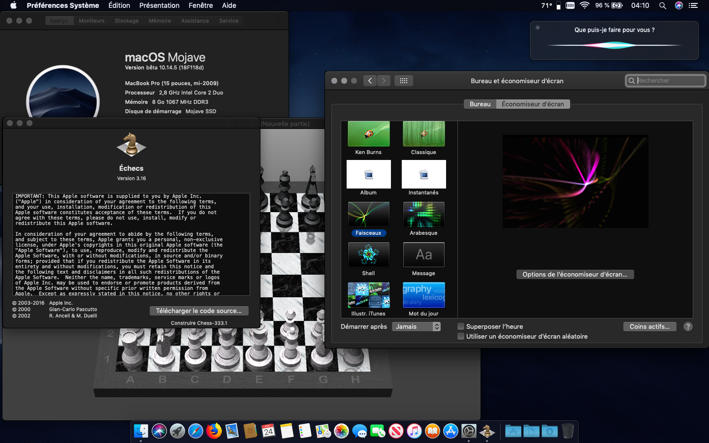

System: MBP5,2 17", SSD with APFS, APFS ROM patch applied.
System running well with 10.14.5b2.
Thanks to RogueB for the instructions, and worth repeating what he said: All credit, and thanks, to @dosdude1, @jackluke, @ASentientBot, @pkouame and many others (in no particular order) for their amazing work and perseverance!
To start, cloned stable 10.14.3 to an external SSD (with CCC). 9600M GT GPU selected all the time.
- installed 10.14.4 over this with dosdude's patcher 1.3.0, applied post-install patches, no extra patch updater patches proposed
- updated to 10.14.5b2 OTA, applied 1.3.0 post-install patches again (and rebuilt caches)
- in single-user mode moved .4 CoreDisplay.framework to /System/Library/Frameworks (before, /sbin/mount -uw /). Used the framework attached to post #14339
- booted fine. Rebuilt caches with sudo kextcache -system-caches; sudo kextcache -system-prelinked-kernel (wasn't sure if needed)
The SSD with 10.14.5b2 is now on SATA and being used as my standard system. Fingers still crossed...
Experience so far:
- stable running for a day using the 9600M GT GPU.
- then switched to 9400M, went well for several hours then a KP in Mail. Was difficult to switch back to 9600M GT because of frequent KPs, but eventually succeeded and running fine again with 9600M GT.
- started to use Safari at this point which had caused KPs in 10.14.4. Fine so far for a few hours, so this is better in 10.14.5b2.
After some running I'll retry everything with the .3 CoreDisplay.framework, to see how 9400M behaves then. Apart from having a stable-enough beta system the thrill of experimenting is also valuable.
Thanks again!View attachment 833340

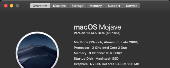

MBP5,2 still on 10.14.5b2, to test 9400M while using .3 CoreDisplay.framework.
System running with 9600M GT.
In single user mode replaced the .4 CoreDisplay.framework in /System/Library/Frameworks with the .3 one.
Rebooted, in Terminal sudo kextcache -system-caches and -system-prelinked-kernel (maybe unnecessarily), rebooted again.
Running fine, then switched to 9400M (see remarks below), rebooted.
Still running fine with 9400M after a while, trying to push it into a KP...
BTW no problems with backlight control etc with either .3 or .4 CoreDisplay.framework.
Remarks on switching GPU:
- although About This Mac and Systen Setting indicate the GPU switching was done, my feeling is that it takes permanent effect, i.e. for next reboot, only after an ordinary shutdown.
- I guess the GPU setting is stored in NVRAM or elsewhere on the main board. Indication is that resetting the NVRAM brings the system into 9400M mode always. And even running from a different disk to switch to 9600M GT mode (had to do that in 10.14.4 from a 10.14.3 disk, otherwise KPs happened too soon to switch) made the switch effective for the next boot from the standard disk.
- one more observation with 9400M during booting: the "white" phase with the progress bar doesn't show, instead after some time or even only after pushing power briefly, the "black" phase starts and boot proceeds OK. Was like this already in 10.14.4, but OK in 10.14.3. That indicates that something is strange with 9400M in 10.14.4 and .5b2 at least during boot, for MBP5,2.
Still no KP with 9400M and .3 CoreDisplay.framework. I'll report if one happens.
EDIT: KP happened as expected - and desired: can proceed to 10.14.5 PB3 now. Switched to 9600M GT for this.
Cool. Yes, the gpu switching is not real-time - one needs to restart for it to take effect. I don't know about gfxCardStatus.app , maybe it enables dynamic switching.
So far, my experience with .5b3 is similar.

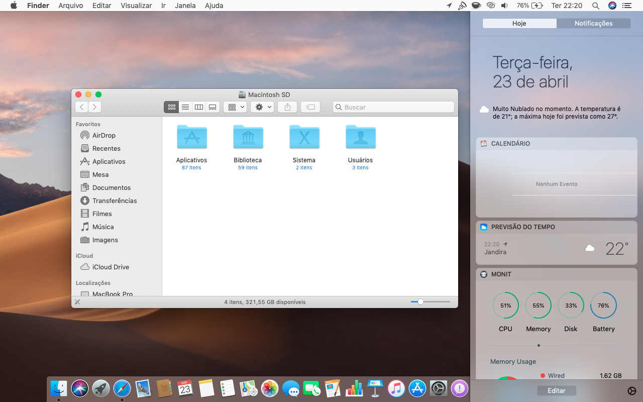

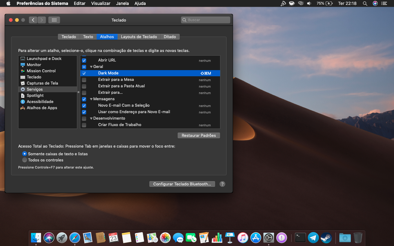

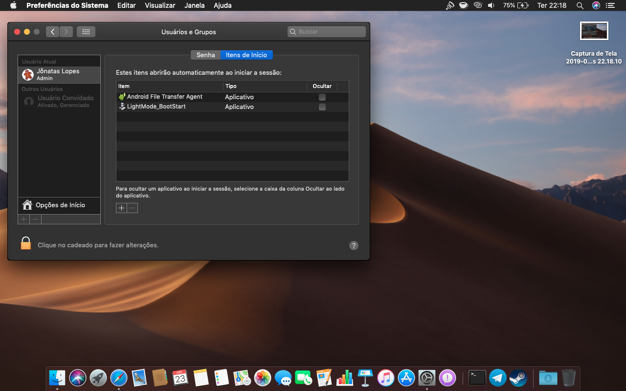

[doublepost=1556068750][/doublepost]My workaround is still working.
Who wants to use, is here:
[doublepost=1556068850][/doublepost]

I finally managed to update to 10.14.5 Beta 3.
1- I redid a clone of my system 10.14.4 SSD
2- I updated this clone (external SSD) to 10.14.5 Beta 3 with Pacifist.
3- I replaced "CoreDisplay"
4- I re-applied the patches with "macOS Post Install.app" 1.3.0 and force rebuild cache
5- After the correct boot (this time) I re-installed the patches with "Patch Updater.app"
EVERYTHING works fine, I have the Siri waveform, Chess 3.16 and Flurry screensaver
