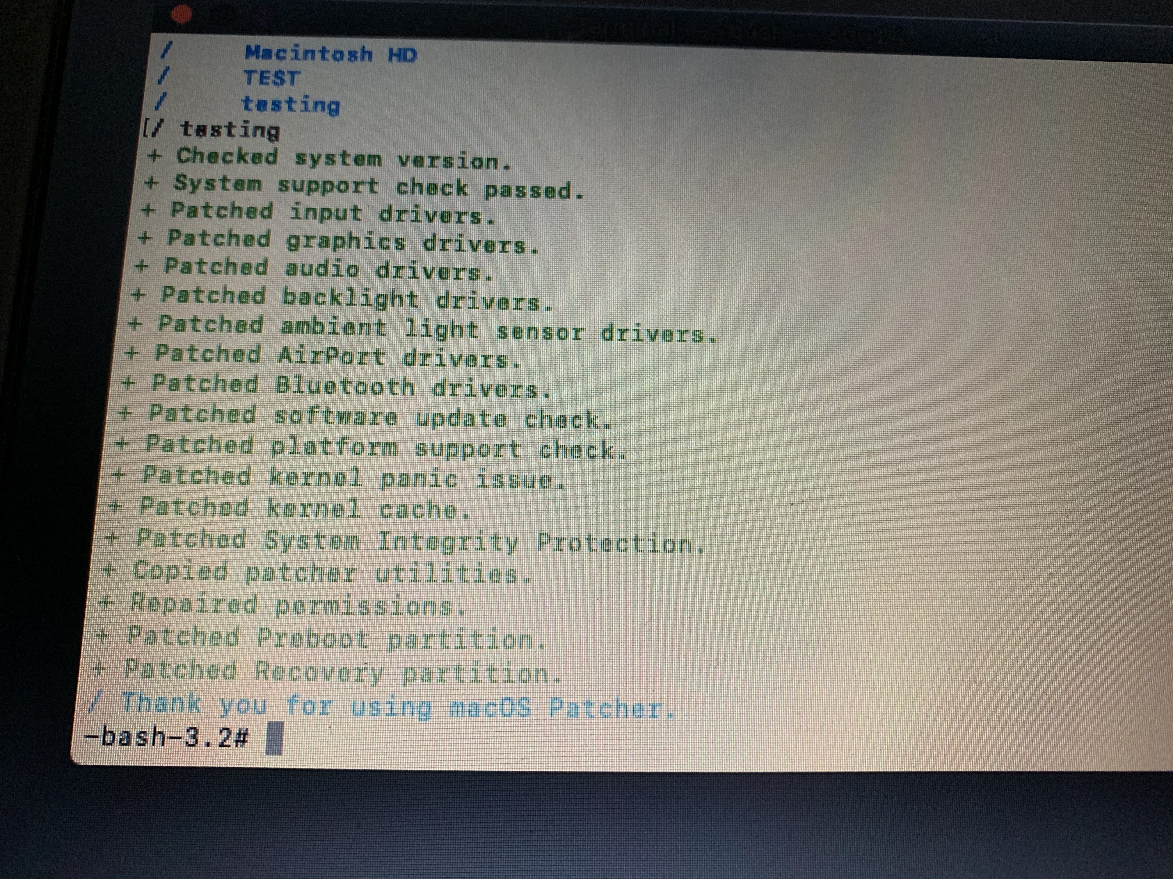

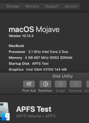

it is not working on APFS patch.

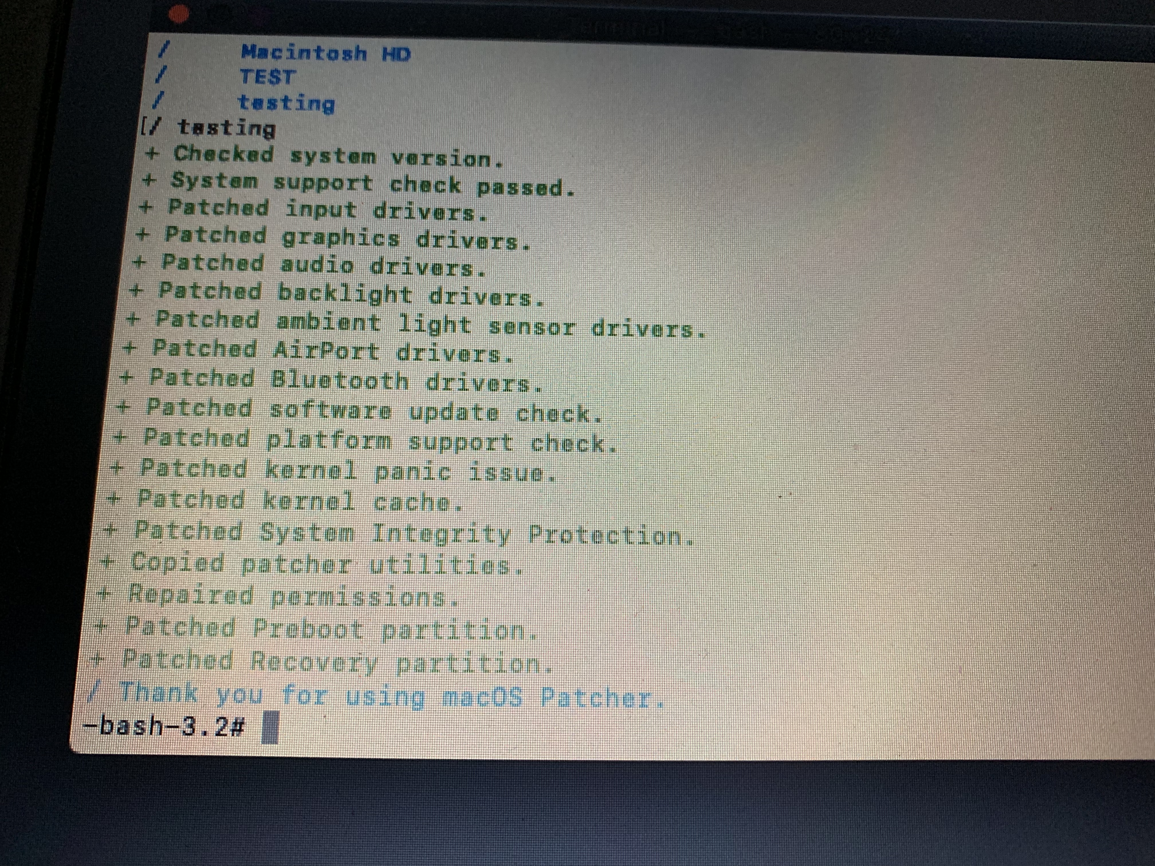

I boot into the installer and run terminal to patch the OS. after the patch finished, it doesn't run APFS patch. when compare with last version
You mean it doesn’t ask you to install the apfs patch? Make sure your drive is an apfs drive.
yes, 100% sure it is APFS and it doesn't ask me to install the APFS Patch
I am going to repartition and install the OS again. Let me try again and let you know the result.

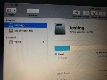

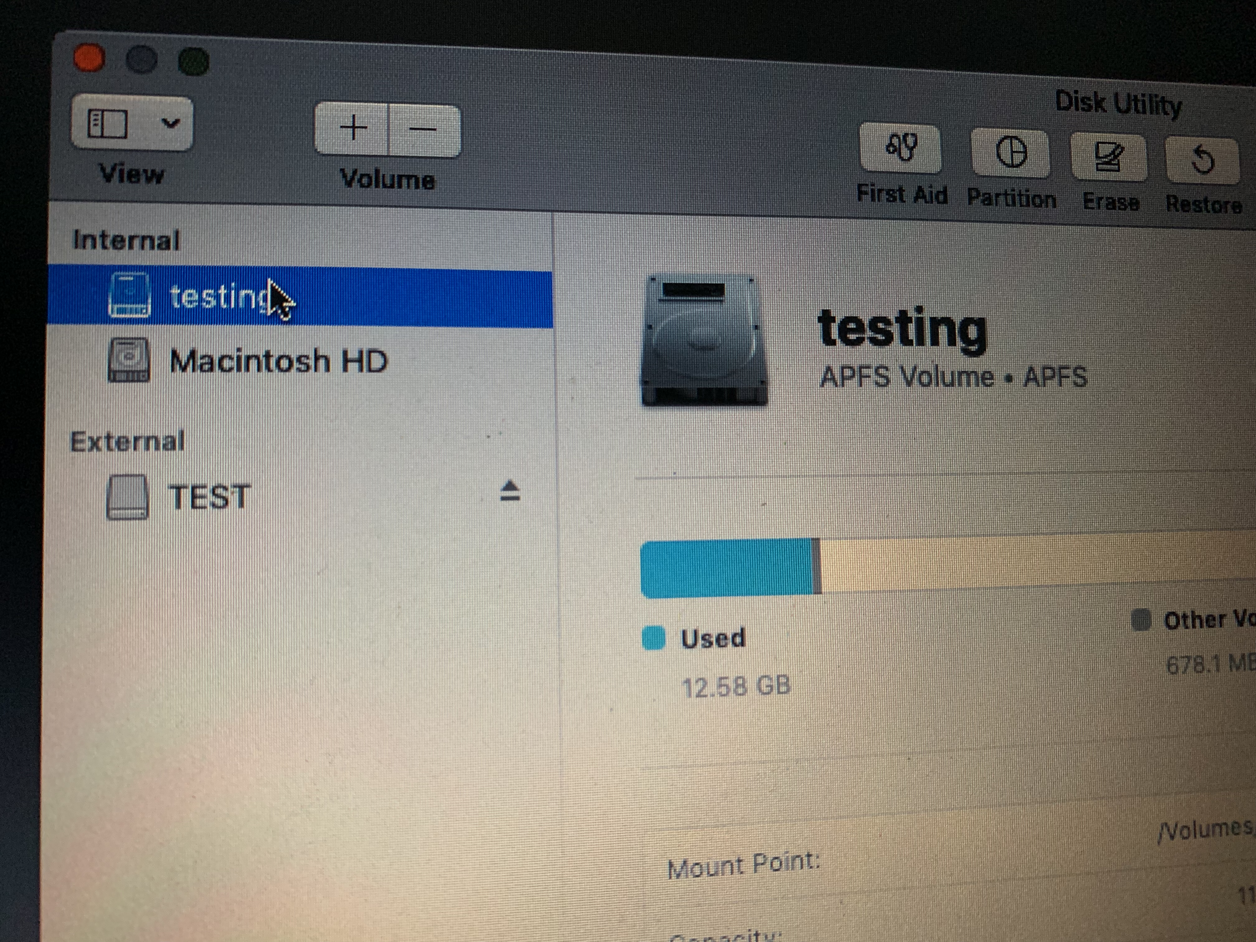

The issue is that you already installed the apfs patch on the drive. It’s done on a per hard drive basis instead of per drive. I could walk you through removing it manually or I could simply remove the check.
how to remove it? i can make it after os installation.
Run diskutil list and copy the disk indentifier (diskXsX) for your edit partition. Then run these commands.
Code:
diskutil mount (your efi indentifer here)
rm /Volumes/EFI/EFI/apfs.efi
rm /Volumes/EFI/EFI/BOOT

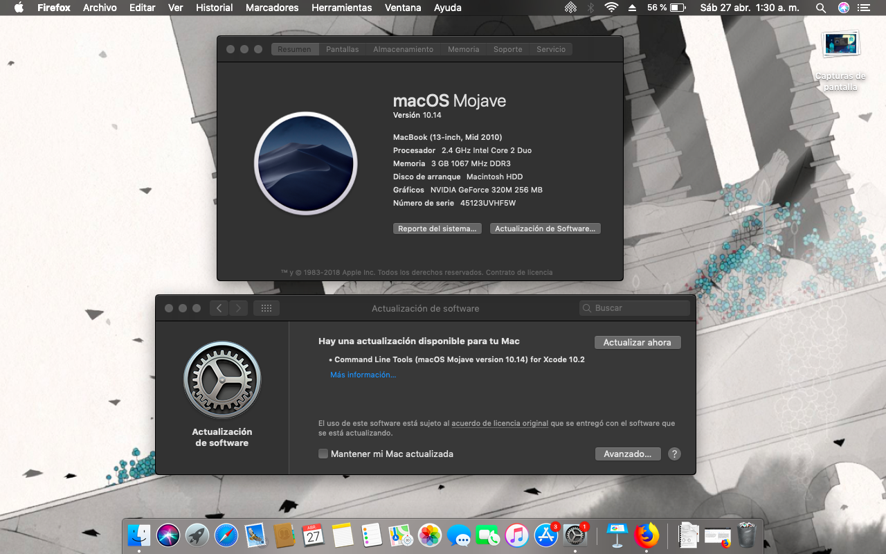

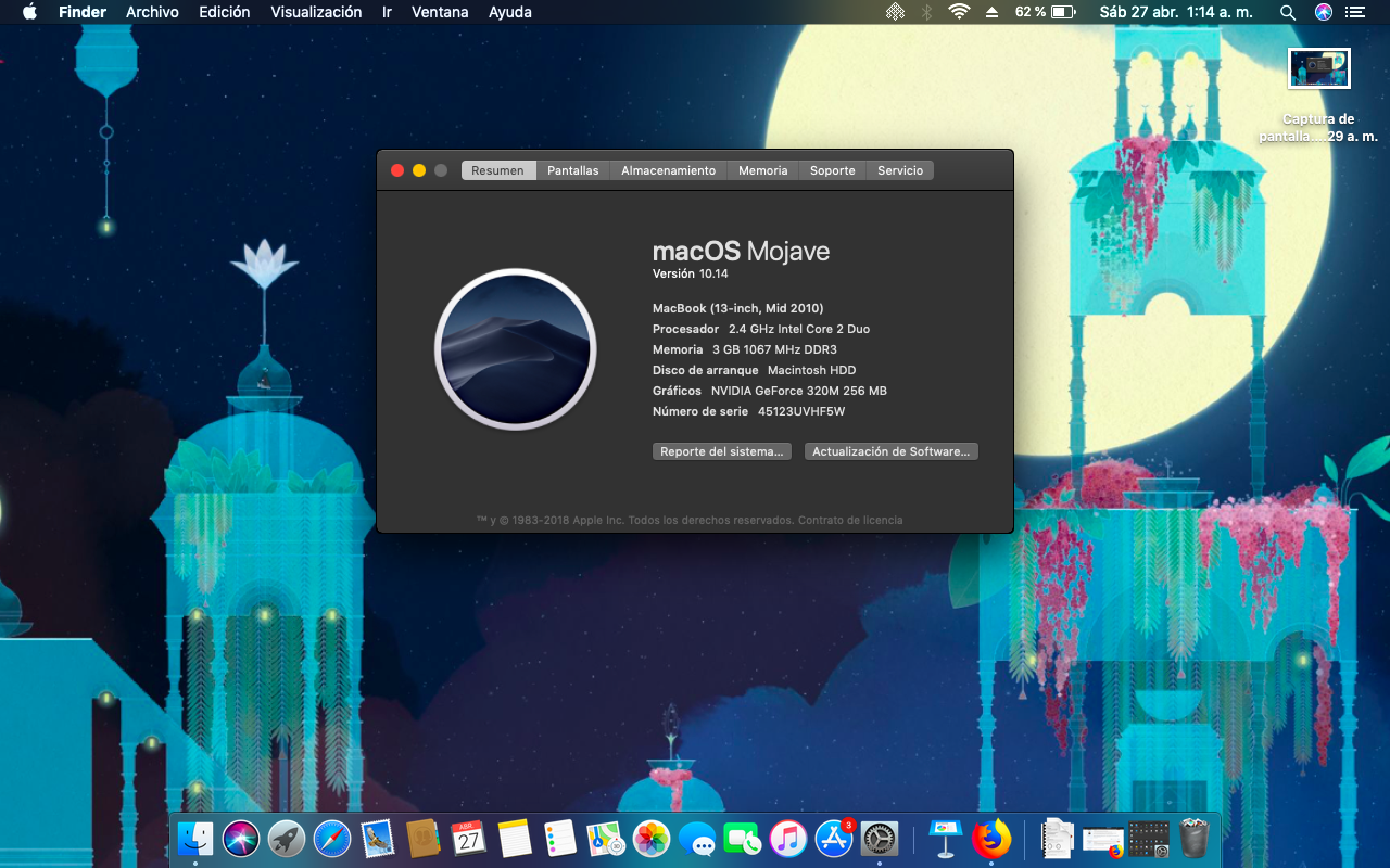

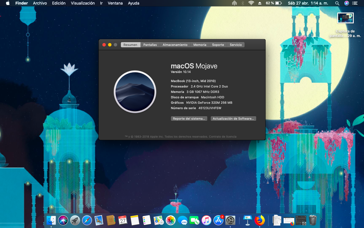

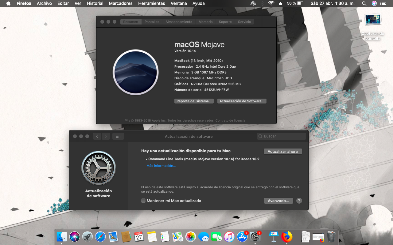

I have some questions guys. i'm still on 10.14 since last year on my Macbook white mid-2010, the question is; Is recommendable to jump to 10.14.4, my mac works so stable and flawlessly on 10.14 and i don't know if there will be performace issues with 10.14.4. I wanna upgrate to 10.14.4 'cause i want the @dosdude1 full acceleration patch for my non-metal gpu; i guess that patch only works on 10.14.4, so i need to upgrade... and i have a problem too... software update doesn't show me the 10.14.4 update, only updates for xcode command line, i guess i have to update via installer....
Captura de pantalla 2019-04-27 a la(s) 1.14.03 a. m..png Captura de pantalla 2019-04-27 a la(s) 1.30.22 a. m..png
View attachment 834081 View attachment 834082
First of all, don’t update to 10.14.4. If you want to update wait for 10.14.5 or I can hook you up with a 10.14.3 installer and you can update to that. I have 10.14.3 on the same Mac as you (using my own patcher - macOS Patcher) and it’s extremely stable. I have never experienced any issue whatsoever apart from transparency which is normal. If you want to update though, you need an apfs drive. If you want to convert your drive to apfs, you can boot from the installer, open disk utility, click edit, and click convert to apfs. Your machine supports apfs so I recommend it.
Why, there's problems or something related to performance?
I can't format my drive on apfs, i don't have an ssd... i'm still using a good old mecanical hard drive.
if there's problems; I guess i just wait until 10.14.5...
thanks for your help @0403979
10.14.4 is unstable and has issues. Hard drives can use apfs on Mojave now and you need to use it to receive updates.
Reactions: webg3
