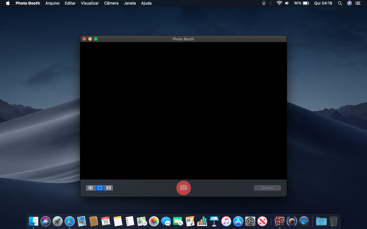

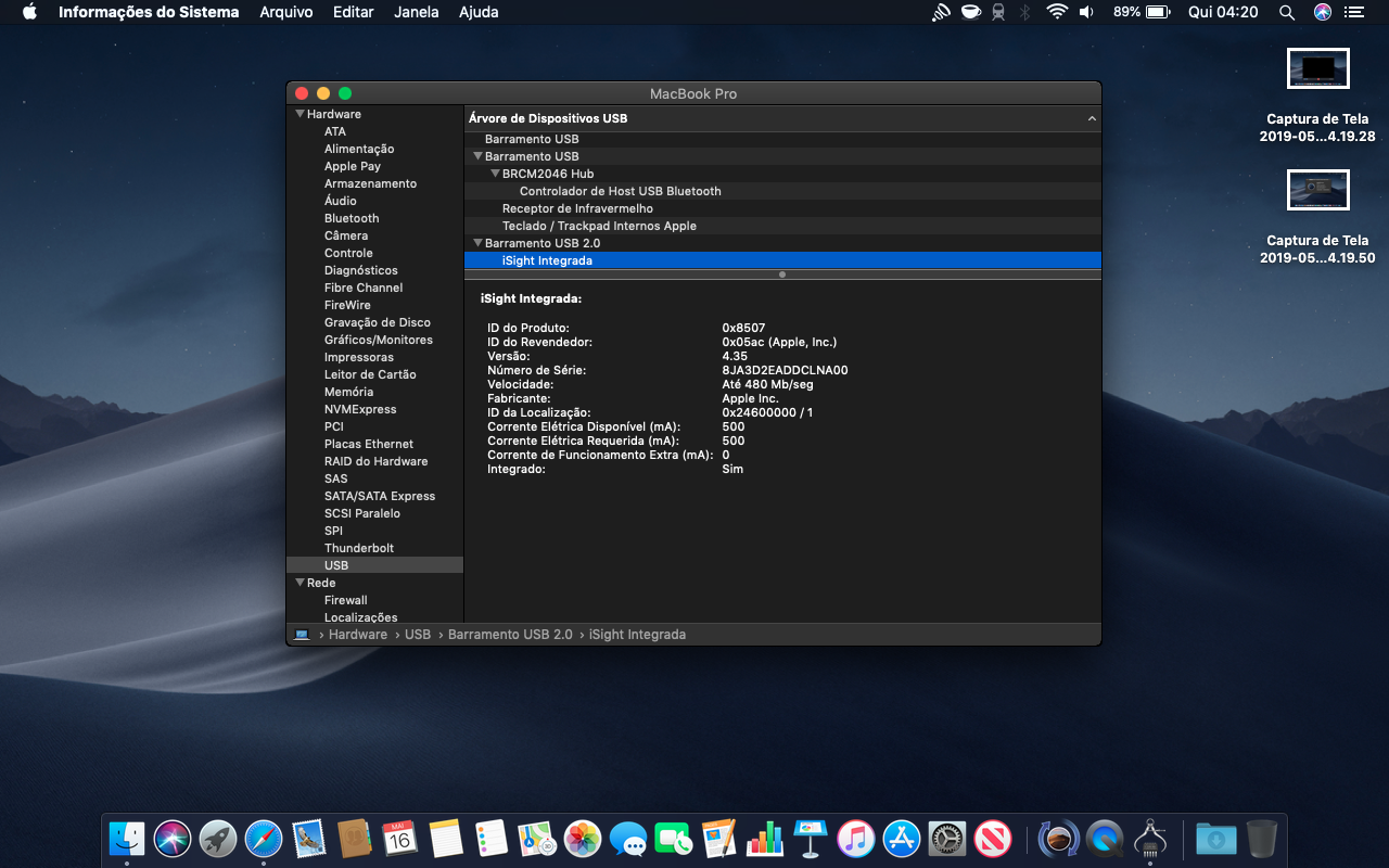

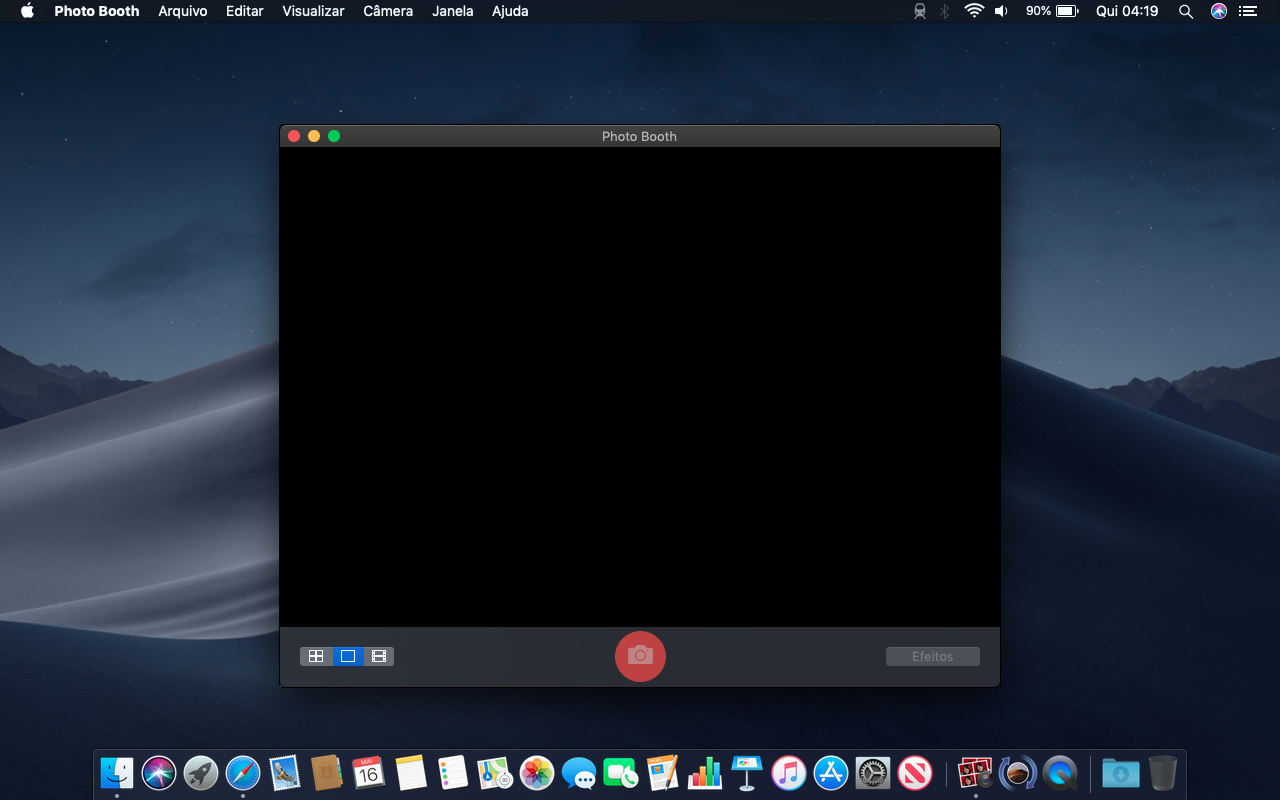

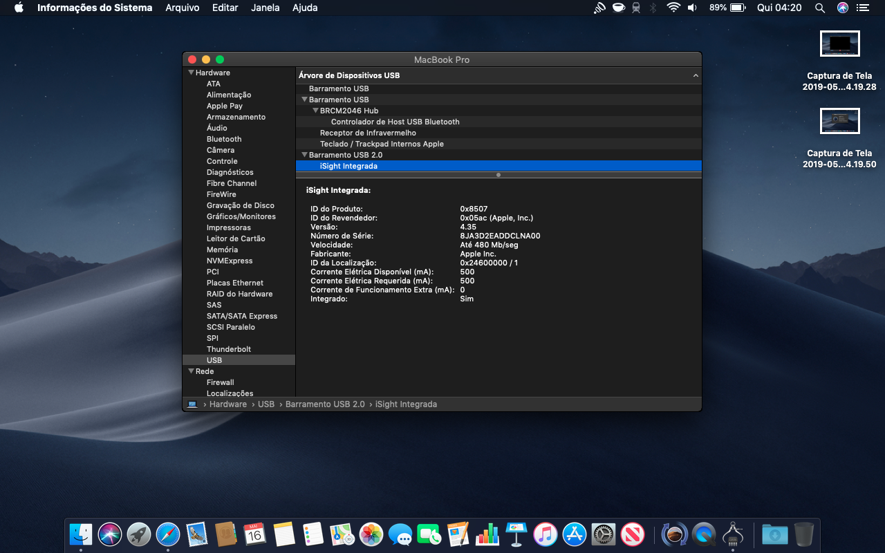

no working = iSight after update 10.14.3 to 10.14.5 (patcher 1.3.1 and 1.3.2)
MacBook Pro 2010 13" (7,1)

no working = iSight after update 10.14.3 to 10.14.5 (patcher 1.3.1)
@ASentientBot is totally right, infact on 2010 machines I used all the 5 IOUSB*.kext stock from 10.14.5 and iSight is working OOB, so if you used some IOUSB* patches you should unpatch them, also deleting the USBLegacyInjector in case.

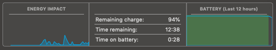

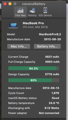

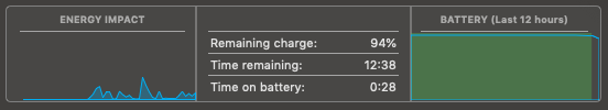

I am definitely impressed with the seemingly improved battery life that came with 10.14.5! Safari Technology Preview 82 seems to be very efficient as well. Looks like Mountain Lion efficiency came back!
View attachment 837307 View attachment 837308
