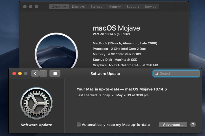

[doublepost=1558897039][/doublepost]The code to ignore the supplemental update did not work for me. I ran it, terminal said it ignored the update, I restarted and it is still there.

Still no luck. I guess I just have to wait for the final release of 10.14.6. Any speculation on when this will be out?

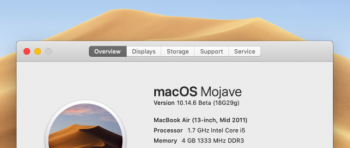

Well, I finally was able to install 10.14.6 beta 1 into my unsupported MacBookAir4,2.
Thank you to @Sedulous for the "softwareupdate --ignore" info, @pkouame for the hybrid patch 1.5 pre-release (works on this beta), @jackluke for his various tests, @TimothyR734 for his tests and suggestions, and of course, to @dosdude1 for his tools and efforts on this subject matter. Apologies to those I failed to mention.

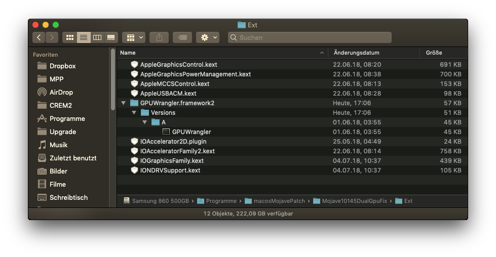

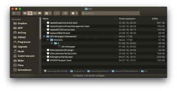

My dGPU machine is running very well with your Mojave10145DualGpuFix (#post 15045, pg 602).
I just went on to try your suggestion and use components of a newer HS 10.13.6 - used the one that dosdude's HS patcher 2.7.0 downloads. It has version 13.6.02 (don't know how to find out the build number without installing it). I've replaced the contents of your Ext folder with the ones from 13.6.02, also including the AppleUSBACM.kext for sake of Arduino. Ext contents in attachment. I've picked all these from my 10.13.6 dosdude USB installer.
Applied those replacements with your .command. Now also running very well... thanks.
Seems indeed faster than without Mojave10145DualGpuFix. GPU switching (though I don't really use it often) works better: systems settings/energy saver change then logout+login work immediately and reliably.
(MBP5,2 17" 2.8GHz mid 2009, APFS ROM patch applied, Samsung SSD 860 EVO with APFS.)
Only thing is that you are not using the latest HS ones, since the last 10.13.6 17G7024 binaries have a date modified of May 8th 2019 , while the ones in my zip package were from 17G6030 date modified March 28th 2019, so you are surely using older 2018 HS kext, it's not an issue, but if you have taken them from an HS USB Installer, even if they worked, those are smaller in byte size (fork'ed version), and are as I call them "incomplete kexts and frameworks" since they only contain the 64 bit architecture coding, and maybe for some 32 bit applications they could cause unpredicted incompatibilities, so you should take those kexts/frameworks from a complete HS installation rather than from an USB Installer, because the ones taken from a full installation contain both 32+64 bit architectures, and are a little bigger in byte size of course. Just an advise.
Reactions: webg3
Only thing is that you are not using the latest HS ones, since those 10.13.6 17G7024 have a date modified of May 8th 2019 , while the ones in my zip package were from 17G6030 date modified March 28th 2019, so you are surely using older 2018 HS kext, it's not an issue, but if you have taken them from an USB Installer, even if they worked, those are smaller in byte size, and are as I call them "incomplete kexts and frameworks" since they only contain the 64 bit architecture coding, and maybe for some 32 bit applications they could cause unpredicted incompatibilities, so you should take those kexts/frameworks from a complete HS installation rather than from an USB Installer, because the ones taken from a full installation contain both 32+64 bit architectures, and are a little bigger in byte size of course. Just an advise.
Thank you jackluke. I‘m learning a lot this way.
In that case I‘ll happily stick for now to the components you provided.

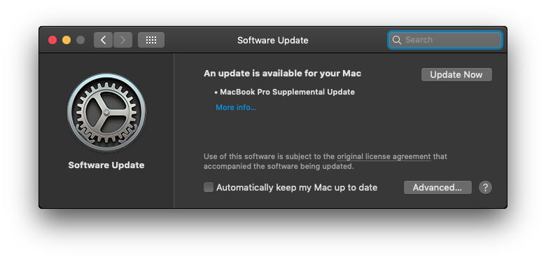

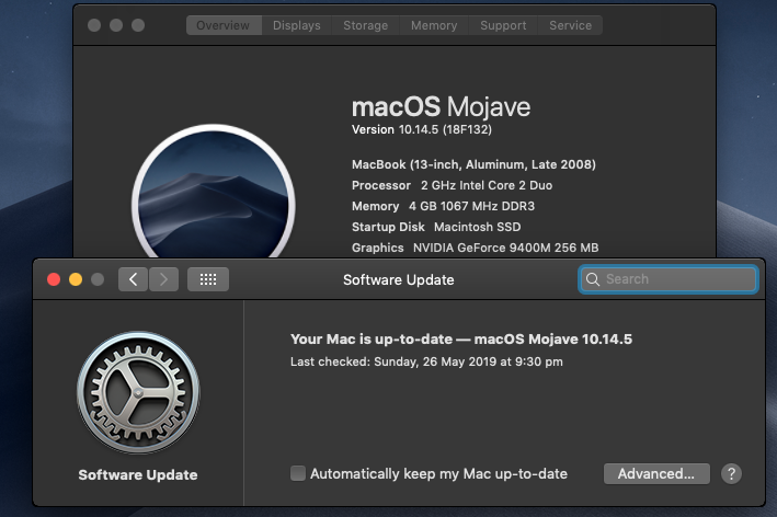

In case anyone else wants their unsupported Mac to avoid the T2 update, you can use terminal to ignore the update.
Code:
softwareupdate --ignore "MacBook Pro Supplemental Update"
This work perfectly on 2 iMac (27 inch, late 2009) 10.14.5 (18F132) and (21,5 inch, late 2009) 10.14.5 (18F132)
Thanks !
The question I ask myself is where is this package (T2 update) that has already been downloaded to my machines but not installed ?
Cheers folks!
Even if the ones you used worked, are much more reliable using the 32+64 bit kext/framework/binaries that are present only on a full OSX installation, while on an USB Installer or Recovery they are "incomplete/fork versions" used just for emergency purpose, I guess apple fork'ed them to reduce the Recovery HD and BaseSystem.dmg sizes.
Thanks !
Cheers folks!
here: /Library/Updates/

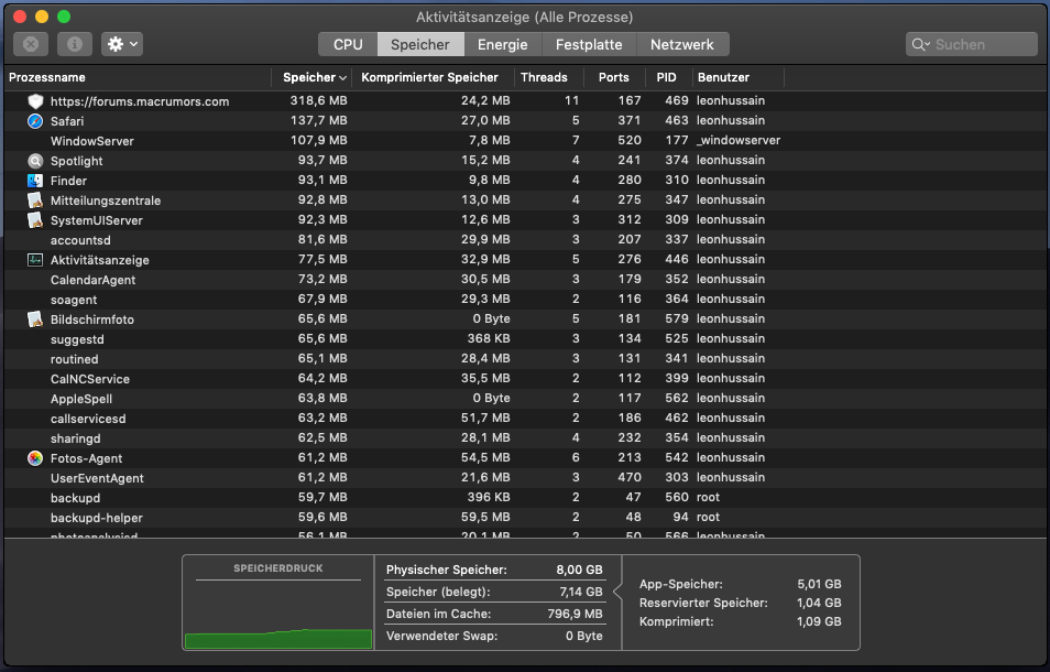

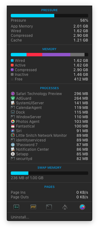

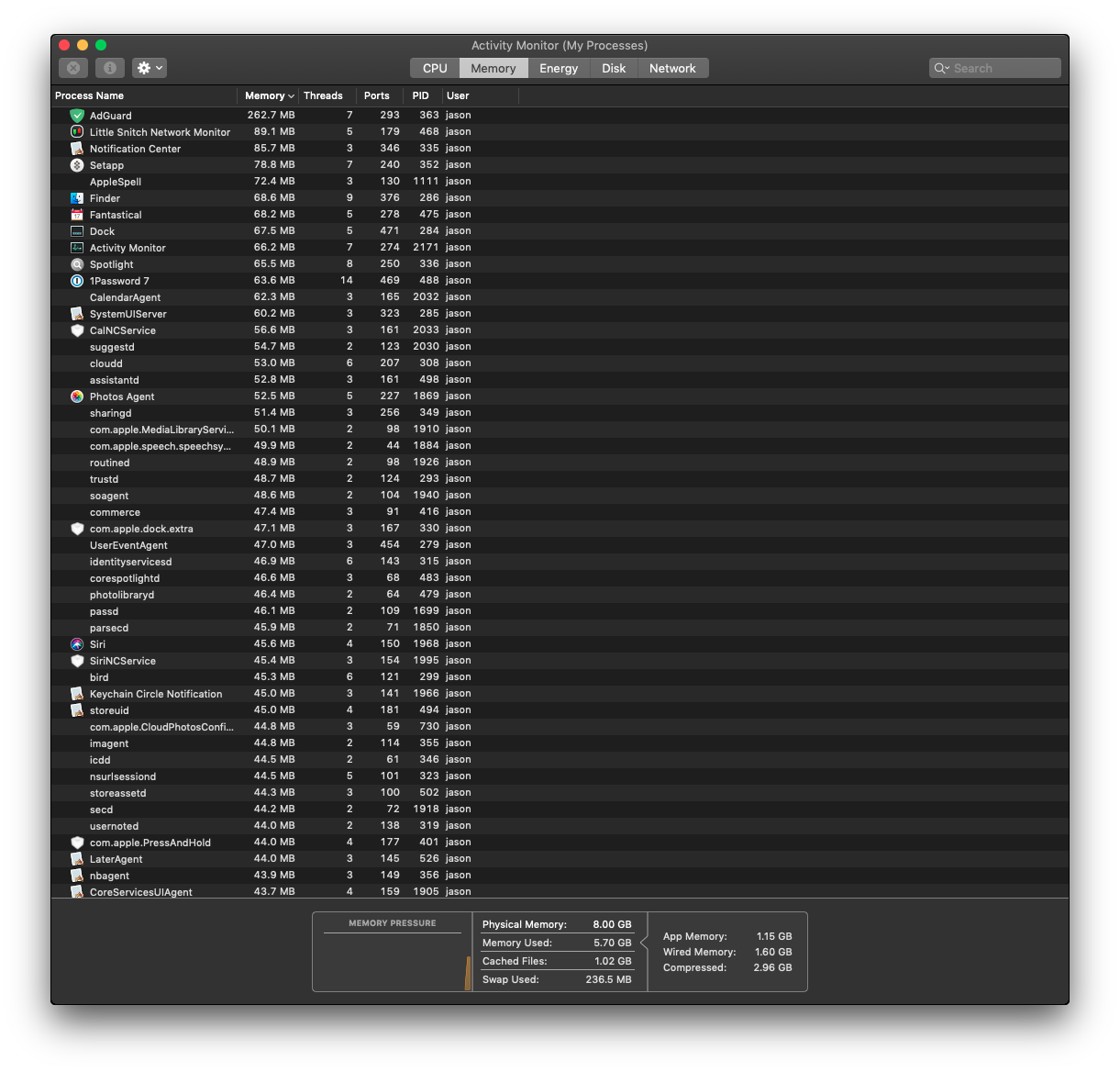

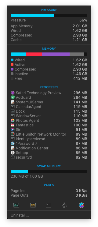

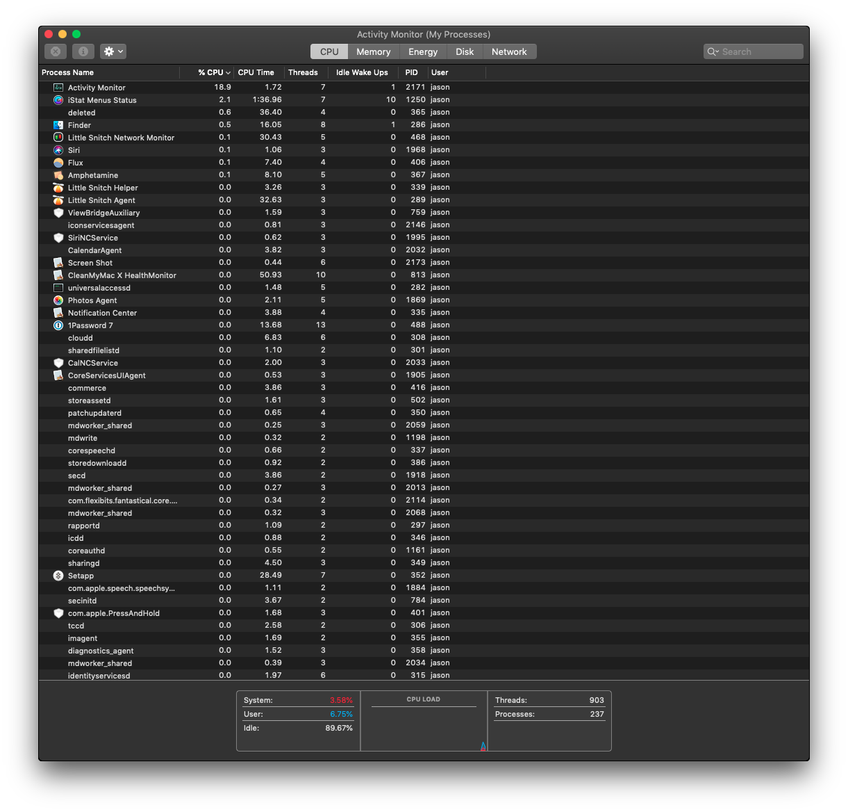

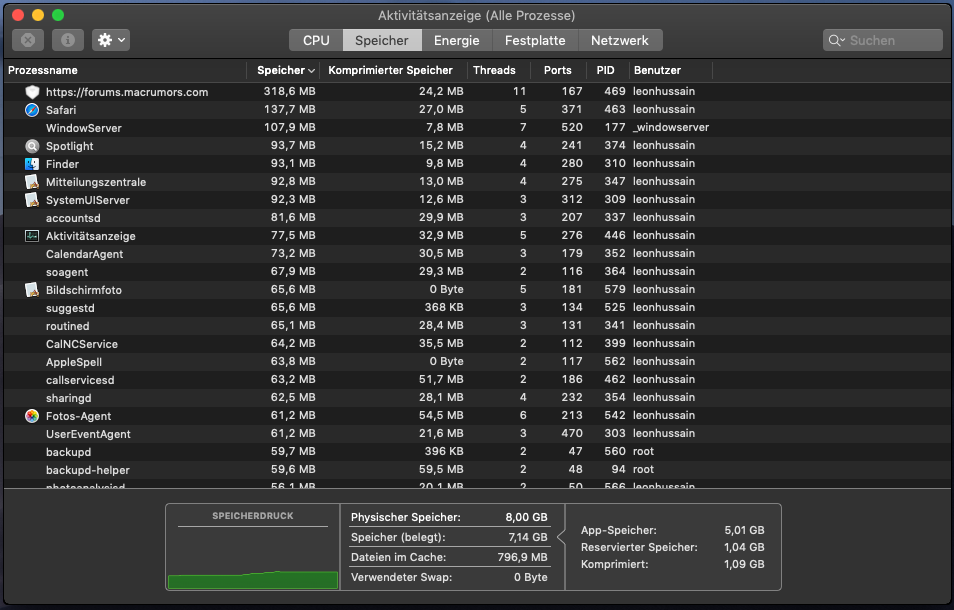

View attachment 838542 View attachment 838540 View attachment 838541 Wouldnt you agree this is nuts memory usage? Normally, before todays supplemental update, which is the only change, I would hover around 30-50% memory usage. That was with multiple tabs open, a music player going with the entire song loaded into ram, etc... Now I have one tab open in Safari and that's it, nothing. My RAM is FULL.
Exact same thing here. Decided to upgrade my Macmini3,1 from 10.13.6 to 10.14.5 and now it keeps using almost all of my memory, even when nothing is running or just Safari with 1 Tab (like in this case). I've tried booting into safe mode, using OnyX etc. but it won't stop filling up my ram.. My macOS build is 18F132 (without the supplemental update)
Any ideas?
Any ideas?
Some of us, including myself experience this. This started with the supplemental update in 10.14.3 (the February build). 10.14.5 is indeed better than 10.14.4 but seems to have a bunch of glitches - especially on my 2010 (laggy trackpad/mouse, memory use, etc)
10.14.2 and 10.14.3 (the first initial january build) runs best for me so im just gonna stay on those
