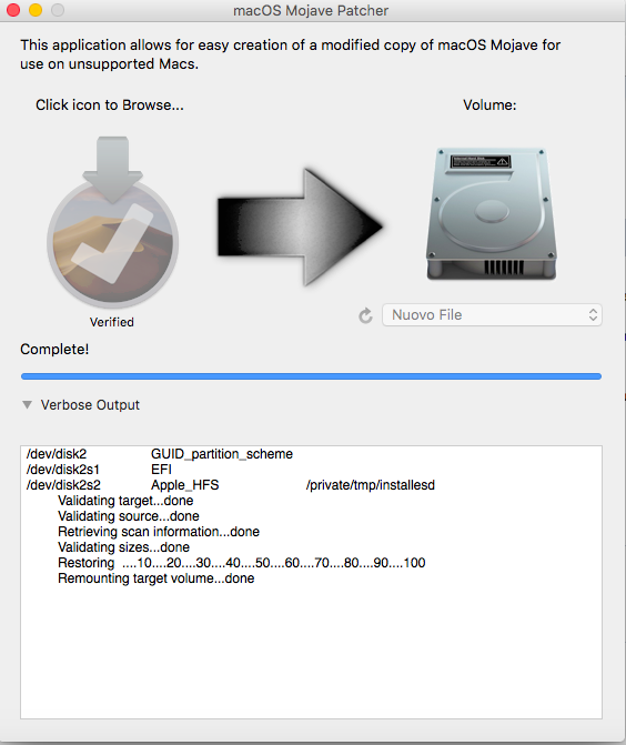

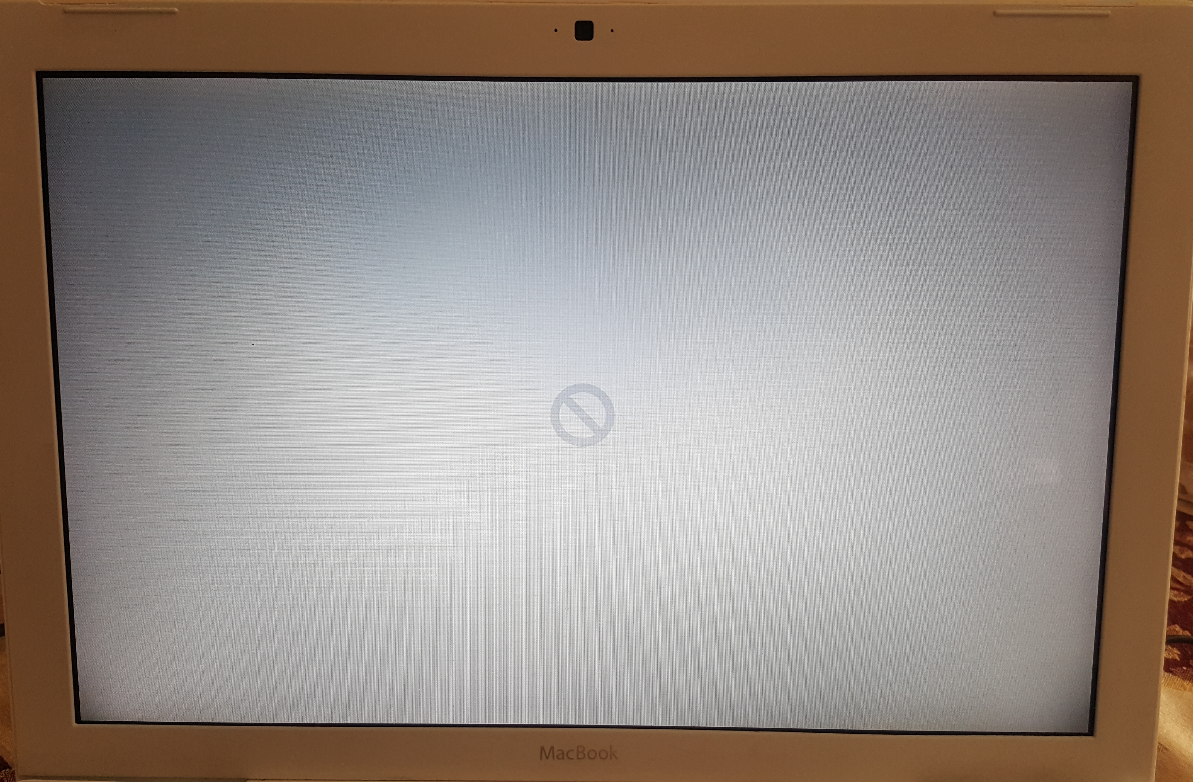

Hi, I've a early 2009 Macbook (5,2 white).
I'm trying to installa Mojave but I get the "NO" symbol when I plug usb, restart Mac and try to installa Mojave. Same happens when I try to install High Sierra.
It's kinda strange because 1 year ago I installed High Sierra via patcher (then returned to El Capitan).
I downloaded both HS and Mojave but nothing works.
I titled my usb with different names but nothing.
What can I do? I tryied HS with 8gb and 16gb usb but nothing. I tryied Mojave with my only 16gb usb.. it seems all okay with 'complete', I reboot, select my usb, Apple logo with bar and then NO symbol.
Thanks!

Not all USB drive's are bootable on a Mac. You need to try different USB brands.

QUOTE="avz, post: 27398062, member: 1148741"]Not all USB drive's are bootable on a Mac. You need to try different USB brands.[/QUOTE]
So unlucky, 3 different brand and 3 times No Symbol! Thanks..
and make sure your SIP is disabled and you have apple the post install patches after you install macOS High Sirra or Mojave
Sure, thank you!
Sure, thank you!
Unplug the USB Mojave patcher, and from any internal (or USB external) OSX bootable partition, or Recovery CMD+R, or Snow Leopard DVD or anything else, boot holding CMD+S , then when you land in any Shell type:
nvram boot-args="-no_compat_check"
reboot
and then retry to boot the USB Installer.

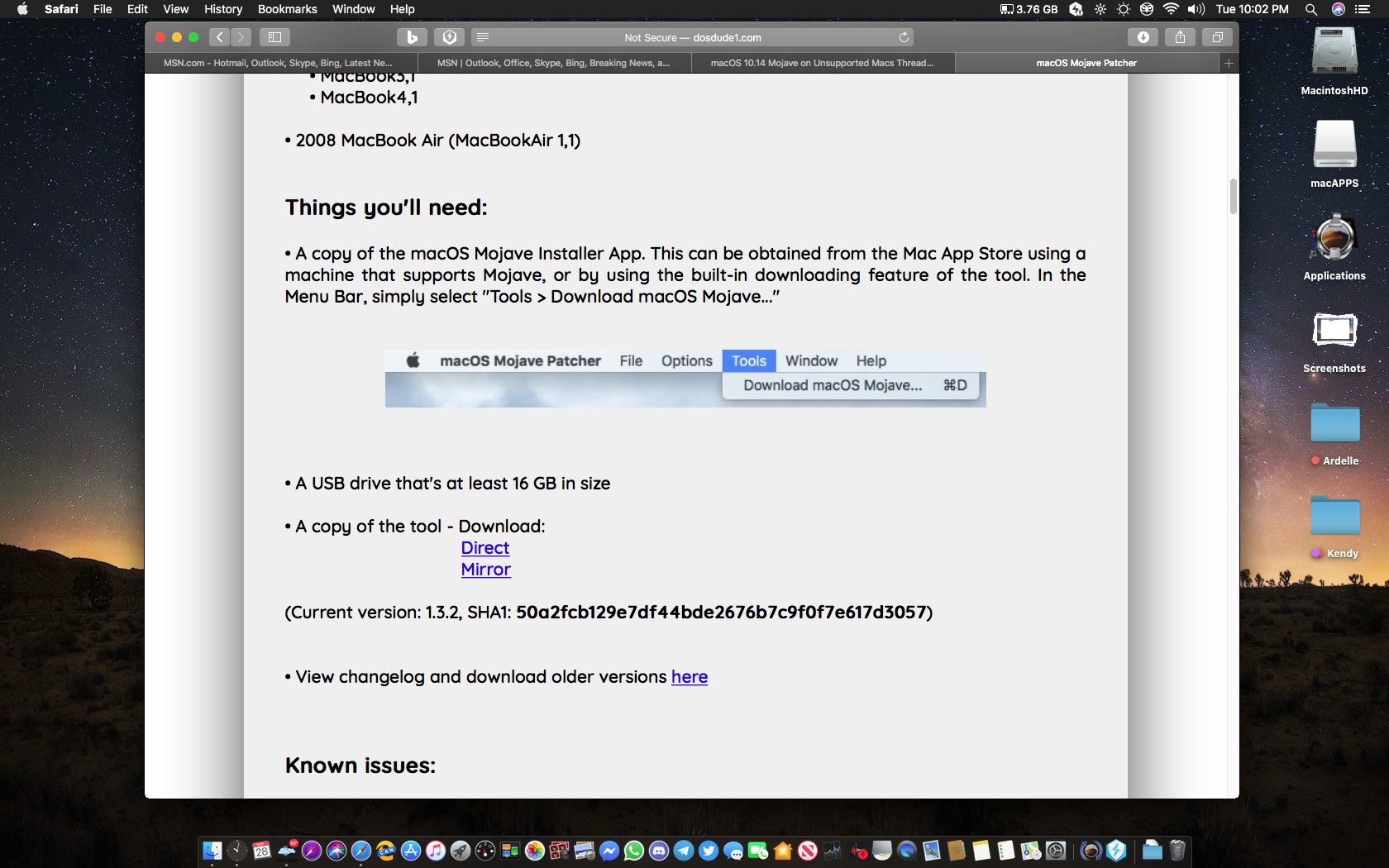

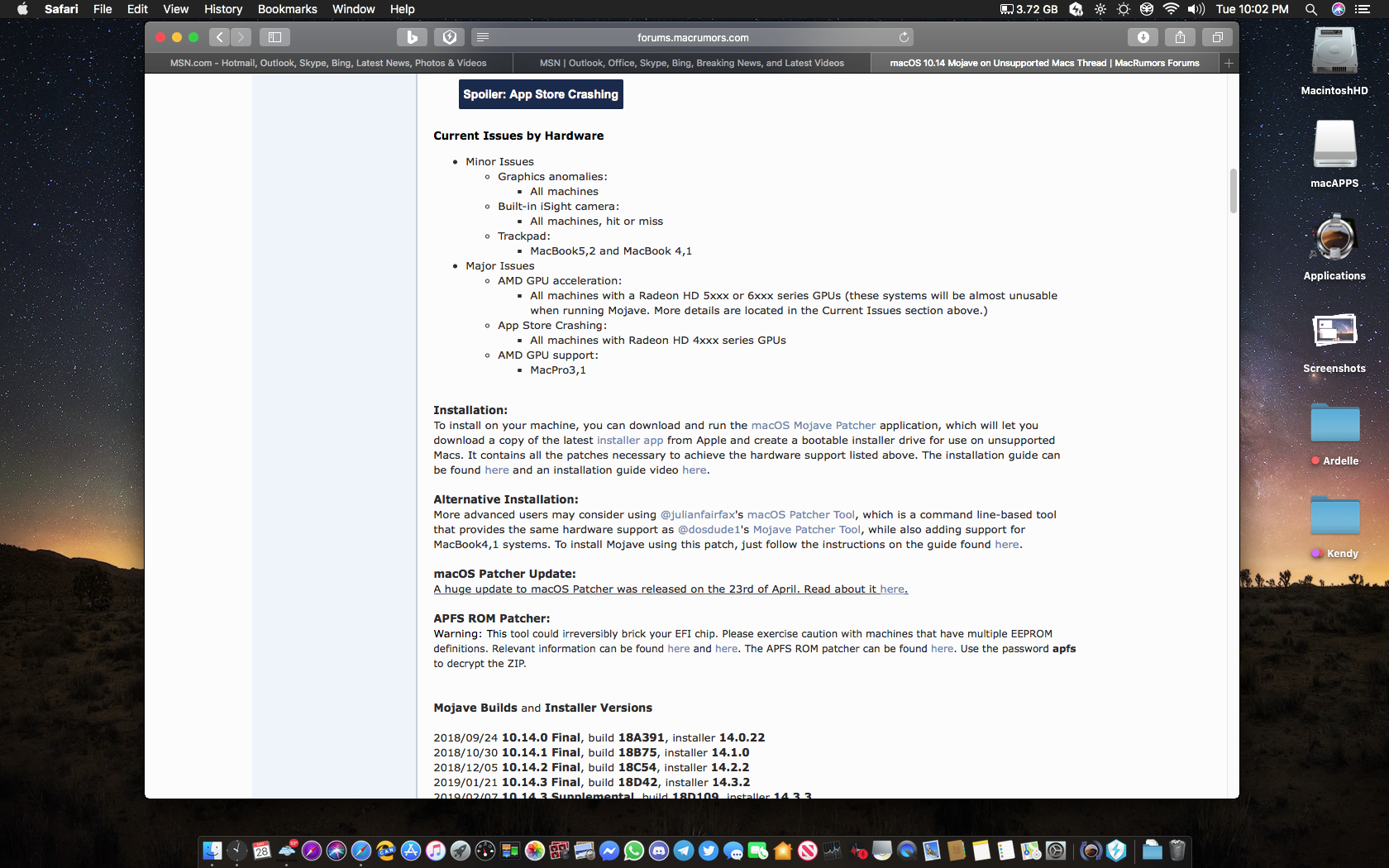

Hi,
Its been some time and I have missed a lot. Last I tried I got stuck with installing 10.14.4 on my Late MBP 13" . I reverted back to .3 and since then have been afraid of doing anything to my laptop.
Is it safe to update from .3 to .4 or .5 ?
If yes can someone outline the detailed process again? I believe I still have 1.2.3 version of the dosdude's patcher and don't know how to update it.
Any help or detailed instructions would be very much appreciated! =)
You will need to download the newest patcher on pg 1 of this thread which is 1.3.2 follow the instructions there on creating one and will also tell you how to download the latest macOS Mojave the newest patcher has the most recent fixes
Reactions: K two
I understand.
The thing that confuses me is when you say, "update the patcher" how am i supposed to do that or just making a usb with the latest patcher trying an inplace upgrade to 10.14.5 work?
I understand.
I hope this helps its on the very first page

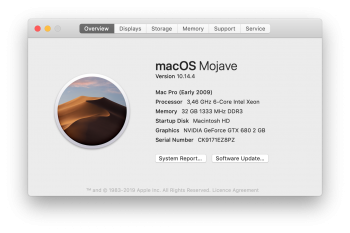

Another thing:
I've GTX680 Gigabyte Windforce 2gb with Evga mac rom, just replaced last week my older 27" FHD display to 32" 16:9 Sam UHD, it can work via HDMI in native resolution with 30hz, but the GUI little slow, so i using 2560 x 1440 60hz: it is more acceptable.
The bigger problem is: The efi / boot selector LOW resolution (800 x 600 and half time of boot switched to 1024 x 768)
» Installed Refind (now usable, i see all of my bootable partitions and installers) and tried to edit higher resolutions in config file without luck.
Do you or Anybody have any idea how to increase that resolution? Is it possible somehow?
My old monitor appeared Efi too in FHD with nice, sharp Apple logo.
The GTX 680 with 2GB should be capable of delivering 2560x1440 in HiRes mode and native 4K resolution.
See my screenshot below.
