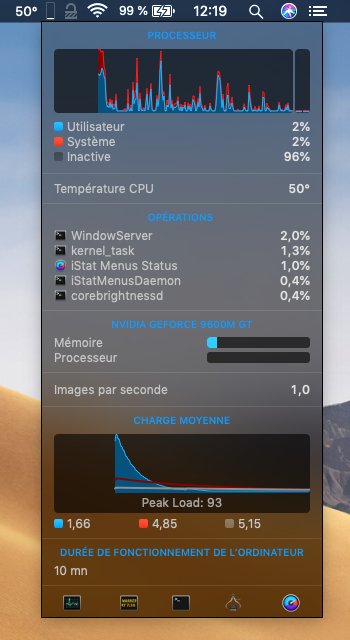

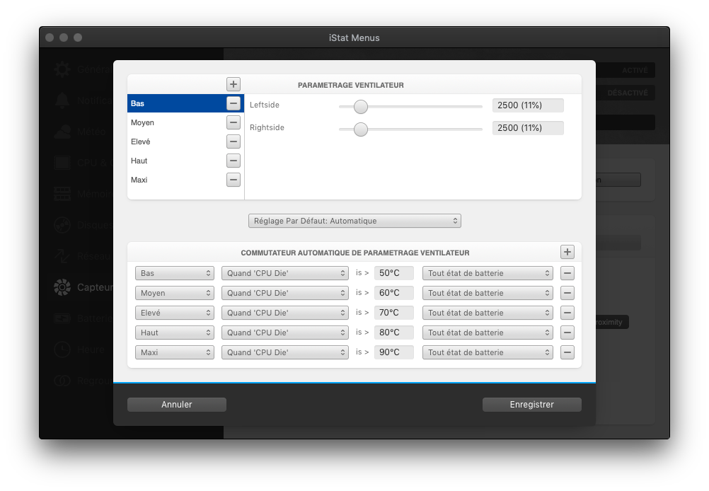

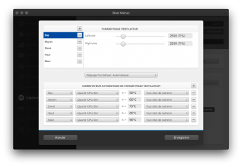

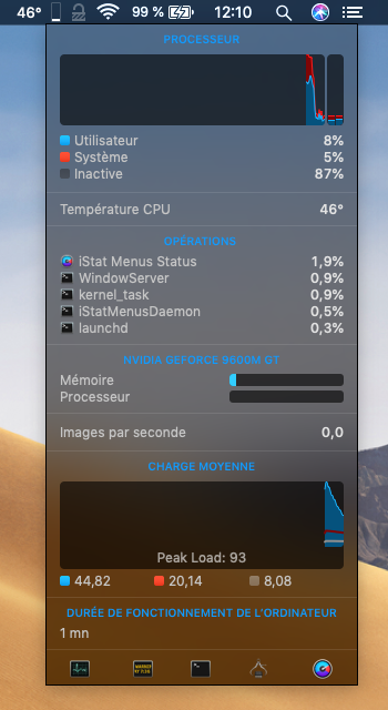

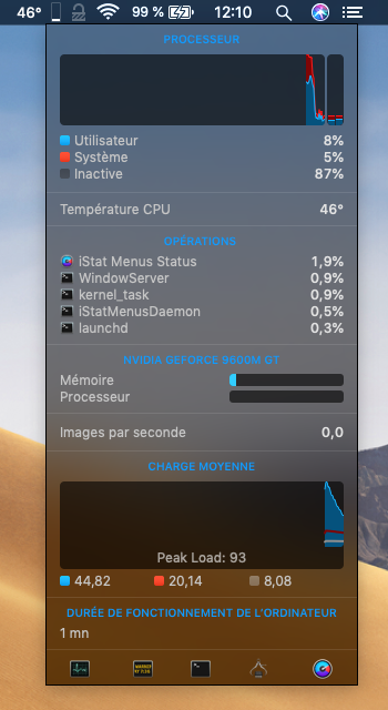

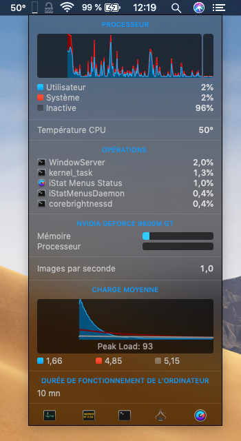

Hi
My MBP5,3 is at 46°C after start-up and at 50°C 10 minutes after start-up, in internet browsing with Firefox 67.0 it is at 60-65°C.

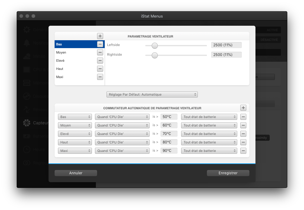

I use iStatMenu with rules to control fans based on CPU temperature. I also think that a more cooled machine will preserve its components.

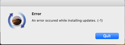

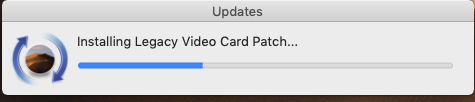

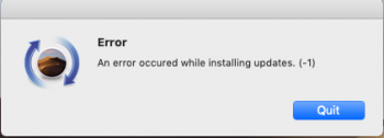

I was running 14.4 without any problems and got the annoying notification that 14.5 was official. I read here how much people like it better than .4 so I thought I'd try it. Upgrade ran fine and I did make a USB before the upgrade with dosdude's package.
After the upgrade, my MBP 5,5 2009 crawled to a snail's pace. I had flashbacks to Windows 1.0 on a 286 box.
Boot up 1.49 minutes. Not bad.
Login to ready to start working... 15 minutes!
Onyx, the whole bit. Same.
I decided to roll back to .4. I had the USB I had used previously and during the past two days using multiple USBs and versions, .3 .4 and .5, I have seen three different scenarios. All of which fail every time.
The first is a failure to verify core.pkg. This is common and most of the time restarting it will successfully verify the core.pkg.
Second is after a successful verify, it begins to extract the contents of core.pkg and the fails on either a random True Type Font OR a desktop jpeg.
The third is the most painful, because neither of the first two occur, and I get hopeful it will complete and then it hangs. No message, just "30 minutes to complete" on the progress bar and no more entries in the logs. Am I waiting long enough? Yesterday I waited an additional 1.5 hours to make sure it wasn't just slow before I killed it.
Again these events are random and it doesn't matter which version of Mojave (.3 .4 .5) I'm using. Multiple USBs used all good and also using both versions (1.3.0 and 1.3.2) of the Patch tool.
Is there anything you folks might know that can help me? I'm worn out.

Hi

Hello,
Could you share alls screenshots related to "Parametrage ventilateur" in iStatMenus ?
I mean what RPM you choose for others "Moyen", "Elevé", "Haut" and "Maxi" ?
Thank you
