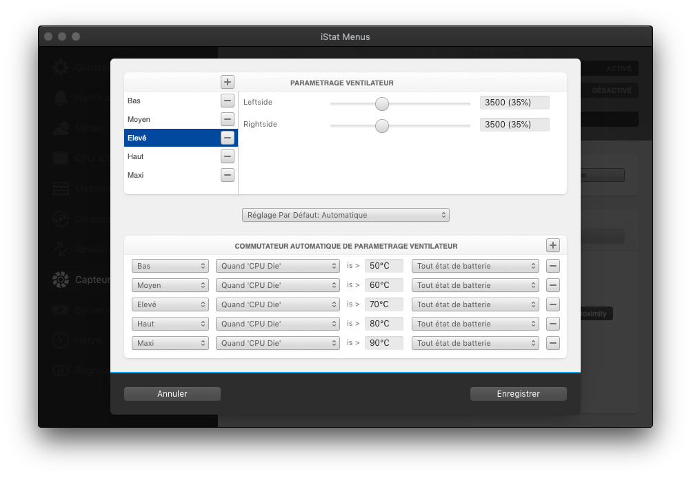

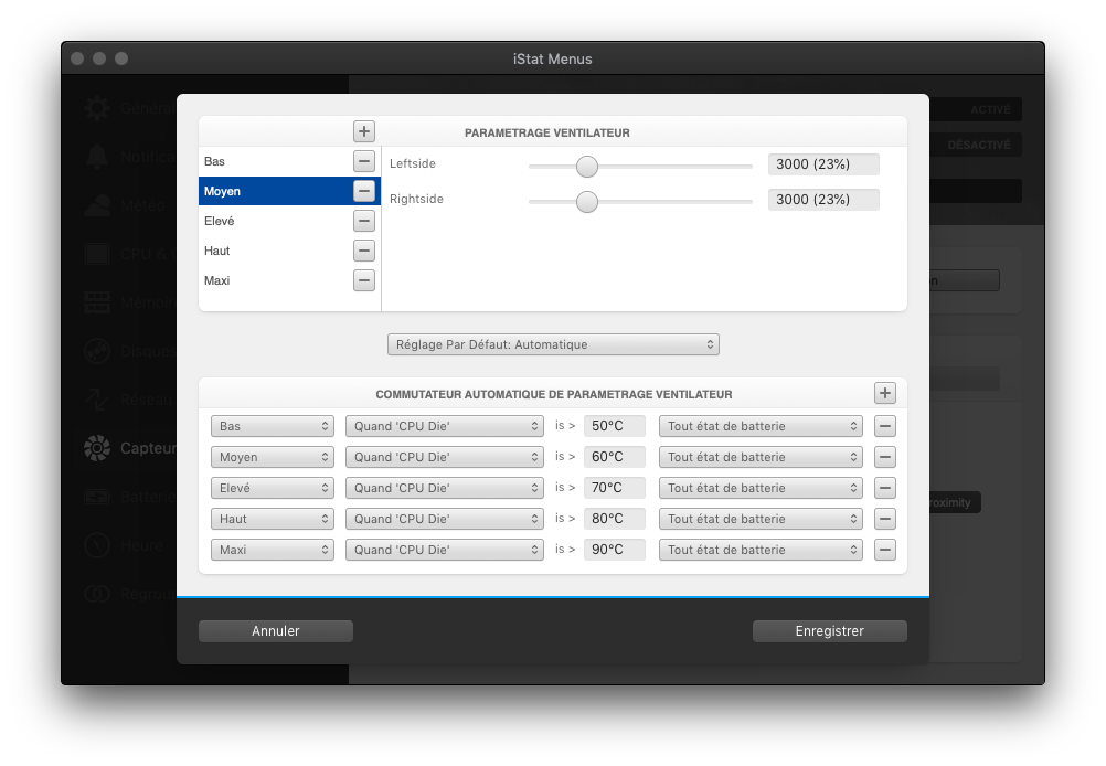

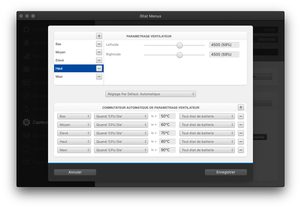

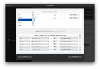

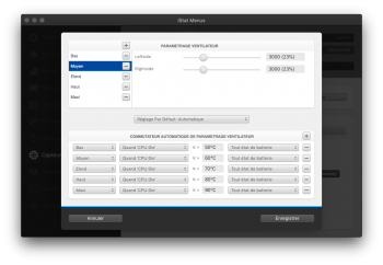

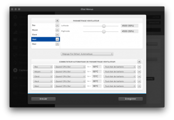

Hello,
Could you share alls screenshots related to "Parametrage ventilateur" in iStatMenus ?
I mean what RPM you choose for others "Moyen", "Elevé", "Haut" and "Maxi" ?
Thank you
Hi @Loyd-01a
Here are the screenshots:
Capture d’écran 2019-06-03 à 11.25.55.png Capture d’écran 2019-06-03 à 11.26.07.png Capture d’écran 2019-06-03 à 11.26.15.png Capture d’écran 2019-06-03 à 11.26.22.png

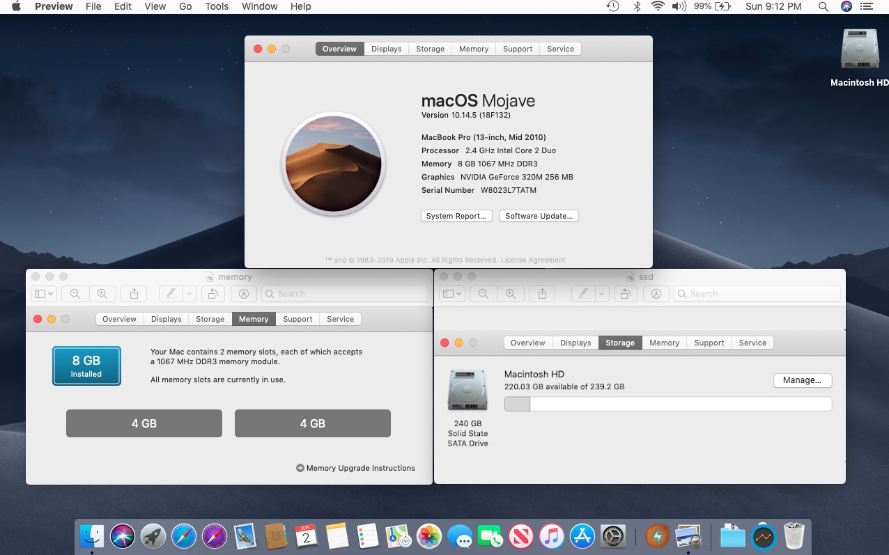

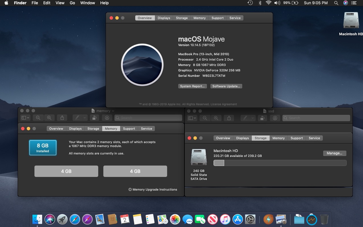

I have a mid 2010 13 inch MacBook Pro that is running high Sierra on its own without any patch, I am thinking about trying this but want to make sure that my 2010 MacBook Pro will be able to handle it ok first. it has a 256gb SSD and 8gb of ram.
I would not hesitate doing it, its running well. Here's a screenshot between Flat light vs Flat dark mode.
Agreed. Never been an issue between OpenGL and sse 4.2 instruction set that I know of. But I think netkas is patching the metal driver itself.
