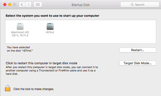

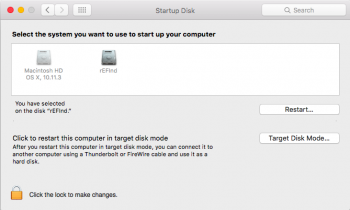

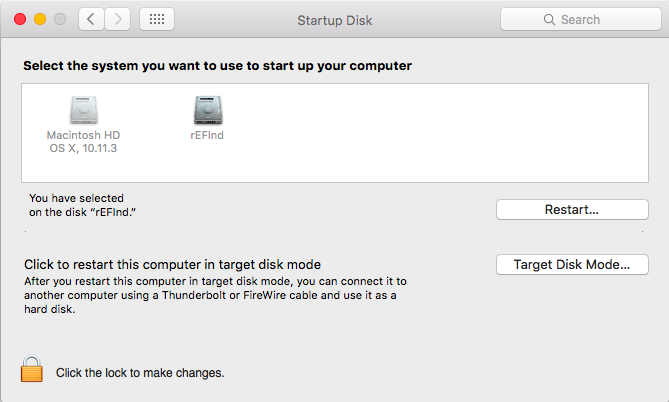

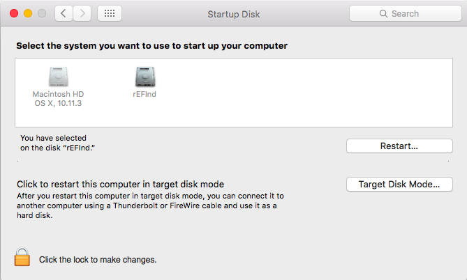

Yes i know, i did that way. There isn't refind, is it natural? I've seen choosable refind partition in start up disk. I attached pictures, the black is mine.
View attachment 839540 View attachment 839541
Yes it's normal, I also use refind on some machines and I don't have any Refind either on apple startup manager and Startup Disk. It's just hidden let's say.

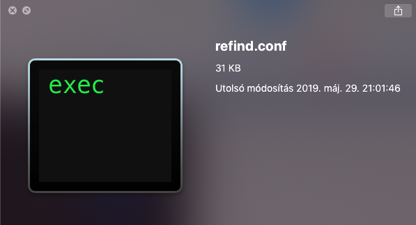

Probably you saved the refind.conf in non-plain-text (probably rich-text), it happens sometimes so you should copy a new refind.conf to make Refind correctly detected after the power-on.
Because when you re-install it keeps the old refind.conf .
Ah, thank you. No, i didn't save to rich text, there isn't any problem with config file.Képernyőfotó 2019-05-29 - 22.57.54.png

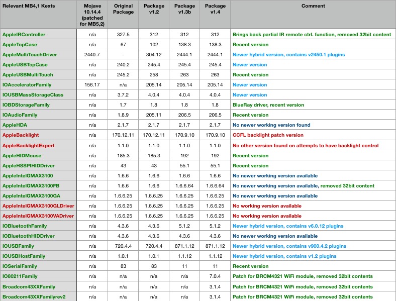

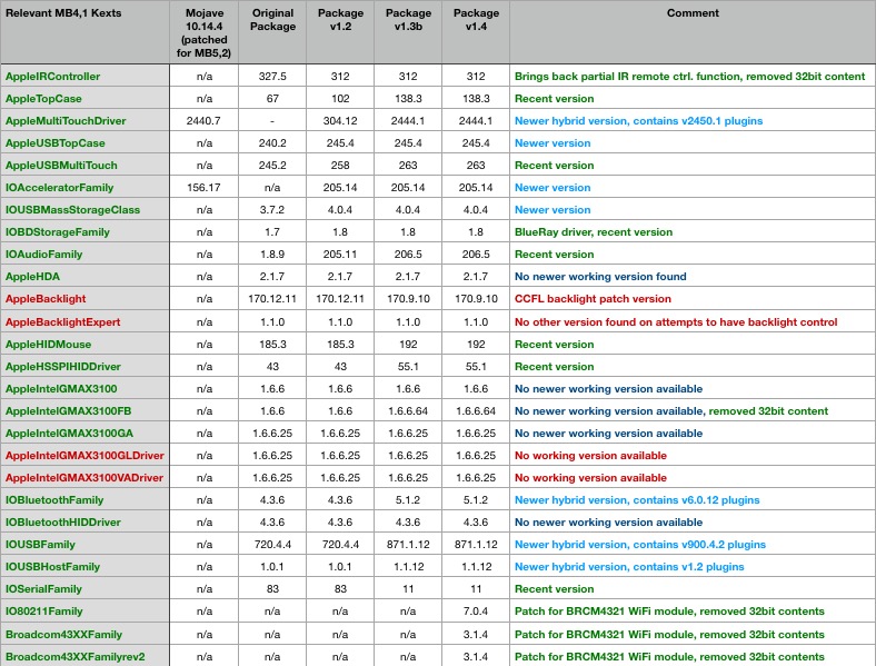

For the MB4,1 lovers:
I've updated my kext-package to v1.4 with the Broadcom Wifi kexts needed to run the original BRCM4321 card that the MB4,1 was equipped with. Runs fine and has been tested on 10.14.4 and 10.14.5. Thanks to @dosdude1 for the test machine! (In the MB4,1 that I previously used I swapped the card to get around this but after folks started using @0403979 alternative patcher it became clear that the old card was really not supported any more - just like in other machines). There will most certainly be better/cleaner/more straightforward solutions for the WiFi issue than this initial kext combo. Julian has some ideas, too, that can be tried out. More to come, it'd seem ;-)
What did not work was the Broadcom plus corecatcher replacement and corecatcherresponder solution that did the trick on other systems with similar cards...
Here's the download link for the package. Install with kext utility or copy to /S/L/E and correct permissions. Then rebuild prelinked kernel and reboot.
See screenshot for current kext contents in v1.4 compared to older versions.
