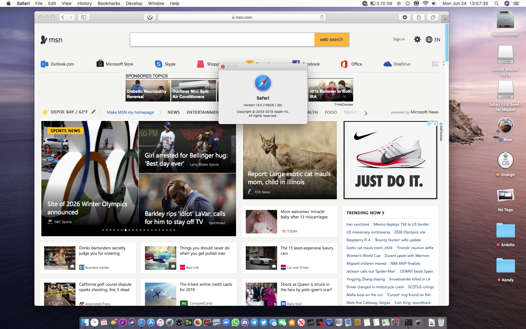

[doublepost=1561410068][/doublepost]Safari 13 Dev beta is working well :)

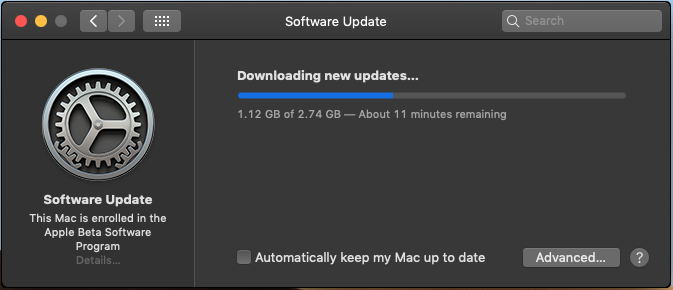

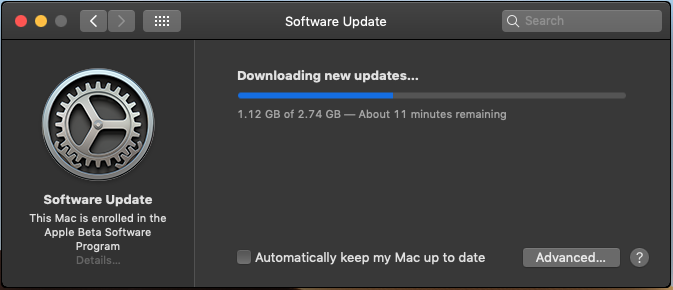

Judging by the size, the .6 PB3 is the biggest Mojave point update ever. I erased my Mojave patcher(made a Catalina patcher) so I will have to do all the patching manually after the update. This is going to be fun!

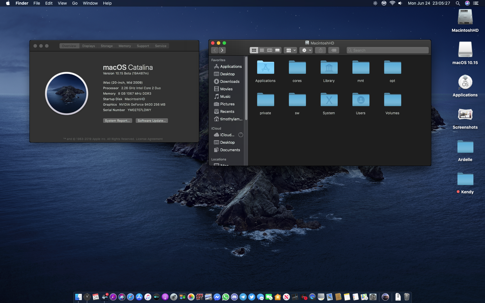

Dosdude has a new MacOS Catalina Patcher out I just installed over 10.14.6 dev beta 3 light mode is still broken but runs well on my iMac 9,1 :)
