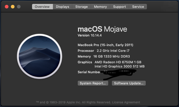

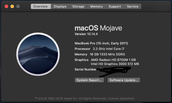

I just bought a pre-owned early 2011 15 inch mac book pro for school- and I installed Mojave - I haven't attempted to disable the AMD graphics care yet - I will later. The only issue I notice is some tearing/overlapping at the edges of applications like Safari for example.
When I do a vram reset and look at my "About This Mac" section - I see the AMD card is gone(temporarily) and the tearing/overlapping issue goes away. The card does come back and so does the edge tearing, after awhile. So I will try to follow the dosdude guide to disable it, permanently.

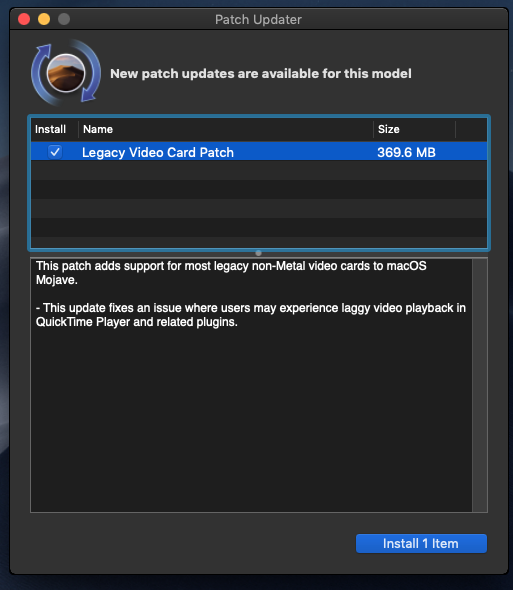

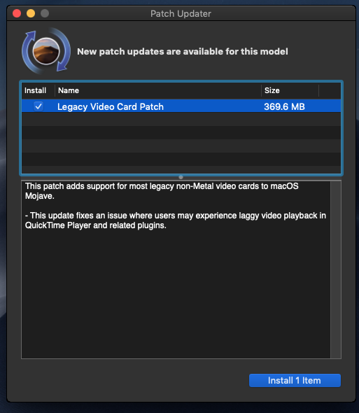

One question I have is - is the new legacy video card patch on the updater for people with AMD cards? or just NVIDIA- I've been avoiding the update because it previously said "for NVIDIA cards" now it doesn't in the updater description area.
View attachment 845334 View attachment 845335
I also I am still running 10.14.4, I don't really wanna do a whole new install.
That update is for all non-Metal cards, so you can go ahead and install it.

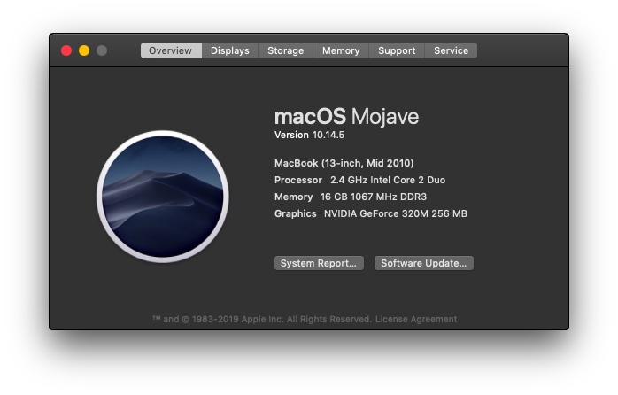

Got a MB 7,1. The tool worked perfectly. Love this little machine. 512 Samsung SSD and 16GB OWC
