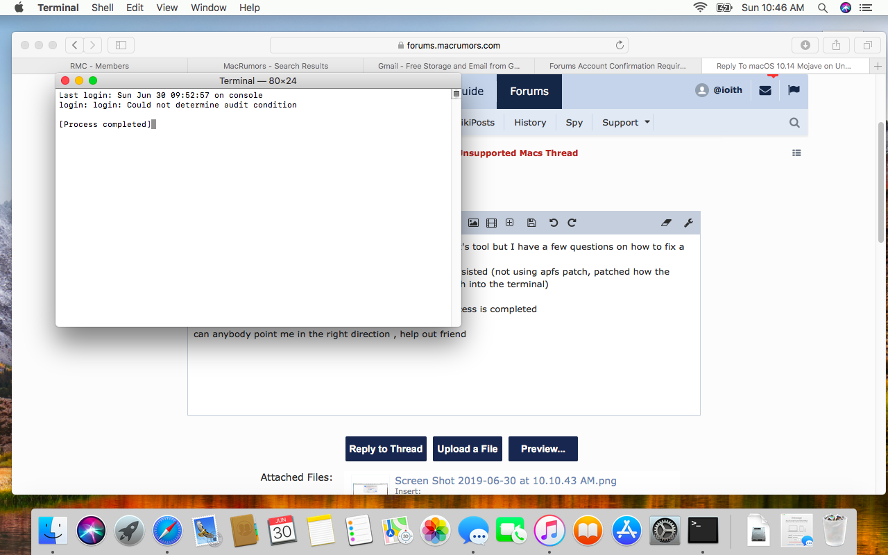

From these permissions issues you have seems you attempted a Catalina HFS+ installation, because I had similar during my experiment, however setting "uid 0" right permissions for each folder is enough complex, but about issues using "sudo" you can try this, booting from your HighSierra with CMD+S (single user mode):
mount -uw /
chown 0:0 /usr/bin/sudo
chmod 4511 /usr/bin/sudo
reboot
Anyway, repairing global volume owner/group mismatched permissions is no more possible since El Capitan I guess, so re-installing to repair them would be a better choice.

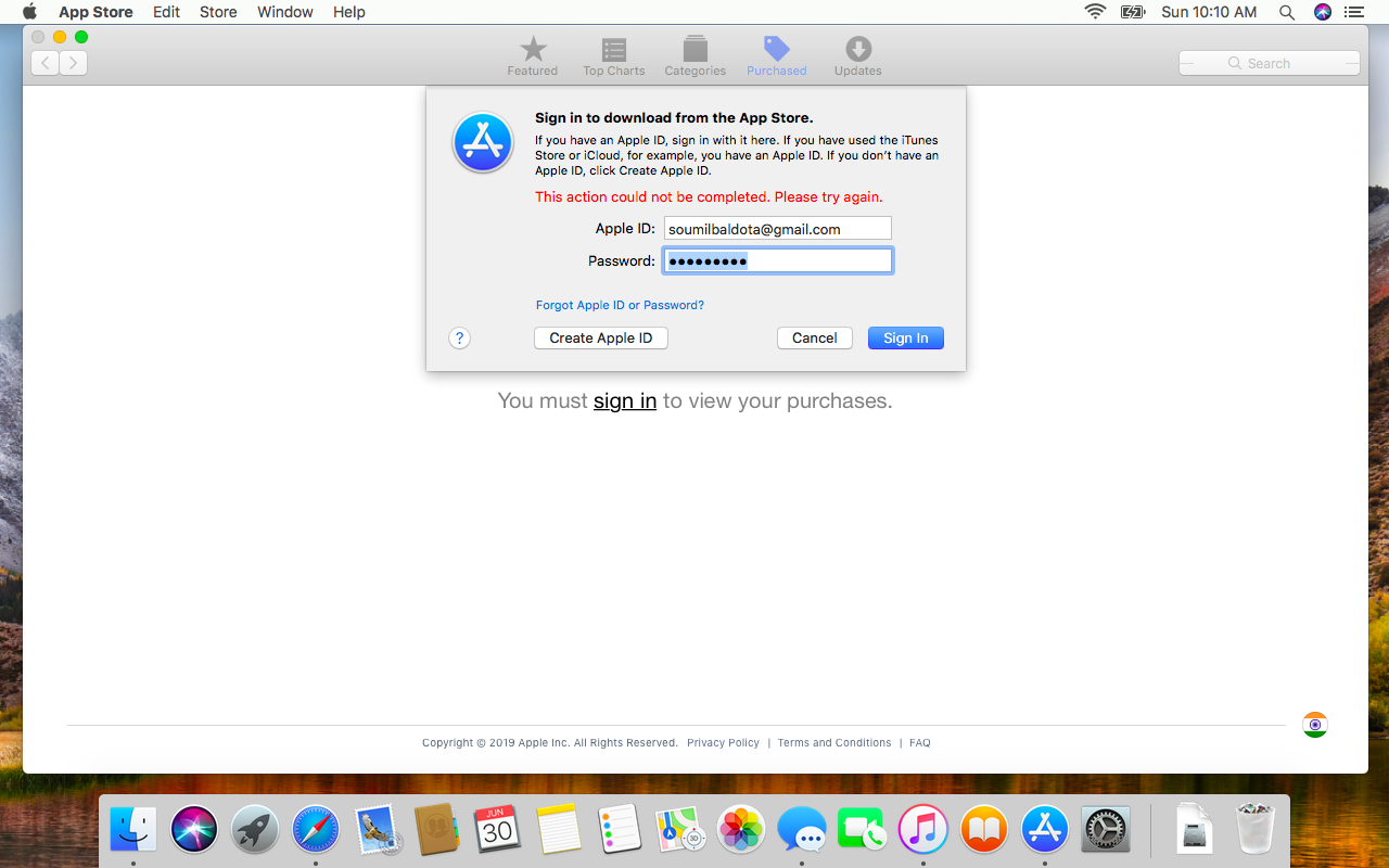

The appstore is still not working when i boot into lion 10.6.8 i can still sign in there but i am unable to sign into appstore on mojave

Can u please tell if u are having anyissues with the appstore or not , i am unable to sign in still

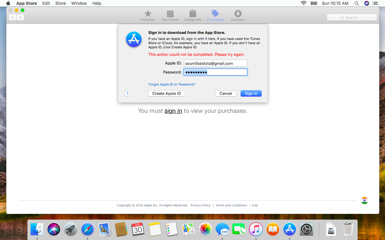

I am running Mojave on a MacBook 4,1 using Julian Fairfax's tool but I have a few questions on how to fix a couple issues
I downgraded to high Sierra still the exact same issues persisted (not using apfs patch, patched how the guide instructed by booting in the installer and typing patch into the terminal)
1)I cannot access the Mac App Store using my Apple ID
2)I cannot type anything into terminal as it shows the process is completed
3)The isight camera does not work
can anybody point me in the right direction , help out friend in need pls
1) has been encountered on various Macs, also supported ones - solution is to fiddle around with your account (logout, log-in, enable/disable/enable account). If to no avail, call Apple support!
2) close the terminal window _and_ quit the application, then start anew, then it works
3) known problem on this machine (in particular), no solution there yet (other unsupported Macs have this from time to time also, but at least principally can use iSight - not so on the MB4,1, sorry).

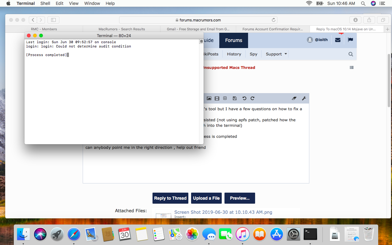

I have tried each every one of these things please help @Larsvonhier yet i cannot sign into the mac app store , terminal has returned to its former glory,and i dont care about the camera anymore please help

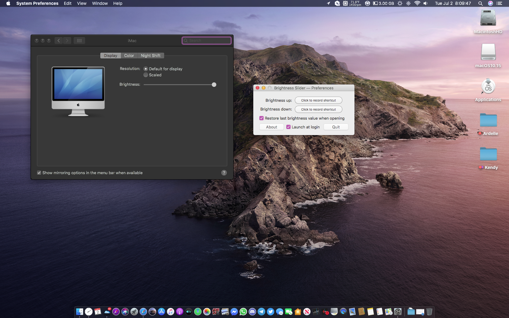

Yes brightness control is anises I do use the brightness slider it takes a little fiddling. I never mess with the slider in the display preferences but using the brightness slider once I find the brightness I like I make sure the restore last box is checked and it seems to work as well as launch ay login :)
Tim: I apologize for sounding stupid. I'm a bit new to this: I appreciate your response. But my question is: Before I downloaded the Brightness Slider, I had lowered the screen brightness to the system min using my keyboard buttons. When I returned to work I discovered that nothing within the system; keyboard buttons, display preferences, etc, was allowing me to brighten the slider to system max. In fact nothing had any effect at all. So I was stuck at system min.
Then I downloaded the slider. And even at the slider max the brightness only comes up to system min--which is where I was stuck to begin with. So even with the slider I can only max up to the system min.
Are you saying that fiddling with the slider may allow me to go back up to full? Or am I missing something you are saying?
This issue is mission critical to me as I need to deliver some Photoshop files to a client. Thanks for your input.

you need to put the display slider for brightness all the way up in system preference like in the screenshot because if you don't the brightness slider won't work and you brightness will appear dark the only I was able to fix was to reinstall Mojave then set my display brightness to full then toggled the brightness slide not quite full but where it was bright then made sure it restore to that setting each time I restart my Mac :)
Ok. That explains it really well. Thanks a lot.
