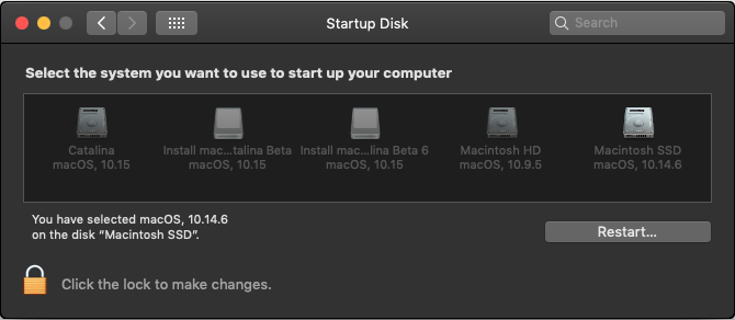

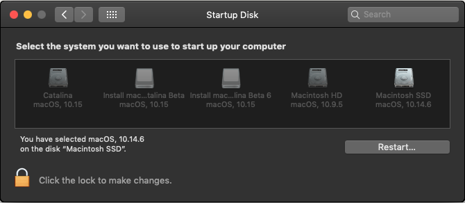

I have tried putting my High Sierra disk back in and still see the scrolling text. Thank you for your help!
I will also see a scrolling text if I don't do this. Please post a screenshot of your Startup Disk Preference Pane.

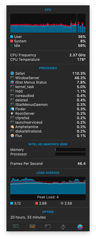

So it appears I am not getting any GPU Acceleration. I was just watching a twitch stream and noticed my CPU usage was very high but my GPU was at zero...
mini 5.1 10.14.6 Mojave.

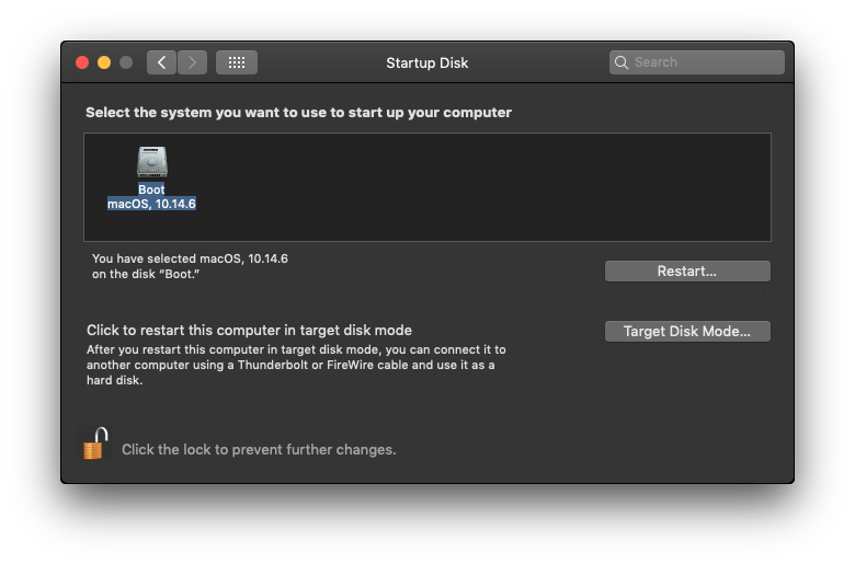

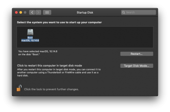

Here ya go!

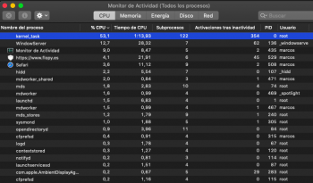

I notice a bug in my laptops running mojave patcher. I don't know if the bug is caused by the patch or the original Mojave OS (I only have unsupported laptops).
I notice that the "kernel_task" is consuming a lot of resources in "Activity monitor". See the image attached.
During this high consumption of "kernel_task", the system is very slow. Is very evident at boot (the system delay a lot of time to be operative).
I have a macbook 5.1 and a 5.2. Both have a very similar hardware and both have the same problem. May be a driver problem? I have an iMac 7.1 too with mojave patcher and I have not this problem. This laptops have windows 10 installed too, and i not notice the system slow at boot or during the use of windows 10, so i think that is a problem with Mojave or the patcher (@dosdude1 says in a previous post that some computers can have a sensor damaged, but i think that if my sensors were damaged, windows 10 may run as slow as mojave does, Isn't it?)
Other diference between the laptops and my iMac is that the laptops have APFS and the imac have HFS.
Anybody have this models with Mojave patcher and notice the same problem? Can anybody see the "activity monitor" and tell us if the "kernel_task" ins consuming high resources? Anybody have a solution for this?
Thanks

It most likely your hardware as Mojave is a perfection on my MacBook5,1(as well as Catalina Beta 6). "Kernel_task" consumes less resources than Activity Monitor itself(most of the time). I hope you are using good quality SSD's with plenty of free space available in your machines.

I have SSD's in both computers and botht SSD's works well. I have enought free space too.
Today i tryed to format the Mojave partition. When the installation was completed, the problem dissapear, so it might be a software problem. I made a change: Now i will use NFS instead of APFS. I'm restoring the time machine backup in the computer. When it finished i can see if the problem persists or the problem is related to APFS (I think that it must be the problem).
