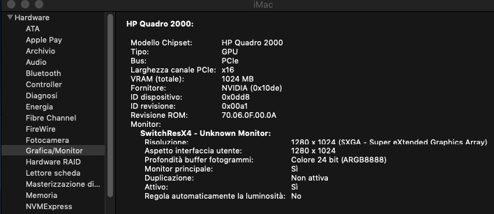

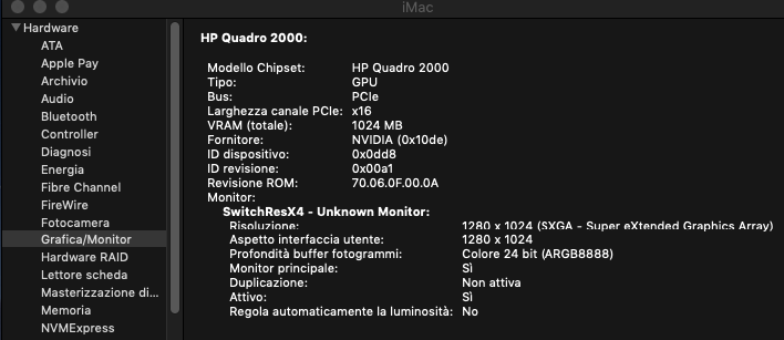

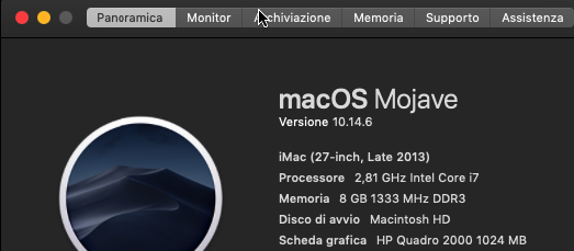

Hi @joevt , I have just tried a Display Port to HDMI converter connected to my Nvidia Quadro 2000 and LG M2352D TV Monitor. I have also managed to install Nvidia web drivers for the unsupported Mojave, following this tutorial that patches the original installer for my specific build of 10.14.6
I have obtained only a very strange behaviour: LG M2352D monitor doesn't show BIOS setup (black screen maybe for old Bios characters res) for selecting Mojave as first boot (but it is already setted in my configuration that works with VGA) . No effects pressing F8 or ESC on ASUS motherboard. But it automatically loads Windows 10 with perfect ratio and 1920x1080 resolution. With DVI to VGA converter Mojave loads fine, stable and fast, but it is always stucked to 1280x1024 @ 60 hz 5:4 ratio. SwitchresX4 app is useless to try to force other resolutions.

I think Apple removed support for VGA so I think you should use HDMI. What DisplayPort to HDMI adapter did you use? Did you try a DVI to HDMI cable (no adapter)?
I don't think you should use web drivers for Mojave.
What does "About this Mac" -> "System Report" show for "Graphics/Devices" and "PCI"?

I have tried an DVI to VGA adapter + VGA cable (works 1920x1080 with win 10, 1280x1024 on Mojave)
and
DISPLAY PORT to HDMI adapter + HDMI cable (works 1920x1080 with win 10, black display on Mojave)
The strange is that, when connected to HDMI, Windows 10 shows up only during second (graphic) booting, not showing motherboard startup options, that instead work with VGA connections for both Win & Mac
and
10de:0dd8 is GF106GL which is Fermi.
Did the GPU ever work properly before? Like in High Sierra with or without the Nvidia web drivers? If so, then post info from there (screen shots and kextstat).
Thank you. With High Sierra graphical glitches are even worses . I give up, I don't want to pay more for a 8 years old system. I hope that this year Apple will finally produce a new Macmini 2020 with 256 base SSD for 900€ and I will keep it until 2030 as I have done with the still fine working Macmini 2010 :)
