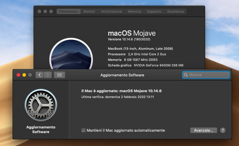

Latest update installed without problems on Macbook Late 2008. After the update I installed the Dosdode1 post patch via the usb stick and rebuilt the cache.

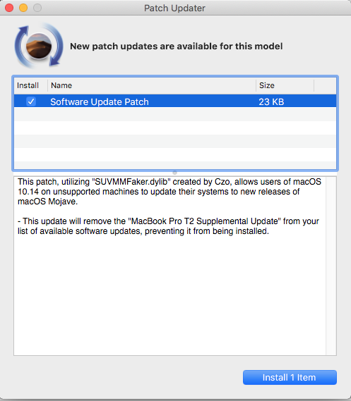

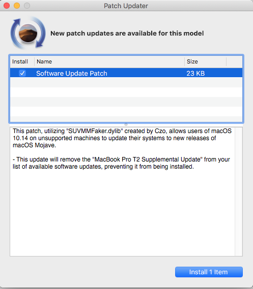

Second, any time I do one of these updates the patcher updater suggests I install "SUVMMFaker.dylib by Czo"
Doesn't seem it applies to my situation, since I'm installing a security update, not a 10.14 new release, and I don't have a MacBook Pro, or anything with the T2 security chip. So wondering if I should just skip it, even though it says "available for this model?"

Successfully updated macOS to the latest macOS 10.14.6 (18G3020) which installed the latest Security Update, Safari and Safari Technology Preview on my 17" Early 2008 MacBook Pro MBP4,1
I ran Software Update, rebooted from my macOS Mojave Patcher USB SSD, reapplied DosDude1's macOS Mojave patches including Force Cache Rebuild... AND then DosDude1's Backlight Patch bkltpatch10.14.2
Yes it takes a couple of restarts but simply AMAZING this 12 year old MacBook Pro can run a current macOS !!!
Thanks again DosDude1 !!!
My only wish is macOS Mojave Patcher would re-apply DosDude1's Backlight Patch bkltpatch10.14.2 during it's patching... instead of having to re-apply using Terminal each time. Oh well... Maybe someday. :cool:

Any idea about the Czo SUVMMFaker.dylib patch -- screenshot above? Needed or not?
Well, I don't know for sure because I don't think I've ever tried it but I don't see why you couldn't boot straight into the patcher - as long as it's on a connected volume, of course. Regarding the installer needing to finish something - if you think about it, it's KPing so may not be doing any "finishing up" anyway. Not sure what it does on the first execution of an updated system - re-index the drive, rebuild caches? I think it would do that anyway, after re-installing patches.
Sorry, but I don't know anything about Czo's patch.
Well, with a trusted backup (or two) at the ready might give it a shot next time. EDIT: remember now that the progress bar shows from start to finish at the restart, as if it were getting ready to boot normally, but then goes into the KP when done.

Also while you're around these parts, do I really need to install SUVMMFaker.dylib by Czo, screenshot above? Doesn't seem to be a fit for my iMac 10,1 + no more 10.14 releases expected. Cutting down on the number of restarts after one of these security updates, which are time consuming, would be welcome.

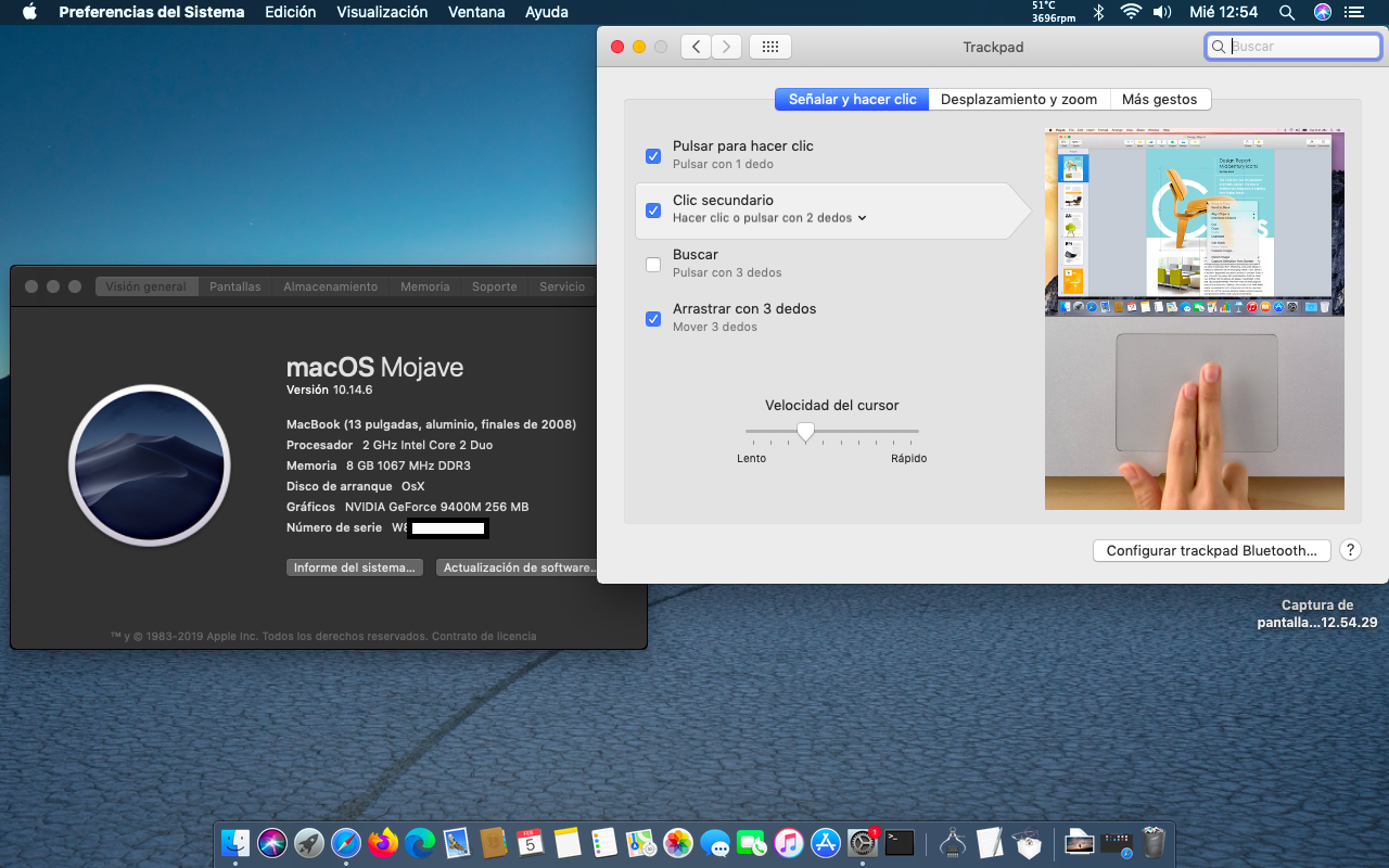

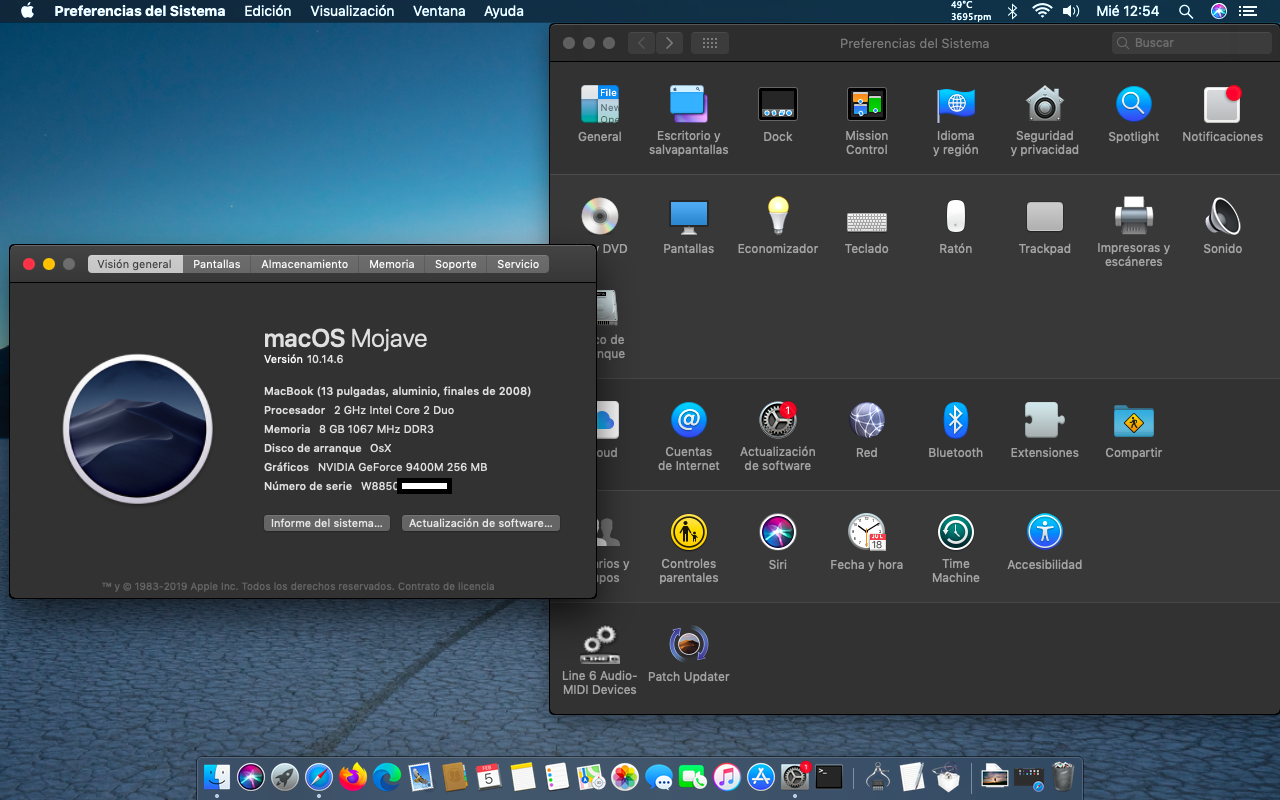

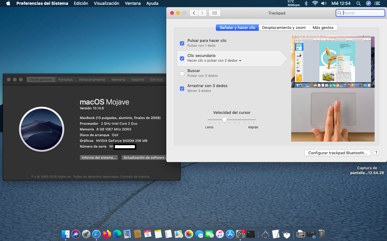

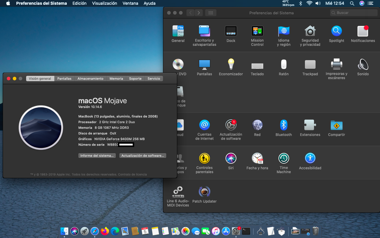

Hi Guys, another MacBook 13.3" late 2008 in Mojave 10.14.6 using HFS+ working 100%.
Macbook Late 2008 13,3" (5.1)
Intel Core2Duo 2Ghz
nvidia 9400M 256Mb
SSD 256Gb
8Gb Ram
Problem With Trackpad!, only detected as mouse, but.... SOLVED!
For anyone with problems with the trackpad, you can use your Trackpad Pref File from another yosemite installation (/System/Library/PreferncePanes). Just replace and reboot.
The only problem its with the color of the Tracpad Preference panel, this dont have "Dark Mode", but.. this is not a problem.
Hope this can help someone. Thanks to everybody.
Link to download Trackpad Pref Panel from my yosemite Installation:
Tested and working 100%. All original features Works Perfect.

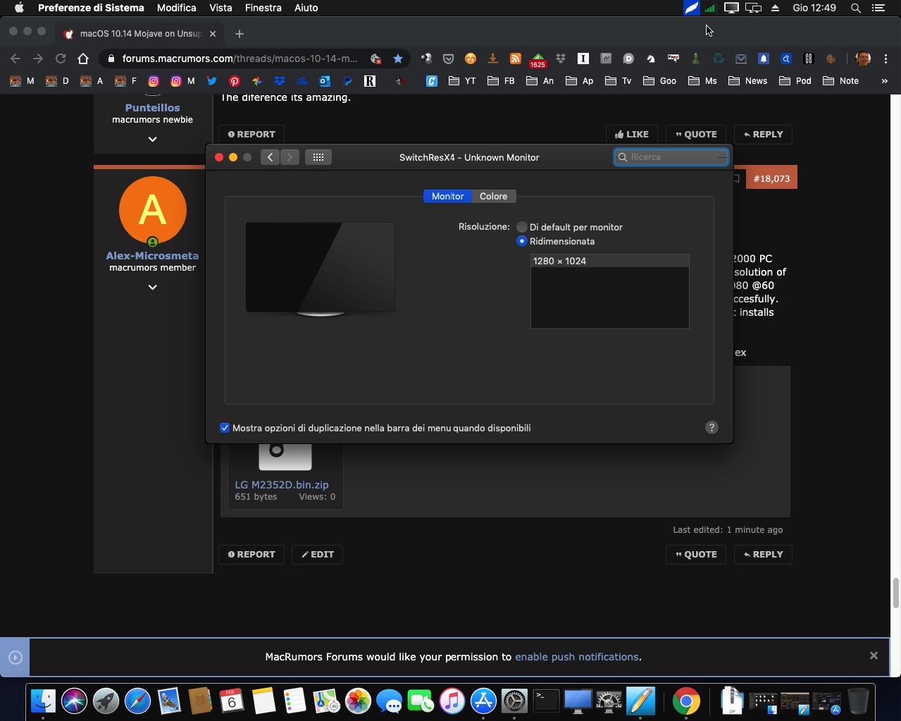

Hello, I have a problem after the 2020 security update. My second screen is no longer detected at startup. I use a GTX 680. Everything works good before this 2020 update…
I have reinstalled all the patches (1.3.7)… help :)
Intel Core2Duo 2Ghz
nvidia 9400M 256Mb
SSD 256Gb
8Gb Ram
This is very strange. I've never had any issues with the trackpad on my MacBook5,1. I believe it is the MacBook5,2 that has the issue as it has a retro trackpad with the button a la mouse.
Finally i go back to the 10.14.6 stock version with a clear installation, and all comes to normallity, this update broke some drivers i think.... becouse the performance its horrible.
The diference its amazing.
Hi @dosdude1 @ASentientBot !
If I'm off topic here, I anticipately sorry, please move my question on the right place.
I have succesfully installed macOS Mojave 10.14.6 on a Core i7-860, Asus P7P55D and Nvidia Quadro 2000 PC with Clover bootloader (it starts from an USB pendrive) using DVI connection. All works fine, but the resolution of my TVMonitor LG M2352D is stucked at 1280x1024 4:3. With Windows 10 the display works fine 1920x1080 @60 Hz, so I have tried SwitchResX4 and some EDID editors (exporting the right EDID from Windows) unsuccesfully. Then I have found your "Fix old Nvidia cards V1" patch, (Nvidia web drivers are available until 10.13) It installs correctly, but nothing happens after rebooting. The only workaround that I have found for the correct ratio is to force the display to 4:3.
I attach the right LG EDID extracted from Windows 10. Any idea for how to fix my issue? Thank you, Alex
  • LG M2352D.bin.zip
Me too - Go Back to 10.4.6 (18G103) with clean install. Works fine :).
Careful with last security update 2020 MP 3.1
How is the display connected? Probably Single Link DVI to HDMI? If so, you could try using a DisplayPort to HDMI adapter. There's two kinds - passive and active. Passive requires that the DisplayPort output supports DisplayPort dual mode (does the Quadro have that?). Active might be better in your case sense the GPU will send a DisplayPort signal instead of HDMI. You can get a DisplayPort 1.2 to HDMI 2.0 adapter (but your TV only needs HDMI 1.x) which are always active.
