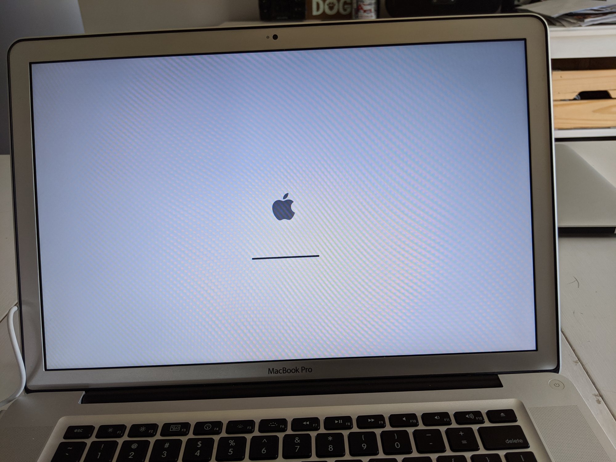

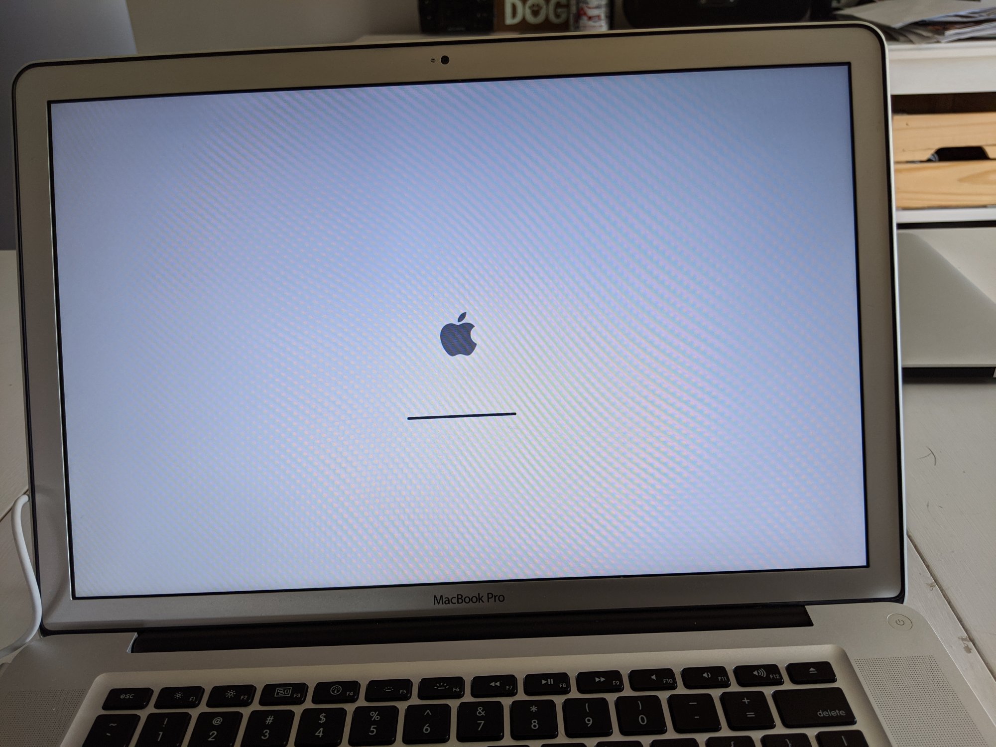

Hopefully someone can help me. I made the bootable usb drive and I select the drive when I boot up my mac, but it keeps getting stuck loading
here. I have tried two different bootable USB drives and I'm having the same issue on both.
Reactions: TimothyR734

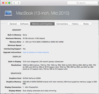

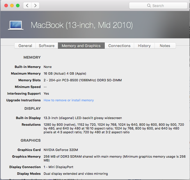

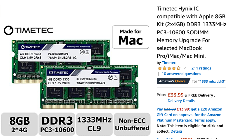

Hi,
i recently updated my Macbook mid 2010 to mojave which has been working very well but I have figured out i now need to upgrade my RAM to 8GB to make it faster which is supported even though officialy it dosent but has been proven it works.
Looking online i have come across one ram kit on Amazon which dosent say my specfic model but still says it is compatible for all models around this time of 2010 to 2011.
I was just wanting to know if this will be compatible with my Mac and if any negitive effects could come from upgrading the ram on a mac running unsuported system (mojave).
Thanks
This are my specs

Hi,
Thanks
View attachment 899410 View attachment 899411 This are my specs
1066 Mhz DDR3 is key for that MacBook. CL9 nope. Apple thinks DDR3 is 1067 Mhz.
here. I have tried two different bootable USB drives and I'm having the same issue on both. View attachment 899300
Try resetting the NVRAM, three strokes. Then boot from USB patcher.
Also boot into your Mojave Patcher in the terminal type csrutil status make sure your SIP is disabled if not type in csrutil disable

Hi,
Thanks
It probably won't work. MacBook mid 2010 uses PC3-8500 (1066 MHz) and those are 1333MHz.
