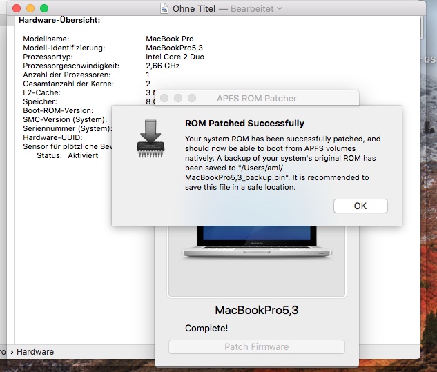

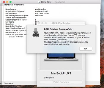

Hi, i come from High Sierra (High Sierra Patcher), was HFS+ and patched the MacbookPro 2009 MBP5,3 ROM with APFS ROM Patcher to have APFS support within the ROM (normally hasn't APFS support!, need APFS preboot patch).
PS: EEPROM Type was an SST ... not MX ... EEPROM. APFS ROM Patcher showed no list ( I seen an screenshoot with 3 MX .. EEPROMS to select , my SST EEPROM seems to be sure detected, so no such list for selecting the right EEPROM)
I erased the SSD und formatted it with APFS before I used the Mojave Patcher to install Mojave and got Mojave installed with a no problems. Running well, also all devices like iSight, Bluetooth, Wlan.
BUT: I see now the APFS EFI patch (EFI preboot verbose text) - so I may have installed / selected APFS patch by mistake OR the Mojave Post Install Patcher patches always APFS for that MBP 5,3(hasn't normally APFS support).
HOW to remove this APFS Patch = no more verbose EFI bootet text- for an patched MacBookPro ROM usage to boot native - I think it resides somewhere in the EFI Partition (normally invisible).
If its to risky, I would let that short verbose boot, no question. But I can handle the terminal / advanced OS X knowledge to do something if you have HINTS to remove that APFS patch/ reboot verbose text.

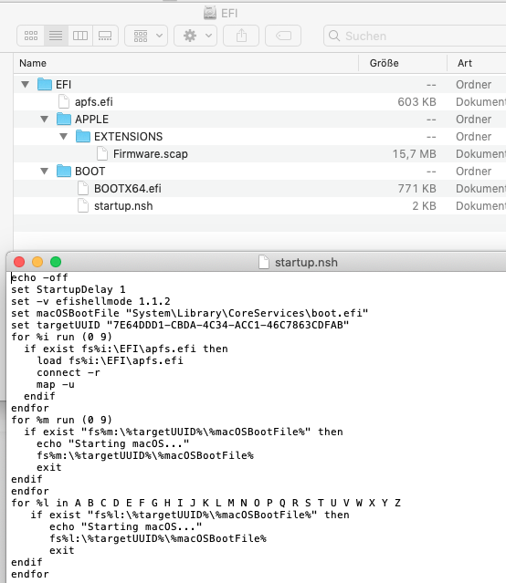

EDIT: I investigated where the APFS Patcher could be.
Found some shell script in the Volume EFI, looks like it could be the place where the Post Install Patcher changed something for non native APFS Macs.
Anyone knows what to change / remove or replace to get native APFS boot ?
Remove apfs.efi and BOOT folder. The bootx64.efi is a renamed EFI Shell that automatically launches startup.nsh which loads the afps.efi driver, rescans for apfs volumes, then tries to boot the Mac OS boot.efi file from the Mojave disk, and if that fails it looks at all other disks.
It looks like you have an old version of the APFS patch (the for loop is wrong - drives are not numbered A-Z. They are numbed as hex)

THanks for the Info about removing APFS EFI patch ( reason: I should have apfs native now by the APFS ROM patcher) . I will try. (general work with/in the EFI Folder is well known for an hackintosh user ;) )
EDIT: WORKED with the instruction from joevt
Before I did removing BOOT folder + the apfs.efi from my SSD Boot volume ( mounted invisible EFI Volume to do that!),I tested if my MacBookPro 2009 5,3 really can boot APFS native by the APFS ROM patcher (tells success, but better test it ;) )
I formatted an USB Stick with APFS and cloned my working SSD HD Mojave system on it with CCC.
In this case, I am sure the USB Stick hasn't anything within the EFI volume.
Bootet with success from the APFS USB Stick :) !!! So I made the changes in the EFI volume of my SSD HD.
Also boots without the apfs efi verbose screen native on my SSD HD.
Thanks to dosdude1 for the APFS ROM patcher and many wirings her to be sure to NOT flash if the patcher asks for EEPROM type you don't know! In my case the ROM patcher didn't ask to select an EEPROM type, it detects my SST .. EEPROM type & knows to it for flashing with success.
IDEA: Perhaps some Info in the FAQ of the patchers for same tasks like me would be great - remove apfs efi patch after flashing patched ROM for native APFS booting.
