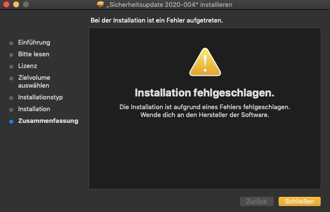

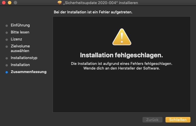

Having a problem with installing SecUpd 2020-004 on my HFS+ install,
did all the usual with modifying the distribution file as I have done before
but comes up with an error while validating,
"The connection to service named com.apple.package-script-service was invalidated." UserInfo={NSDebugDescription=The connection to service named com.apple.package-script-service was invalidated.}}} {
any clues?
The same here, not able to install 2020-004

That is a different error from my problem, download the attachment from TimothyR734
and read its contents.

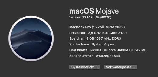

The revision number or build number is hidden by default in About This Mac, if you want to see it
move the cursor over the text Version 10.14.6 and click on your mouse or trackpad, you may have
to use the Control key as well.

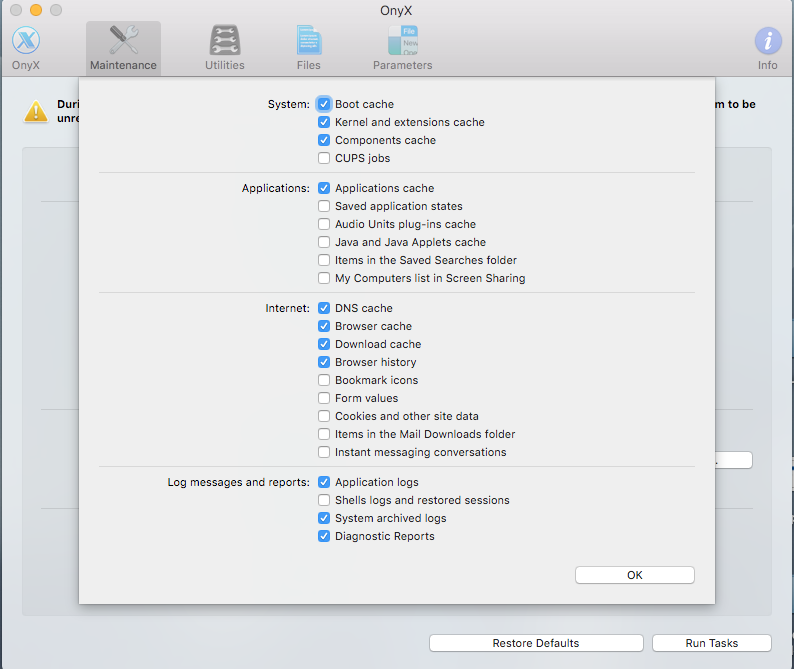

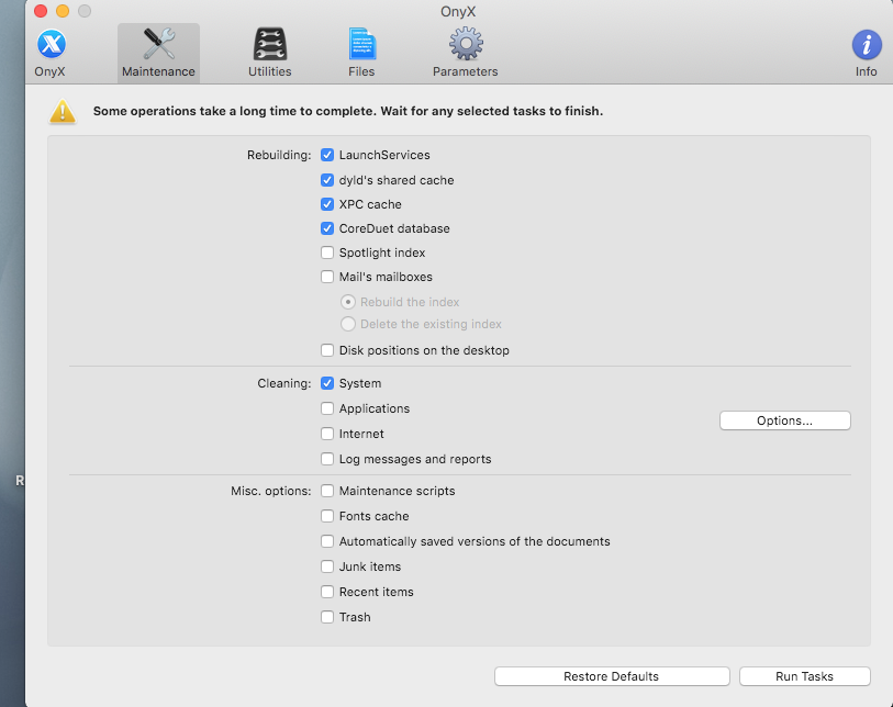

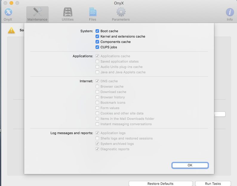

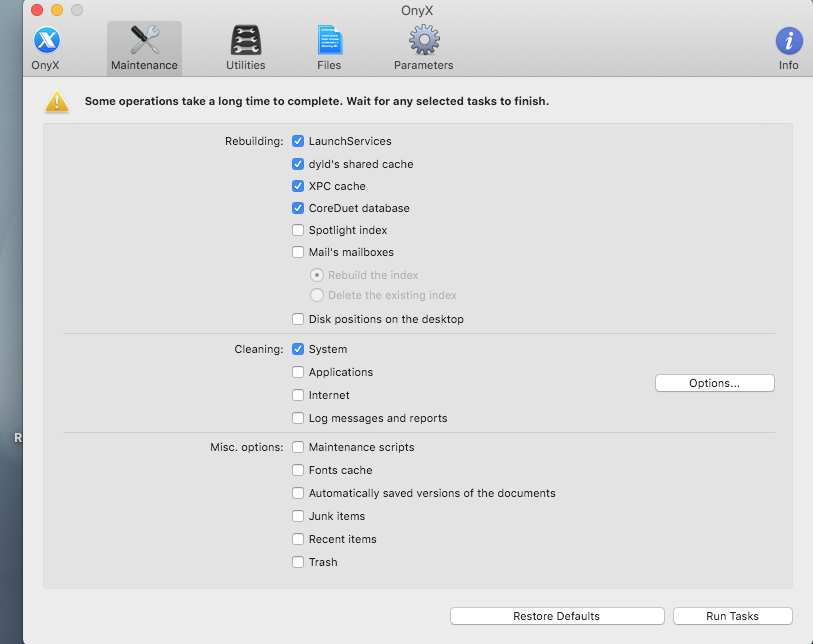

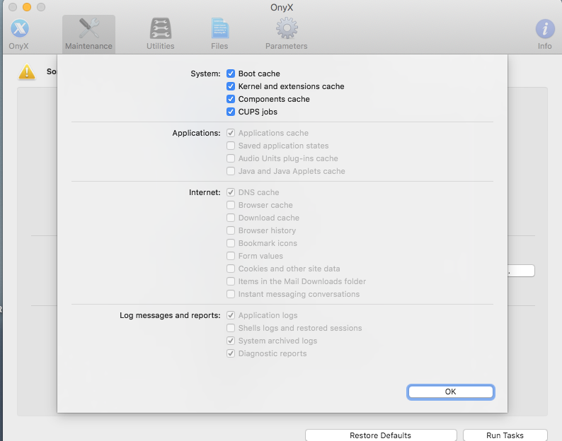

Re. running Onyx Maintenance after installing SecUpd, wondering just what items are recommended? (EDIT: don't understand why images are doubled. Don't see any way to remove the dupes.)

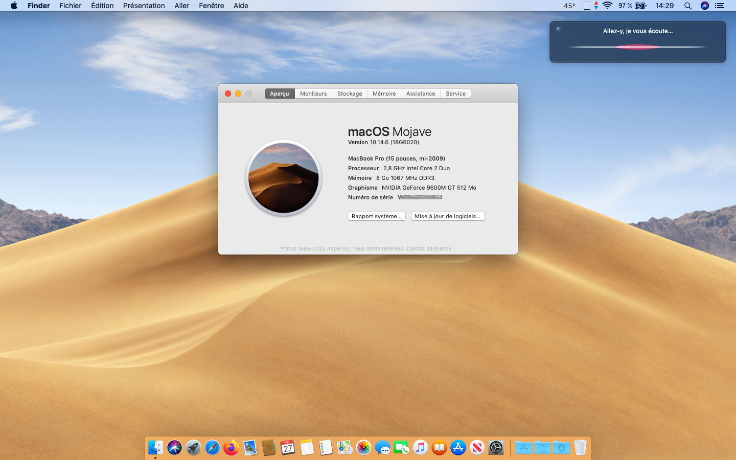

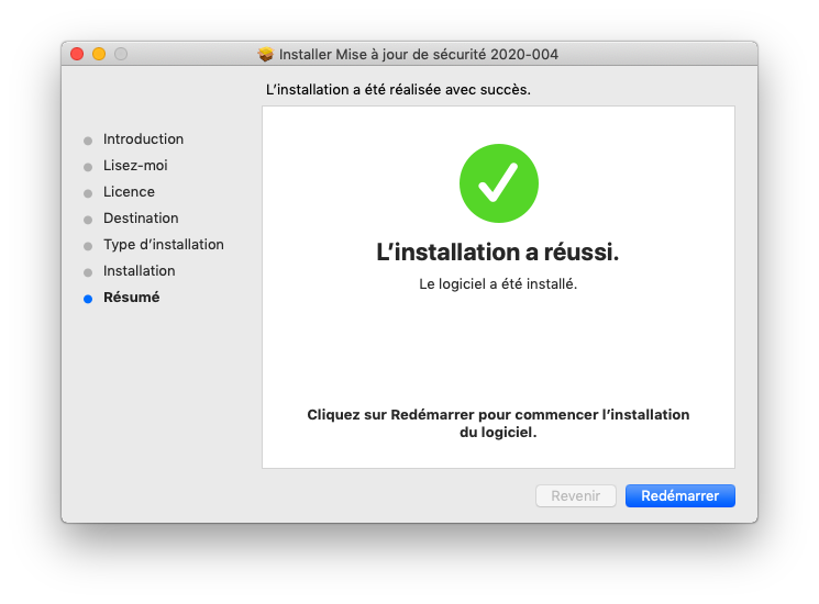

Hi all,
Mojave SecUpd2020.004 (18G6020) successfully installed on MBP5,3 and iMac8,1 a few days ago (After Distibution file modification)
Reapplied Postinstall with Force Cache rebuild at the first restart after update.
Like the other times, I replaced AppleGVA.framework (for videos fluidity), HIToolbox.framework (for dock menu shadows), SiriUI.framework and Siri.app (for waveform) and SoftwareUpdate.framework (to disable the Catalina upgrade proposal).
Everything works well

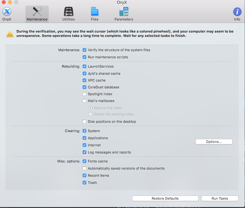

See that option "Restore Defaults"? Click there and then "Run Tasks"
Luis, thanks for the quick reply. But perhaps you can explain why all of the items which appear in Restore Defaults would be necessary? Thinking that rebuilding all these caches will be time consuming and produce a great deal of beach balling. For example, the DNS or browser caches/history (browser cache/history I always deal with independently), Recent Items, Applications Cache, Fonts Cache. Perhaps you can say just what the minimum is for a satisfactory result? Would think that just the items checked in my screenshots in my first post would do the job. Besides those, can you say what others are really necessary, and why?
