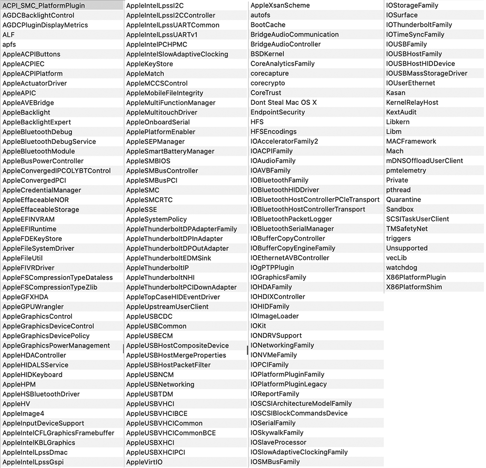

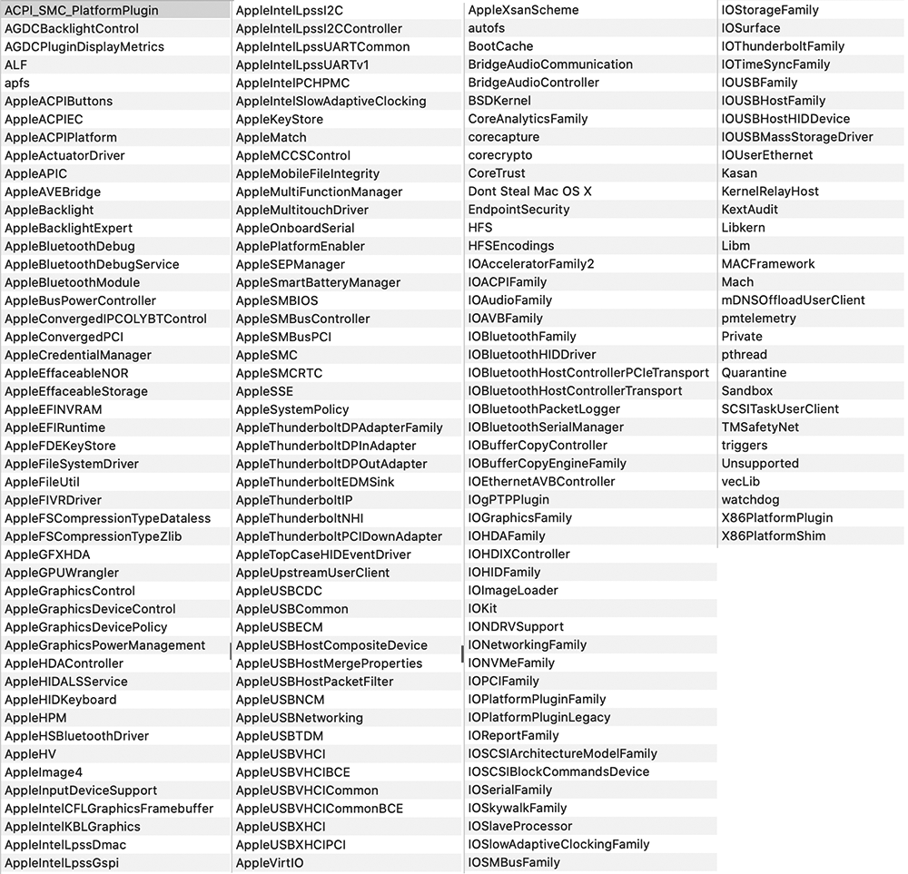

I am not sure what you are talking about. In my screenshot you will see the 4 kexts you need from Catalina.
Thanks for your continued efforts, but I don't think that's right.
The above list shows every loaded kext I'm running in Catalina.
IO80211Family
IO80211FamilyV2
IOAccelerator2D
aren't loaded and WiFi still works.
I've also since removed IOAcceleratorFamily2 and WiFi continues to work. So unless they can still function without showing as loaded under System Report (possible?) those four kexts don't seem to have anything to do with WiFi on the 16,3 under Catalina.

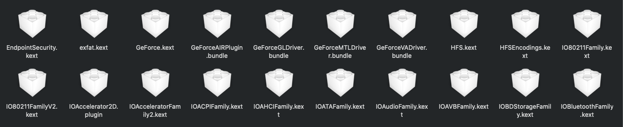

Just to be certain I took your advice and loaded Catalina's:
IO80211Family
IO80211FamilyV2
IOAccelerator2D
and loaded them into Mojave. No WiFi. But I did lose Display scaling.
Under System Report the four do show as signed, but none of them are loaded.
IO80211Family
IO80211FamilyV2
IOAccelerator2D

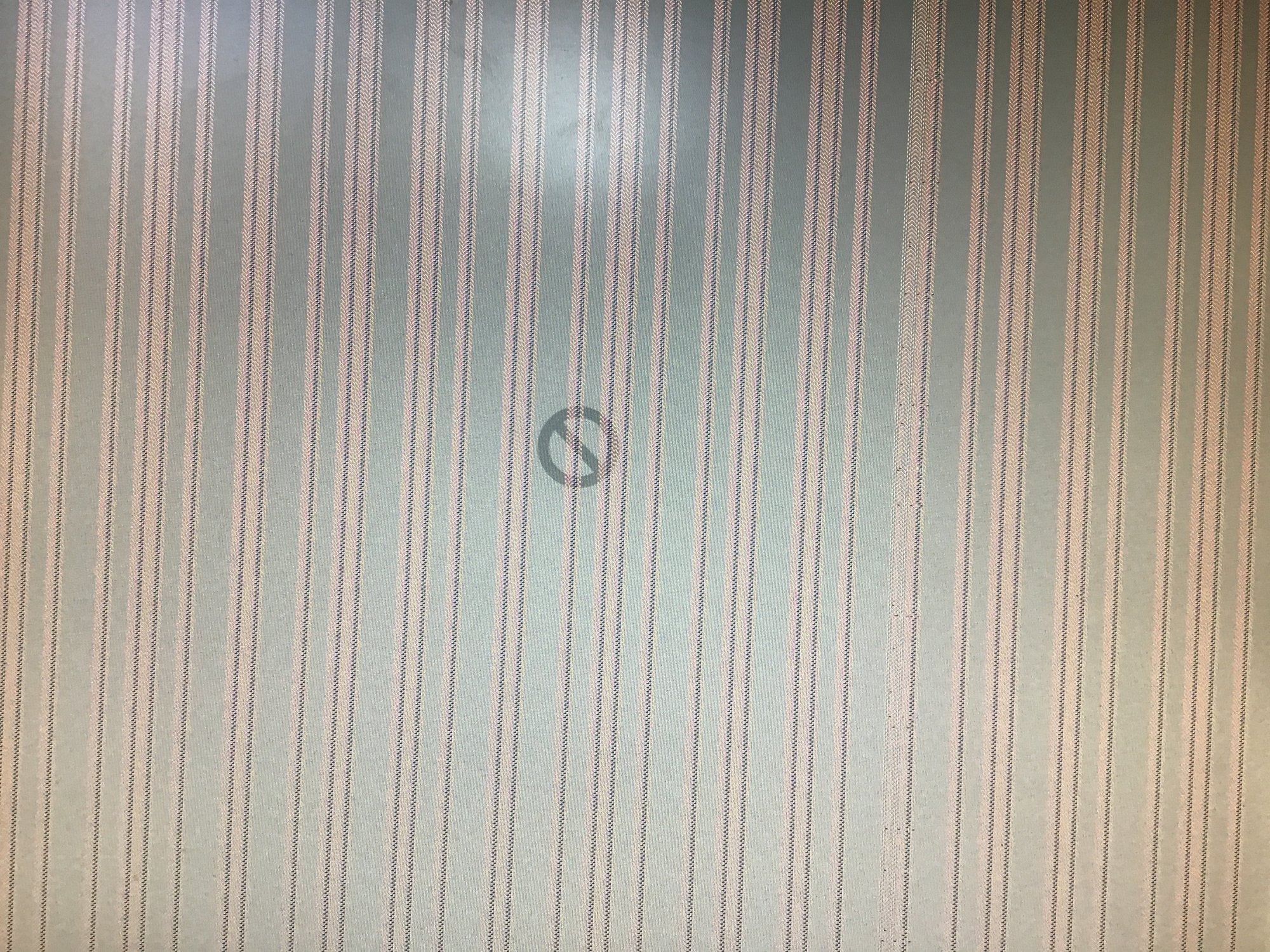

doesn't work, it goes to this screen. the lines are just from my old gpu that I use for troubleshooting, I don’t have a boot screen with my other card.
So, I just gave it one more shot.
I have a usb with multiple partitions, on each of those partitions I have a version of mac os.
I created a new partition on that usb and tried to boot that, and..... YES! It booted right into the installer and I just reapplied all of the patches and mac os booted normally.
I also can confirm that the issue was the software update, because when I logged in I got the setup you get with every update. My mac is now on the newest security update and boots way faster because I removed the raid card.
I don't know why my mac rebooted to do the update, because I don't have auto update enabled. Is there a method to disable this auto rebooting?
So, thanks for the suggestions, I have my mac back.
