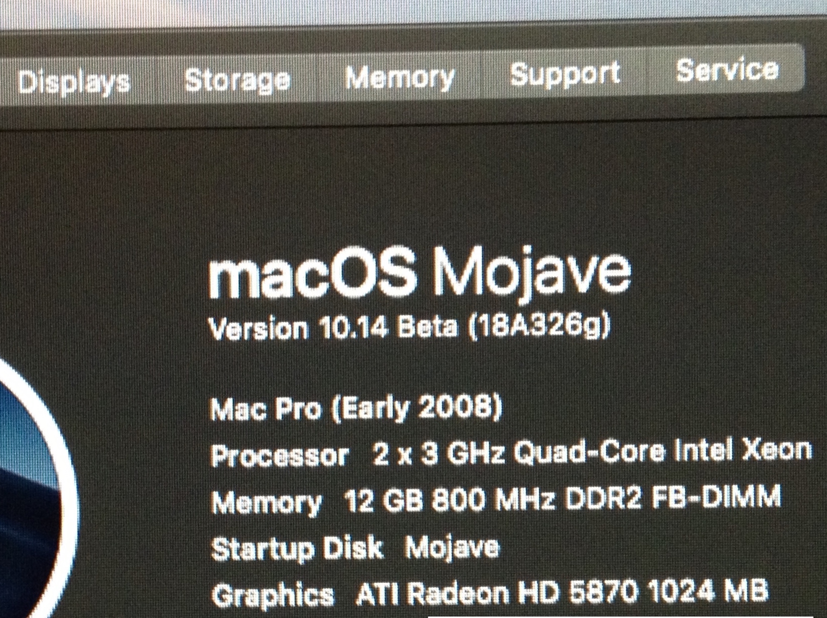

with help :) I did the complete Beta 3 install on a 3.1 with a Apple OEM HD5870:
- Took Apart Instal ESD
- patched OSInstall.mpkg
(Distribution File, pulled nonSupported, added Board ID)
- rebuilt OSInstall.mpkg
- copied the content of install esd in a folder plus the patched OSInstall.mpkg
- run OSINstall.mpkg
(system installed by installer app)
(installed system was missing boot.efi)
-copied boot.efi from Mojave bootstick
(or payload usr/i386)
-swapped Platformsupport.plist from High Sierra
-replaced system/library/UserEventPlugins with the content of latest High Sierra Installer
Finder was laggy, fullscreen Video played ok (guess this is missing metal on my gpu)

With "my" method the amd5 is not crashing on MacPro3,1 Stock HD5870. But not accellerated in Finder and Safari. Further testing tomorrow, its late here...

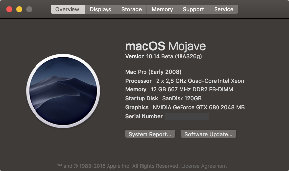

Mojave DP3 on a Mac Pro 2008!!!! SafeMode works.
What I did:
Cloned my Mojave DP3 install onto a HFS+ SSD with CCC (haven't added APFS to the BootROM), copied /System/Library/UserEventPlugins folder from 10.13.5, copied /System/Library/CoreServices/PlatformSupport.plist from El Capitan (easier than add my board-id), added boot-args="-v -no_compat_check" to the nvram.
The first normal boot didn't work but rebooting on SafeMode works.
Rebooted again and this time worked even without SafeMode. eVGA GTX680 for Mac works with native Nvidia drivers with both my monitors (DVI-1 and HDMI). USB and Bluetooth works but no Wi-Fi [Atheros 9380 AirPort Extreme (0x168C, 0x3112)] and no audio.
Edit: SafeMode/SingleUserMode, board-id, USB.

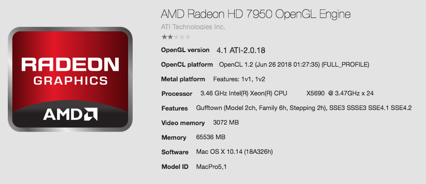

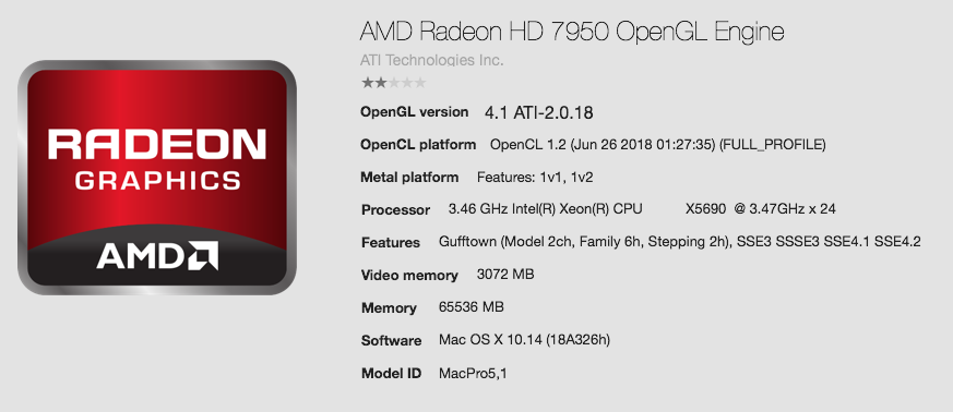

Regarding AMD Radeon HD 7950, was using with 3 x Apple 27" LED Cinema Displays (mDP model) under HS just fine on my cMP 5,1. After successfully installing Mojave -- all versions up to current PB2 -- only the two displays I have connected directly to the Mini DisplayPorts work. The third monitor not working in Mojave I have connected to the DVI port using a DVI to mDP converter. Note that no drivers are needed for this converter. Thoughts as to why? I know we are still in Betas, but just curious for those with more knowledge on the details. If I reboot into HS, all three light up during boot per normal behavior.
My questions are:
1. Is this software-related to Mojave?
2. Is this impacting the DVI port specifically?
3. Is this just limited support at this stage with only supporting 2 monitors max in Beta?
My questions are:
1) Yes, every year this happens when beta testing and sometimes even on GM.
2) No, seems a problem with the frame buffer/personalite, even changes what it's the first output.
3) Yes, the beta driver problem happens every year, since at list ElCapitan betas.
My questions are:
Uh, you are using Sierra drivers to enable HD7950? Since 3,1 does not support SSE4.2.
Edit.: Nevermind, 5,1...
My questions are:
Kinda strange. My Mac Pro 5,1 works fine using the Dual DVI connector running Mohave.
