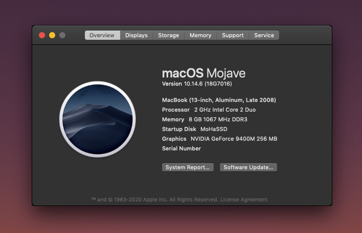

It is very hard to troubleshoot over the internet. I don't think that my Late 2008 MacBook is vastly superior to whatever hardware you are running, so at this stage I am out of ideas.

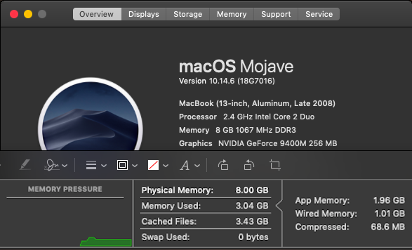

Btw, Memory usage in 10.14 not impossible, but not greatScreen Shot 2020-12-28 at 10.49.21 AM.png

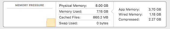

Btw, Memory usage in 10.14 not impossible, but not greatView attachment 1702396

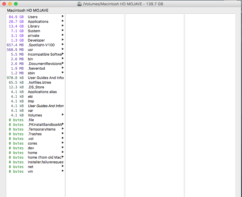

Btw, what the size of your System 10.14(Just the system files)? Mine is around 30GB, so if your partition did not have enough space to begin with, a recent doubling up of the System size(seems to affect a non-Apple 3rd party drives) is not going to help your case.

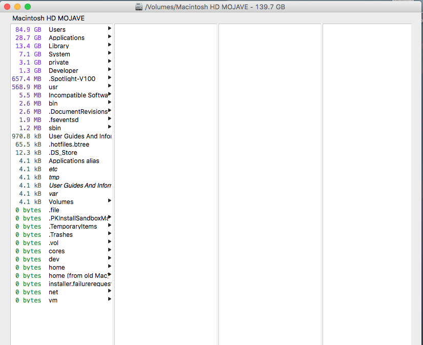

Loads of space, 115 GB overall available (from iMac 10,1, but similar percentage wise on Mini)
System (strictly) only 7.1 GB. But perhaps you mean mostly everything apart from User. See screenshot from OmniDiskSweeper (run as root)

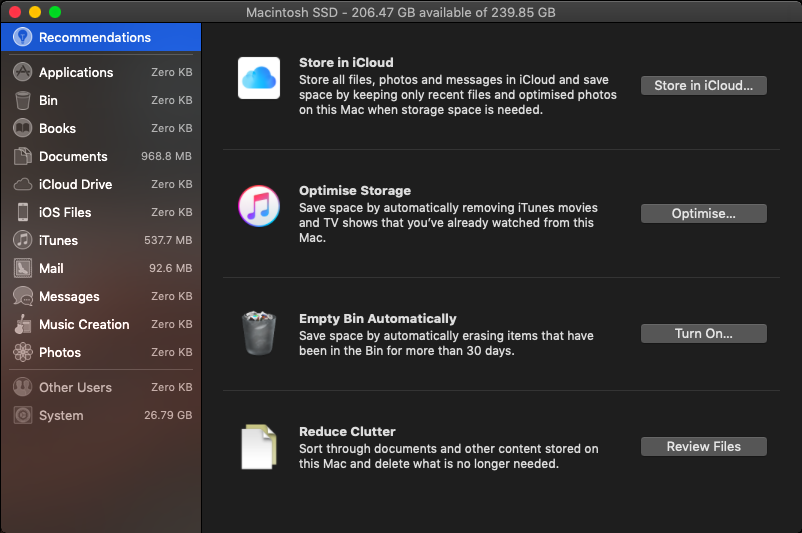

What about the Apple's native About This Mac/Storage/Manage?
