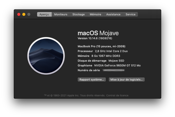

Hi all,
Successfully updated MBP5,3 (HFS+) with SecUpd2021-004Mojave (18G9216).
After, installing this update, needed reboot on USB Key and re-patch with Dosdude1's Patcher with force cache rebuild.
As every time, appleGVA.framework, softwareupdate.framework, HIToolbox, Siri.app and SiriUI.framework (for Siri waveform) have been replaced.

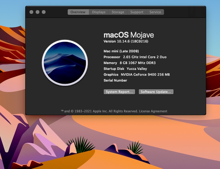

Ran SilentKnight>reboot into v.1.3.7 USB, re-apply, Force Cache Rebuild, re-boot into -
FWIW - The dynamic .heic desktop pictures from Big Sur work great in Mojave. Shown is 'The Desert' 😎

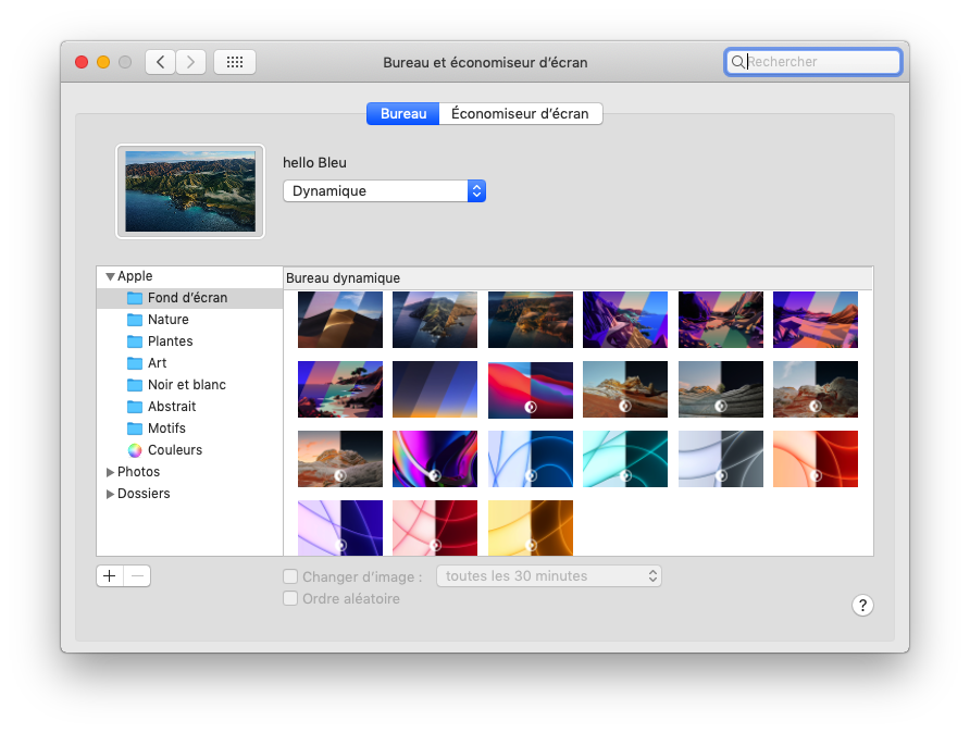

Thanks @K two for the information about "trustd" high CPU usage, I also got that but after the 2021-003 SU, I used the excellent Onyx and everything was fine.
Yes, Big Sur's .heic wallpapers work very well under Mojave (I've been using them for almost a year, and I'm currently using "blue hello" from 11.3)
But I've found that for a better reactivity of the thumbnails display in "DesktopScreenEffects. prefPane" of the System Preferences, it is advisable to add the thumbnails in the hidden folder ".thumbnails" (in the "Desktop pictures" folder) but also to add each added wallpaper name in the hidden file ".orderedPictures.plist" (also in the "Desktop pictures" folder) like this:
