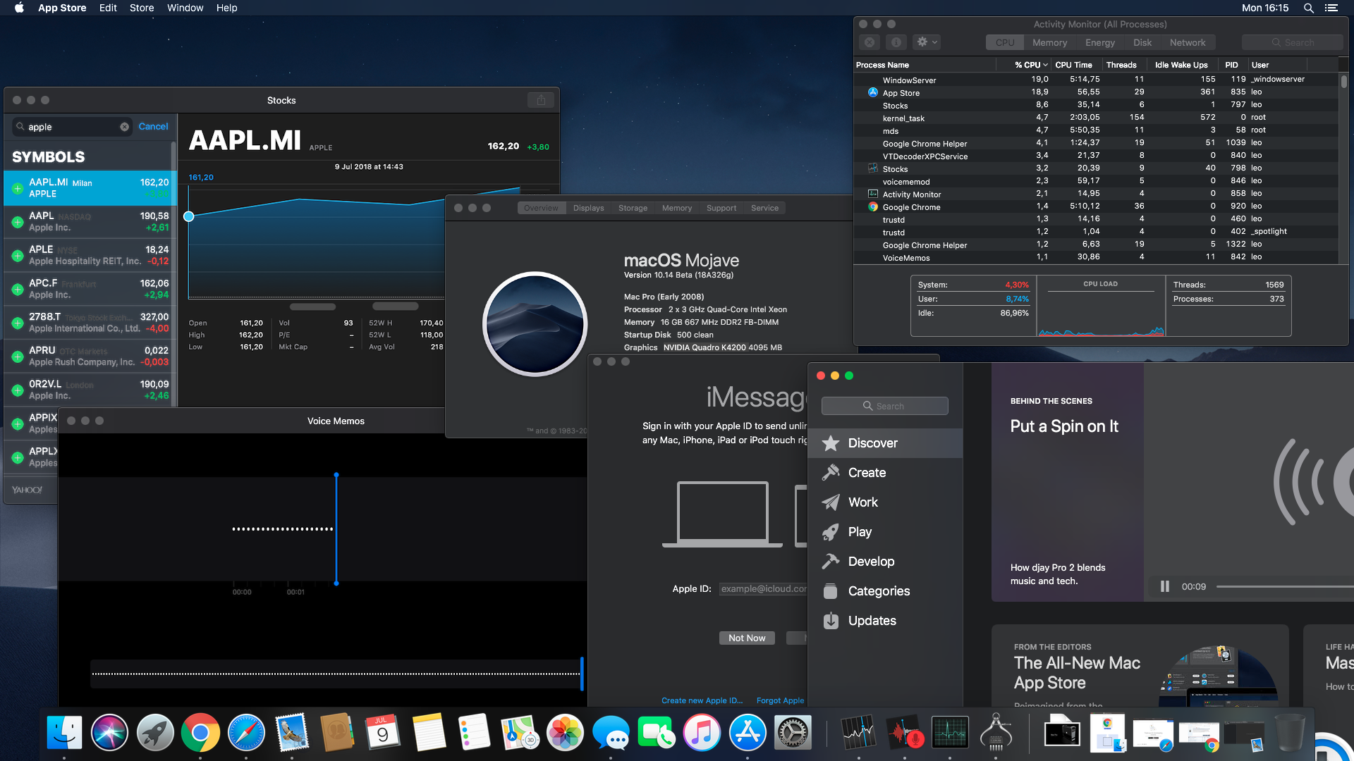

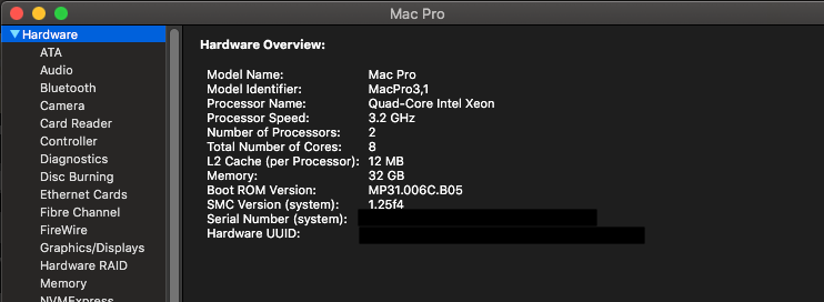

Now working fine on MacPro 3,1 with boot rom flashed for APFS support. The only thing I can see that is NOT working is Bluetooth, which is a little odd b/c this 3,1 has an upgraded BT4LE/wifi card from a 2014 iMac and the wifi side of the card is working fine.
The GTX680 shows up as normal and no screen tearing or issues that I can see so far. iCloud in Messages is working as is email.
I'll play a bit more and report back what I see if anything.
I think the S/H value of Mac-flashed EVGA GTX 680 cards will rise!

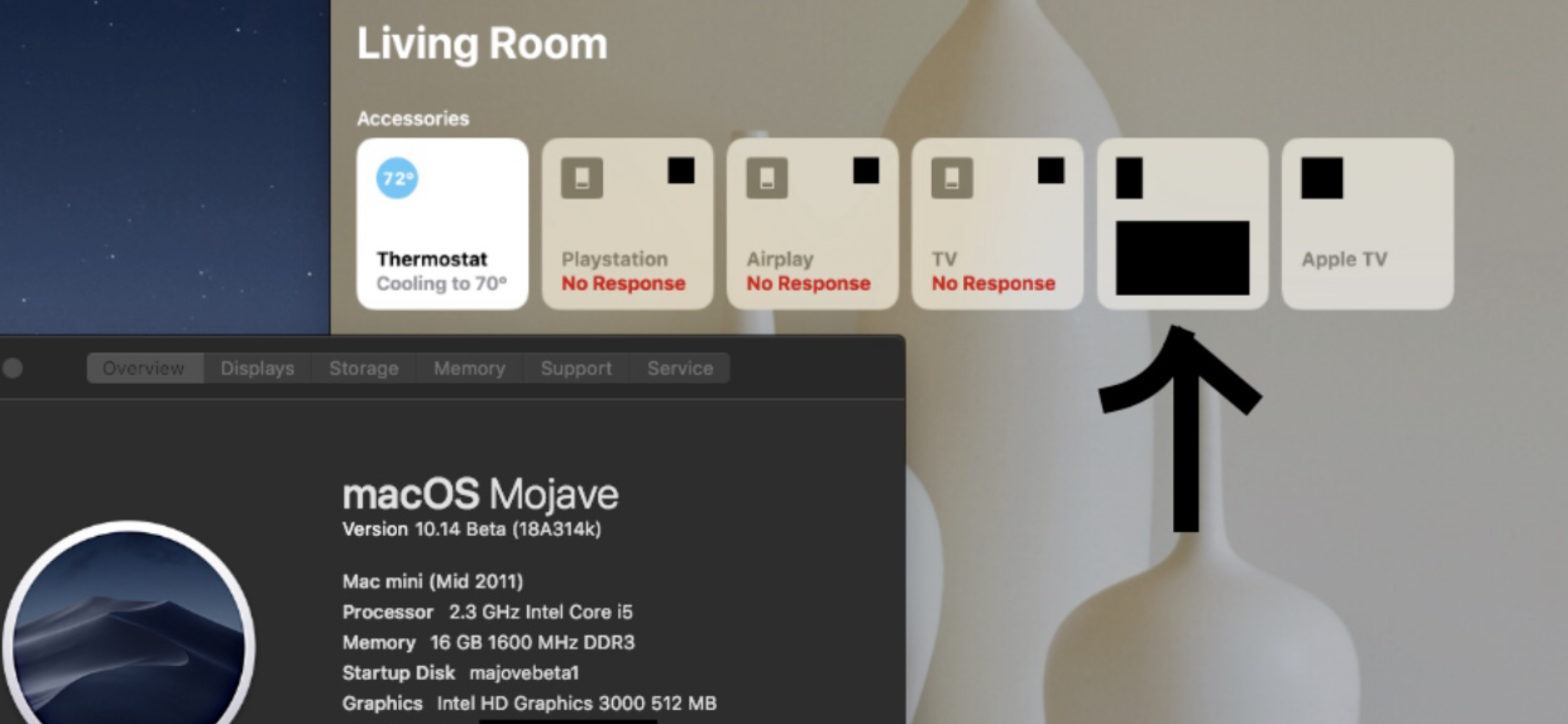

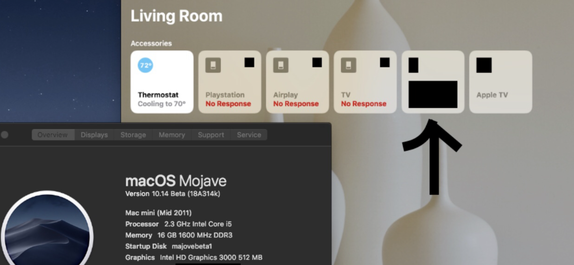

On my MacMini with Intel HD Graphics, system is running great thanx to your patch. But I do have some graphics issue in the new apps Apple
has converted from iOS to MacOS such as News and Home, black boxes appear instead of certain icons as seen in picture. Any ideas of cause?

No, as it will cause a kernel panic on login. As of now, it only works well on Intel HD Graphics.

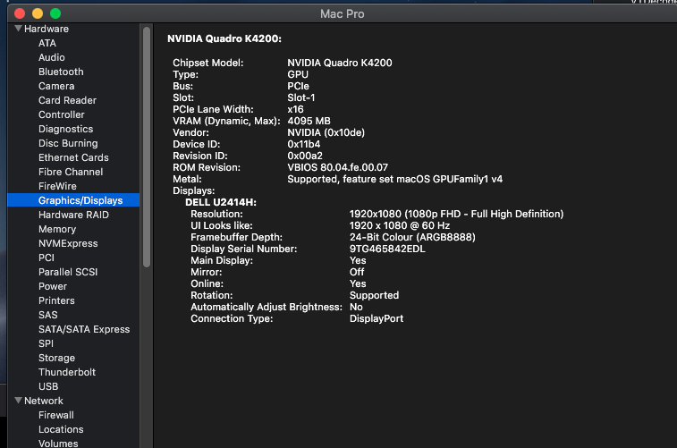

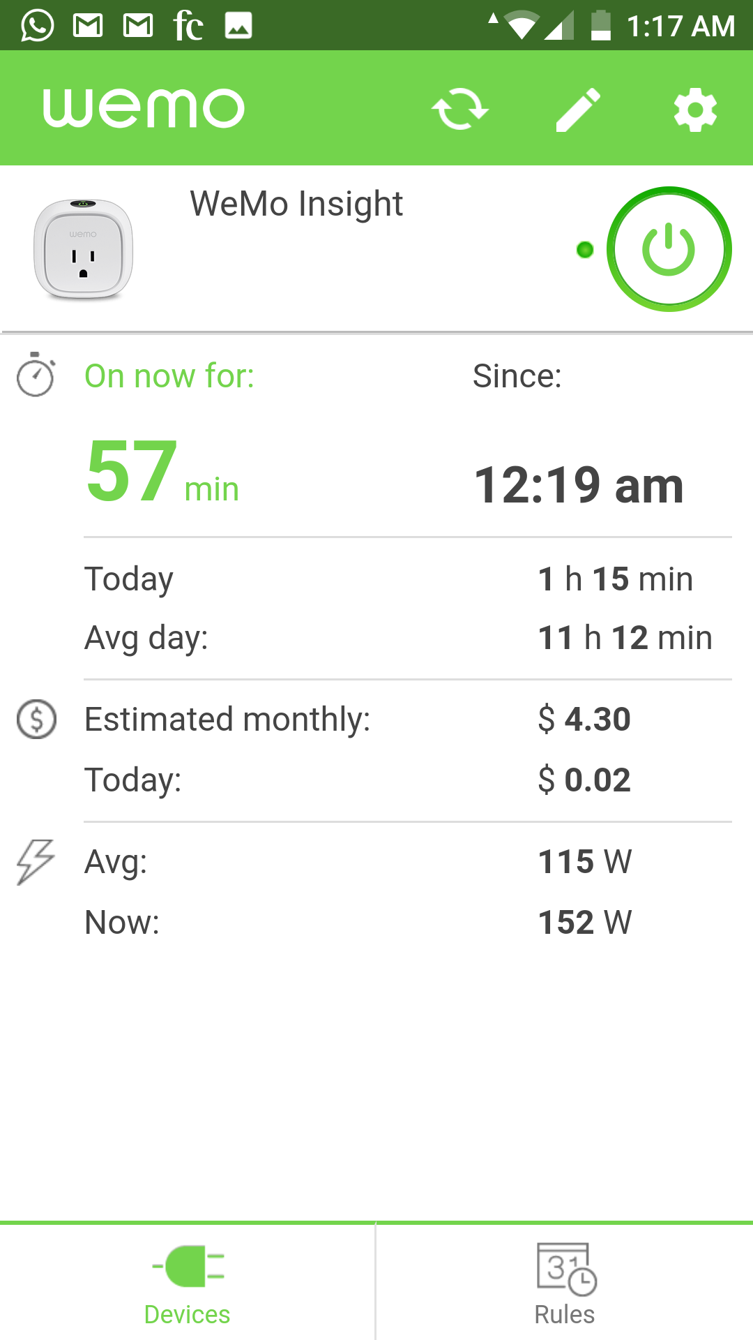

Just to report that using the latest magical patch tool of dosdude1. I have been able to install Mojave 10.14 Beta (18A326g) in a Mac Pro 3,1. the process was very simple. Just like High Sierra (this is the link to the install process in case someone reading is lost http://dosdude1.com/sierrapatch.html) So far I haven't noticed any display glitches. Everything seems to be working just fine like high sierra. My graphics card is a NVIDIA Quadro K4200. (by the way I'm writing this post using Mojave, the screenshot tool have many new options built in) Thanks to dosdude1 and everyone else to make this possible and keep on proving Apple that planned obsolescence is not the right way, is the machine still capable there is no reason to put it out of the supported list. Something else that I have notice is that the system seems to be more power efficient. As now the Mac Pro is idling at 152 Watts. In High Sierra it idle at 200 Watts. So still good news for our pockets!... Please pardon my English :)
How does the Home and News app look on you computer, I’m having some
Issues as you can see point out by an arrow in pic
