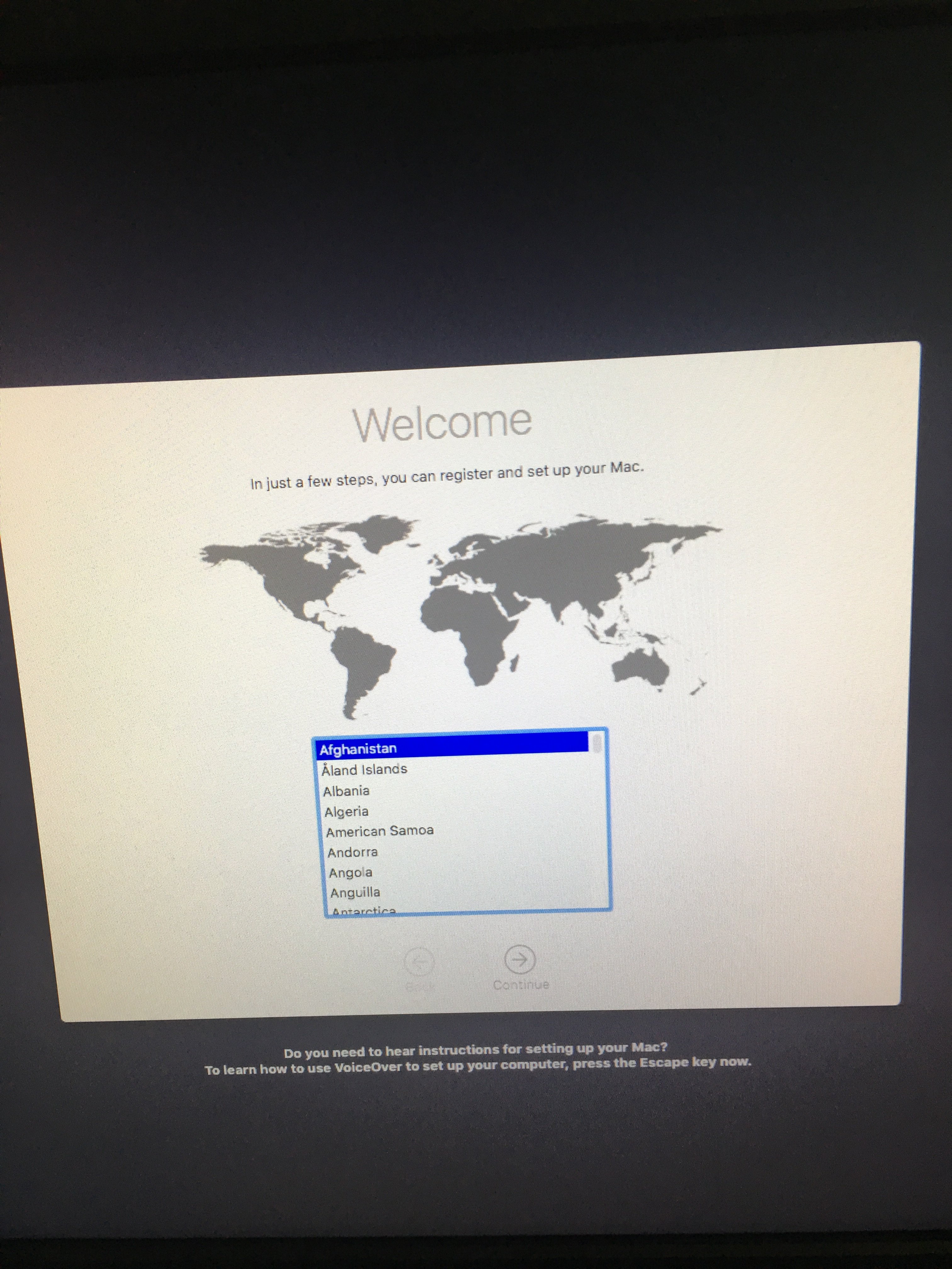

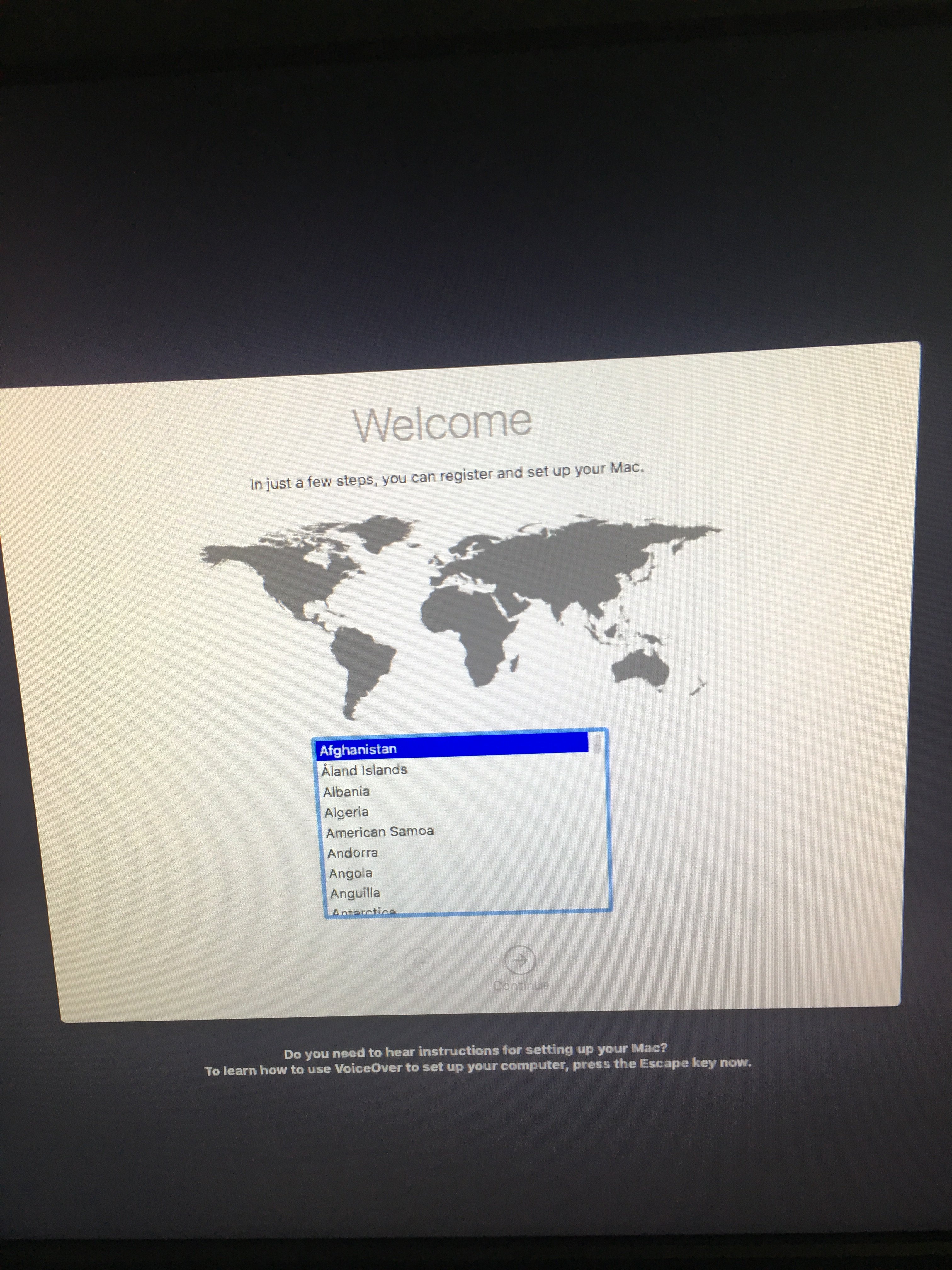

Well Finally got it installed on my Mac Pro 3,1 now I just need to set it up
