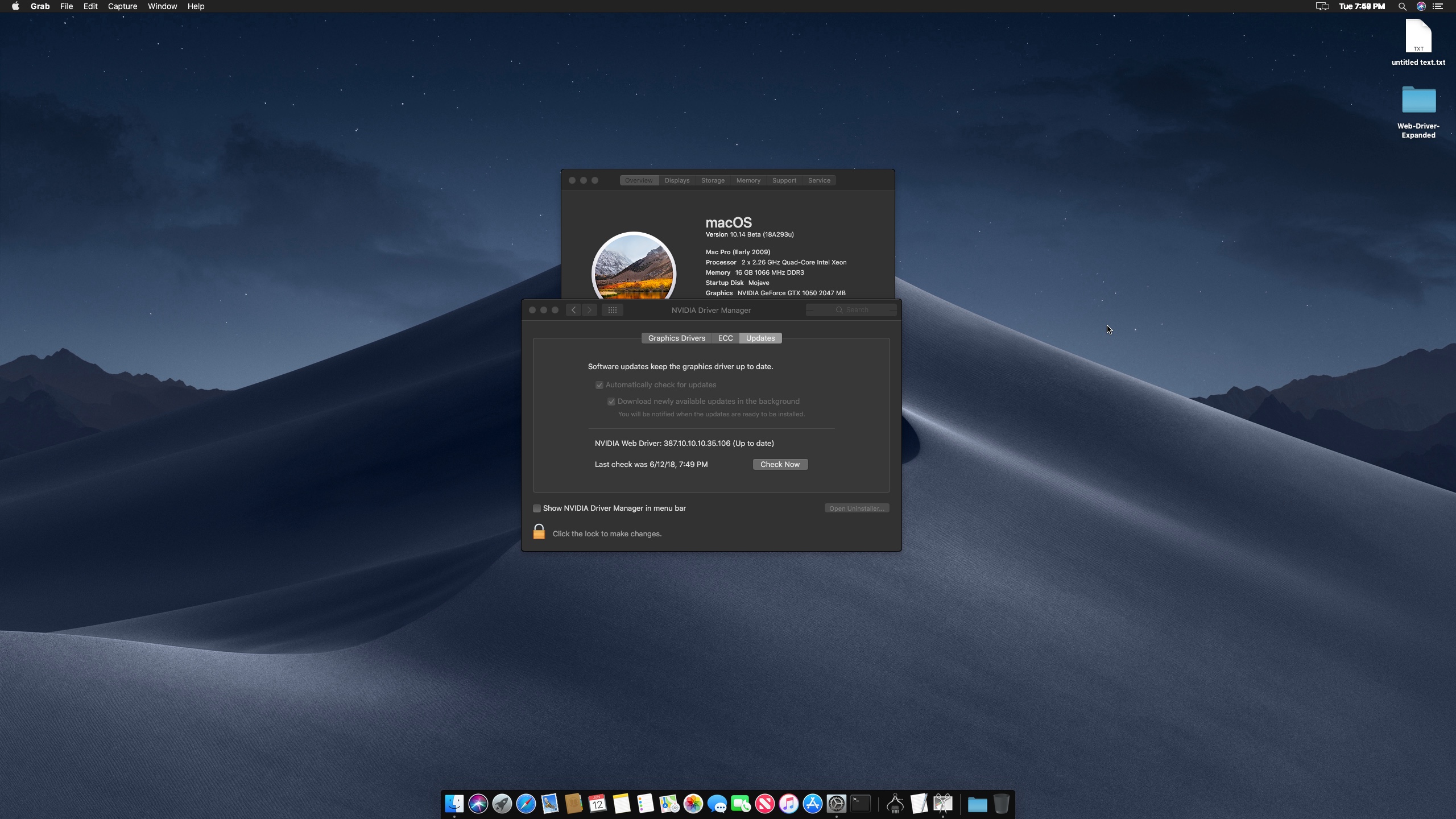

No acceleration. My GTX 970 runs like trash on latest BETA along with GTX 1060.
Edit: This is only until nvidia releases the Web Drivers or a port is created for the High Sierra ones.

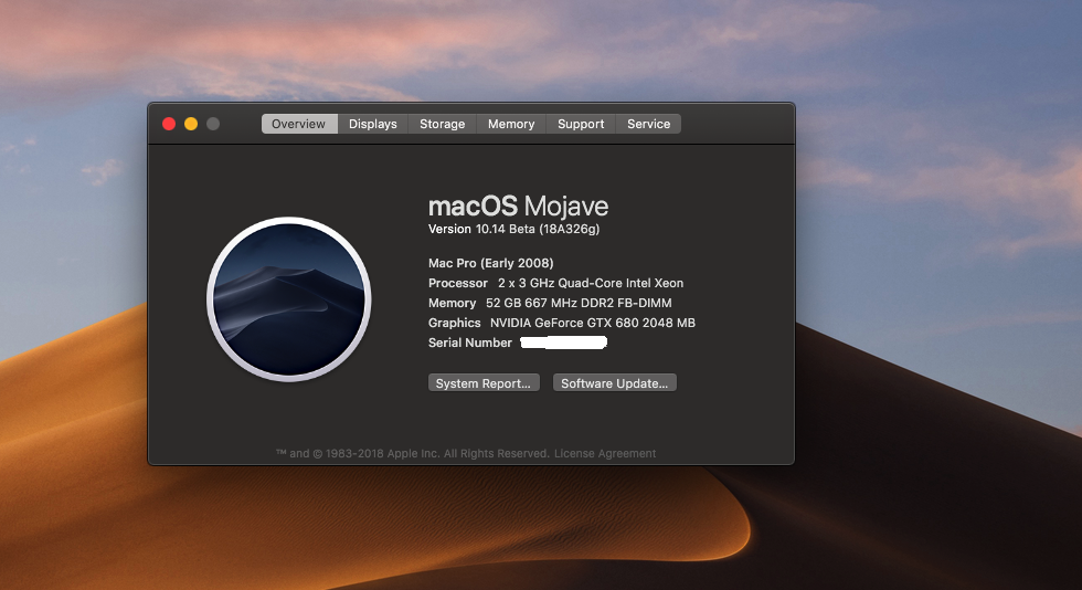

I'm up and running on a Mac Pro 5,1 with NVIDIA GTX 1050. Graphics are sluggish--acceleration is partially working from what I can tell.
So I bought a used MSI AMD RX570 graphics card. Wow! I was able to do a regular install on my Mac Pro 5,1 (4,1). Everything works beautifully with full acceleration. Mojave actually runs faster than High Sierra on my system. The only downfall is that there is no boot screen. I can live with that. I did have to enable/force trim on my SSD drive after install.
I also found a sweet spot on my 27-inch screen Cinema Display at 1920x1080 HiDPI. The 2560x1440 native resolution was a little too small for my eyes. At 1920x1080 HiDPI, everything looks sharp and crip (especially text).
When Mojave comes out, I will seriously consider upgrading my CPUs. I can’t wait.
