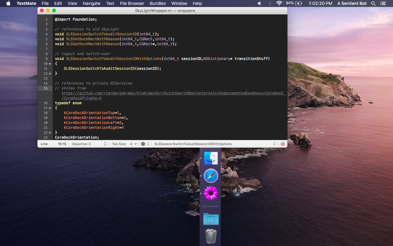

Hey, I'm back again with what's hopefully the last Dock-related patch for my SkyLight wrapper. I'm not sure if anybody noticed, but my recent fix for the left-side-Dock-collisions-wack-ness was actually terrible. While it fixed the weird size limiting, it caused apps (no matter the Dock orientation) to sometimes open "under" the Dock... like they did before I wrote any Dock shims, when those functions were just stubs.
Now, I finally understand what's going on, and I've implemented a patch that will fix that regression, while still keeping things working when the Dock's on the left. A new wrapped SkyLight framework and wrapper code is attached. @dosdude1 @0403979
A (not so) quick summary of what's going on here for those who are interested:
The Dock collisions are handled by two functions in SkyLight, SLSSetDockRectWithOrientation and SLSGetDockRectWithOrientation. These are called by the HIServices framework.
SLSSetDockRectWithOrientation is called when the Dock rectangle is changed (either by stretching, changing what side it's on, or opening/closing/adding/removing apps), as well as at some point during the login process. It is supposed to store the Dock rectangle (of type CGRect) as well as what side it's on. The problem, of course, is that Mojave's SkyLight doesn't have this function. But it does have a very similar one, SLSSetDockRectWithReason. So, my wrapper just passes the rectangle through to that function -- a very simple shim, and one that I implemented a couple months ago.
SLSGetDockRectWithOrientation is used, unsurprisingly, to fetch the saved rectangle. I pass that call through to the very similar SLSGetDockRectWithReason in the old framework.
That was enough to get the Dock to "collide" with apps normally, when the Dock was on the bottom. As you can probably see quite quickly (but I didn't!), not saving the orientation is bound to cause issues. Essentially, the weird window-size-limiting that some of you reported? That was because the system thought that the Dock was still on the bottom, but standing on end. And so, of course, it prevented the app from colliding with this monstrosity of a tall vertical Dock that it thought was there. (See the mockup image below -- eww!)
My previous "fix" for this issue was to disable the SLSGetDockRectWithOrientation function, which essentially disabled Dock collisions altogether. That was dumb.
The correct fix is simply to, in SLSGetDockRectWithOrientation, fetch the Dock orientation (using a private HIServices API documented here) and return it correctly. (See my attached code.)
TL;DR: I was dumb, didn't save the Dock orientation in my shim function, caused the system to think the Dock was standing on end, and squished your apps. Then I "fixed" it by disabling the whole shim function. Now I finally fixed it properly. Yay me! (This is a perfect example of why you don't want a first year computer science student to be patching your operating system...)

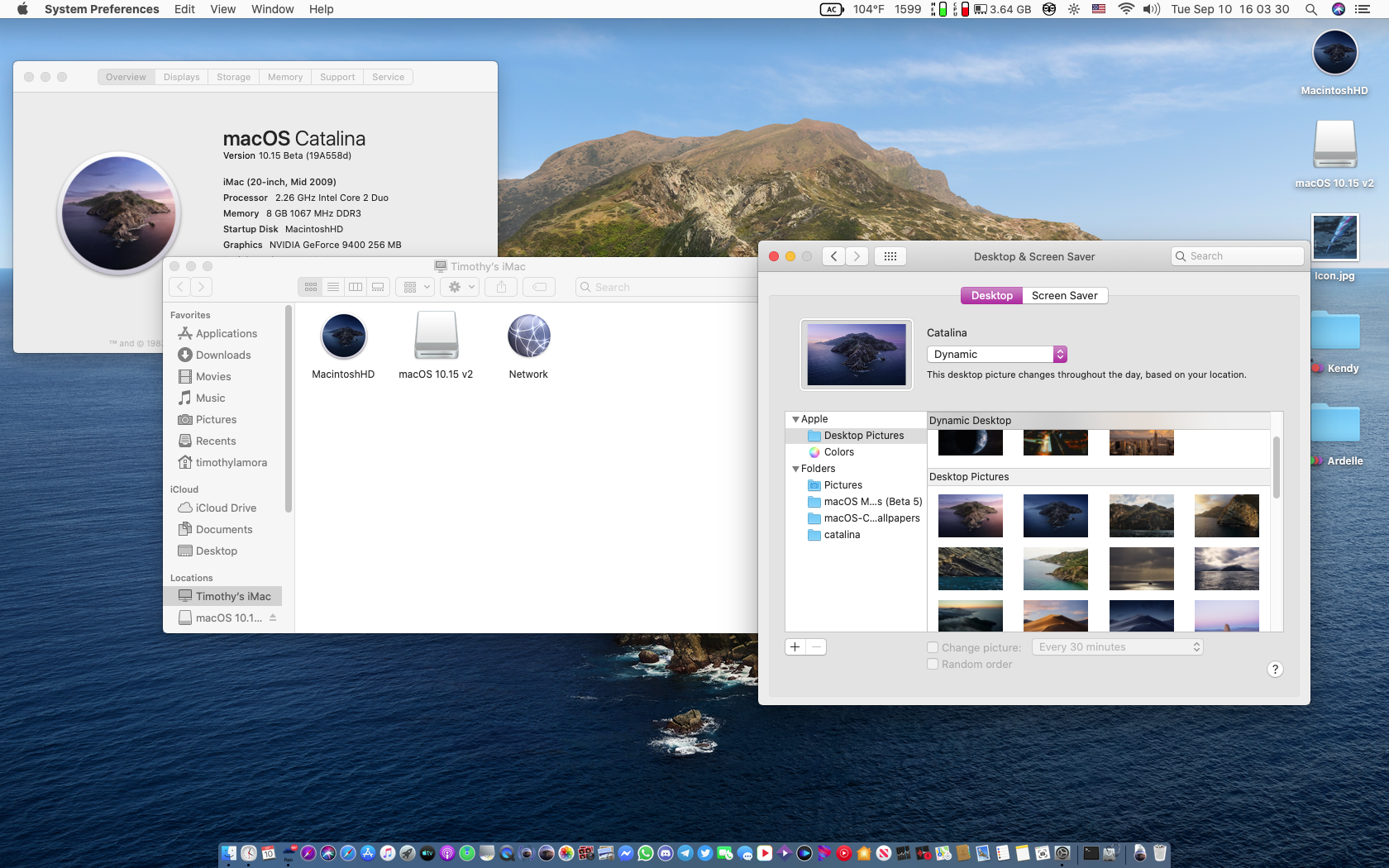

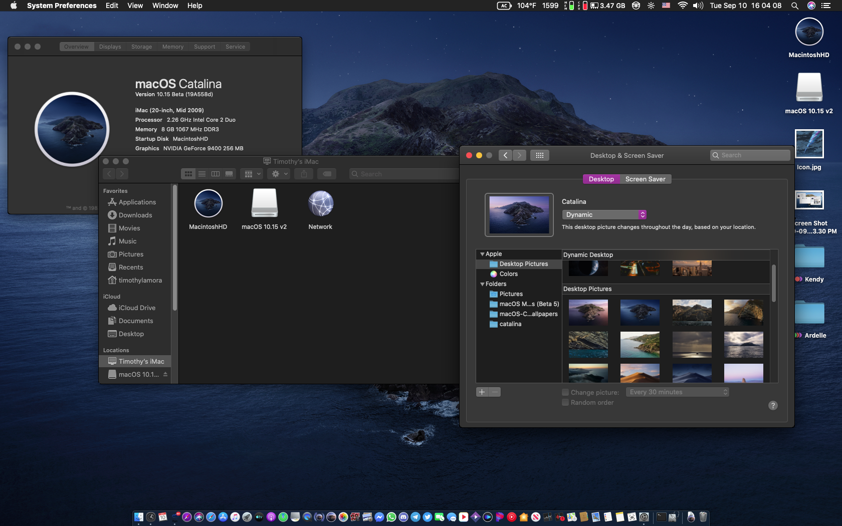

macOS Catalina Dev Beta 8 installed successfully BlueSky patches working nice new desktop pictures as well :) Photos is still working Map only partially to use the updated dynamic Catalina desktop you have to selected automatic in system preferences or it will use the dark or light still pictures :)

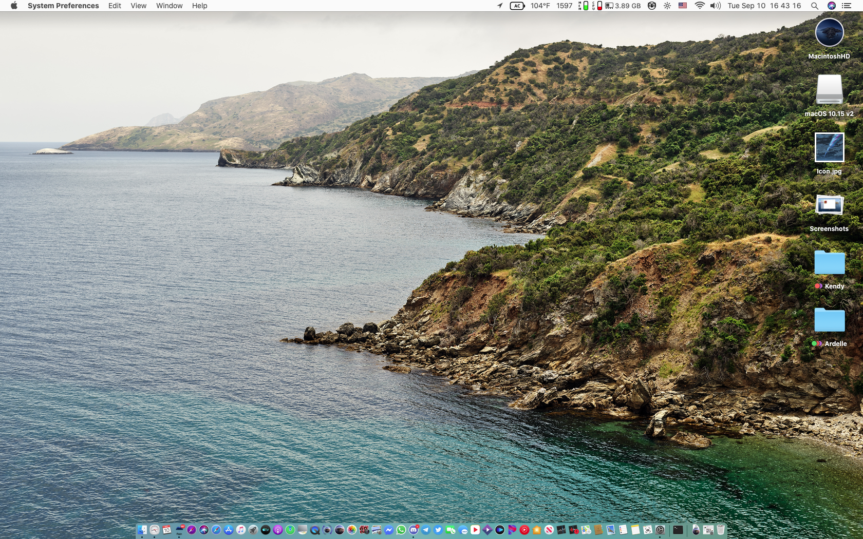

most likely Apple took into account some sleep for 8 hours so that leaves 16 hours so the dynamic changes every to hours as mine has changed
