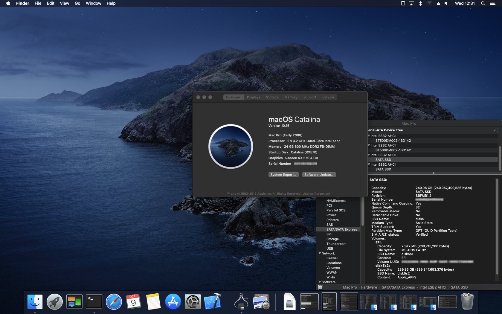

Another successful Catalina upgrade to report - MP3,1, RX570 GPU, TRIM via "sudo trimforce enable". Upgraded from Catalina DP7 to Final using @dosdude1's patcher v1.1.6.
Also - if you have a relatively modern video card (with GOP support) but no Mac-EFI BIOS available to flash: @Ludacrisvp posted a great tip here on how to get boot screens using rEFInd. A quick recap (all credit goes to him, see his original post for details):
  1. Find your EFI partition using "diskutil list", mount it to /Volumes/EFI
  2. Download rEFInd from here, unzip it into /Volumes/EFI/EFI (which will create a refind subdirectory)
  3. Download OsxAptioFix2Drv-64.efi from here, place it into /Volumes/EFI/EFI/refind/drivers_x64
  4. Make rEFInd bootable using the "bless" command: sudo bless --mount /Volumes/EFI --setBoot --file /Volumes/EFI/EFI/refind/REFIND.efi --shortform
When you reboot, you'll get the rEFInd boot manager, and can choose from any bootable partition; once you choose, you'll see all the boot progress screens. I can't believe I spent so long swapping my video cards just to see progress/error messages. There's also a refind.conf file that allows you to customize rEFInd and its actions, but details of that are for another post (or you can read the documentation here). One quick note: some MacOS updates will "hijack" the boot (force it to boot straight to MacOS), and you'll have to redo step #4 to re-enable rEFInd. (Going from Catalina Beta to Release caused this to happen.) I put the "bless" command in #4 into a shell script in ".../EFI/EFI/refind/rebless" to simplify the do-overs.
