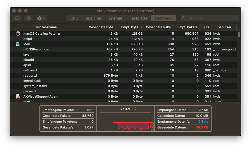

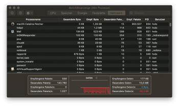

Neither the Activity Monitor nor the Network Utility reports accurate information on an iMac8,1.
The iMac boots into El Capitan, Mojave and Catalina. All screenshots were taken from the same iMac, suggesting that any variations are caused by the OS, not the hardware.
Activity Monitor shows the individual Processes, but no statistics. See screen shots from Catalina and from Mojave to compare.
Network Utility shows a WiFi Link speed of 5.74 Mbit/s under Catalina, compared with 130 Mbit/s under Mojave. The lower value is not correct. The ISP charges for 100 Mbit/s but usually provides between 85 Mbit/s and 115 Mbit/s. This corresponds to the actual download time of approx. 7 minutes for "Install macOS Catalina Beta", which is a 6 GB file.
The measurements were repeated over 2-3 days with several restarts and are reasonably consistent, but consistently incorrect.
Don't know if these are core Catalina issues, relate to the patched macOS version or are specific to the iMac8,1.
On MBP5,2 with 10.15.0 Release, still observe this:
the network graph in Activity Monitor shows no read activity, while in fact reads are going well on full speed (example of downloading the os with patcher 1.1.7).
Using an Ethernet wire for this.
Looks reasonable when using WIFI.
Not a significant thing, but weird.
Edit: both WIFI and Cable look fine on a supported MBP11,1 (cable connected via Thunderbolt adapter though).

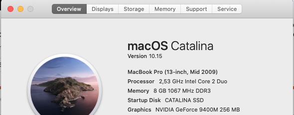

Catalina 10.15 successfully installed on MBPro 5,5,apfs rom patch installed, runs very well although from usb.No major problems..bluesky is working ok, Temps stable, cpu idle 60 to 70,mem usage half.
Good luck for all the newbies!!!Screenshot 2019-09-18 at 14.12.51.pngScreenshot 2019-10-13 at 12.41.52.pngScreenshot 2019-10-13 at 13.08.09.png
