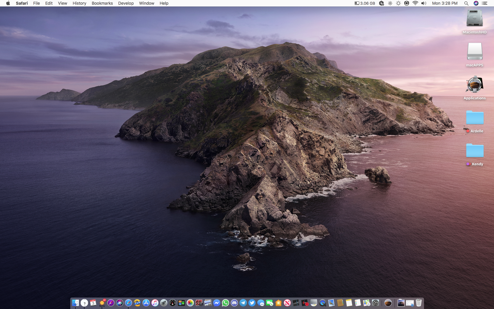

already download and installed the Catalina heic wallpaper :)
[doublepost=1559600978][/doublepost]here it looks on my mid 2009 iMac the Catalina dynamic wallpaper :)

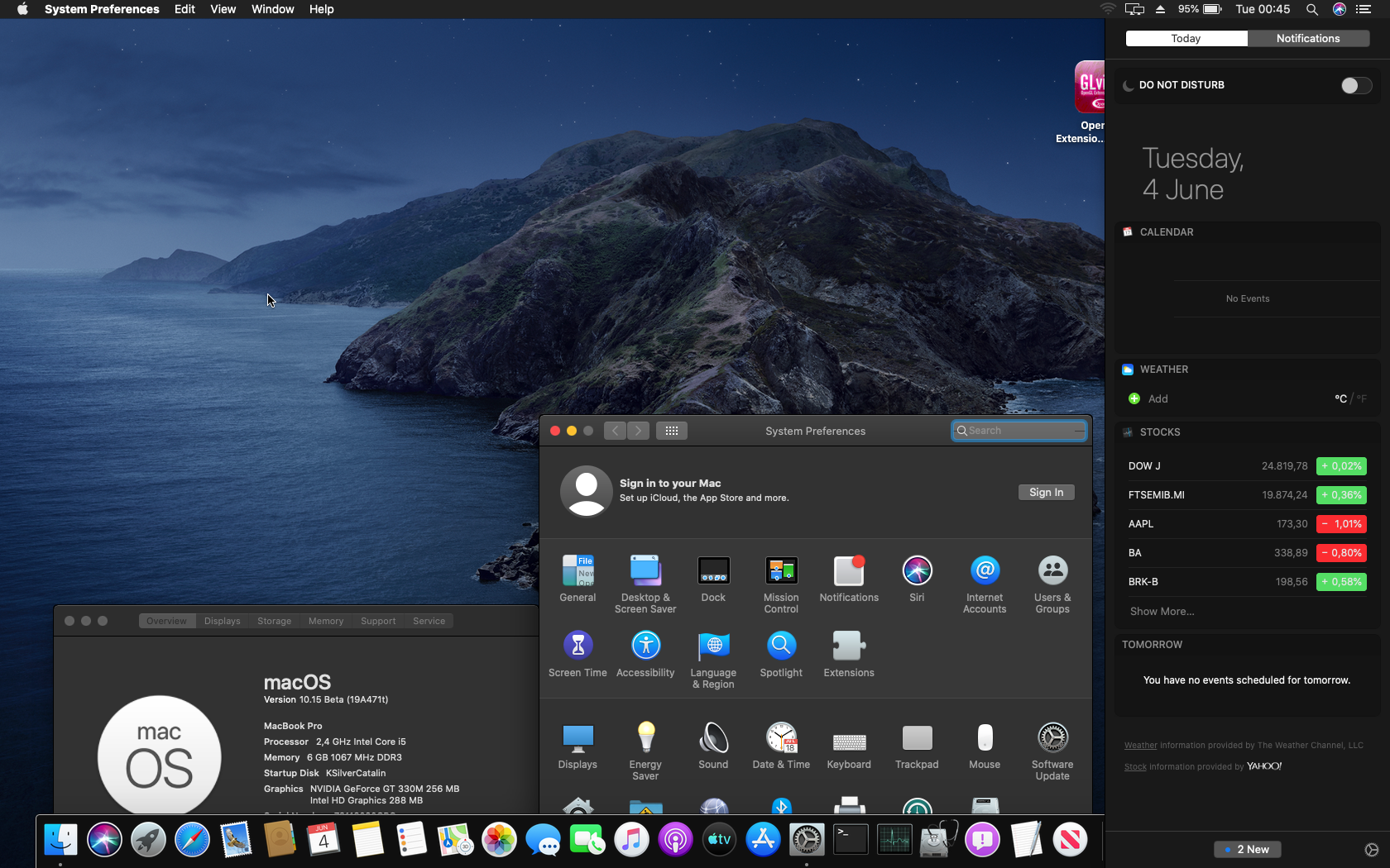

Ok at least managed to boot in safe mode, I guess @foxlet did booted that way too.
Now I attach a picture just for example, haven't replaced any kext/framework , because for now I need this external usb SSD untouched Catalina to use on supported Mac.
But the fact Penryn cpu is still supported is very positive.

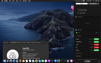

@ASentientBot I attached a picture from MacBook7,1 too, I haven't patched any kext/framework, just renamed "telemetry.plugin2". It's an APFS installation however. But I guess @dosdude1 will add also the possibility to install in HFS+.
I still can't find my Catalina Users folders when I boot from another Mojave machine, it's ultra hidden I guess. Anyway I really preferred the old system root folders layout.
