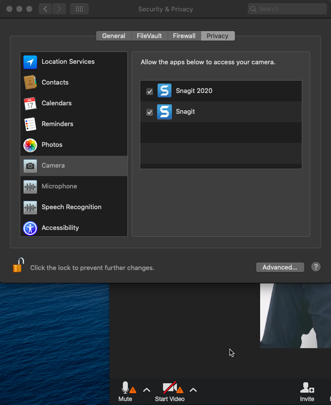

10.15.4 Skype/Zoom Camera/Microphone Security & Privacy Permissions
For some reason apps like Zoom or Skype don't seem to be properly asking MacOS for permissions to use the Microphone & Camera permissions. The strange thing is that I have other apps that are properly asking for Microphone/Camera permissions such as TechSmith's SnagIt 2020.
I was able to find this thread (https://superuser.com/questions/144...e-privacy-settings-in-macbook/1462245#1462245) with others who have a similar problem. I have tried the solution of unlocking sharing & permissions for my user and applying this change to all users, I have enabled SIP by entering csrenable in the Internet Recovery Terminal, and I have even tried the Zoomnonmetal patch.
Has anyone run into this problem? Please help! If it helps, I am running a MacbookAir 4,2 (mid-2011).
What version of the patcher did you use? This was thought to be fixed a while back. There were also some work arounds before the new patcher fixed this

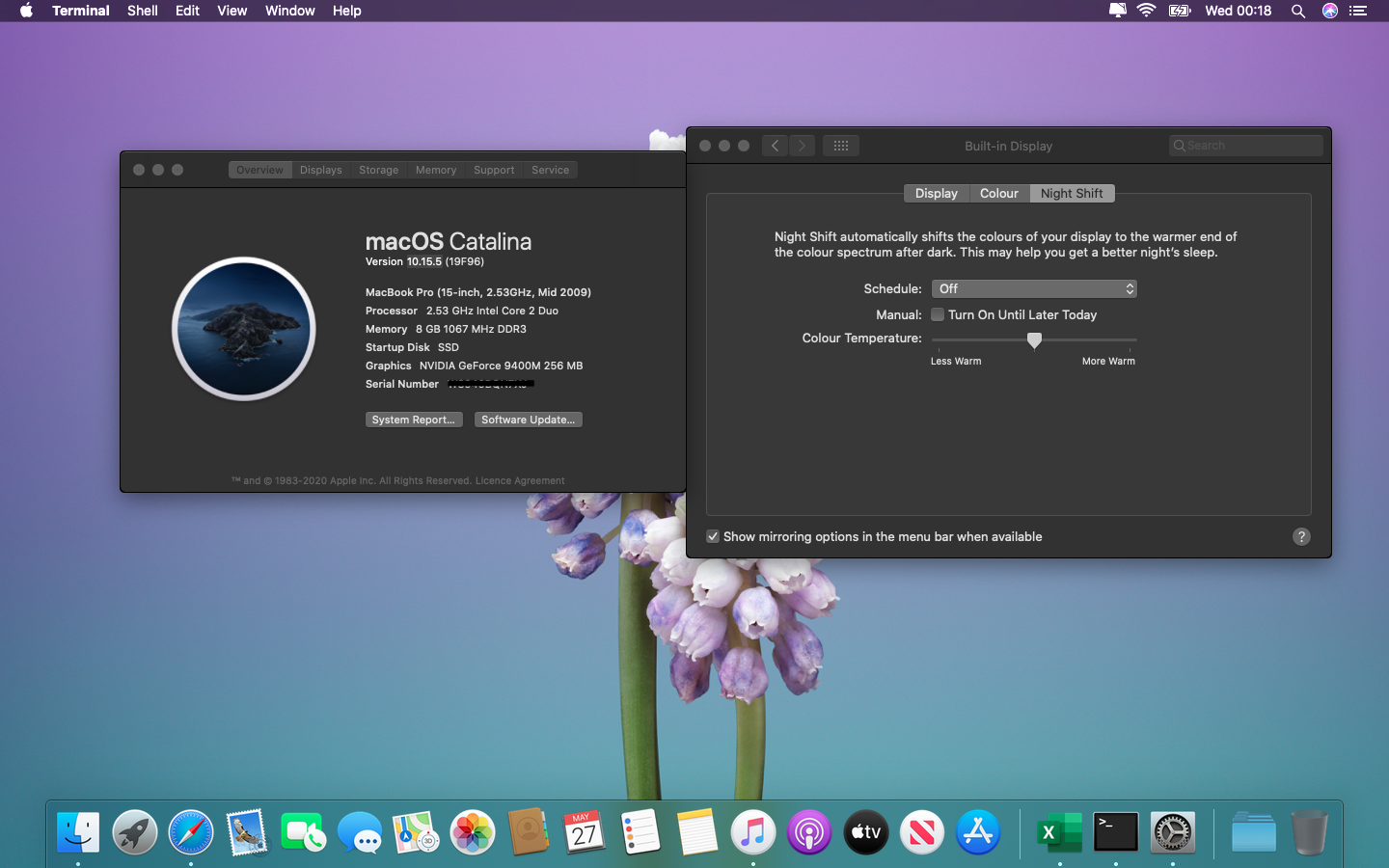

Updated to the newest Catalina Beta 15.5.5 (19F96) after using catalinaswufix5amfi command (when an OTA notification appeared in System Preferences) in terminal and afterwards post install patches ( from Cat Patcher version 1.4.3).

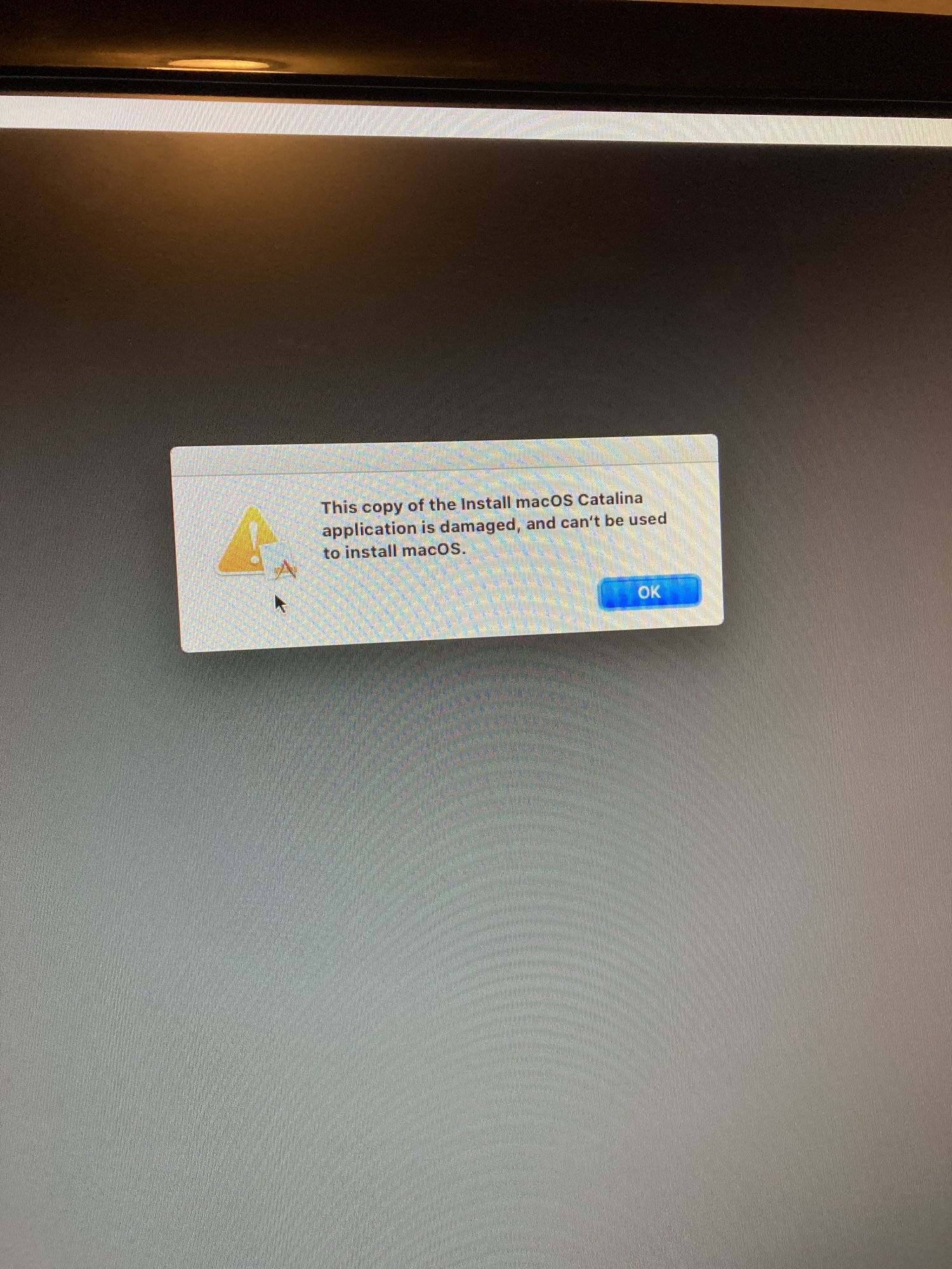

So far I've not been able to install using the newest patcher/download. Still tinkering with different methods.
I don't get an error. It starts out well, then says it must restart to commence with the install. It shutdown, then reboots right back into 10.15.4.
This is with the "Install to this machine" option. Trying other methods at this moment.
