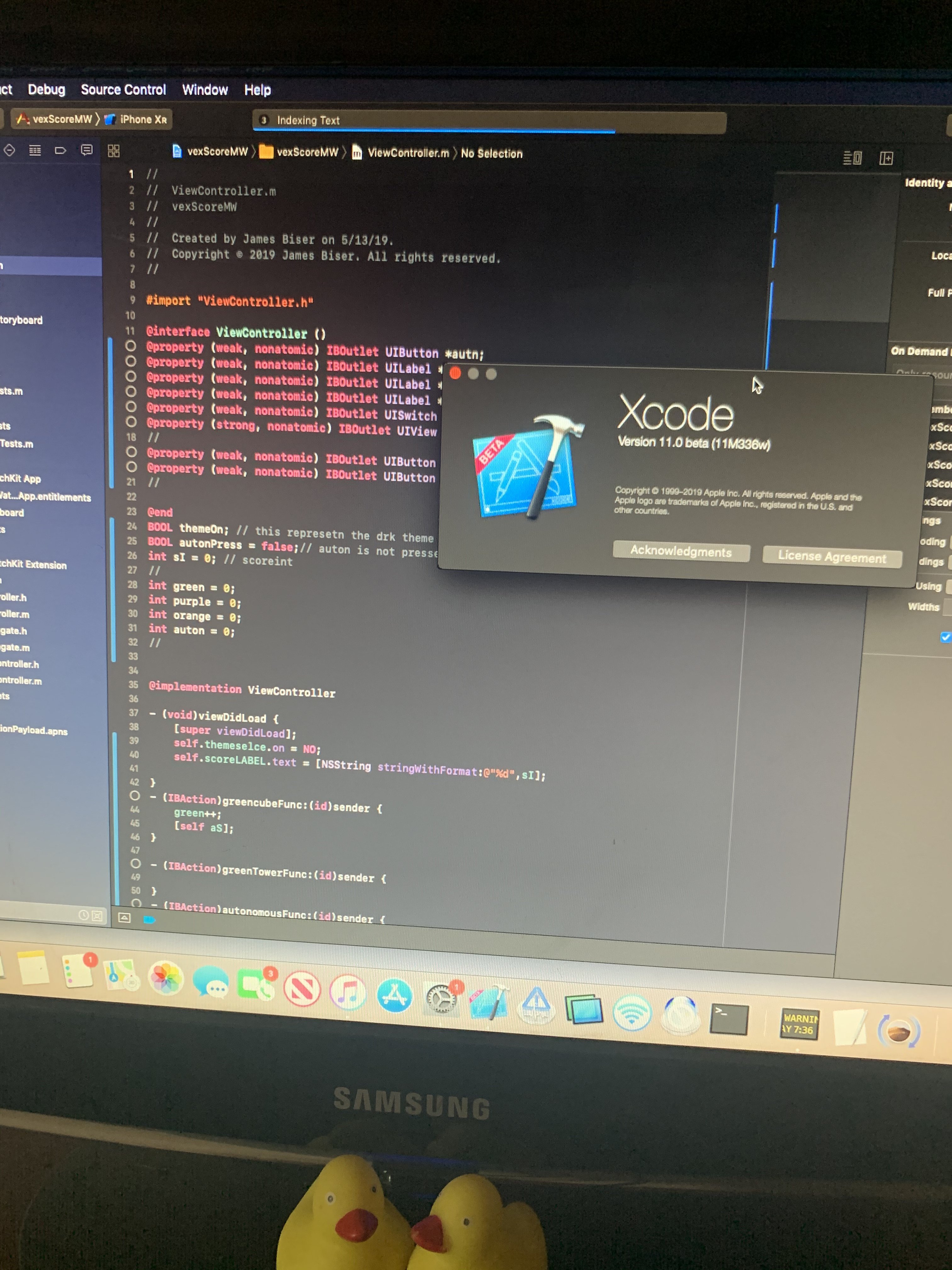

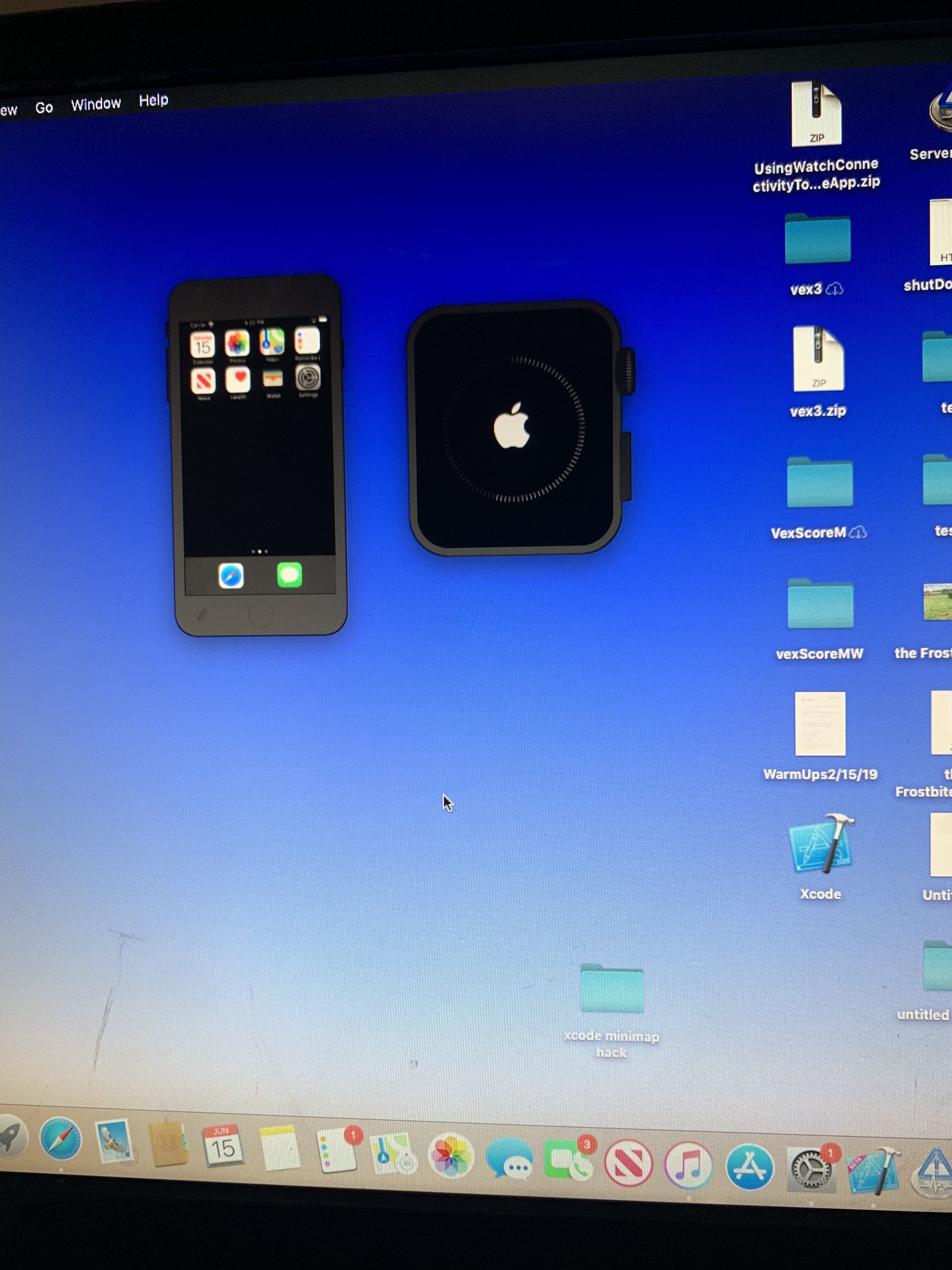

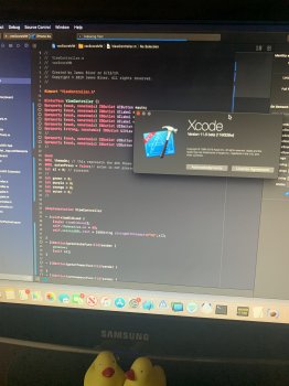

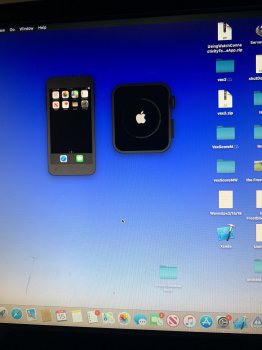

I also noted in the release notes this little snippet of text. "Metal is available in iOS 13 and tvOS 13 simulators when running on macOS 10.15. Metal code is executed on the host Mac GPU, and is significantly faster than simulated OpenGL code." So it seems like Xcode 11 requires Metal for at least the new OS 13 simulators and probably just crashes the whole app without it.
The graphics card I have now is absolutely incompatible with Metal. No way it can get graphics acceleration working in here. Yet, the dosdude1 patch for Mojave makes Majove work like High Sierra did, I would not call it better or worse. This is what I need, nothing more. Probably no Mac OS X had graphics acceleration on this since Yosemite. I just want to upgrade the current state to Catalina. This is me. About others, I am sure there are some people with similar preferences.

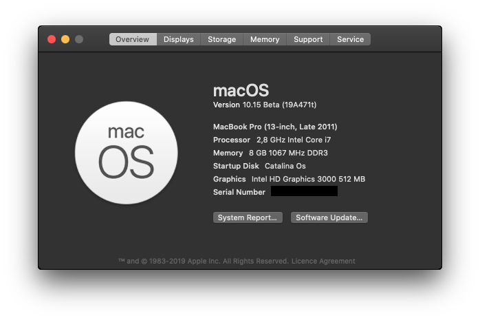

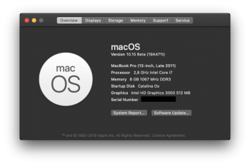

Mac Os Catalina fully working
Many thanks to!
@jackluke for his instructions
@ASentientBot for his patches of the Mac Os Frameworks
@dosdude1 @0403979 : For their effort to make a easy installer for older Mac's.
Looking forward to the new patchers.
If developers need some help let me know, I can test some things and share logs.
Photo app not working.Is already known.
Memory handling is seems better ,less memory pressure comparing to Mojave.
Good to be here on MacRumors:)

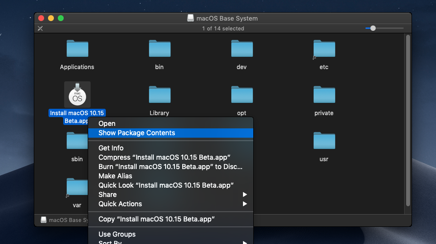

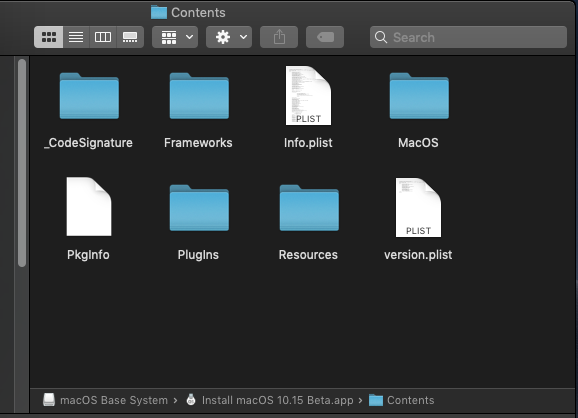

They are outside the InstallESD.dmg , I mean they are here /Install macOS 10.15 Beta.app/Contents/SharedSupport/
but I guess you could download them separately, keep in mind that Catalina BaseSystem.dmg is about 500 MB.
The little advantage is that inside the Catalina BaseSystem.dmg you will find the "Install macOS 10.15 Beta.app" forked of the rest, but you can create a full installer from there adding manually a "SharedSupport" folder.
You could retrieve from sucatalog there should be URLs I guess, but don't know exactly how to.

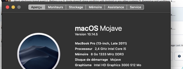

hi nt some help about installing mac0S 10.15 macbookpro8.1? there a patch or sun truce for ative hard drive

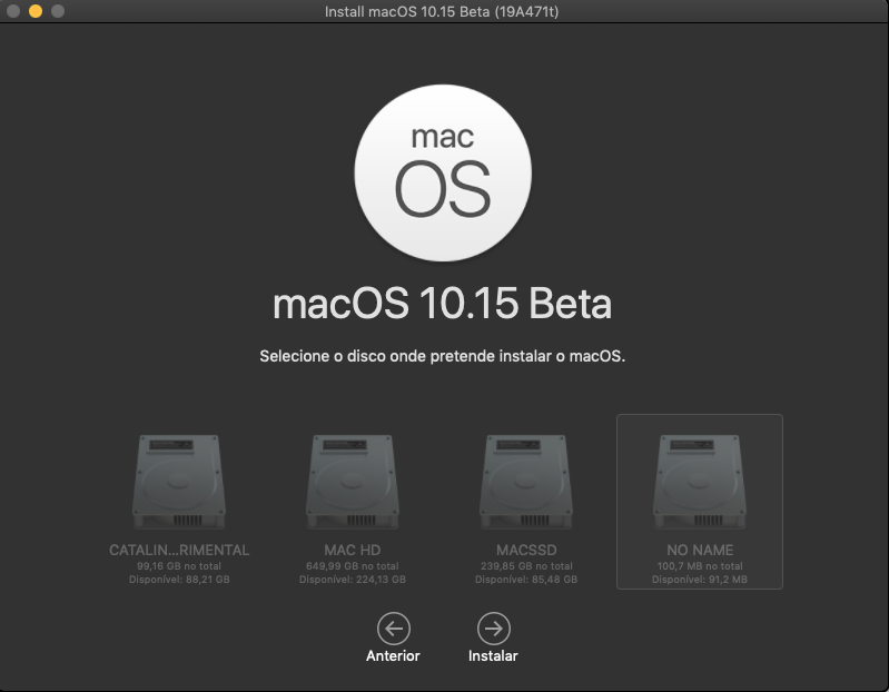

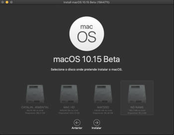

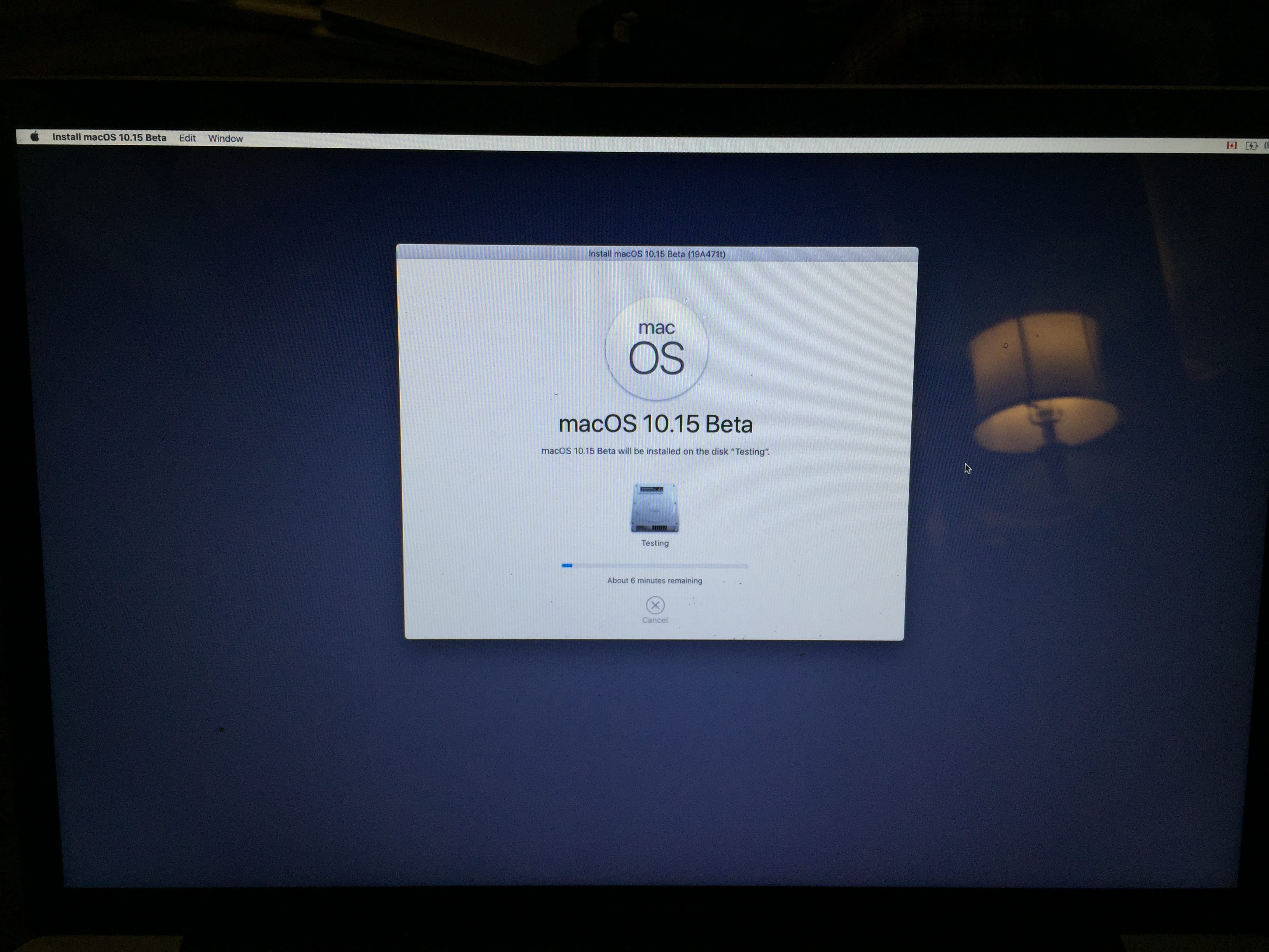

Why i can't install eventhough i put this command: sudo nvram boot-args="no_compat_check"....it doesn't let me choose where to install...
