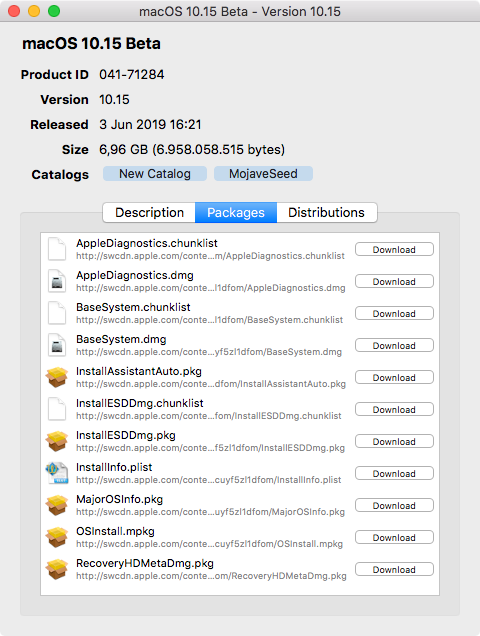

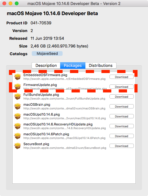

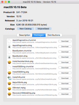

Catalina DP1 don't have any BootROM or SMC upgrades at all.
Catalina DP1:
10.14.6 DP2 where all Macs got BootROM updates except MP5,1:
Catalina DP1:
Ah right! That's why many here with "Catalina loader" have escaped from EFI/SMC pkg updates.
But in the root of "Catalina's InstallESD.dmg" I guess there are the *firmware*.pkg updates for 10.14.6 beta 1 , so a bit of risk is lying in wait.
I mean if EFI/SMC update for a spoofed iMac is issued to a MacBookPro, after, there is risk of unstable machine or bricked.
However many here that used "Catalina loader" have encountered at half install the "big apple and big loading bar", then this scenario has failed/interrupted (or powered off the machine), hence they were able to power-on it again and resume the stage2 Catalina installation.
