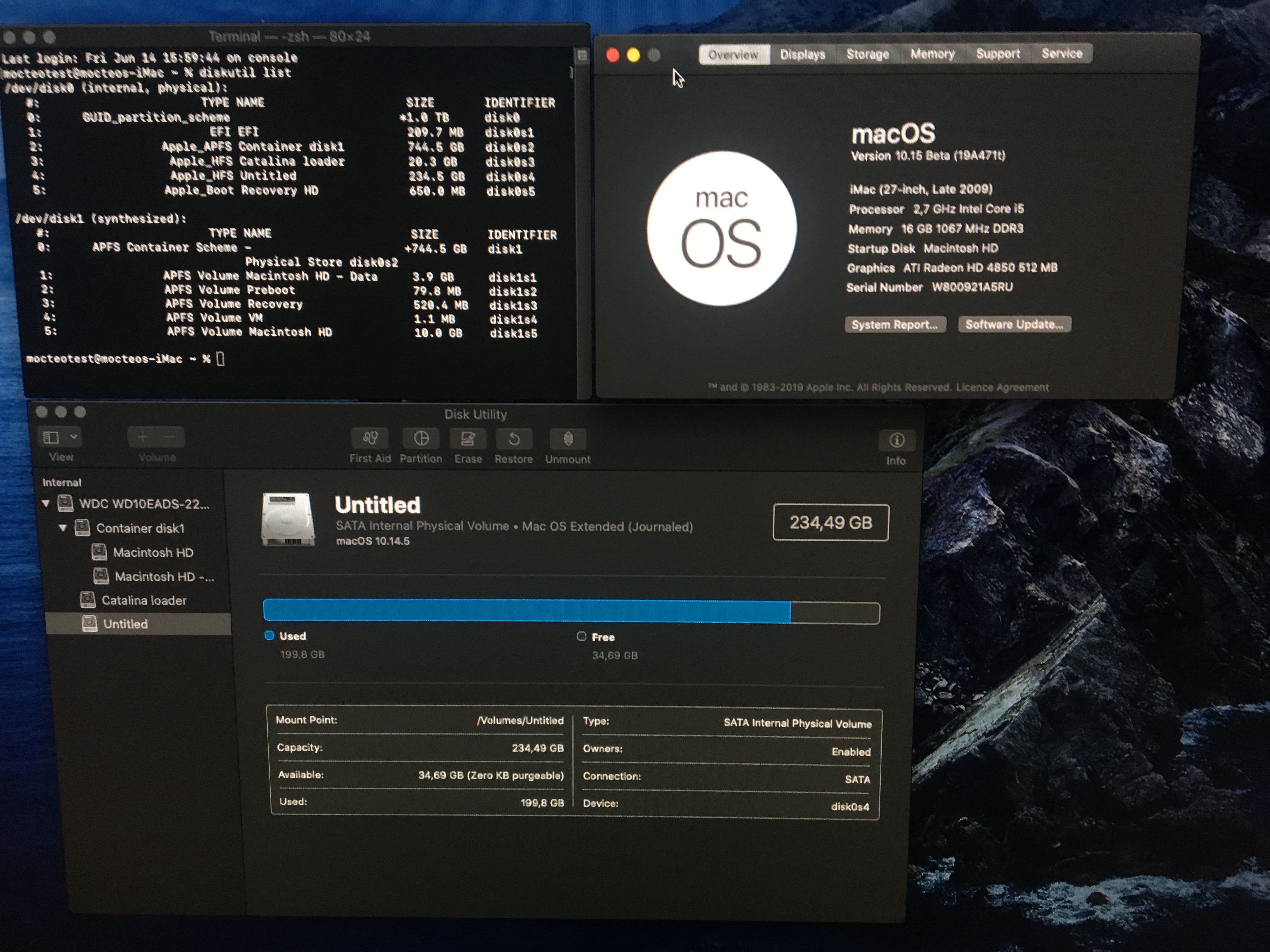

And that’s it, installed without any issue on a HFS+ disk, even if i thought apfs was required...
Could you post from your current Catalina Terminal the output of: diskutil list
Because you'd be the first to have installed Catalina working in HFS+.
I don’t understand, i only have one disk on my iMac but it appears like this, so i don’t know... maybe i just don’t remember...

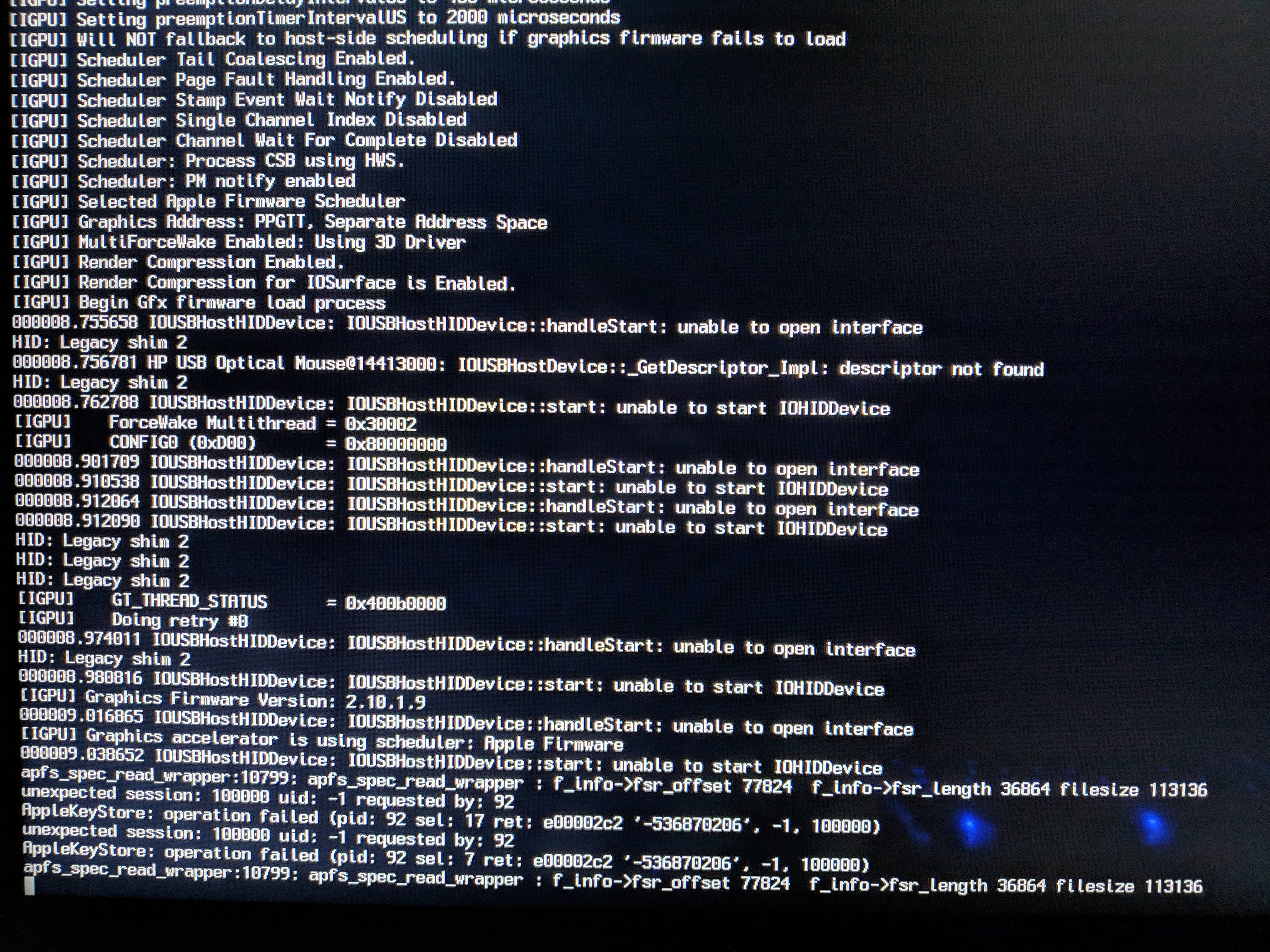

Hi - similar to a previous poster, I am getting the apfs_spec_read_wrapper error when trying to boot. Am on an Intel NUC with Clover, i5-8259u CPU with Iris 655 graphics. Any help would be appreciated. Thanks!
