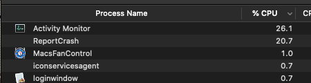

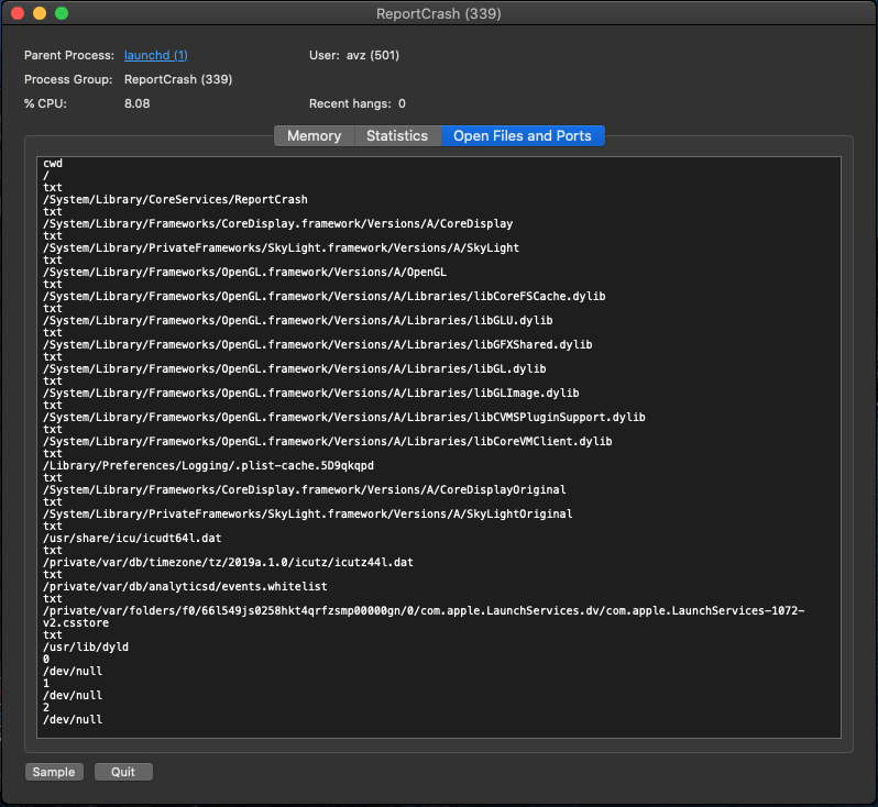

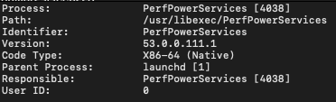

Looks like the PerfPowerServices(Although I don't have much experience with the Console):
You may be on to something. Search for PerfPowerServices in the system log - there may be associated crash logs also.

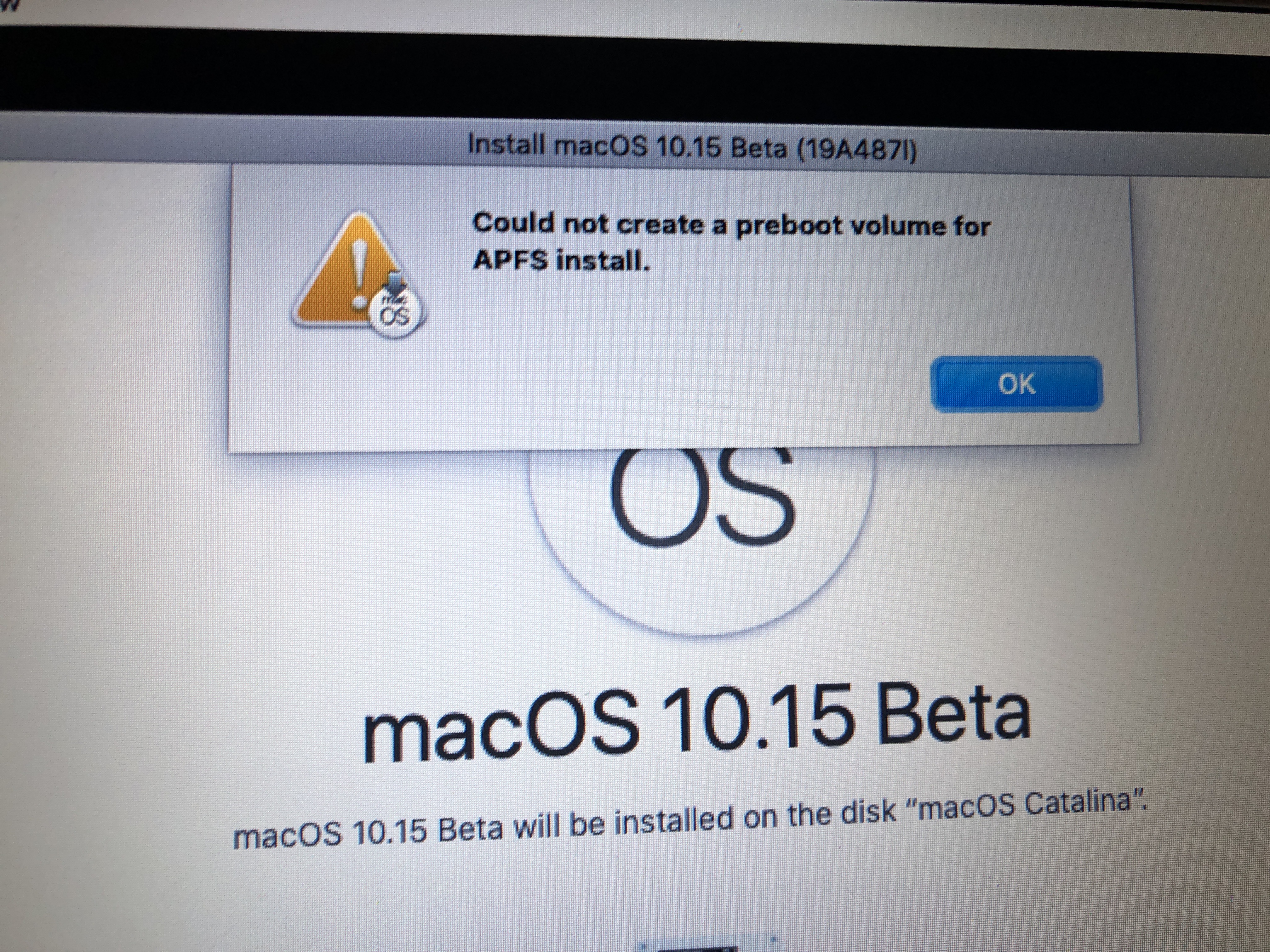

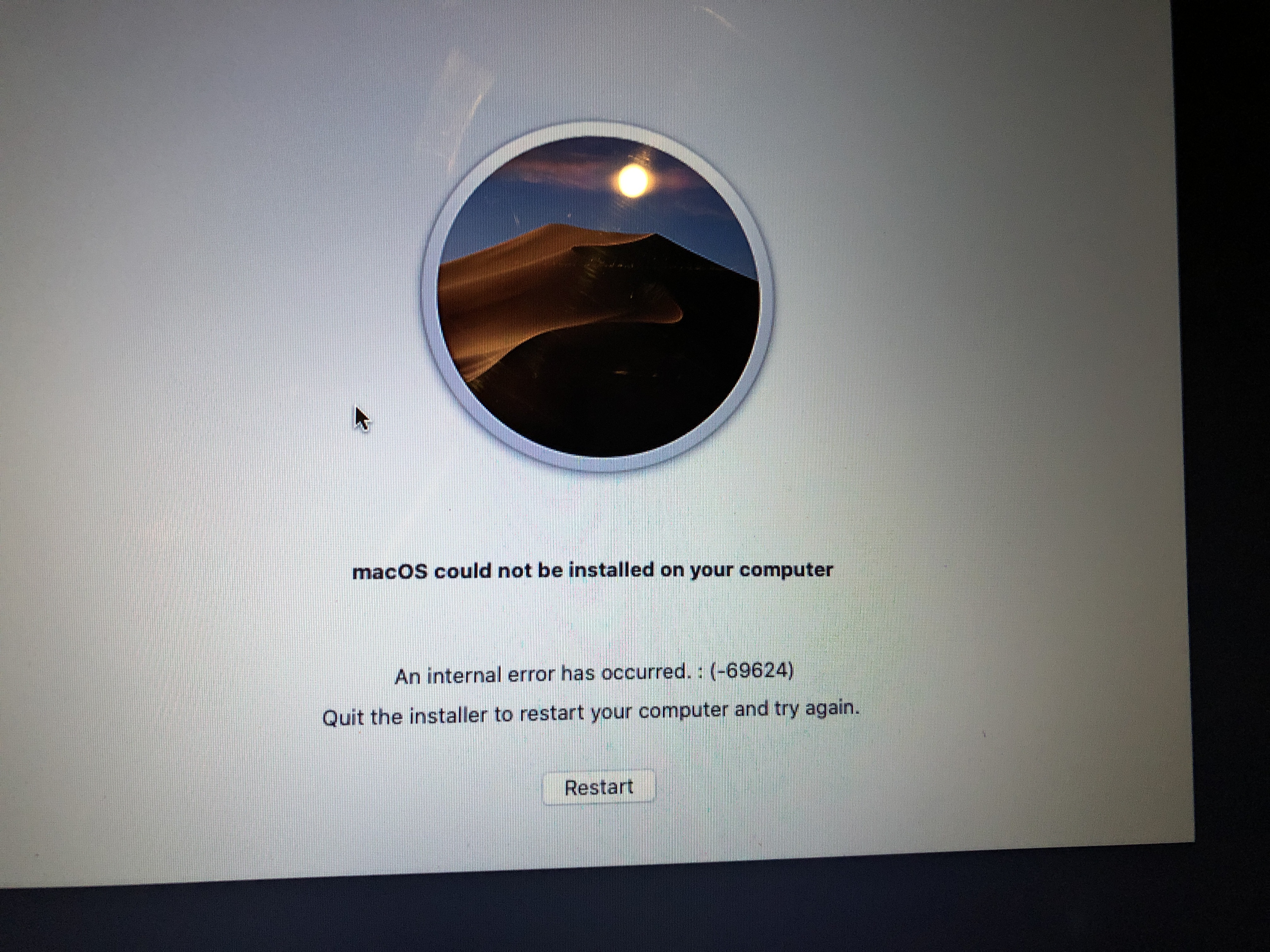

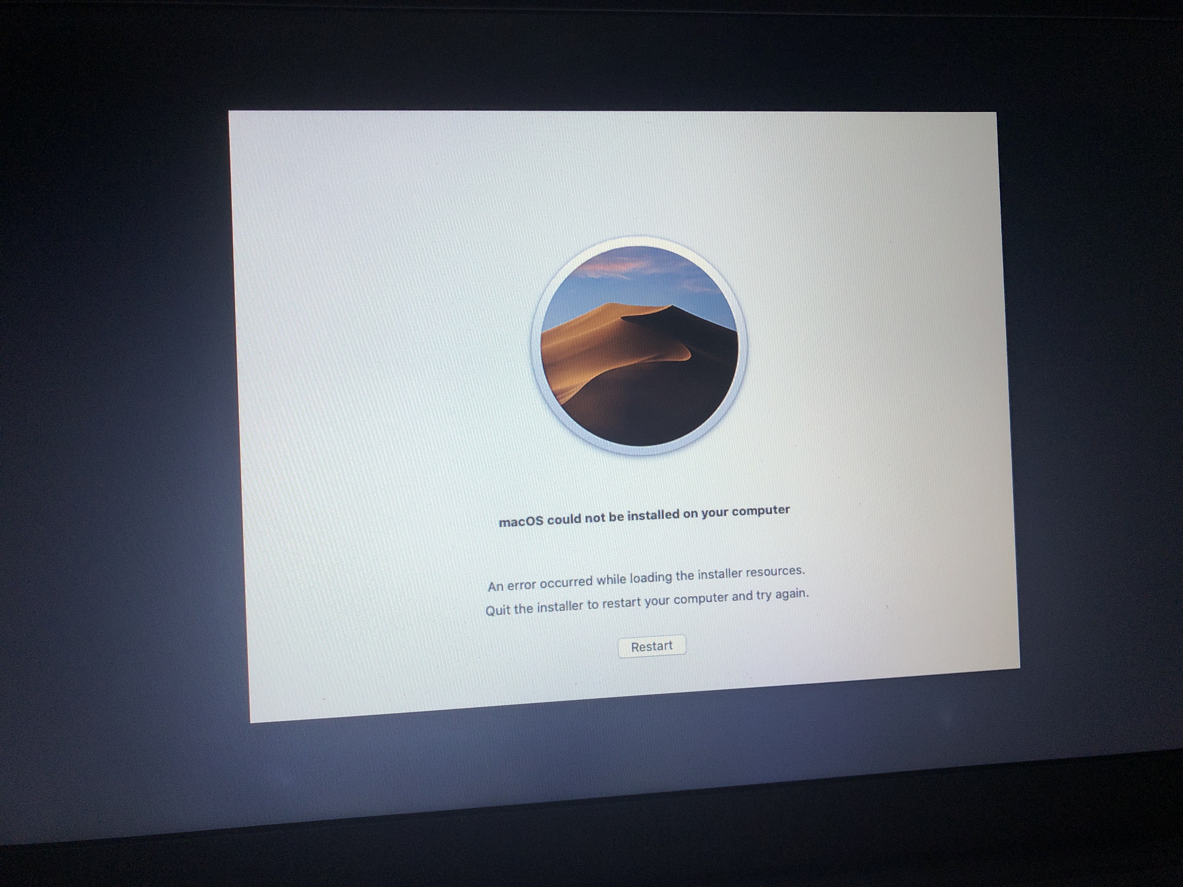

Using patcher beta 10 mac os catalina beta 1 don't know why i'm getting this issue "macos could not be installed on this computer" also can't format to apfs in the installer it just doesn't work so i had to use mac os extended journaled and if i used mojave to format it to apfs i get this error "could not create a preboot volume for APFS install "
The tool now only supports using the Developer Preview 2 installer app (due to some extreme changes Apple made to the DP2 installer). You can download it using my macOS Downloader tool.

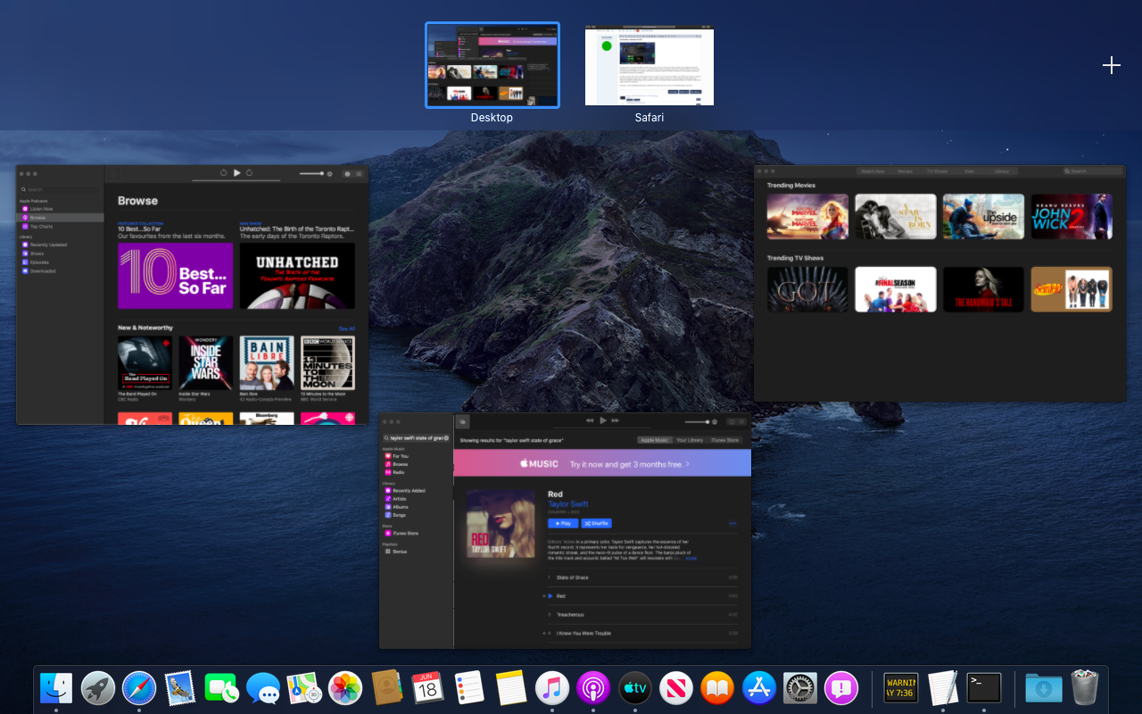

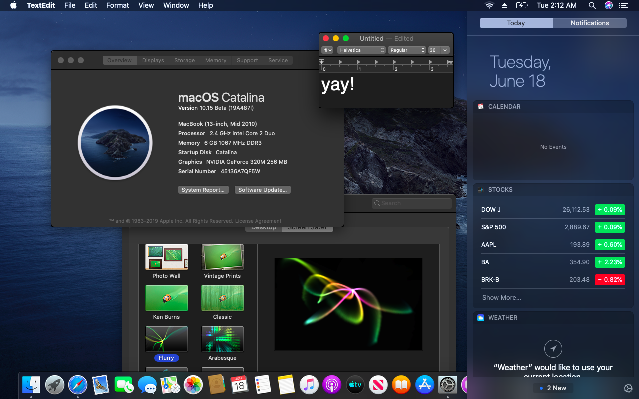

Acceleration achieved on DP2! :)

Yay!
Unfortunately, I feel that this effort will soon come to an end if we can't find a better solution than replacing the entire SkyLight and CoreDisplay. But for now, I made stuff happy again by stubbing out another several functions. (It only took so long because dumbass me somehow removed the symlinks inside the OpenGL framework in the process of copying it, and apparently those are necessary.)
It's late so I don't have time to thoroughly test, but it seems much the same as before. Key differences include an actually read-only filesystem, some nice "Loading..." text in Finder's columns view, and a lot of changes to what seems to be mostly accessibility-related display code. (Related: none of the display-related accessibility features in System Preferences really work at the moment due to my stub functions not actually doing anything.)
Anyways, a new CoreDisplay.framework (the SkyLight wrapper is unchanged) is attached for those who want to be on the bleeding edge. Good luck and goodnight.
