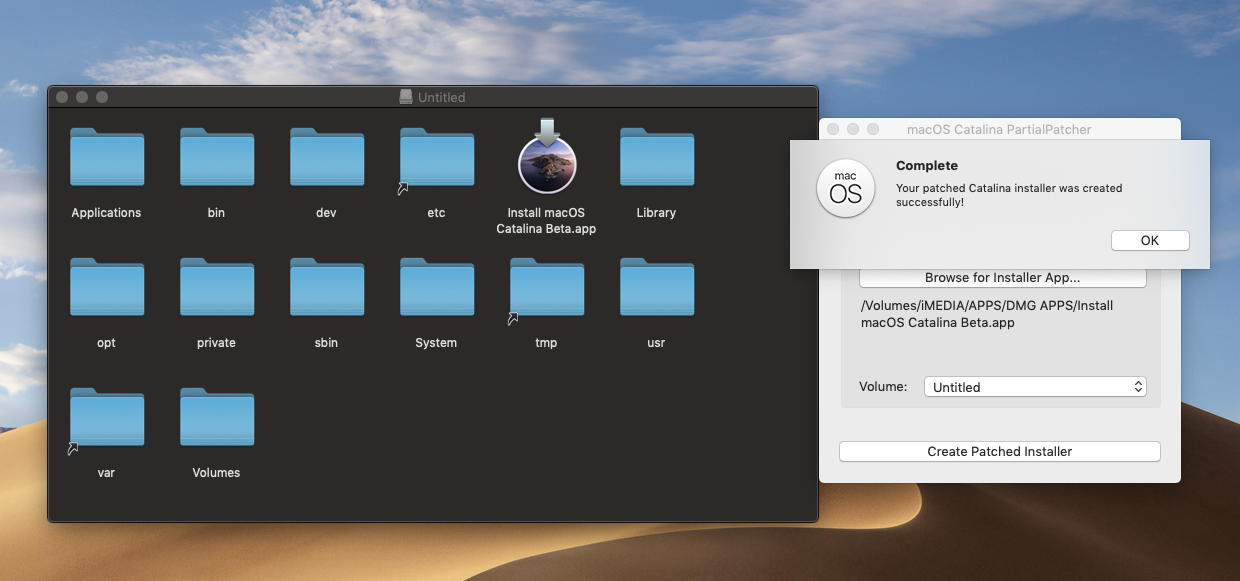

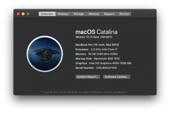

succesfully created install media on a 16 gb usb stick
now it will not apply the nvram variable, does sip need to be off
