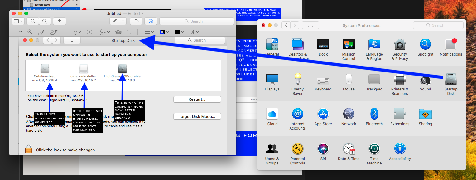

ATTEMPTS TO INSTALLL CATALINA FAILING, BECAUSE THE TARGET DRIVES ARE NOT FORMATTING AS NEEDED.
The scanDisk running catalina on my 2012 CMP Croaked for the most part. It will not start my computer, though most of the files are readable when the machine is booted with a spare installation of High Sierra I was lucky to have had available.
Now, I want install to Catalina and get back to running under it. I have a thumb drive setup as an bootable installer of Catalina, which I created following carefully the instructions and software provided graciously by Mr. Dosdude.
I HAVE THE INSTALLER BUT CANNOT FORMAT A DISK TO HAVE CATALINA INSTALLED
The problem I have is the HDD devices where I expected to install Catalina are not formatting as needed. I tried following the instructions to format them as APFS drives, provided by Mr. DosDude, but that formatting does not seem to be going right. I have not figured out how to reformat those drives as though they are new. When I try formatting APFS onto them, they end up NOT MOUNTED. It looks like there is a container at the top level of these drives that is Apple Journal type of containers so the APFS underneath them will not mount. I tried changing those then tried deleting them..I could not get the formatting of the drives to accept Catalina

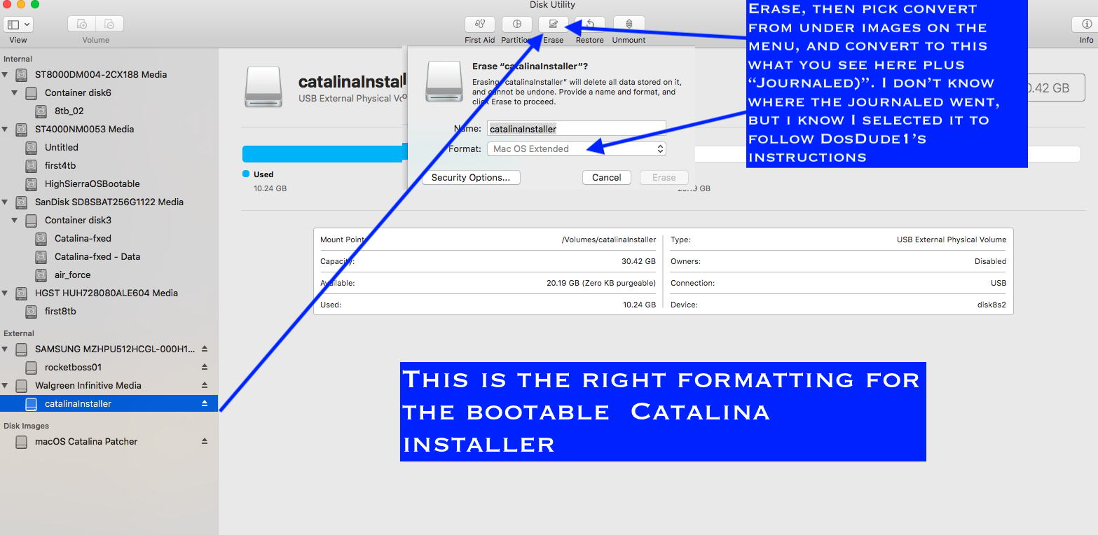

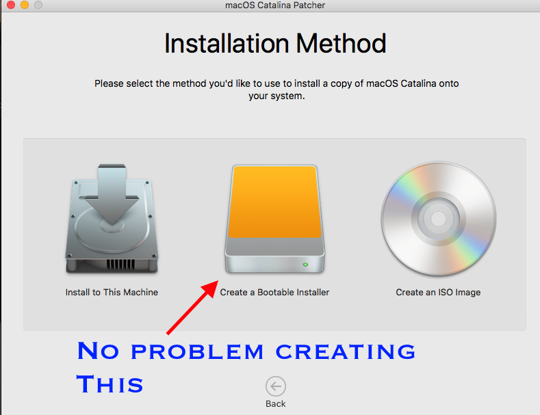

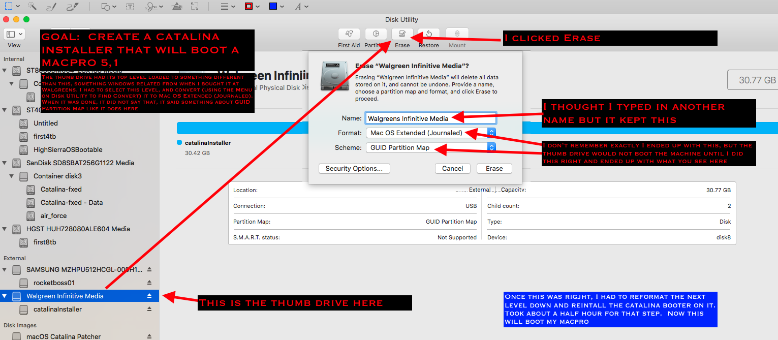

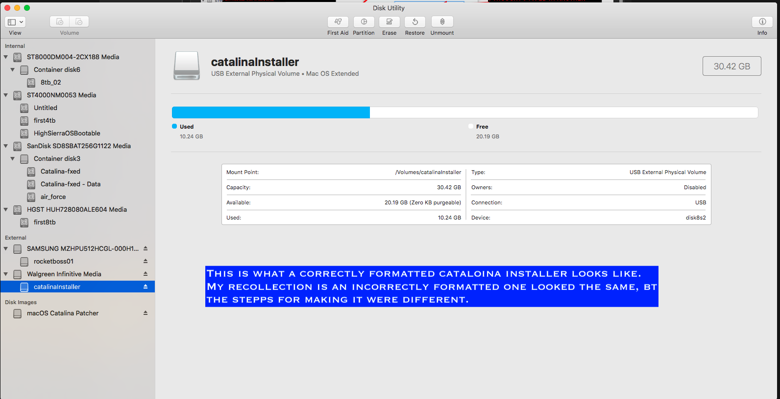

danallen
macrumors regular
Oct 8, 2018
135
36
Houston
Can anyone help? I'm trying to follow this guide - https://www.macrumors.com/how-to/install-macos-catalina-unsupported-mac/
I've created a patched install USB but when I boot from it, the Apple logo progress bar takes a very long time to fill and then nothing happens once the bar is full. The install never starts.
Target machine is a late 2011 MBP 13"
I've tried a couple of different USB sticks in case that was the issue and I get the same result
I had that problem for awhile with the Catalina installer on a thumb usb drive. The fix was to reformat the usb thumb drive, starting with the top level of what was on there already and make it
