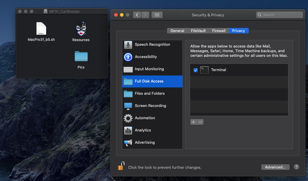

Can you send me some screenshots of the output from my script and what volume you are using at your destination, like the volume name? I am not sure if you are applying it to the correct volume.

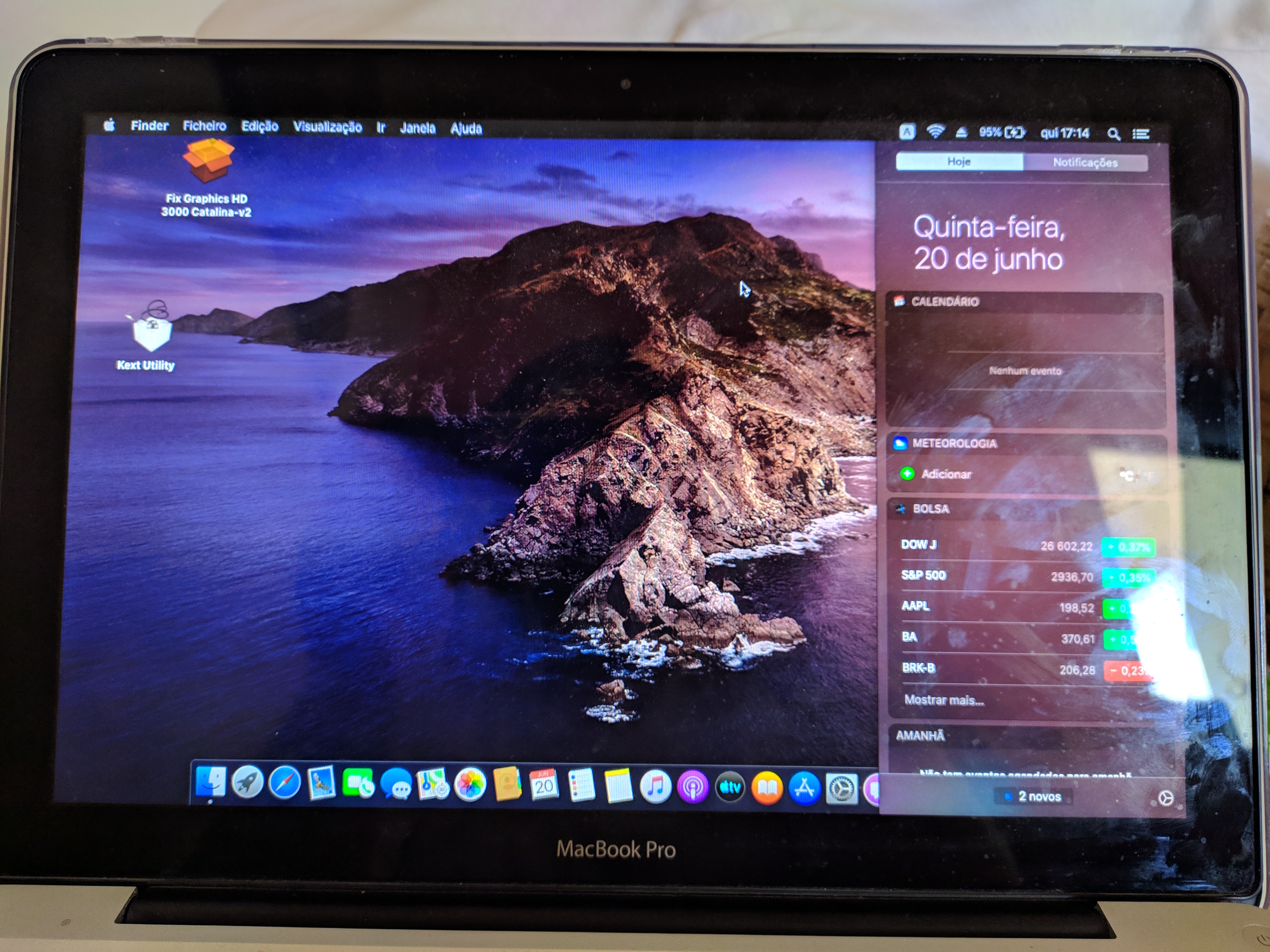

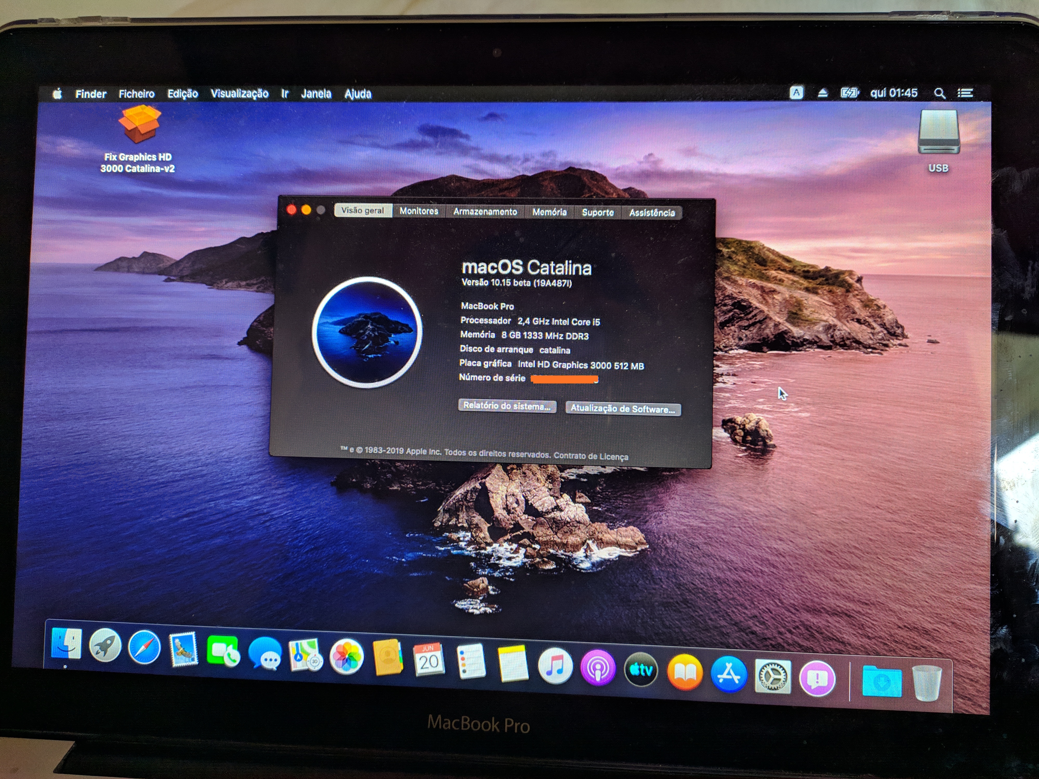

That looks good to me. I have a 2011 MBA with Intel HD 3000 so I commented out the Nvidia, AMD, and Arrandale while leaving the intelsandybridgegraphics and the usb/WiFi stuff. I also skipped the telemetry.plugin removal as it doesn’t stop my machine from booting but I believe it’s necessary for the MP 3,1 IIRC...

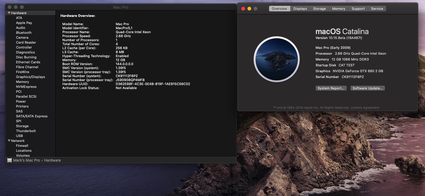

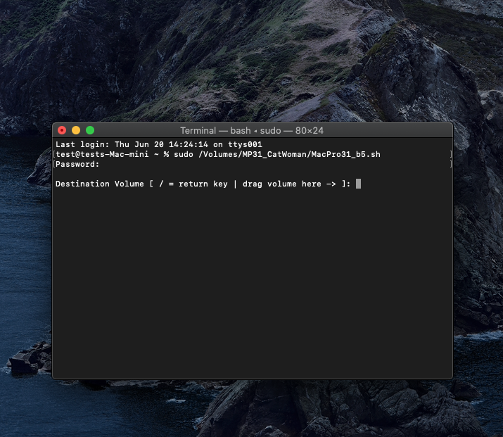

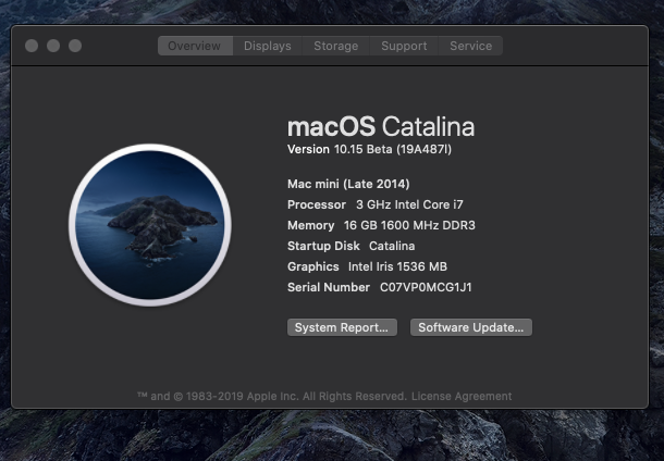

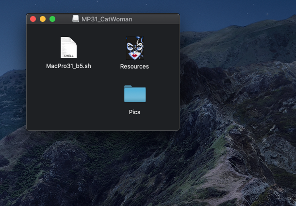

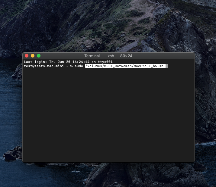

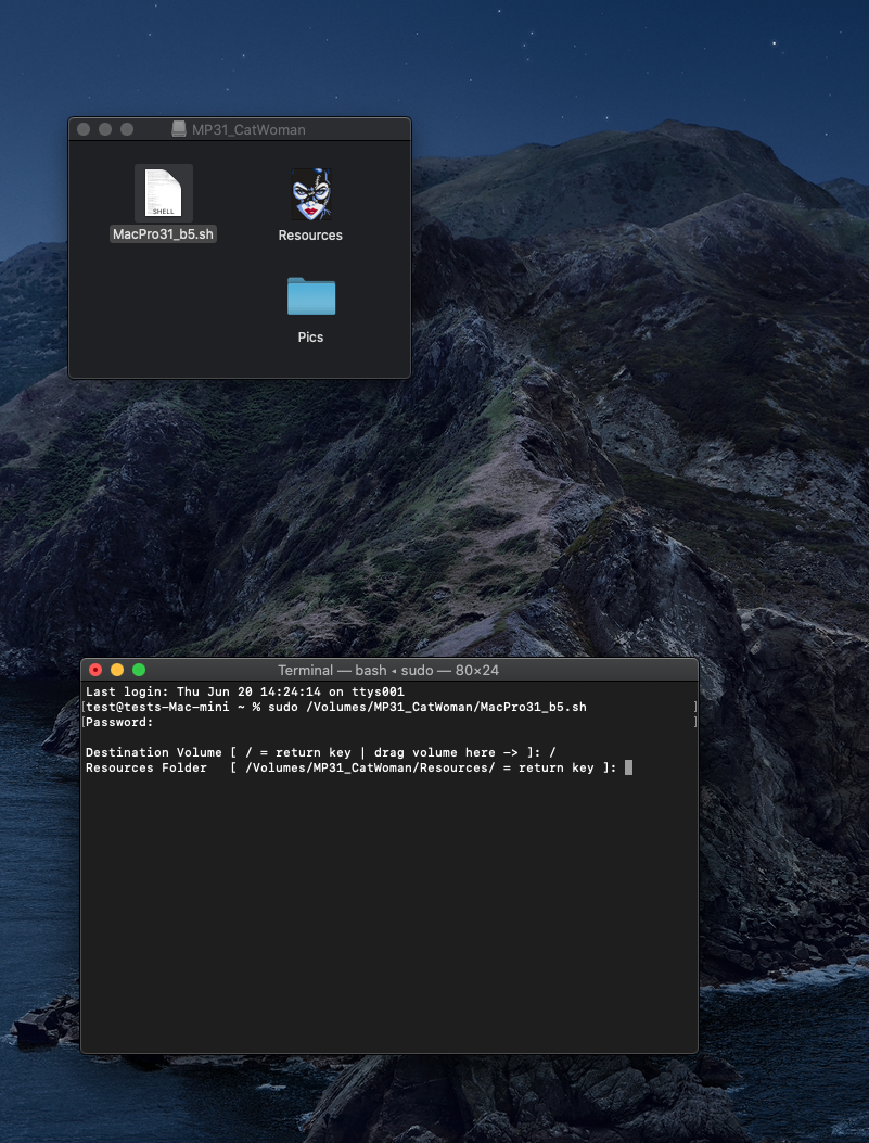

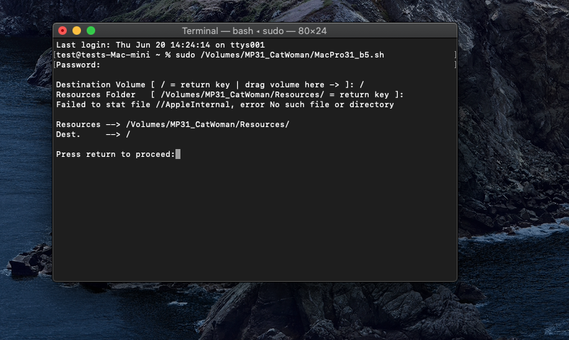

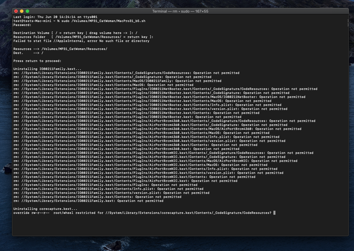

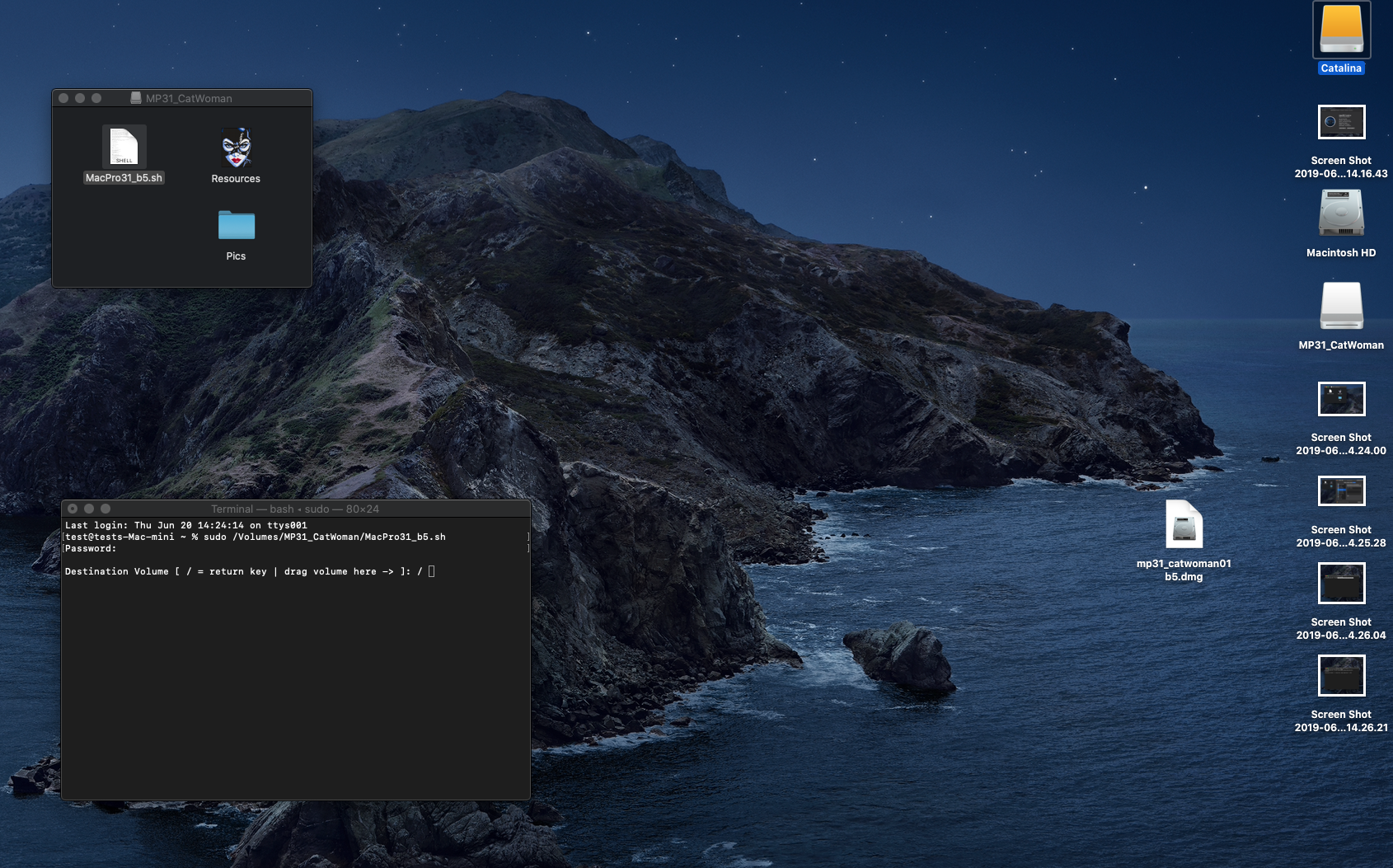

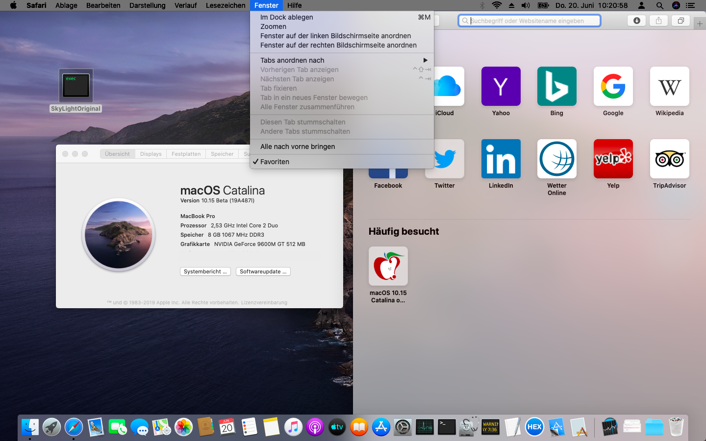

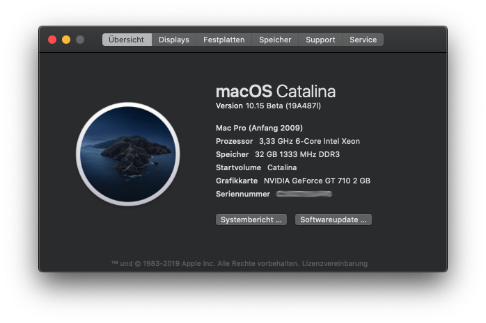

Here are some screen shots from a clean Catalina install and then a live patch and the resultant b5 script error mess Screen Shot 2019-06-20 at 14.16.43.png Screen Shot 2019-06-20 at 14.24.00.png Screen Shot 2019-06-20 at 14.25.28.png Screen Shot 2019-06-20 at 14.26.04.png Screen Shot 2019-06-20 at 14.26.21.png Screen Shot 2019-06-20 at 14.26.46.png Screen Shot 2019-06-20 at 14.27.02.png Screen Shot 2019-06-20 at 14.27.14.png Screen Shot 2019-06-20 at 14.28.58.png Screen Shot 2019-06-20 at 14.29.09.png Screen Shot 2019-06-20 at 14.16.43.png Screen Shot 2019-06-20 at 14.24.00.png Screen Shot 2019-06-20 at 14.25.28.png Screen Shot 2019-06-20 at 14.26.04.png Screen Shot 2019-06-20 at 14.26.21.png Screen Shot 2019-06-20 at 14.26.46.png Screen Shot 2019-06-20 at 14.27.02.png Screen Shot 2019-06-20 at 14.27.14.png Screen Shot 2019-06-20 at 14.28.58.png Screen Shot 2019-06-20 at 14.29.09.png ages
Reactions: TimothyR734
[doublepost=1560993289][/doublepost]It IS a Mac Pro 3,1 and it does have a metal nVidia GTX 680 that runs under Mojave—so it would seem to be identical to what you are testing and it does have the native APFS and NVMe boot rom patches.
But thanks for your efforts.

"Booted MM 7,1 into Mojave (internal) with Catalina on external SSD and used your beta 2 catwoman script to write patch to external SSD with correct paths.
Moved patched Catalina and booted. Although got gray Apple, progress stalls at about 2 cm into progress.
Any ideas?"
Can you clarify please? Maybe I'm just dense.

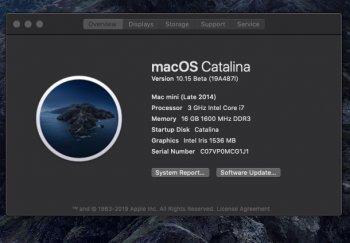

These screenshots are for a patch to a LIVE Catalina install booting the MM7,1—to show Starplayr the resultant errors on the b5 scripts.

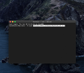

I have the same problem when I create the Catalina disk and then run the b5 patch on non-Live Catalina when it is on an external connected to the MM7,1 and is not the boot disk. I'll post those screenshots as soon as I have done a clean Catalina install (again!). It takes about 20 minutes to make a new clean install, so hold on.
Reactions: Kevbasscat

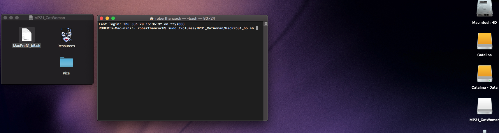

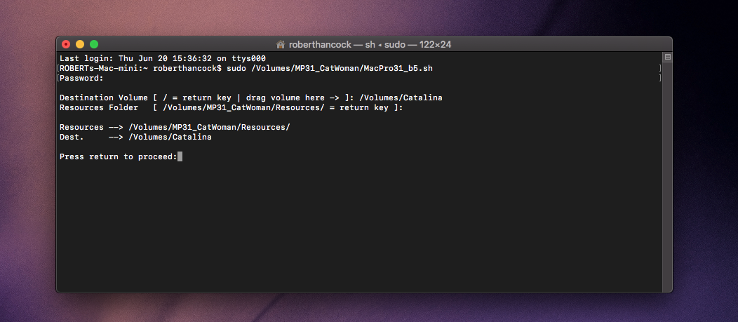

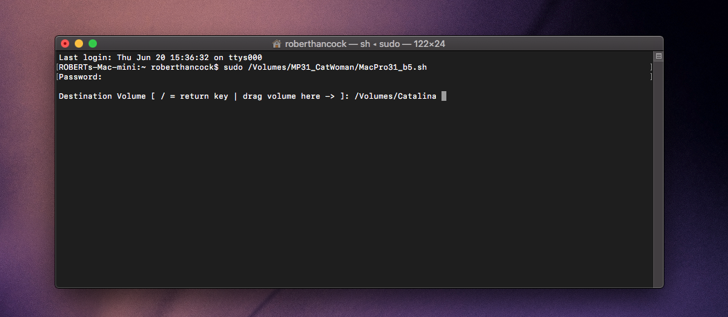

And here is the output of the b5 script when patching a clean NON-LIVE Catalina on an external SSD booted in Mojave. The screenshots are to show the source and destination paths.
Something is not right because these are not the lines that Starplayr gets.
Last login: Thu Jun 20 15:36:32 on ttys000
ROBERTs-Mac-mini:~ roberthancock$ sudo /Volumes/MP31_CatWoman/MacPro31_b5.sh
Password:
Destination Volume [ / = return key | drag volume here -> ]: /Volumes/Catalina
Resources Folder [ /Volumes/MP31_CatWoman/Resources/ = return key ]:
Resources --> /Volumes/MP31_CatWoman/Resources/
Dest. --> /Volumes/Catalina
Press return to proceed:
Uninstalling IO80211Family.kext...
Uninstalling corecapture.kext...
Uninstalling AppleHDA.kext...
Uninstalling LegacyUSBInjector.kext...
rm: /Volumes/Catalina/Library/Extensions/LegacyUSBInjector.kext: No such file or directory
Uninstalling IOHIDFamily.kext...
Uninstalling com.apple.telemetry.plugin...
Installing Broadcom WiFi (Mojave)...
Copying /Volumes/MP31_CatWoman/Resources/IO80211Family.kext
Copying /Volumes/MP31_CatWoman/Resources/corecapture.kext
Installing Native Sound (High Sierra)...
Copying /Volumes/MP31_CatWoman/Resources/AppleHDA.kext
Installing Legacy USB Injector (Parrotgeek)...
Copying /Volumes/MP31_CatWoman/Resources/LegacyUSBInjector.kext
Installing IOHIDFamily (ASentientBot Stall Fix)...
Copying /Volumes/MP31_CatWoman/Resources/IOHIDFamily.kext
Installing Telemetry (High Sierra)...
Copying /Volumes/MP31_CatWoman/Resources/com.apple.telemetry.plugin
Updating kextcache on volume /Volumes/Catalina...
Warning: /Volumes/Catalina/AppleInternal/Library/Extensions: No such file or directory
Warning: /Volumes/Catalina/Library/Apple/System/Library/Extensions: No such file or directory
Kext rejected due to improper filesystem permissions: <OSKext 0x7fc8df2a0280 [0x7fff8e89c8e0]> { URL = "file:///Volumes/Catalina/System/Library/Extensions/IOHIDFamily.kext/", ID = "com.apple.iokit.IOHIDFamily" }
Rejecting invalid/inauthentic kext for bundle id com.apple.iokit.IOHIDFamily at location file:///Volumes/Catalina/System/Library/Extensions/IOHIDFamily.kext/.
/Volumes/Catalina/System/Library/Extensions/AppleUSBDisplays.kext - no compatible dependency found for com.apple.iokit.IOHIDFamily.
/Volumes/Catalina/System/Library/Extensions/IOUSBHostFamily.kext/Contents/PlugIns/IOUSBHostHIDDevice.kext - no compatible dependency found for com.apple.iokit.IOHIDFamily.
/Volumes/Catalina/System/Library/Extensions/AppleUSBDisplays.kext is missing dependencies (including anyway; dependencies may be available from elsewhere)
/Volumes/Catalina/System/Library/Extensions/IOUSBHostFamily.kext/Contents/PlugIns/IOUSBHostHIDDevice.kext is missing dependencies (including anyway; dependencies may be available from elsewhere)
/Volumes/Catalina/System/Library/Extensions/AppleMultitouchDriver.kext - no compatible dependency found for com.apple.iokit.IOHIDFamily.
/Volumes/Catalina/System/Library/Extensions/AppleMultitouchDriver.kext is missing dependencies (including anyway; dependencies may be available from elsewhere)
/Volumes/Catalina/System/Library/Extensions/IOUSBFamily.kext/Contents/PlugIns/IOUSBHIDDriver.kext - no compatible dependency found for com.apple.iokit.IOHIDFamily.
/Volumes/Catalina/System/Library/Extensions/IOUSBFamily.kext/Contents/PlugIns/IOUSBHIDDriver.kext is missing dependencies (including anyway; dependencies may be available from elsewhere)
/Volumes/Catalina/System/Library/Extensions/IOUSBFamily.kext/Contents/PlugIns/IOUSBHIDDriverPM.kext - no compatible dependency found for com.apple.iokit.IOHIDFamily.
/Volumes/Catalina/System/Library/Extensions/IOUSBFamily.kext/Contents/PlugIns/IOUSBHIDDriverPM.kext is missing dependencies (including anyway; dependencies may be available from elsewhere)
Kext rejected due to improper filesystem permissions: <OSKext 0x7fc8df2af330 [0x7fff8e89c8e0]> { URL = "file:///Volumes/Catalina/System/Library/Extensions/IOHIDFamily.kext/Contents/PlugIns/IOHIDSystem.kext/", ID = "com.apple.iokit.IOHIDSystem" }
Rejecting invalid/inauthentic kext for bundle id com.apple.iokit.IOHIDSystem at location file:///Volumes/Catalina/System/Library/Extensions/IOHIDFamily.kext/Contents/PlugIns/IOHIDSystem.kext/.
/Volumes/Catalina/System/Library/Extensions/AppleACPIPlatform.kext/Contents/PlugIns/AppleACPIEC.kext - no compatible dependency found for com.apple.iokit.IOHIDSystem.
/Volumes/Catalina/System/Library/Extensions/AppleACPIPlatform.kext/Contents/PlugIns/AppleACPIEC.kext is missing dependencies (including anyway; dependencies may be available from elsewhere)
/Volumes/Catalina/System/Library/Extensions/AppleACPIPlatform.kext/Contents/PlugIns/AppleACPIButtons.kext - no compatible dependency found for com.apple.iokit.IOHIDSystem.
/Volumes/Catalina/System/Library/Extensions/AppleACPIPlatform.kext/Contents/PlugIns/AppleACPIButtons.kext is missing dependencies (including anyway; dependencies may be available from elsewhere)
/Volumes/Catalina/System/Library/Extensions/IOHIDFamily.kext/Contents/PlugIns/IOHIDSystem.kext does not authenticate; omitting.
Kext rejected due to improper filesystem permissions: <OSKext 0x7fc8df2ac8e0 [0x7fff8e89c8e0]> { URL = "file:///Volumes/Catalina/System/Library/Extensions/IOHIDFamily.kext/Contents/PlugIns/IOHIDUserClient.kext/", ID = "com.apple.iokit.IOHIDUserClient" }
/Volumes/Catalina/System/Library/Extensions/IOHIDFamily.kext/Contents/PlugIns/IOHIDUserClient.kext does not authenticate; omitting.
Kext rejected due to improper filesystem permissions: <OSKext 0x7fc8df2a0340 [0x7fff8e89c8e0]> { URL = "file:///Volumes/Catalina/System/Library/Extensions/IOHIDFamily.kext/Contents/PlugIns/IOHIDEventDriver.kext/", ID = "com.apple.iokit.IOHIDEventDriver" }
/Volumes/Catalina/System/Library/Extensions/IOHIDFamily.kext/Contents/PlugIns/IOHIDEventDriver.kext does not authenticate; omitting.
/Volumes/Catalina/System/Library/Extensions/IOHIDFamily.kext does not authenticate; omitting.
/Volumes/Catalina/System/Library/Extensions/AppleUSBTopCase.kext/Contents/PlugIns/AppleUSBTCButtons.kext - no compatible dependency found for com.apple.iokit.IOHIDSystem.
/Volumes/Catalina/System/Library/Extensions/AppleUSBTopCase.kext/Contents/PlugIns/AppleUSBTCButtons.kext is missing dependencies (including anyway; dependencies may be available from elsewhere)
/Volumes/Catalina/System/Library/Extensions/AppleUSBTopCase.kext/Contents/PlugIns/AppleUSBTCKeyboard.kext - no compatible dependency found for com.apple.iokit.IOHIDSystem.
/Volumes/Catalina/System/Library/Extensions/AppleUSBTopCase.kext/Contents/PlugIns/AppleUSBTCKeyboard.kext is missing dependencies (including anyway; dependencies may be available from elsewhere)
/Volumes/Catalina/System/Library/Extensions/AppleUSBTopCase.kext/Contents/PlugIns/AppleUSBTCKeyEventDriver.kext - no compatible dependency found for com.apple.iokit.IOHIDFamily.
/Volumes/Catalina/System/Library/Extensions/AppleUSBTopCase.kext/Contents/PlugIns/AppleUSBTCKeyEventDriver.kext is missing dependencies (including anyway; dependencies may be available from elsewhere)
/Volumes/Catalina/System/Library/Extensions/AppleHIDMouse.kext/Contents/PlugIns/AppleUSBHIDMouse.kext - no compatible dependency found for com.apple.iokit.IOHIDFamily.
/Volumes/Catalina/System/Library/Extensions/AppleHIDMouse.kext - no compatible dependency found for com.apple.iokit.IOHIDSystem.
/Volumes/Catalina/System/Library/Extensions/AppleHIDMouse.kext/Contents/PlugIns/AppleUSBHIDMouse.kext is missing dependencies (including anyway; dependencies may be available from elsewhere)
/Volumes/Catalina/System/Library/Extensions/IOBluetoothHIDDriver.kext - no compatible dependency found for com.apple.iokit.IOHIDFamily.
/Volumes/Catalina/System/Library/Extensions/AppleHIDMouse.kext/Contents/PlugIns/AppleBluetoothHIDMouse.kext - no compatible dependency found for com.apple.iokit.IOHIDFamily.
/Volumes/Catalina/System/Library/Extensions/AppleHIDMouse.kext/Contents/PlugIns/AppleBluetoothHIDMouse.kext is missing dependencies (including anyway; dependencies may be available from elsewhere)
/Volumes/Catalina/System/Library/Extensions/AppleHIDMouse.kext is missing dependencies (including anyway; dependencies may be available from elsewhere)
/Volumes/Catalina/System/Library/Extensions/AppleUSBMultitouch.kext - no compatible dependency found for com.apple.iokit.IOHIDFamily.
/Volumes/Catalina/System/Library/Extensions/AppleUSBMultitouch.kext is missing dependencies (including anyway; dependencies may be available from elsewhere)

Screen Shot 2019-06-20 at 15.39.24.png Screen Shot 2019-06-20 at 15.40.02.png Screen Shot 2019-06-20 at 15.40.17.png
Thanks for the instructions Starplayr, followed them to the letter but still the mouse and keyboard not detected, going to go and totally reinstall and try again:(
New approach of LightMode fix ("HybridMode 2.0")!!!
What is it:
- fixes broken areas in LightMode
- DarkMode isn't affected at all
- It's not exactly like the original LightMode under a supported machine, it's just a workaround as we (@pkouame and I) still didn't know the core problem of the broken LightMode
Known issues:
- Top MenuBar is still broken
Prerequisits to use patch:
- full acceleration achieved by @ASentientBot's patch!!!
How to install:
- Download new SkyLightOriginal
Backup your original file in /System/Library/PrivateFrameworks/SkyLight.framework/Versions/A/SkyLightOriginal
- Open Terminal and type:
Code:
sudo mount -uw /; sudo cp /PATH/TO/PATCHED/SKYLIGHTORIGINAL /System/Library/PrivateFrameworks/SkyLight.framework/Versions/A/SkyLightOriginal
(don't forget to replace /PATH/TO/PATCHED/SKYLIGHTORIGINAL)!!!
EDIT:
If you patch on-the-fly (as described above) you need to relaunch every app to see changes
EDIT2:
file now should be ad-hoc signed. keep copy of the original SkyLightOriginal!!!
  • SkyLightOriginal.zip
Finally got full acceleration on my mbp 8,1 late 2011 with the .PKG fix for intelhd3000 from @chris1111 . Many thnx!
Password:

View attachment 844010 View attachment 844011 View attachment 844012
On my MacPro 3,1 with GTX680, the approach that I have taken for installing either dosdude1's test patches or Starplayr's is to install from dosdude1's patched Catalina installer and on the first boot after the installer completes option select the patched Catalina usb installer again to launch its Terminal application. For Starplayr's patches, I used a second usb stick with the contents of his dmg mounted under the same volume name. In both cases, I had no issues applying the patches (except Starplayr's install script didn't grok destination volume names with spaces).
I ran into the read only file system myself tonight.
I used mount -o rw /
what's the different between
-uw /
and
-o rw /
never mind. I see it in the man page.
Thx.
They are exactly the same, just a common unix command that uses a slight different syntax.
However in your mp31patcher , since from Catalina beta2 APFS system folders are a bit more locked (even with SIP disabled), you should add before your scripts "sudo mount -u -w /"
That's why many here have issues using your patcher.
But if I don't get wrong "sudo mount -u -w /" is not required from Catalina Terminal when chown/chmod/kextcache, it's just required to replace system files/folders.
And I'd you suggest to don't remove "rm -R" the kext before patching, just overwrite with "cp -R".
[doublepost=1560995755][/doublepost]Thanks. Beta 2. It could be the VM thing because the last line in verbose boot is:
root# VM Swap Subsystem is ON
I'll try beta 3 of catwoman.
What seems to work much better is the following approach to installing the catwoman patches...
1) Install with a patched Catalina Beta 2 usb installer created by dosdude1's tool.
2) At the final reboot after the install completes, option select back into that usb installer and launch the Terminal app
3) Execute the catwoman patches install script from the terminal after inserting a second usb key with the contents of the catwoman dmg under the same volume name.
4) After the patches apply, reboot.

Thanks for the confirmation about the package working on real MacBook

1. Did you enable the Terminal to have full disk access in System Prefs?
2. What is your start up volume? Are you patching you current start up volume or another Partition. Because if it is another partition like /Volumes/something then / is wrong. try dragging the desired volume to the terminal prompt when it asked you for the destination.
It's saying you have file system permissions issue and it looks like the kextcache rebuild is failing.
Are you running this from a supported Mac or your unsupported Mac?
I think you should wait for Dosdude1's final patch tool. I've done all I can.
I would stick to booting on your MP3,1 and patching it there.

Hi there, I am new here although I am not new to the mac (had my first iBook G4 800 in 2003).

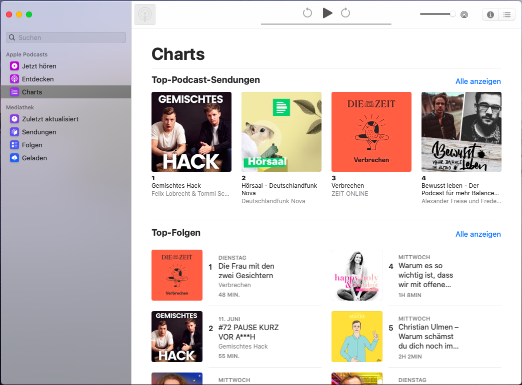

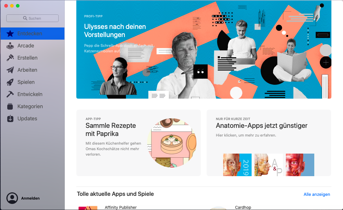

I just did a clean install of Catalina on my Mac Pro Early 2009 with the
DosDude1 patcher 1.0b12 and Catalina Beta2.
That's what I see so far:
1. The installation progress was only possible with Catalina Beta 2. With Beta 1 I got an APFS error. Also I hat to install my original graphics card (GeForce GT120) to get the installation screen. After installation Catalina booted but without screen (I think ... I cannot say if it was booted or not). I put the GT120 out and Catalina booted without any problem.
2. I looked a little bit around on the clean install and decided to migrate my data from my NVME SSD (unfortunately I only had a 500GB 2,5" HDD to test Catalina so I cannot say anything about performance).
3. After migrating the data everything worked like a charm (except of the 32-Bit apps of course)
So after 2h of playin' around with Catalina I can say: There is almost no difference to Mojave in functionality. I will test it out further.
Here is my configuration:
In case of stability and functionality I cannot see any reason not to support the cMP in Catalina.
Thanks to DosDude1 and everybody else working on the patcher!
What is it:
Known issues:
How to install:
Code:
