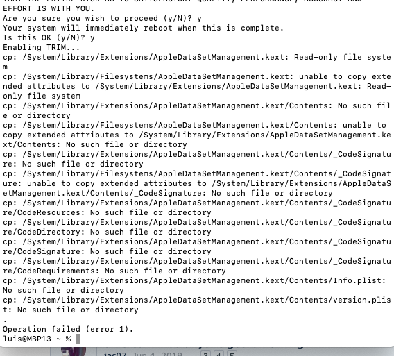

Any workaround to enable TRIM in Catalina?
I'm getting this:
Tried in single user mode and didn't work either.

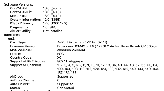

It would be interesting to see what one of those machines report under Mojave in the wifi section. On my machine, I have...
Card Type: AirPort Extreme (0x14E4, 0x111)
Firmware Version: Broadcom BCM43xx 1.0 (7.77.61.2 AirPortDriverBrcmNIC-1305.8)
Mine says exactly the same as yours. Works oob with Mojave 14.4/14.5. Yet to try with Cat, let you know what happens when I get around to it.

@ASentientBot has already found it, type before from Catalina Terminal: sudo mount -uw /
just ignore the "/AppleInternal" error, since it is present also from single user mode and from Mojave if I don't get wrong.
nope I tried that. It looks as it succeeded, reboots but does't enable TRIM. I've managed to enable it using Cindori's Disk Sensei. It complains of a kext not working in future versions of macOS but it works.

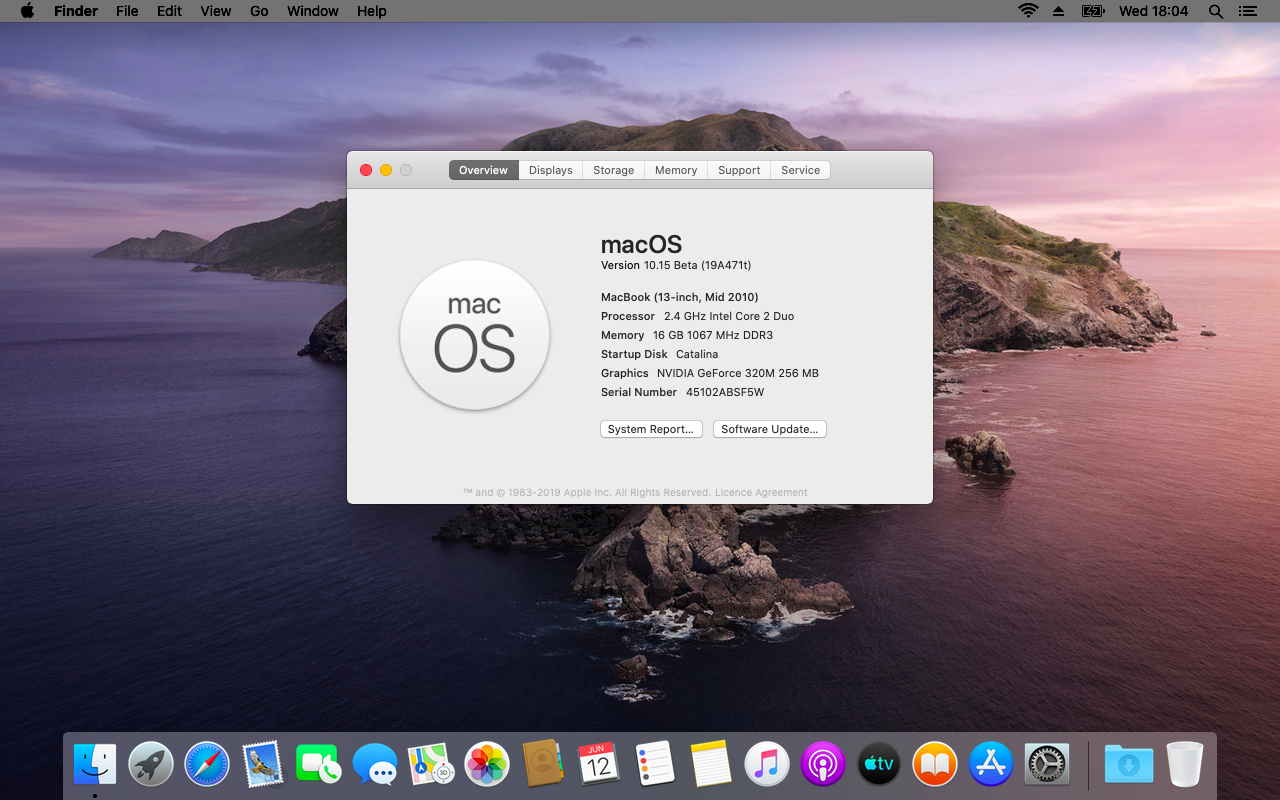

I was able to enable TRIM without any issues on a MB5,1 under 10.15 Beta. Or is it just a Catalina Beta issue?
Catalina only
I meant what a iMac 14,1 or 14,2 with the Apple factory installed BCM94360CD reports for card type and firmware. People are assuming that they are different from those sold on eBay such as the one I bought.
https://www.ebay.com/itm/Broadcom-B...629645?hash=item3d88c5314d:g:26MAAOSw~HJct1kA
However, I seem to recall that these cards had problems running on early Mojave as well. So perhaps Apple just got overzealous in removing code when they disabled the remaining BCM94* n-wireless card support.
If you are on Catalina beta1 then APFS system was less locked, from beta2 is required to mount it as writable manually when need to modify system files/folders.
[doublepost=1561204344][/doublepost]
[doublepost=1561202980][/doublepost]
Catalina only
I guess that app uses the classical terminal command, but have you tried:
sudo mount -uw / ; sudo trimforce enable
I cannot test it since I use an SSD for Catalina but it's an external USB so no "trim status" since I guess it's only available over an AHCI or NVMe controller.

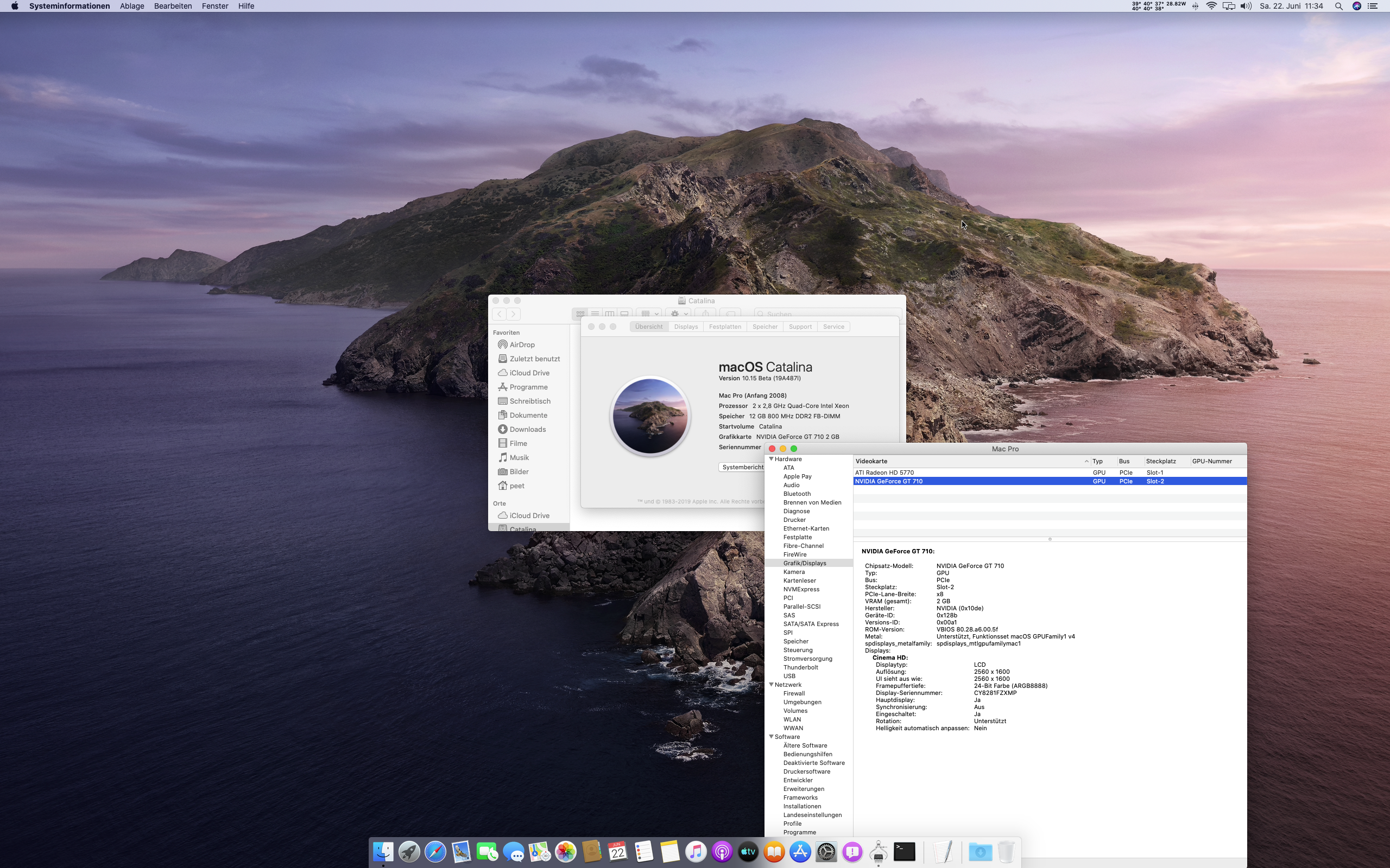

The macOS Catalina Patcher b15 works nearly perfect on my iMac 2009 Core2Duo, 16GB RAM w. ATI4670
Graphics,Sound, Sleep runs OOB except WIFI. But i ll inject the patched WIFI Kext from the Mojave Patcher and testing a bit. So far, THIS is some excellent work and everyone of you should be proud to this!
RIP Adobe CS6 Programs...

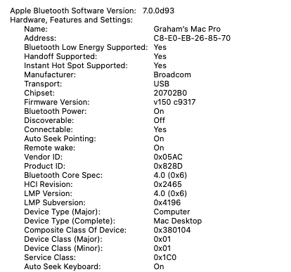

Just installed Cat B2 to see what happens. Used dosdude1's beta patcher and patches. (Thanks dosdude1 all went seamlessly for mp3.1). Bluetooth and Wifi working without any other input. All seems to be working well.
My card originally did. It with on 5Ghz even though it detected it. Later Mojave drivers seemed to have fixed this issue. Same Mojave WiFi drivers run on Catalina.

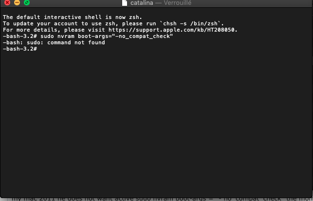

hi brother proublem and not on the usb or catalina jais finds the proublem and on the tirmnel or subject of my mac 2011 he does not want active sudo nvram boot-args = "- no_compat_check" the moment I format the hard disk and minarine tirminal and sudo nvram boot-args = "- no_compat_check" it rine
here I go on another mac book 2009 he installs and he activates sudo nvram boot-args = "- no_compat_check" and out samarche and bine installs
the proublem and on
sudo nvram boot-args = "- no_compat_check" I think the macbook pro 2011 it if not the hard disk APFS or bios
the proublem and on
Without sudo from there only: nvram boot-args="- no_compat_check"
