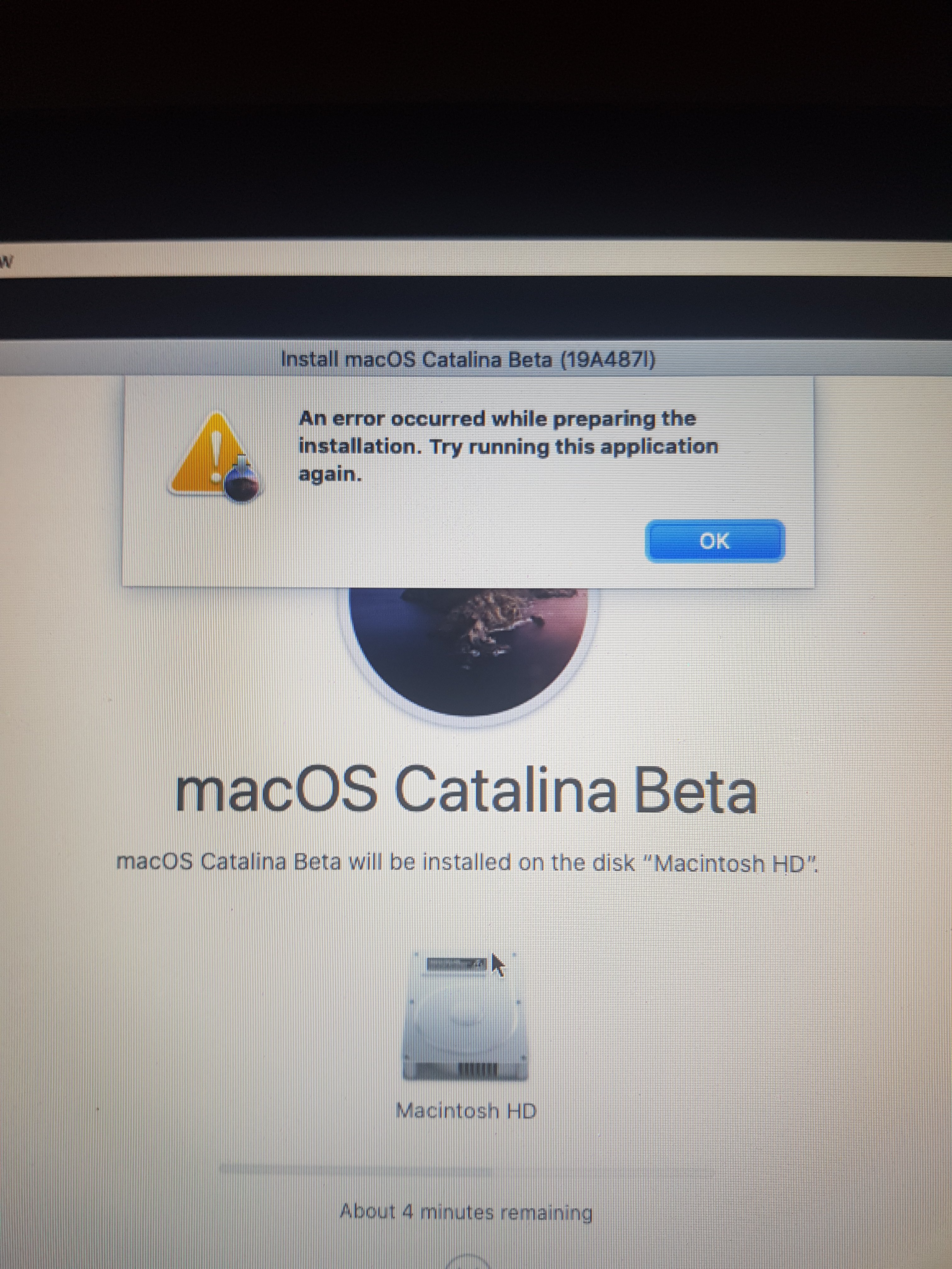

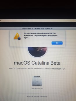

I'm using 0403979's patcher on a Macbook Pro 7,1 and I get this error. Anyone know what i'm doing wrong?
Reactions: TimothyR734

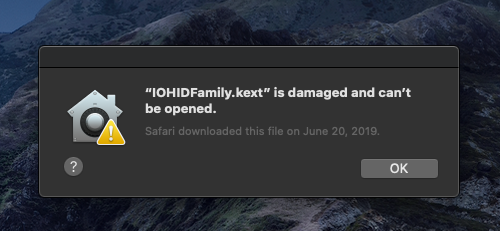

On a MacPro 3,1 running Catb2 using the combined dosdude1, Starplayr, jhowarth method, I am seeing this damaged kext warning (attached) on a restart. It does not seem to affect anything yet and the OS is running as expected with the usual bugs.

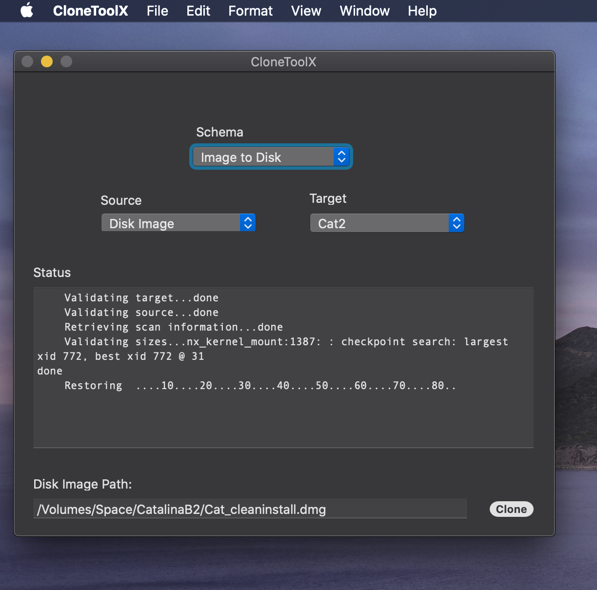

CloneToolX update. It is now restoring volumes from disk images. It is pretty fast. Overcoming some on minor obstacles along the way.
Did that appear after the initial installation and patching or is it something that appeared on a later reboot? If not, I would try reinstalling from the 1.0b15 created usb installer and use dosdude1's bundled patcher to see if that eliminates it. Otherwise, you might want to check that smart isn't shows any failures on your storage device. I've done around 10 reinstallation this week and never saw anything like that.
