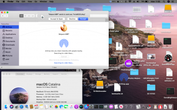

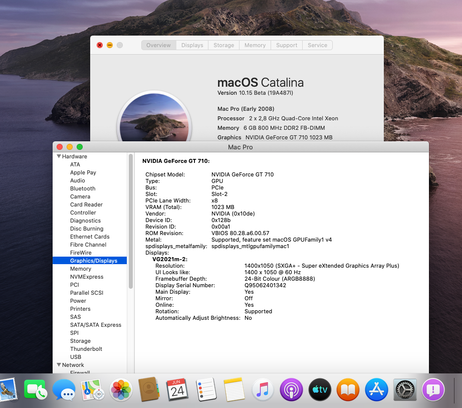

I wish to thank all the great people here who have made this possible. Mac Pro 3,1 running 19A487l with original (non-APFS) firmware, non-EFI metal graphics card.

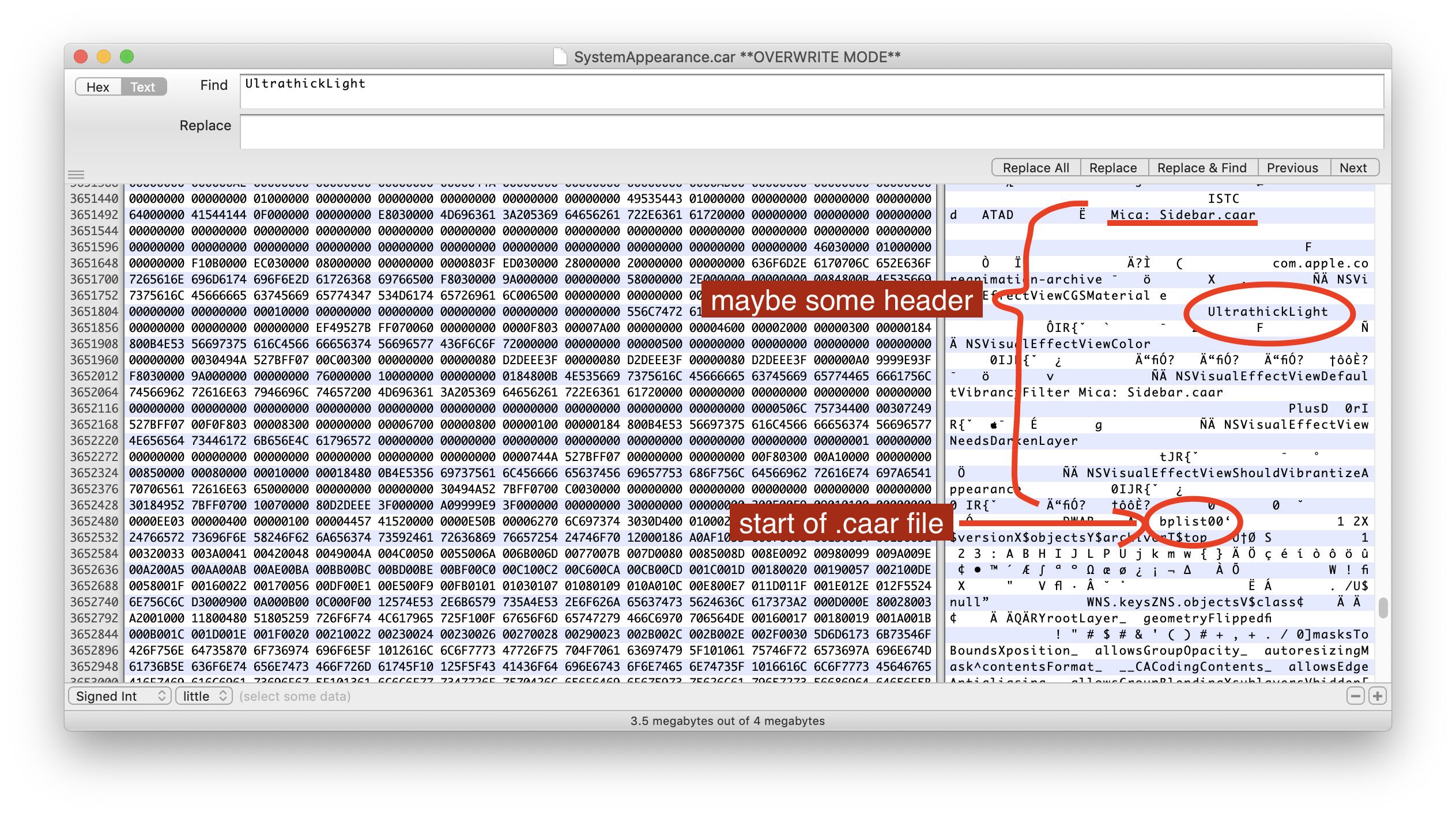

I would like to share some insights about the current light mode patch and hopefully some talented people here could help us to get us some new input.
A brief recap about the current process:
- SystemAppereance.car contains everything for the basic "look" of macOS, like colors, UI-Elements and materials
- these materials are embedded in SystemAppereance.car as single caar files (be careful with car and caar, this are binary plist-files, starting with "bplist00..." if inspected by a Hex-Editor and could be extracted e.g. with an app called ThemeEngine)
- these caar files contain the layers of the individual materials. months ago @pkouame and I spend some time to search common parameters of broken materials in this caar files. We even built them by hand in Xcode, and as far as I remember they worked correctly there. You could also inspect a caar file with the app Kite, and also there they work properly with transparency. So we didn't find something really interesting.
And we shouldn't find anything, as I think the caar files are totally right. The common parameter is inside the header (as I call it) you could see here
It is some information ahead of the caar file itself. Even ThemeEngine doesn't show this information as far as I remember. And if you export the caar file, of course this additional header is not included. It is also clear, that if you swap the whole .car(!) file with the one from DarkMode it works almost properly (excluding text rendering), as inside the DarkMode .car file this header refers to UltrathickDark for example, instead of UltrathickLight. Also taking a .car file from older macOS versions shouldn't work at all or at least could not fix the broken areas because as we have seen earlier the old "headers" refer to the old descriptions for example Ultralight (no ..Light or ..Dark at the end).
- these descriptions/"base materials" are definitely the common ground of broken areas and are processed by SkyLight. They are individual for light and dark mode and only some of the Light ones are broken. If replaced by a working one, it fixes all materials from SystemAppereance.car with this specific descriptions in the header. Another reason that shows, that CoreUI patches worked indeed, but weren't in the right place.

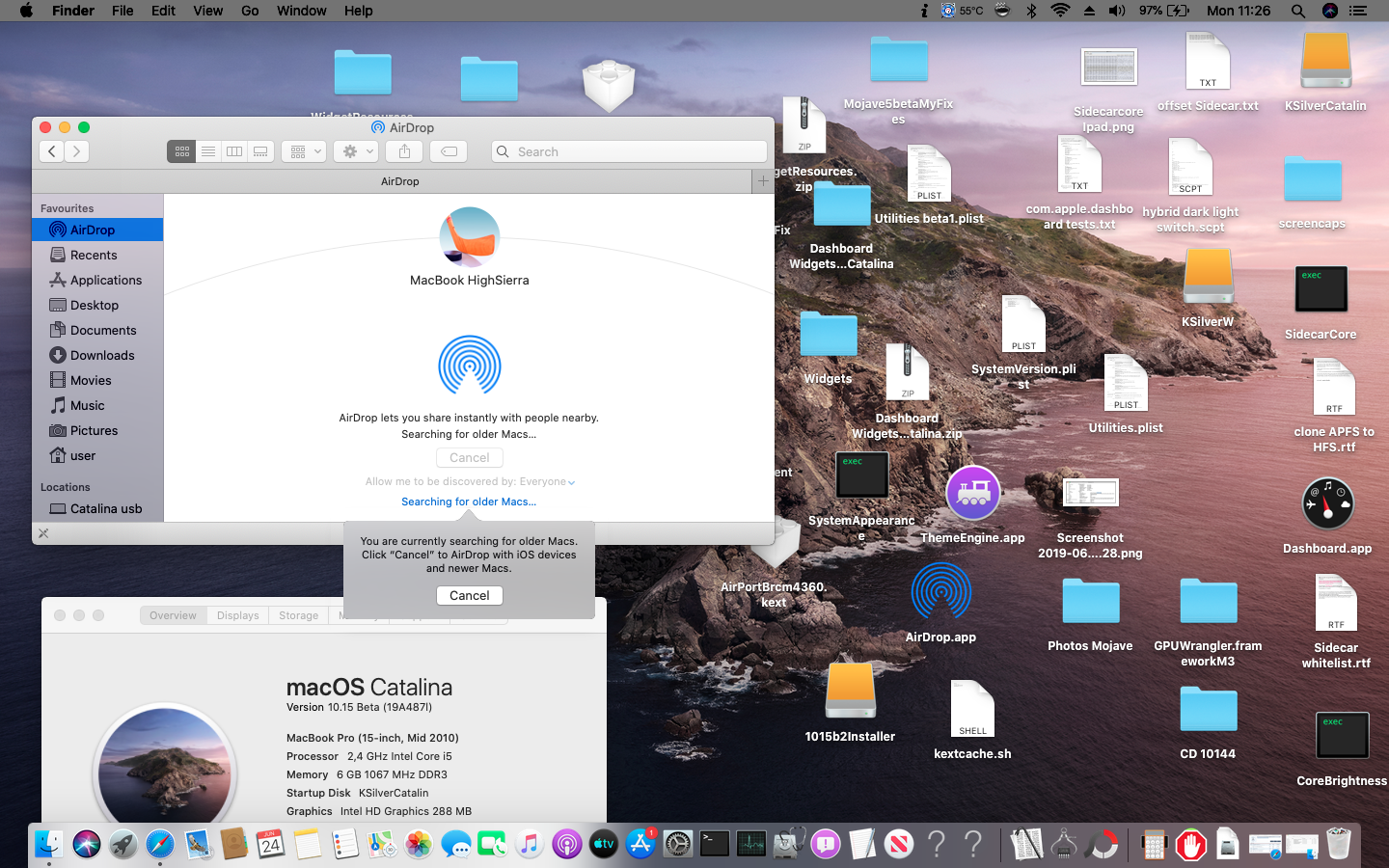

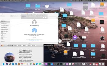

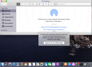

I guess I've patched the Catalina AirDrop to use AirDrop without a BT 4.0 usb dongle.
I've re-enabled the AirDrop legacy feature "Don't see who you're looking for?" and "Search for an Older Mac" that from Catalina was dropped.
"Older Macs" in AirDrop are considered by apple all the machines without a BT 4.0 internal device, so those with a BT 2.1 internal device.
Here are the steps from Catalina Terminal:
sudo mount -uw / ; killall Finder
open /System/Library/CoreServices/Finder.app/Contents/Resources/Base.lproj/
Ovewrite the file AirDropInfoView.nib attached with the one inside that path.
After replace no need to reboot just from Catalina Terminal: killall Finder
The only file attached is suffice in my case (probably because of my previous manual patch on the
Brcm4360 driver used) to allow using the BT 2.1 , but consider that some very legacy machines may need to replace from Mojave the entire folder attached, the Mojave AirDrop.app should be re-placed inside the /Catalina/System/Library/CoreServices/Finder.app/Contents/Applications/
On the picture attached both the machines use their default Bluetooth 2.1+EDR internal device, the other one is MacBook7,1 with HighSierra installed, and the HS one can detect this Catalina MacBookPro6,2 .
Next picture I unplug this Catalina USB SSD external and plug to the MacBook7,1 and from MacBookPro6,2 I run a Mojave, lets check it out.
In both cases it's bidirectional working.
I've tried also from a MacBook7,1 Mavericks AirDrop to discover and be discovered from Catalina and it's totally working.
My AirDrop "Search for an Older Mac" method works also on Catalina supported Macs, that are not allowed to discover and be discovered from legacy machines, since apple dropped the "Search for an Older Mac" function from Catalina.
Instead replacing on a supported Catalina this AirDropInfoView.nib brings back that function, AirDrop will work and allow to discover/discovered also very legacy Macs (I guess until 10.7 OSX Lion when AirDrop was introduced by apple).
  • Legacy AirDropInfoView.nib.zip

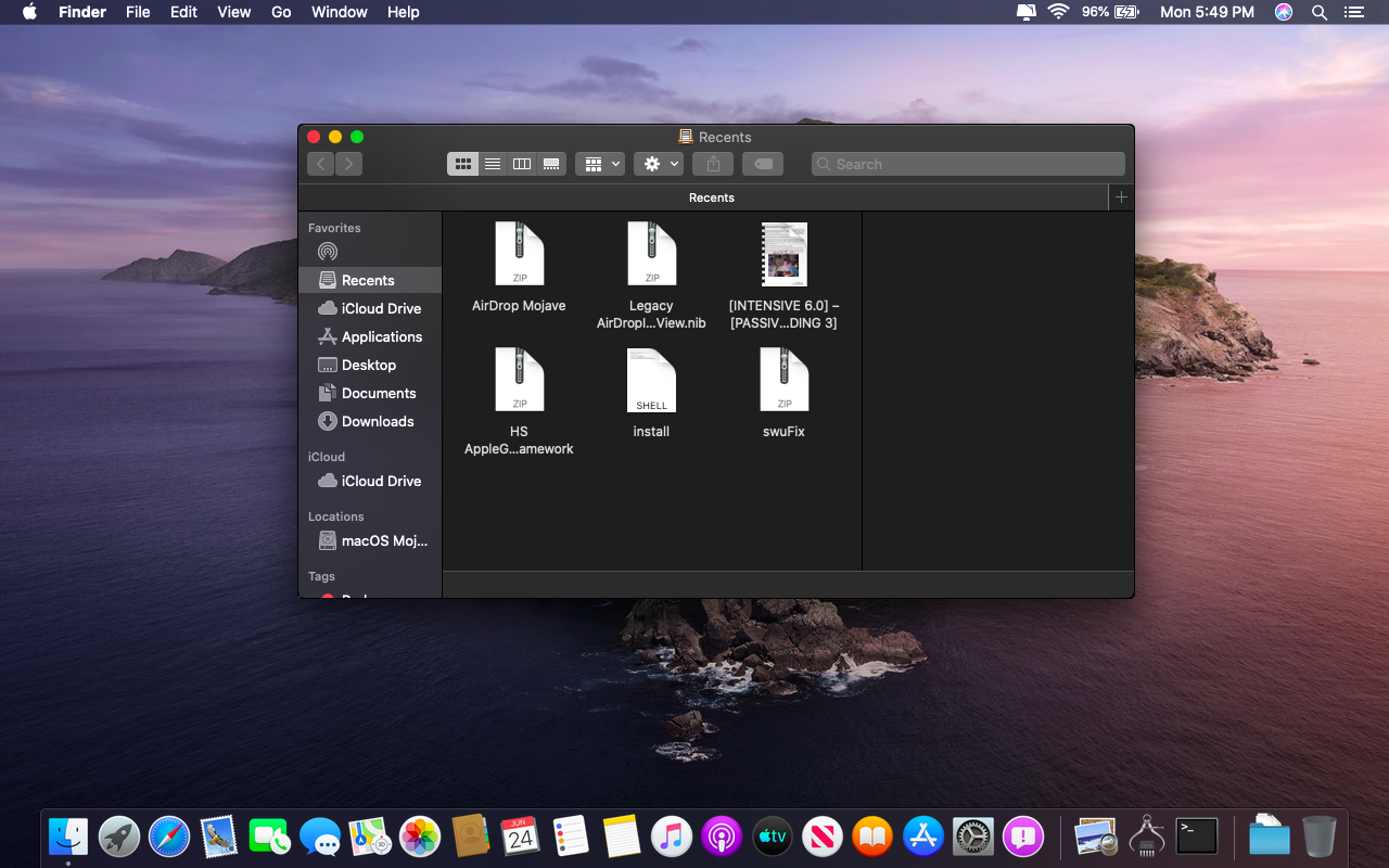

Actually, Finder crashed after rebooting...
Reactions: TimothyR734
It appears on reboots after the initial install. Not urgent b/c this machine is just for testing. I'll wait a few beta iterations and try again nearer the GM.
This is the current light mode patch implementation in SkyLight:
Original

- unfortunately MenuBar is rendered different, maybe in SkyLight but many things point to HIToolbox
It would be great, if someone could figure out, how these materials (UltrathickLight, ThickLight, ...) are processed by SkyLight and where there is the difference with the dark mode ones.
I think with the discovery of these materials inside SkyLight we are way more closer to the "core problem". We could also discuss this topic on Discord if you guy would like to do so, or want to share some results.

To have that AirDrop icon with no name, you don't used my previous method (the 4360 driver) but should have used other scripts before for example this:
defaults write com.apple.NetworkBrowser BrowseAllInterfaces 1
That on Catalina doesn't work more.
But maybe you should open SystemReport on Wifi tab and check which Broadcom AirPort do you have 0x14E4
probably some different or older Broadcom Wifi can't enable this AirDrop menu.
My method has been tested and is totally working on 0x14E4 , 0x9* and later Broadcom AirPort Wifi cards and even on supported Catalina Mac.

Mine is 0x14E4, 0x8D
Then I guess that's reason , I tested and working on 0x14E4, 0x9* (or later Broadcom AirPort Wifi cards example 0x14E4, 0XF* or 0xD* and so on) and on a Catalina supported Mac too.
You may try to find your "PCI Match ID" and add it the Info.plist 4360 driver, from Catalina Terminal to detect it:
ioreg -r -n ARPT | grep IOName
These should be the AirDrop supported machine (at the bottom): https://support.apple.com/en-us/HT203106

So, with this new SkyLight patch, are the light mode issues still solved by swapping materials or have you gotten the original materials working? I’m asking this because the material swapping method doesn’t really produce the best results and I’m curious about the method. Discord is better for discussion but I think this forum is a great place to post status updates.
The fix is still achieved by swapping materials, as you could see by comparing the two functions (before and after). BUT this time dark mode is completely UNTOUCHED by this patch. It ONLY modifies light mode, as only there the broken areas appear. So I think it's better than the previous hybrid patch, as this time all the people how prefer dark mode still could apply the patch, without taking any disadvantage.
