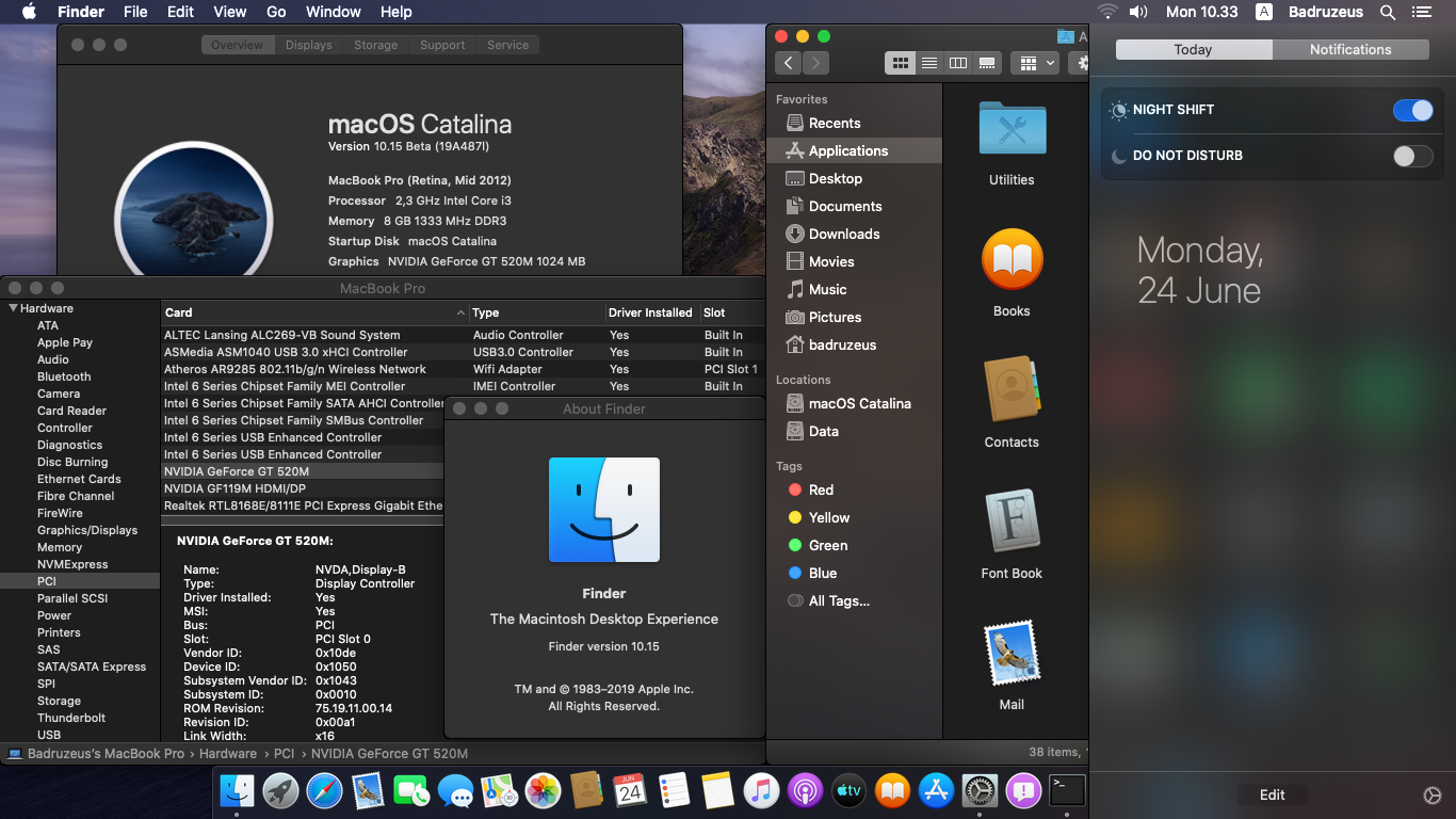

Thanks @ASentientBot finally full GFX Acceleration (QE/CI) on my Nvidia Fermi GF119 achieved on 10.15 Beta 2. What insteresting is I need using these additional tweaks from 10.14.4 (not 10.14.3):
Code:
- CoreDisplay.framework (10.14.4) + your wrapped CoreDisplay & CoreDisplayOriginal (10.14.4)
- OpenGL.framework (10.14.4)
- GPUSupport.framework (10.14.4)
- SkyLight.framework (10.14.4) + your wrapped SkyLight + SkyLightOriginal (10.14.4)
- GeForce.kext, GeForceGLDriver.bundle, GeForceVADriver.bundle (10.14.4)
- AppleGraphicsControl, IOAccelerator, IOGraphics, IONDRV, IOSurface, NVDA* are vanilla from 10.15 Beta 2
- I don't use NDRVShim.kext on Fermi #CMIIW
Sorry, screenshot is taken from H*ckintosh laptop. Yeah, I think provided GeForce, NVDAGF100, NVDAResman* (10.15) from Apple make differences here.

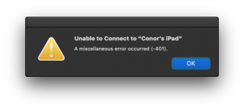

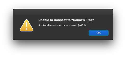

Hey all,
I've got this running smoothly on my Macbook Pro 2011 without much modification, the only issue I'm facing is Sidecar crashes after showing a black screen on the iPad for 5 seconds. After checking, it seems that Sidecar is looking for a Metal Device (a GPU supporting metal) for Sidecar. I'm wondering if it would be possible at all to use OpenGL for Sidecar? It seems very far fetched and I'm not sure if it's possible but it was worth a suggestion.
Thanks!
Edit:

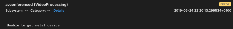

After reading the logs, this is what I get from when Sidecar is started to when it crashes:
SidecarReplay sends an event ‘com.apple.sidecar’ with 1 key
SidecarRelay activates something
SidecarRelay registers events with the IDs *
SidecarRelay (RPStreamServer) activates 0x0>
SidecarRelay (RPRemoteDisplaySession) registers the request ID “streamStart”
SidecarRelay (RPRemoteDisplaySession) registers the request ID “streamStop”
rapportd (RPRemoteDisplaySession) activates a session from SidecarRelay:ID to the iPad, in my case an iPad 7,5
SidecarReplay sends an event ‘com.apple.sidecar’ with 2 keys (to the iPad maybe?)
SidecarReplay sends another event ‘com.apple.sidecar’ with 2 keys (to the iPad maybe?)
SidecarRelay (RPRemoteDisplaySession) is activated, probably established the link with the iPad.
rapportd queues multiple event sends, these are then sent
rapportd then receives an event ID ‘com.apple.sidecar’ with 1 key from the iPad
SidecarRelay (RPStreamServer) starts a stream session with the ID: ‘ID:HIDRelay’, the type RPCnx
SidecarRelay’s CUTCPServer Is then activated on port 51804
The session that was started is then prepared by SidecarRelay in the RPStreamSession
SidecarRelay starts a stream session with the type UDPNWPath and another with an AVCVideoStream
The UDPNWPath is then queued for activation
The UDPNWPath is then started
The connection is started from a UDID at the port 50440 (probably the iPad)
the session connection is accepted from the HIDRelay (RPCnx)
There is another server connection queued for startup by the SidecarDisplayAgent with the type RCPnx
SidecarRelay (CUTCPServer) then invalidates the stream, after the stream is activated on socket 4. This is repeated multple times until it gives up, with errors from the AVCVideoStream and more, hinting at a metal issue? ‘Unable to get metal device’ is also printed multiple times from the avconference daemon.
From my research, it seems like sidecar is requiring metal to function, it may be possible to use OpenGL instead but very unlikely, hopefully this analysis can help someone, if you have anything to add just reply and I’ll add it.

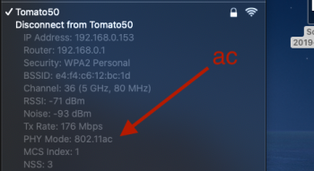

That would depend if that card is available and is the interface same type that 3,1 accepts. Plus the 3,1 may have a different entry point to get its network working with may rely on the previous kext to access it. Also if it's an 802.11ac card, it would be an expensive replacement. 802.11n cards are much cheaper.
Yes, it works, the slot is compatible with an adapter (although it's a PITA to connect the antennas) and it supports 802.11ac (see screenshot). And yes, it was expensive from here.
https://www.osxwifi.com/product/mac...94360cd-802-11-a-b-g-n-ac-with-bluetooth-4-0/
