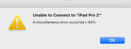

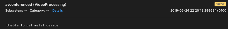

Hey all,
I've got this running smoothly on my Macbook Pro 2011 without much modification, the only issue I'm facing is Sidecar crashes after showing a black screen on the iPad for 5 seconds. After checking, it seems that Sidecar is looking for a Metal Device (a GPU supporting metal) for Sidecar. I'm wondering if it would be possible at all to use OpenGL for Sidecar? It seems very far fetched and I'm not sure if it's possible but it was worth a suggestion.
Thanks!
Edit:
After reading the logs, this is what I get from when Sidecar is started to when it crashes:
SidecarReplay sends an event ‘com.apple.sidecar’ with 1 key
SidecarRelay activates something
SidecarRelay registers events with the IDs *
SidecarRelay (RPStreamServer) activates 0x0>
SidecarRelay (RPRemoteDisplaySession) registers the request ID “streamStart”
SidecarRelay (RPRemoteDisplaySession) registers the request ID “streamStop”
rapportd (RPRemoteDisplaySession) activates a session from SidecarRelay:ID to the iPad, in my case an iPad 7,5
SidecarReplay sends an event ‘com.apple.sidecar’ with 2 keys (to the iPad maybe?)
SidecarReplay sends another event ‘com.apple.sidecar’ with 2 keys (to the iPad maybe?)
SidecarRelay (RPRemoteDisplaySession) is activated, probably established the link with the iPad.
rapportd queues multiple event sends, these are then sent
rapportd then receives an event ID ‘com.apple.sidecar’ with 1 key from the iPad
SidecarRelay (RPStreamServer) starts a stream session with the ID: ‘ID:HIDRelay’, the type RPCnx
SidecarRelay’s CUTCPServer Is then activated on port 51804
The session that was started is then prepared by SidecarRelay in the RPStreamSession
SidecarRelay starts a stream session with the type UDPNWPath and another with an AVCVideoStream
The UDPNWPath is then queued for activation
The UDPNWPath is then started
The connection is started from a UDID at the port 50440 (probably the iPad)
the session connection is accepted from the HIDRelay (RPCnx)
There is another server connection queued for startup by the SidecarDisplayAgent with the type RCPnx
SidecarRelay (CUTCPServer) then invalidates the stream, after the stream is activated on socket 4. This is repeated multple times until it gives up, with errors from the AVCVideoStream and more, hinting at a metal issue? ‘Unable to get metal device’ is also printed multiple times from the avconference daemon.
From my research, it seems like sidecar is requiring metal to function, it may be possible to use OpenGL instead but very unlikely, hopefully this analysis can help someone, if you have anything to add just reply and I’ll add it.

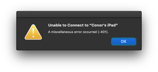

Almost same issue with Sidecar on a Mac Pro 3.1 equiped with a GTX 770 (metal capable) and a iPad Pro 12,9 2nd gen. I don't have the error related to metal device but the result is the application crash.

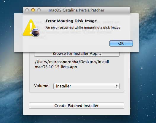

Guys, I`m trying to create bootable disk usb of Catalina with Patcher, but everytime occure this error and I don`t know what I do anymore... Look image...
I`m using Macbook Air, OS Mountain Lion, Mid 2011, 4.1, Core i5.

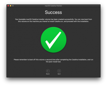

At last, the first preliminary release of the FULL macOS Catalina Patcher is now done! This is definitely one of the best macOS patcher implementations I've ever created, and it works amazingly well! I have not yet implemented all the features I intend to, but they will be coming very soon. As of now, the tool works perfectly with its new user interface, and will allow you to install a fully-patched copy of macOS Catalina on your unsupported system!
The tool is able to run under as old as Mac OS X version 10.6 (Snow Leopard), ensuring maximum compatibility (doesn't use any of that awful Swift rubbish).
As of now, the same prequisites apply as with macOS Catalina PartialPatcher:
  • The system must support booting from APFS volumes natively, or have had native APFS support added to its BootROM via my APFS ROM Patcher tool
  • -no_compat_check must be set in NVRAM to install, as detailed on the webpage.
Let me know how you all like it, and of course, please report any bugs!

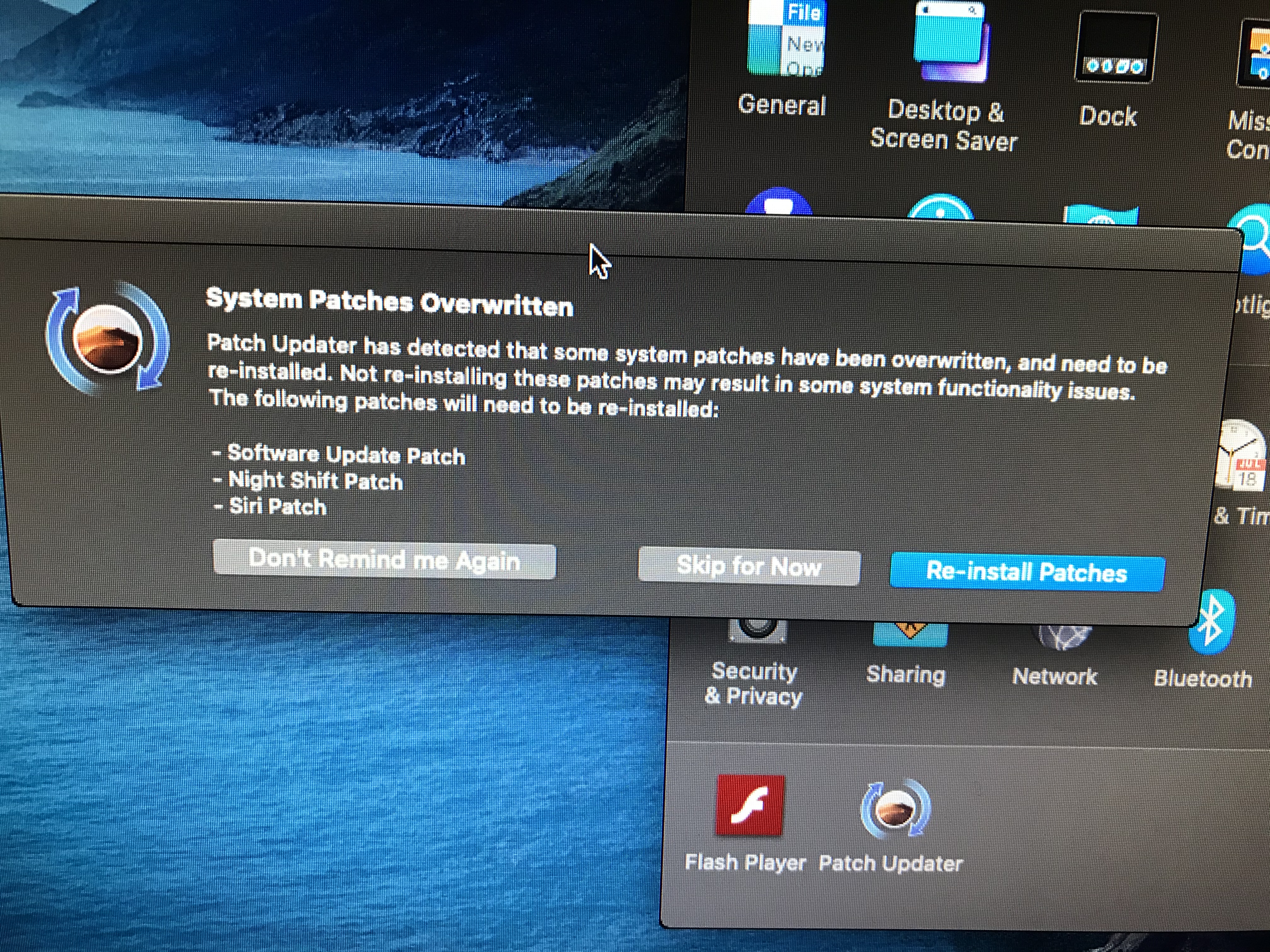

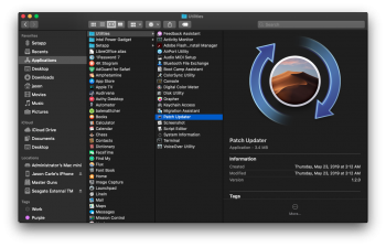

I just finished installing Catalina on my 5.1 mini and had this pop up.
You did an upgrade from Mojave. Just remnants of Mojave Patcher. Just select "Don't Remind me Again", as those patches will mess up Catalina.

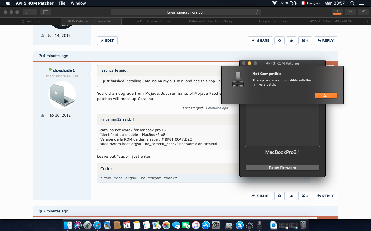

APFS ROM Patcher tool for
MacBookPro8,1 not worek

You can't use it on that system, as it natively supports APFS. Download and run this package to install the latest official system firmware on your machine.
or I can find it you talk about
MacBook Pro MCUpdate.dmg
mac2015efiupdate..dmg package to install the latest firmware on your machine.

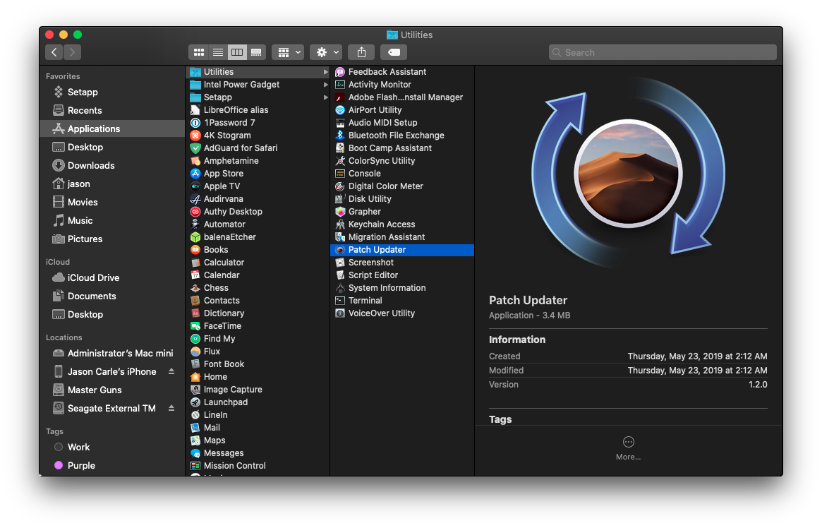

I did, somehow it remained even after a wipe of the ssd. Oh well, thank you for the answer.
edit: I bet that the migration assistant brought over the old patcher to my system. Is there a way to tell which one is the new one?
Amazing work! Looks as good as the official installers, thanks for your hard work. @dosdude1
Reactions: dosdude1
