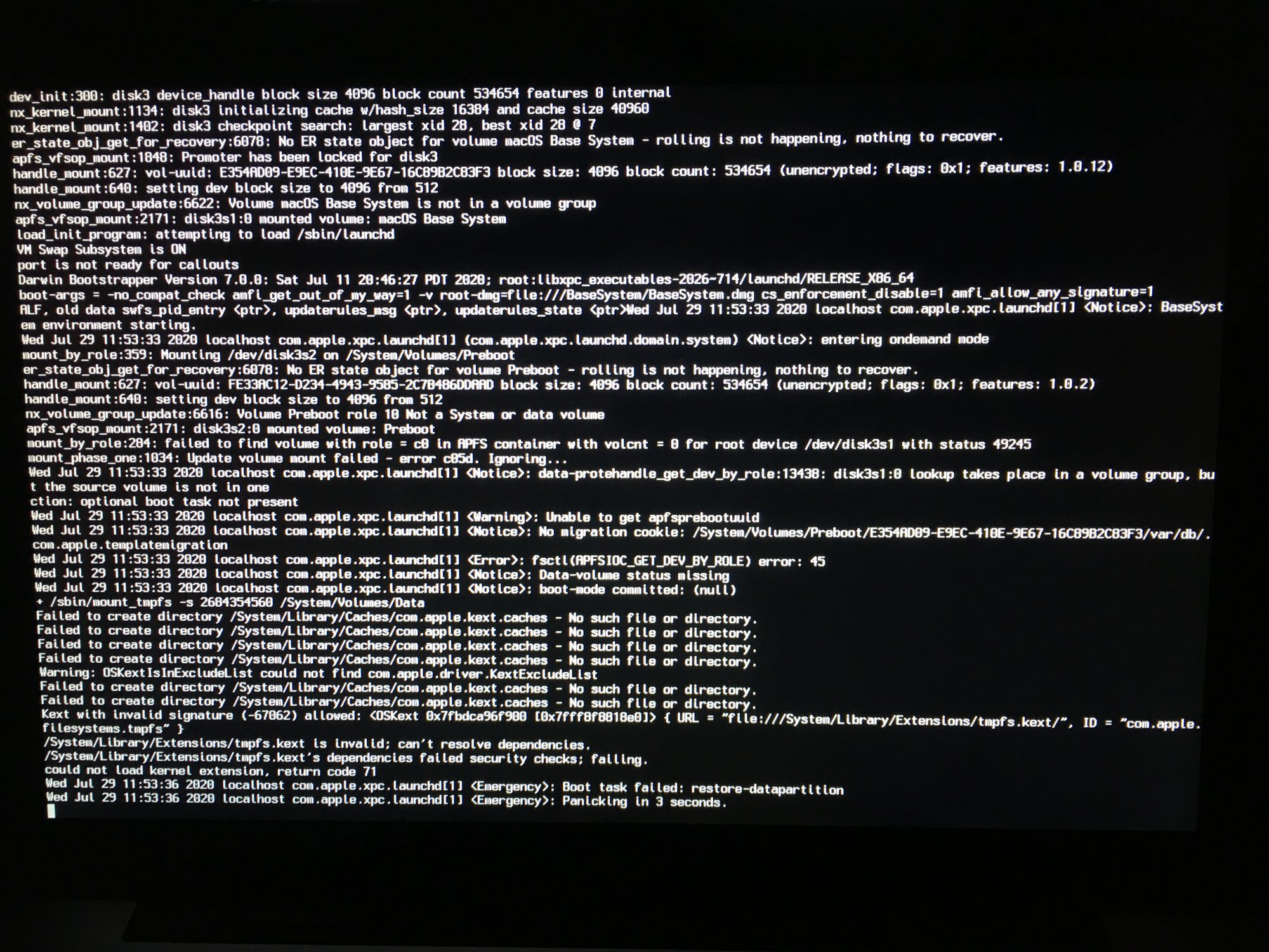

It actually is possible to boot the BaseSystem with a prelinkedkernel. I just did it. (Basically, I used LZVN to extract all the kexts from the prelinkedkernel, then created a Zip archive of the System folder inside LZVN's kext output, then extracted that Zip archive at the root of the BaseSystem so that the kexts in that archive would overwrite the same kexts on the BaseSystem, but kexts on the BaseSystem that were never in the prelinkedkernel would be left alone.)
Part of what helped me figure out that this needed to be done, is that I managed to get a photo of the messages leading up to the kernel panic. I'm attaching that photo since it might be enlightening to others. (What's happening is something along the lines of launchd invoking mount_tmpfs, which tries to load tmpfs.kext, and that fails for some reason, so mount_tmpfs fails, so launchd triggers a kernel panic. I don't know why mount_tmpfs is trying to load tmpfs.kext when it's part of the prelinkedkernel.)
The unfortunate thing is, there's weird stuff going on with the kexts on the BaseSystem that seems to make it impossible to build either a prelinkedkernel or a BootKernelExtensions.kc from them. (Both kextcache and kmutil produce error messages that make basically no sense. I'm too exhausted right now to be more specific than that.)
I have ideas on what to try next. Basically, first I think I'll see if what I did with LZVN makes it possible to boot with a BootKernelExtensions.kc from a full Big Sur installation. If not, then maybe I'll try something like replacing the kexts in /System/Library/Extensions on the BaseSystem with the corresponding kexts from a full Big Sur install. (If all else fails, I'll try enlarging the BaseSystem.dmg and replacing /S/L/E on the BaseSystem with /S/L/E from full Big Sur.) It's possible that I won't get to try any of this until tomorrow.
I also booted the BaseSystem with legacy usb prelinkedkernel through CMD+S (just changing the kernel cache to prelinkedkernel with USB installer com.apple.Boot.plist), but it won't boot the graphical environment (same kp issue on tmpfs.kext).
I guess that recompressing with LZVN some kext and dictionary.plist won't produce a valid kernelcache ID (unless you use kextcache targeting that kexts folder and a BigSur kernel file) , this new BaseSystem with its Preboot it's weird, I guess more BKE with legacy usb if patched properly could boot the Recovery.
I also booted the BaseSystem with legacy usb prelinkedkernel with single user mode (just changing the kernel cache to prelinkedkernel with USB installer com.apple.Boot.plist), but it won't boot the graphical environment.
I don't think that recompressing with LZVN some kext and dictionary.plist produces a valid kernelcache ID .
I didn't do anything involving dictionary.plist. I didn't recompress anything with LZVN. And the result definitely booted into the graphical environment. I did not change the prelinkedkernel. I changed stuff in /System/Library/Extensions on the BaseSystem.
Maybe I should try to explain in more detail at some point -- but there was no way to use the result to build an updated prelinkedkernel, so it was a dead end that didn't help after all.

% sudo kmutil install --update-all
checking collections...
unable to load existing release kernel collections, forcing rebuild
rebuilding release collections: boot, system
    boot kernel collection
    system kext collection
rebuilding local auxiliary collection
Error: Error Domain=NSCocoaErrorDomain Code=4097 "connection to service on pid 0 named com.apple.KernelExtensionServer" UserInfo={NSDebugDescription=connection to service on pid 0 named com.apple.KernelExtensionServer}
% sudo kcditto
Copying deferred prelinked kernels in /...
Copying: /Library/Apple/System/Library/PrelinkedKernels/prelinkedkernel -> /System/Library/PrelinkedKernels
Copying KCs in /...
System Volume UUID: CF2D53BB-9152-45FA-BF0E-4E8B2FD8F30F
Volume Group UUID: 13982718-DA24-480A-9EDD-51D4FBB809A5
Preboot disk: /dev/disk8s2
Preboot volume: /System/Volumes/Preboot
Copying: /System/Library/KernelCollections/BootKernelExtensions.kc.elides -> /System/Volumes/Preboot/13982718-DA24-480A-9EDD-51D4FBB809A5/boot/System/Library/KernelCollections
Copying: /System/Library/KernelCollections/BootKernelExtensions.kc -> /System/Volumes/Preboot/13982718-DA24-480A-9EDD-51D4FBB809A5/boot/System/Library/KernelCollections
Copying: /System/Library/PrelinkedKernels/immutablekernel -> /System/Volumes/Preboot/13982718-DA24-480A-9EDD-51D4FBB809A5/System/Library/PrelinkedKernels
Copying: /System/Library/PrelinkedKernels/prelinkedkernel -> /System/Volumes/Preboot/13982718-DA24-480A-9EDD-51D4FBB809A5/System/Library/PrelinkedKernels
Is there anything in there that is obviously different?
Reactions: TimothyR734
So I tried USBOpenCoreAPFSloader3b + prelinkedkernel.
On my MacBook6,1 it works! It boots the Big Sur beta 3 USB stick, patched as I previously described to use the prelinkedkernel, and the keyboard and trackpad work! It got as far as the FileVault account prompt (my MacBook6,1 has a FileVault-encrypted Mojave running on the internal drive), but I decided to shut down instead of proceeding further. Unfortunately, it seems like my boot-args and csr-active-config got cleared from nvram. This is my first time trying OpenCore, so I don't know if this is expected. (I tried it a second time and they got cleared a second time, by the way.) So I'll still see if I can get an updated BKE to work on the Big Sur installer USB.
By the way, on my MacBook4,1 (I may not have previously mentioned that I have one), it flashes between the Apple logo and the prohibited sign, and eventually seems to freeze up, before it ever gets to the OpenCore boot menu. (I don't actually care that much about getting my MacBook4,1 to run Big Sur, but I figured I'd give it a quick try. Right now it's still on Lion.)
