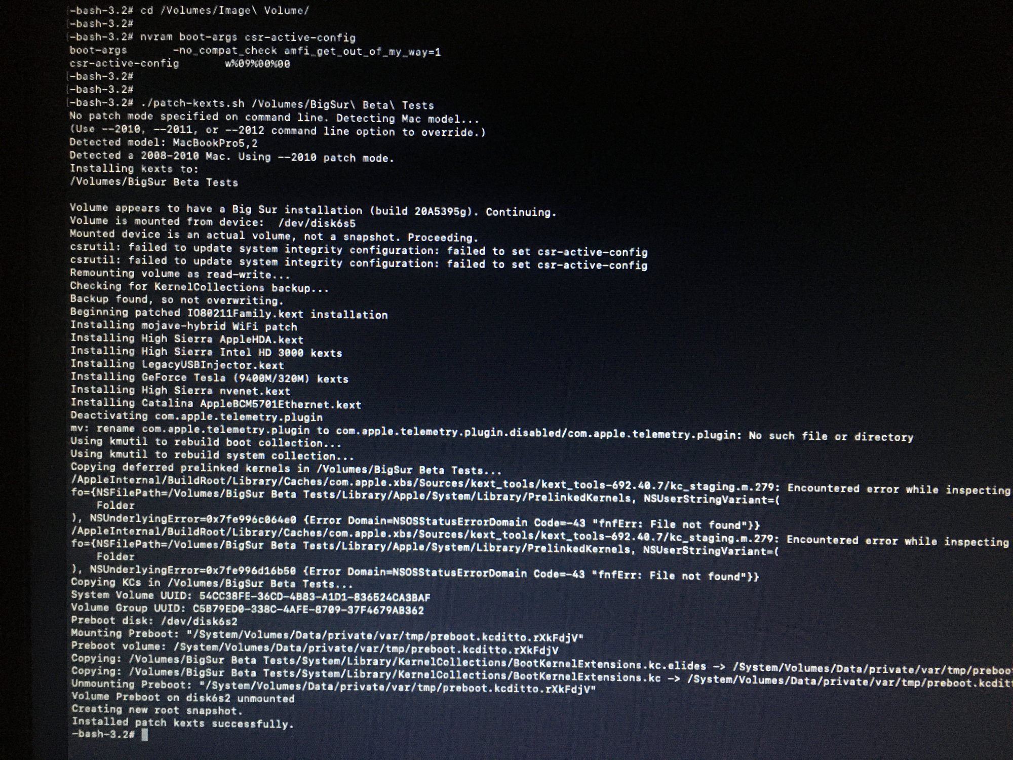

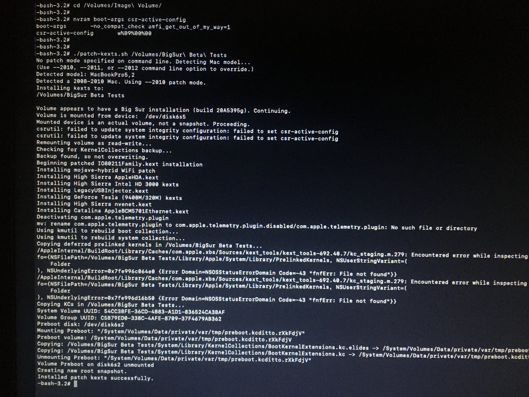

MBP5,2 - updated my BS beta10 USB installer with contents of payloads of micro patcher 0.4.3.
Applied new patch-kexts.sh to my existing BS beta10 installation on external SSD.
MacBookPro5,2 detected and options like for --2010 or --2009 correctly chosen.
Newly patched BS beta10 boots and runs fine.
Thank you Barry K. Nathan!

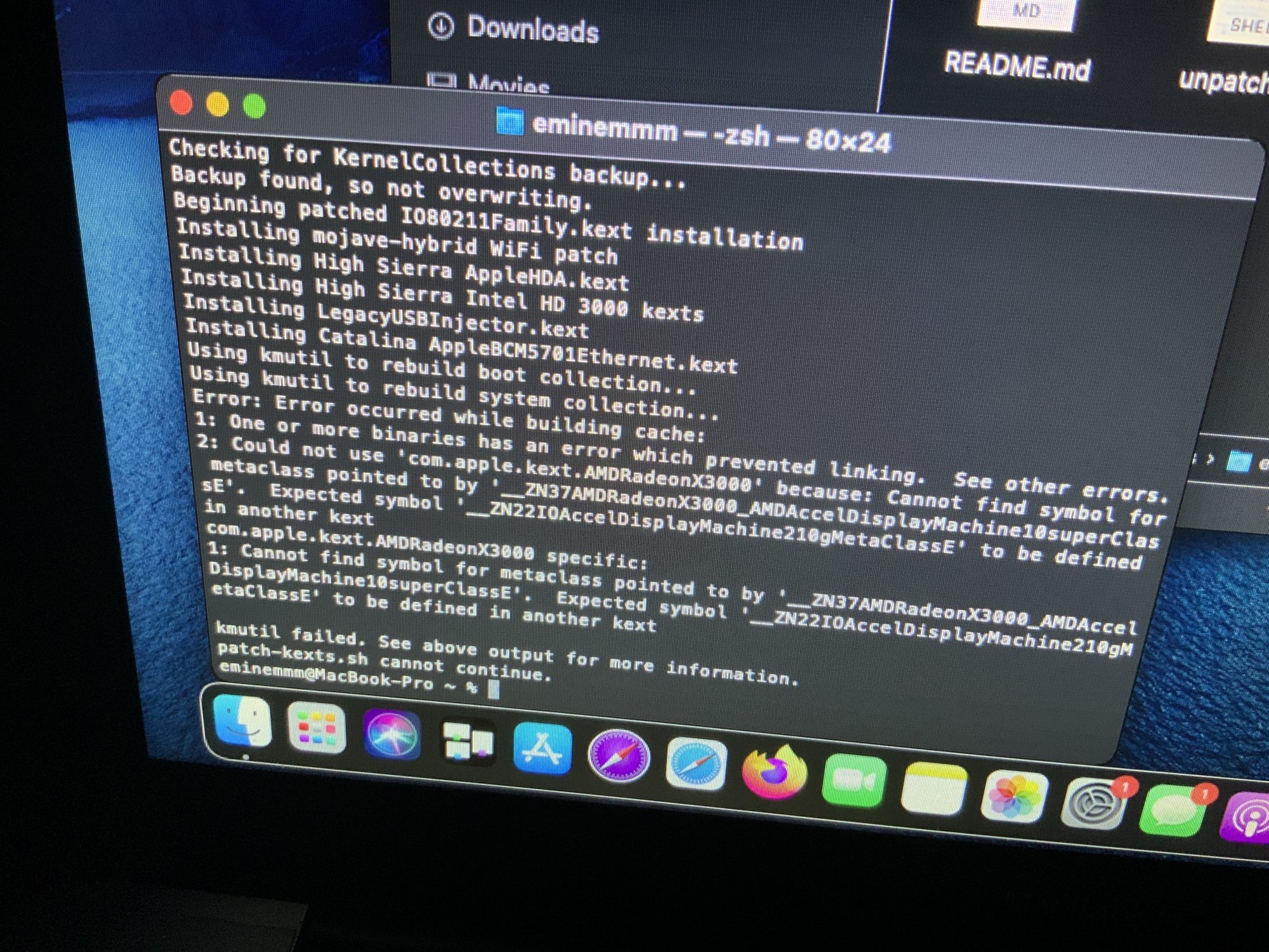

Tried also Micropatcher 0.4.3 on beta 9
but failed again as usual. Please see photo
i tried it twice booting from usb and from macOS
I was going to reply with directions for trying to fix it, but I think I should be able to make one more change to the procedure to reduce the risk of data loss in case anything goes wrong, so I need to run another test. This is going to delay me by at least a few hours, possibly longer. Sorry. (One of my attempts to come up with a fix failed to work and created a big mess on my test system, so I must be careful.)

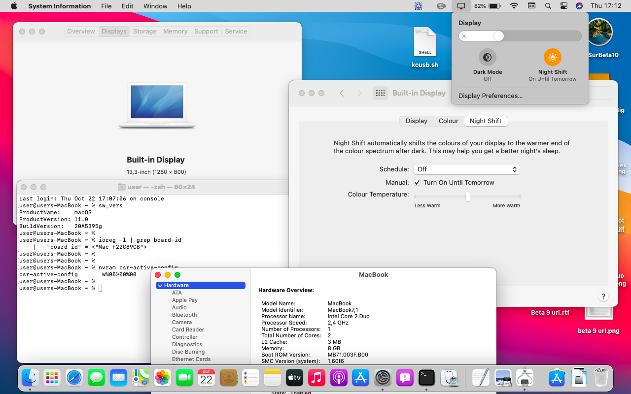

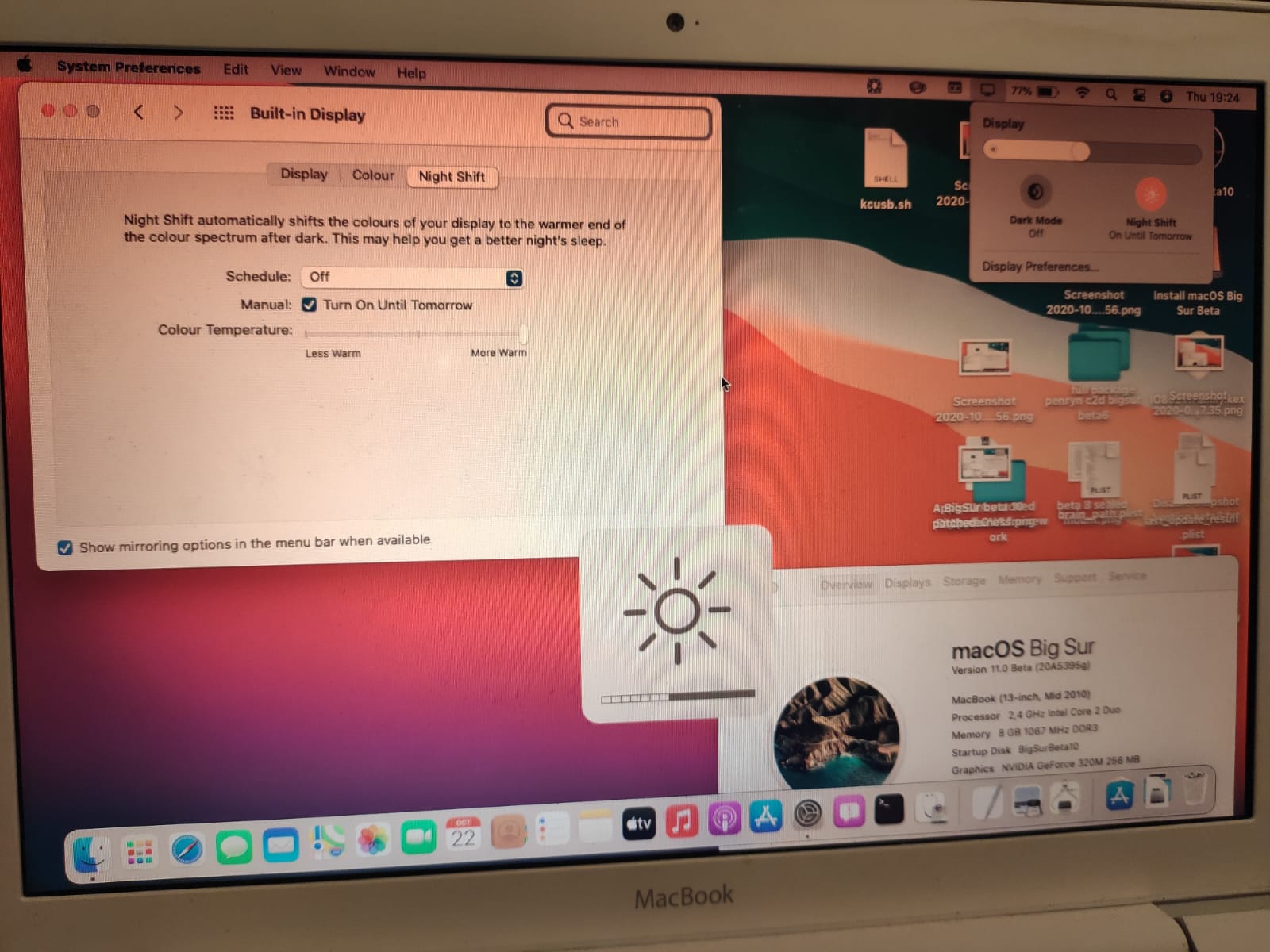

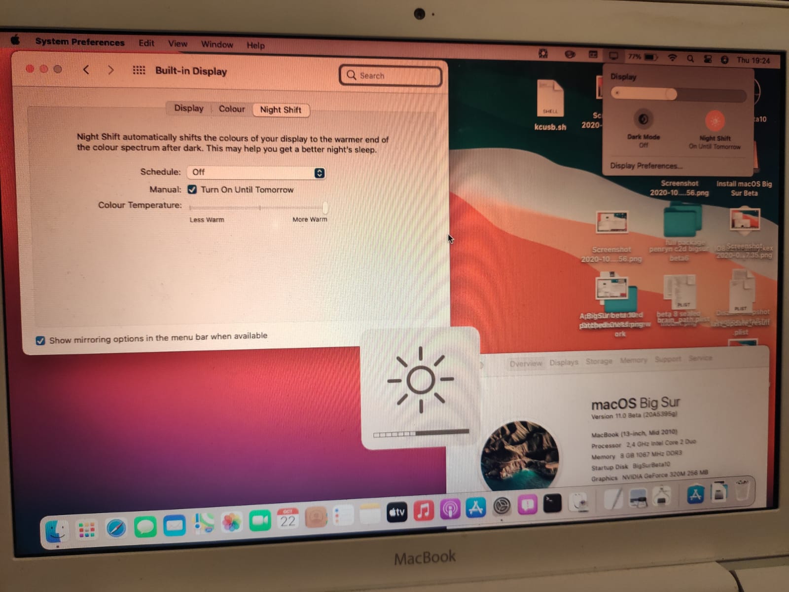

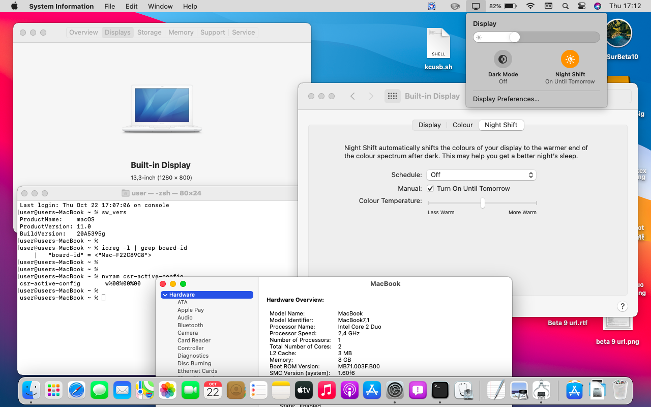

I report that this my earlier patched framework (based on Catalina framework 10.15.6): BigSur patched CoreBrightness exec
still works correctly on BigSur beta 10, as I explained earlier even if BigSur frameworks exec are packaged in dyld shared cache, if you replace manually it inside the target folder (typically /System/Library/Frameworks/Name.framework/Versions/A/ ), the kernel will try to load your patched framework exec before the one in dyld shared cache.
(This could be used as basis guide to use for example a patched AppleGVA.framework)
Some advises to use patched frameworks on BigSur :
- amfi disabled (amfi_get_out_of_my_way=1 in nvram or in com.apple.Boot.plist or ASentientBot Disable Library Validation plist)
- csrutil disable (or csrutil authenticated-root disable)
- editing the framework Resources/Info.plist SDK matching any values to 11.0 and macosx11.0internal (because 10.16 or 10.15 or earlier won't work or might work but with issues)
- replacing the framework in target folder through sudo mount -uw / (this requires snapshot booting disabled) or making a new snapshot with replaced framework from another macOS environment
- graphics kext framebuffer loaded (example ASentientBot patched Nvidia ResmanTesla or Intel HD3000 SNB)
