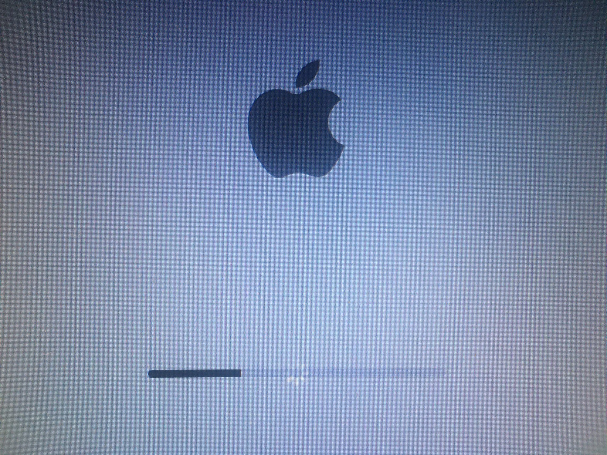

THANKS !!!!, YouTube is working fine now. Still stuck with the booting time. I think its something to do with snapshots or mounting volumes.
The long booting time is a known old problem depending on TRIM. Have a look whether Trim is enabled. If not you should enable it. During restart pess option key. when in the boot option go to your boot drive pressing ctrl and click the mouse on it. booting time should be faster then.

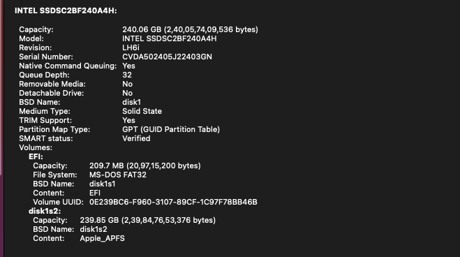

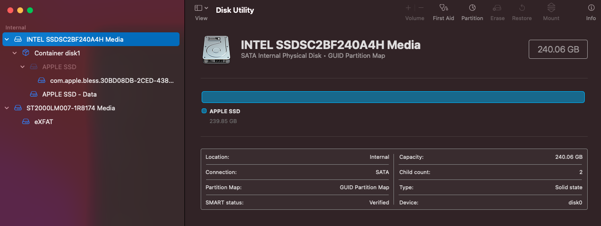

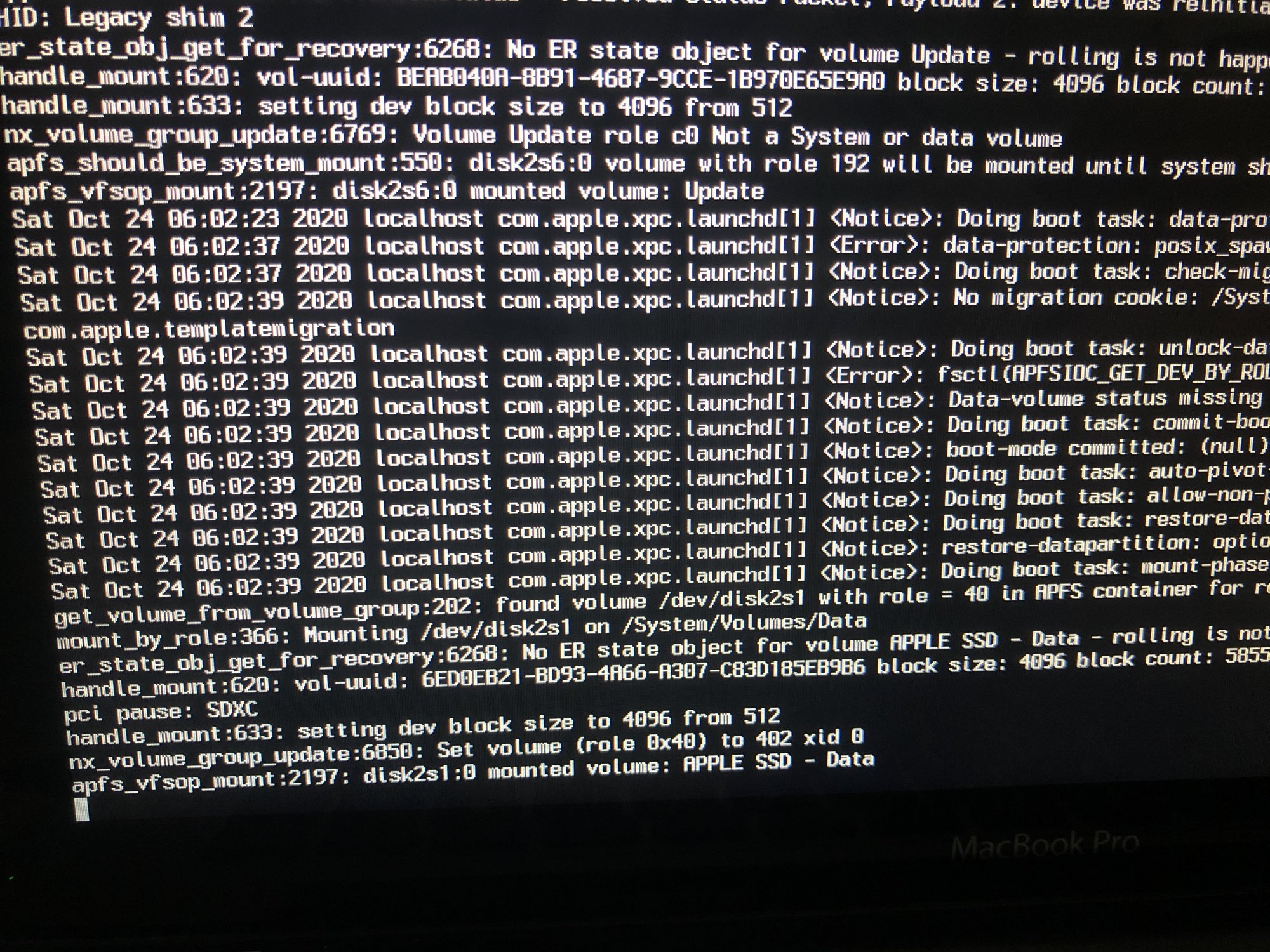

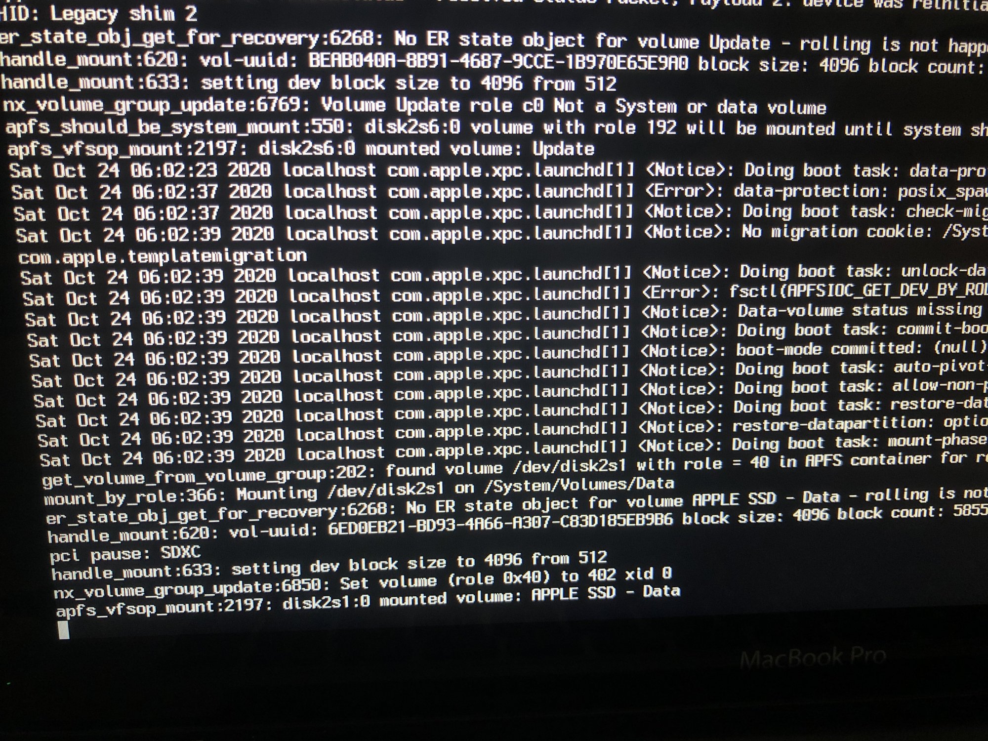

Trim is already enabled, and when I checked in verbose mode
"apfs_vfsop_mount:2197:disk2s1:0 mounted volume: APPLE SSD-Data" is taking maximum time..
Thanks.

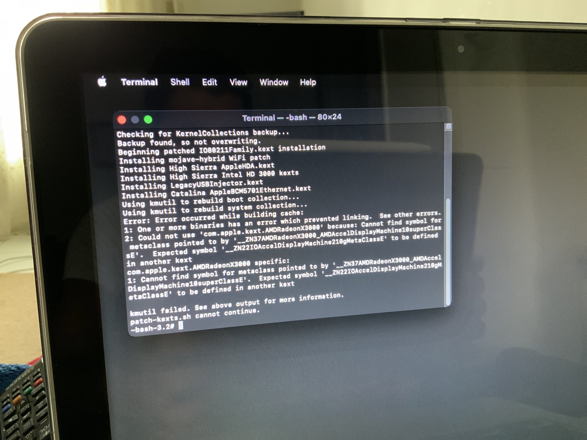

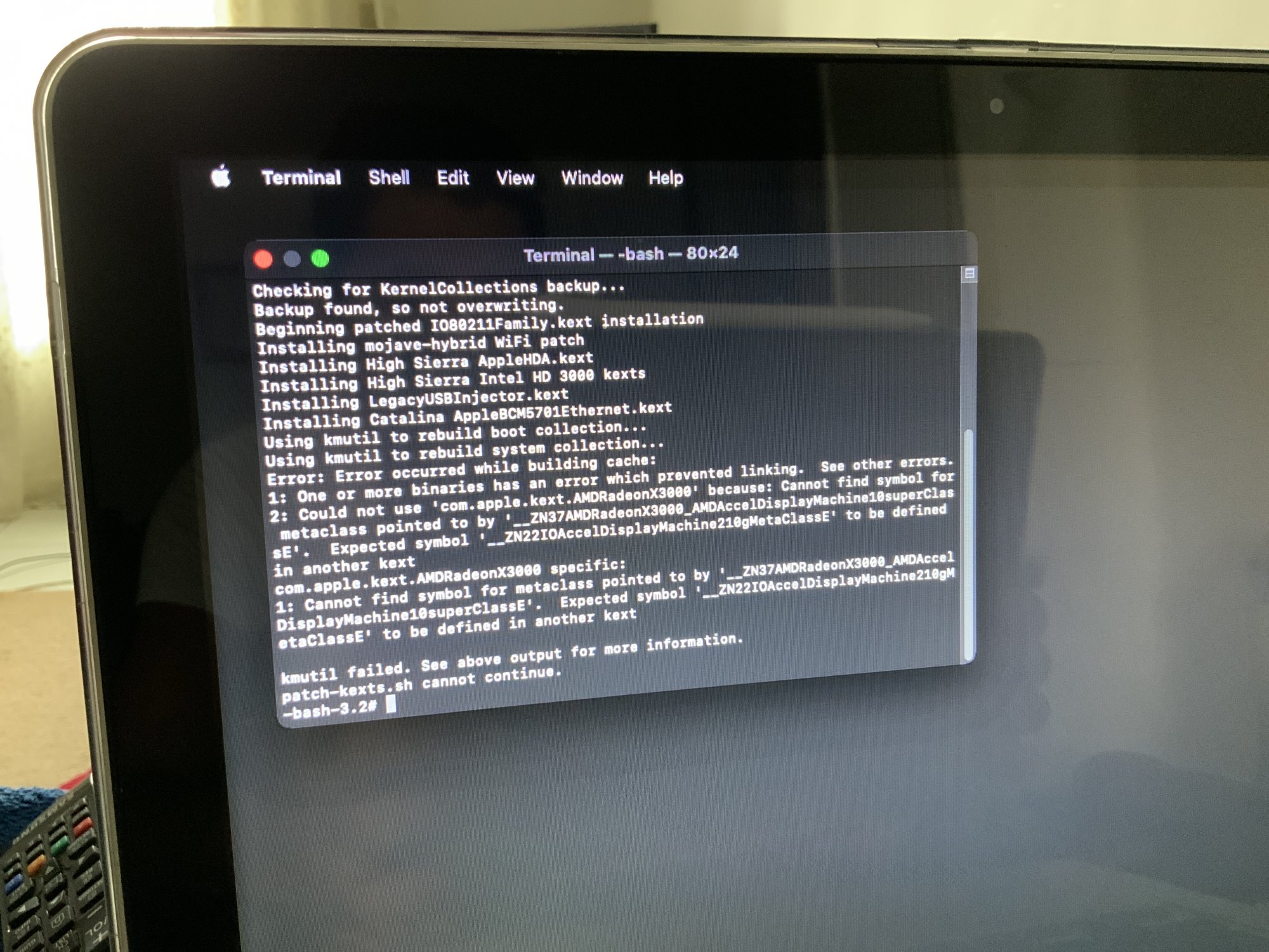

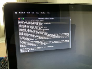

First, make sure you've done a Time Machine backup, as I've mentioned in a few previous posts.
Next, try doing the following:
Boot from the patched installer USB. Open Terminal. Then run the following commands:
Code:
cd /Volumes
mount -uw "Volume Name" (such as "MY KINGSTON SSD" or "Macintosh HD" or whatever your Big Sur volume is)
cd "Volume Name"
cd System/Library
mv Extensions Extensions.old
Then quit Terminal, start the Installer, and reinstall Big Sur. See if you're able to make WiFi and Ethernet work afterward.
tried but nothing worked

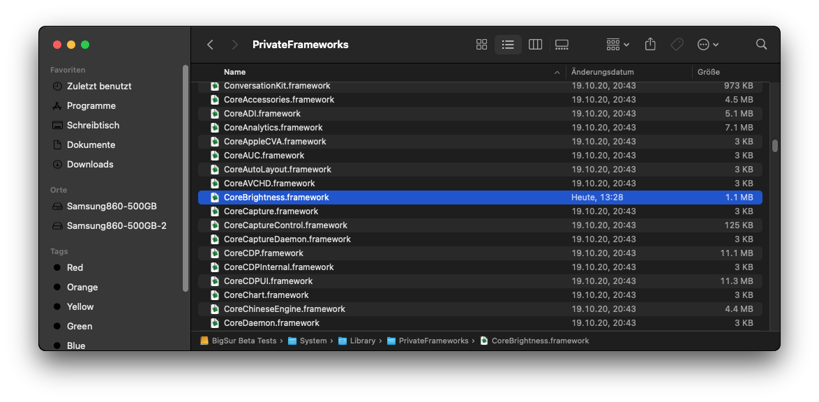

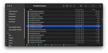

CoreBrightness.framework (and nightshift with it) also working on MBP5,2 with BS beta10. *
Many things in good shape on this legacy USB machine.
I had the problem of Photos.app crashing with all BS betas, but I had always used migration assistant to populate it with all my photos from Catalina. There seem to be one or more with problematic data among them. Without migration (just importing quite a few photos from iPhone) no problems.
* patch-kexts.sh is so well structured that I didn't replace CoreBrightness manually, but found it easier to make a small temporary change/addition to micropatcher 0.4.3 instead.
Thanks Barry K. Nathan and jackluke!

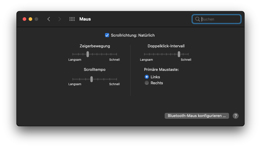

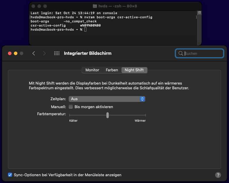

Two small scratches to this picture of BS beta10 on MBP5,2:
1 - while system information shows that USB mouse or keyboard are connected, system settings don't, and the devices don't react. OK in BS public beta 1. The same for on-board USB or USB3 of nanotech expresscard.
EDIT: USB mouse and keyboard work in beta10 after booting with CMDS+S/exit as seen earlier by alex-microsmeta.
2 - patched CoreBrightness.framework needs amfi_get_out_of_my_way=1 in boot-args, otherwise booting hangs. Reverted to unpatched one without problem (again via patching-over with patch-kexts.sh), to verify that booting is normal again.
Then went again to patched one for convenience of night shift.
Ausdauersportler had reported this already, I didn't notice it earlier as amfi setting was in place.
For me these are minor points which may still be cured. Thanks again to all!

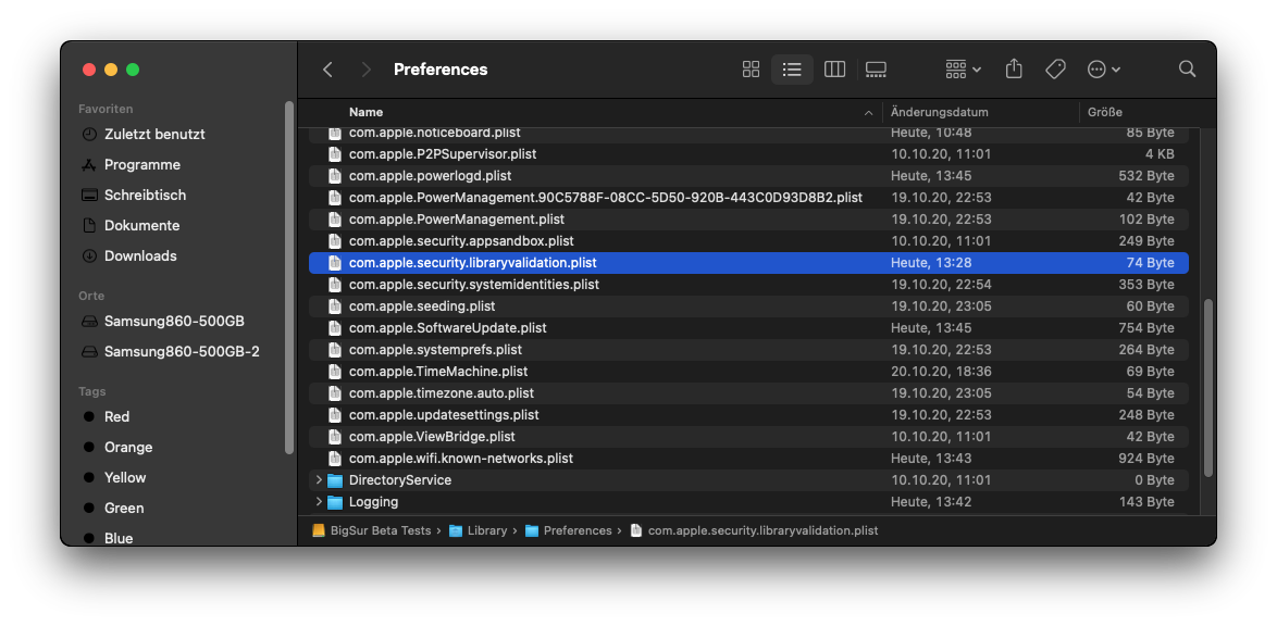

About the issue of USB mouse and keyboard non responsive, it's not due to my patched CoreBrightness, rather to LegacyUSBInjector.kext that on BigSur for Nvidia MCP79 and MCP89 Chipset for more working reliability requires CMD+S and exit.
About using patched frameworks and amfi, through this ASentientBot plist (a kind of amfi partially enabled to keep TCC.db stock and works also directly from snapshot booting desktop):
Code:
sudo defaults write /Library/Preferences/com.apple.security.libraryvalidation.plist DisableLibraryValidation -bool true
then you can clear the nvram boot arg for amfi (but SIP disabled is still required for patched frameworks), meanwhile I updated to 10.15.7 the patched CoreBrightness (pikeralpha method) aligning with BigSur beta10 Info plist, so maybe use this attached if you need night shift displays on BigSur non Metal GPU.

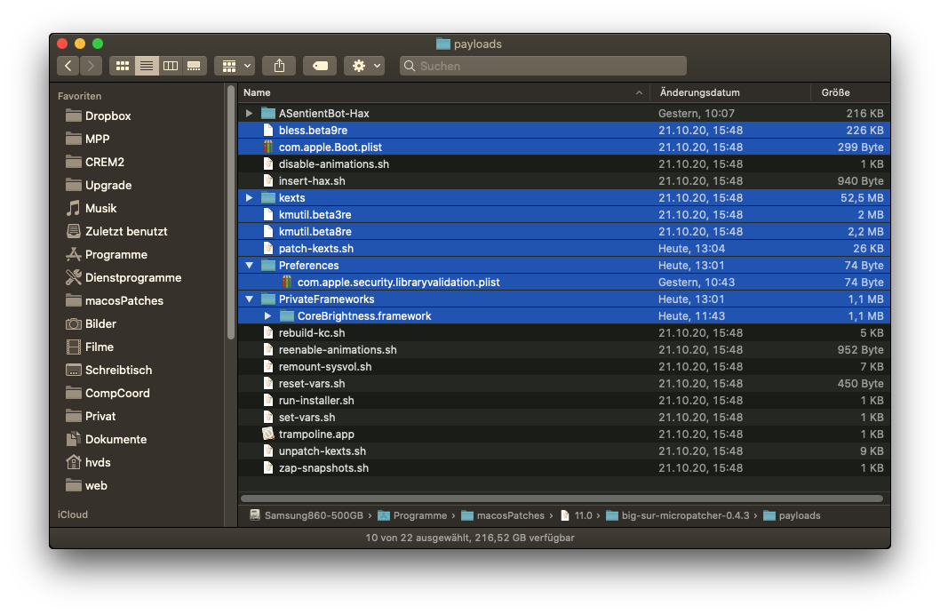

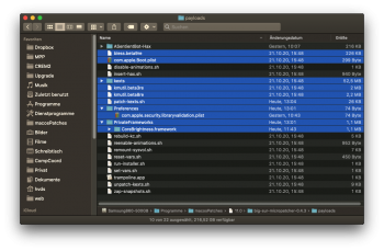

Thanks @jackluke , I had forgotten about the com.apple.security.libraryvalidation.plist which is routinely used in patched Catalina. Sorry, my fault. I'll try it right away, and also your new patched CoreBrightness.framework.
EDIT: that worked well, booting OK without amfi in nvram.
Your new patched framework and the libraryvalidation.plist are in place on my BS beta10 (USB SSD).
I've left this again to the patch-kexts.sh machinery, very convenient!
(for info to @Barry K. Nathan and @Ausdauersportler , appended is the minimally modified script I'm using temporarily (two places labeled hvds), together with the files used from micropatcher, with extra folders PrivateFrameworks and Preferences)
The existing libraryvalidation.plist (I took it from 10.15.7) and one freshly made in BS beta10 (defaults write...) are identical.
Just as a reminder, my BS USB installer is a hybrid based on createinstallmedia of beta10, patched with jackluke's BigSur BaseSystem legacy usb fix b9, and the patch-kexts part of Barry's micropatcher 0.4.3 for post-install patching.
Code:
cd /Volumes
cd "Volume Name"
cd System/Library
As you know from BigSur many core kext (example Wifi and Sound) to load after a new snapshot requires not only BKE but also SKE updated, so they are included on both kernelcollections, but apart this, from the user output seems that is using a dual GPU Mac with AMD GPU and IntelHD3000 , SKE can't complete to update because needs this AMDRadeonX3000.kext (stock on HighSierra but not on Mojave).
When the Sandy Bridge Mac has only IntelHD3000 GPU your BKE and SKE worked without issues, instead probably with a dual non Metal GPUs, the kmutil tries to rebuild the kernelcollection using the main hardware GPU in that case AMD Video card, so I guess is triggered when some IntelHD3000 kext are added to kernelcollections.
Hence to let rebuild SKE.kc for install patched "Wifi and Sound", I'd try to don't install IntelHD3000 kext on a dual GPU non Metal with an AMD video card, or maybe installing but also with HighSierra AMDRadeonX3000.kext (and its related dependencies kext bundles).
Thanks.
I guess it's the SSD vendor controller (or its NAND flash chip) a bit incompatible with APFS dual filesystem (snapshot booting), BigSur drivers or machine internal AHCI.
Look at @eminemmm's previous posts. It's a 13" 2011 MacBook Pro. It's HD 3000 only. It's not a dual GPU machine.
Somehow it's having trouble removing the kexts that are left over from the dosdude Catalina patcher's Legacy GPU Patch, and that's why kmutil is failing.
@eminemmm I have another set of instructions to try. I'm having trouble figuring out how my previous instructions would not have worked, but try this before I suggest anything more drastic.
Code:
cd /Volumes
cd "Volume Name"
cd System/Library
rm -rf Extensions
rm -rf Extensions.old
