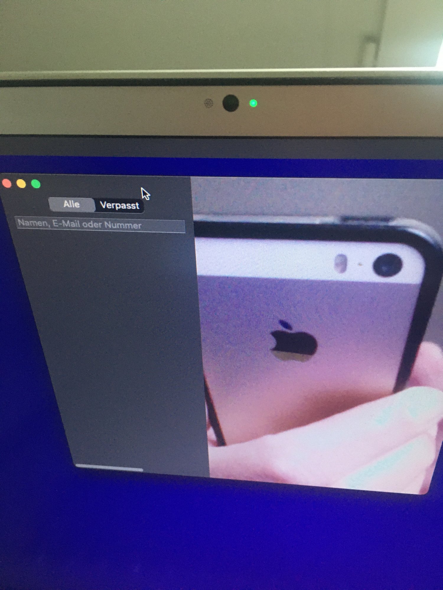

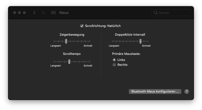

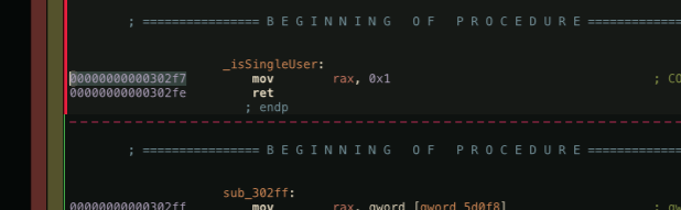

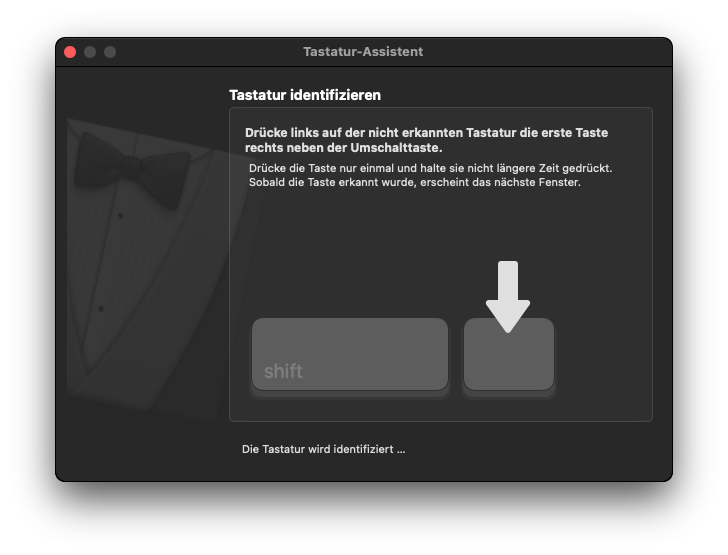

I've patched the IOHIDFamily exec from BS beta10's IOHIDFamily.kext à la ASentientBot, using hopper disassembler v4. No re-codesign done but that seems unnecessary. So in effect function _isSingleUser always returns TRUE.
Installed the patched IOHIDFamily.kext, again via patch-kexts.sh. Booting my legacy USB MBP5,2 now results in responsive USB keyboard and mouse even without CMDS+S/exit (tried booting a few times). iSight also works, but I think it did before.
I can't easily tell with my non-graphics-accelerated machine if this patch causes undesired delays elsewhere.

Well done, codesigning is not required for kext exec, but only for frameworks exec, I notice that also your iSight webcam works.
But I guess for some non-APFS machines still there is an iSight issue not due to LegacyUSBInjector.kext or IOHIDFamily.kext or patched CoreBrightness, because from my another test seems that on non-APFS Mac FaceTime iSight crashed when framebuffer video kext are loaded, instead with basic graphics kext (as those used in safe mode) it works.

Your patched file worked to skip CMD+S and exit for legacy USB Mac, checking your IOHIDFamily exec is reduced to 882 KB (while stock apple beta 10 one is 2 MB ) so more than half of assembler code has been removed from binary patching or there was some ARM coding removed after binary exec produced ?
@ASentientBot and @Barry K. Nathan could you confirm that modifying the assembler code for _isSingleUser function from IOHIDFamily binary stock 2 MB the binary size is reduced to half, I guess it's the ARM code that is removed from Disassembler when build Mach-O x86_64 output exec ?
In that case (as for Catalina exec 32 bit is removed) ARM binary code is almost unuseful for Intel cpus, so @hvds patched IOHIDFamily worked correctly for BigSur legacy USB Mac.

Could be due to ARM code. I just overwrote the beginning of _isSingleUser with the two instructions and left the (orphaned) rest of the function untouched.
Then to save the change did in hopper disassembler File / Produce New Executable.
Edit: probably Hopper Disassembler can't deal with the ARM instruction set anyway, it may ignore ARM code already while reading the exec file.
